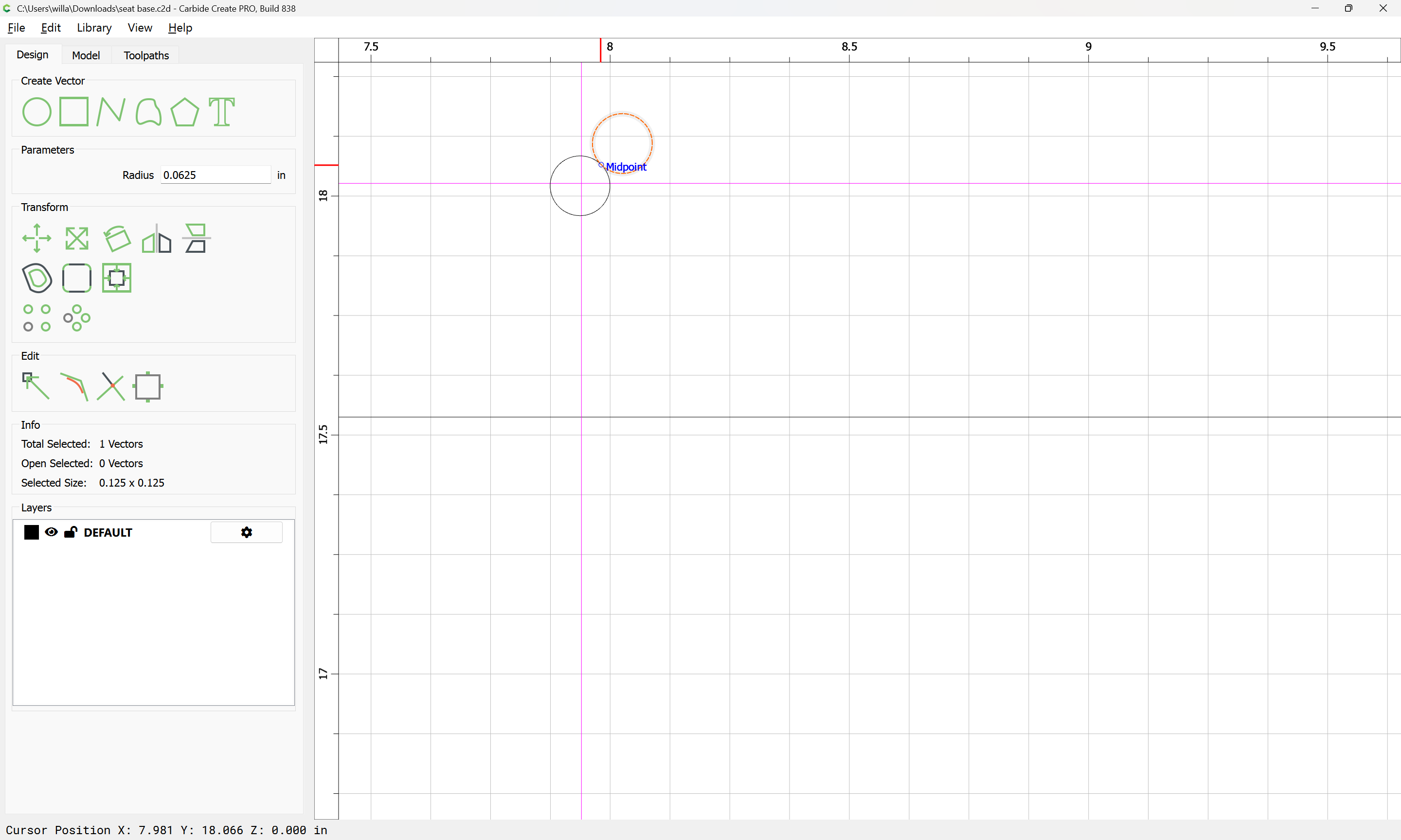

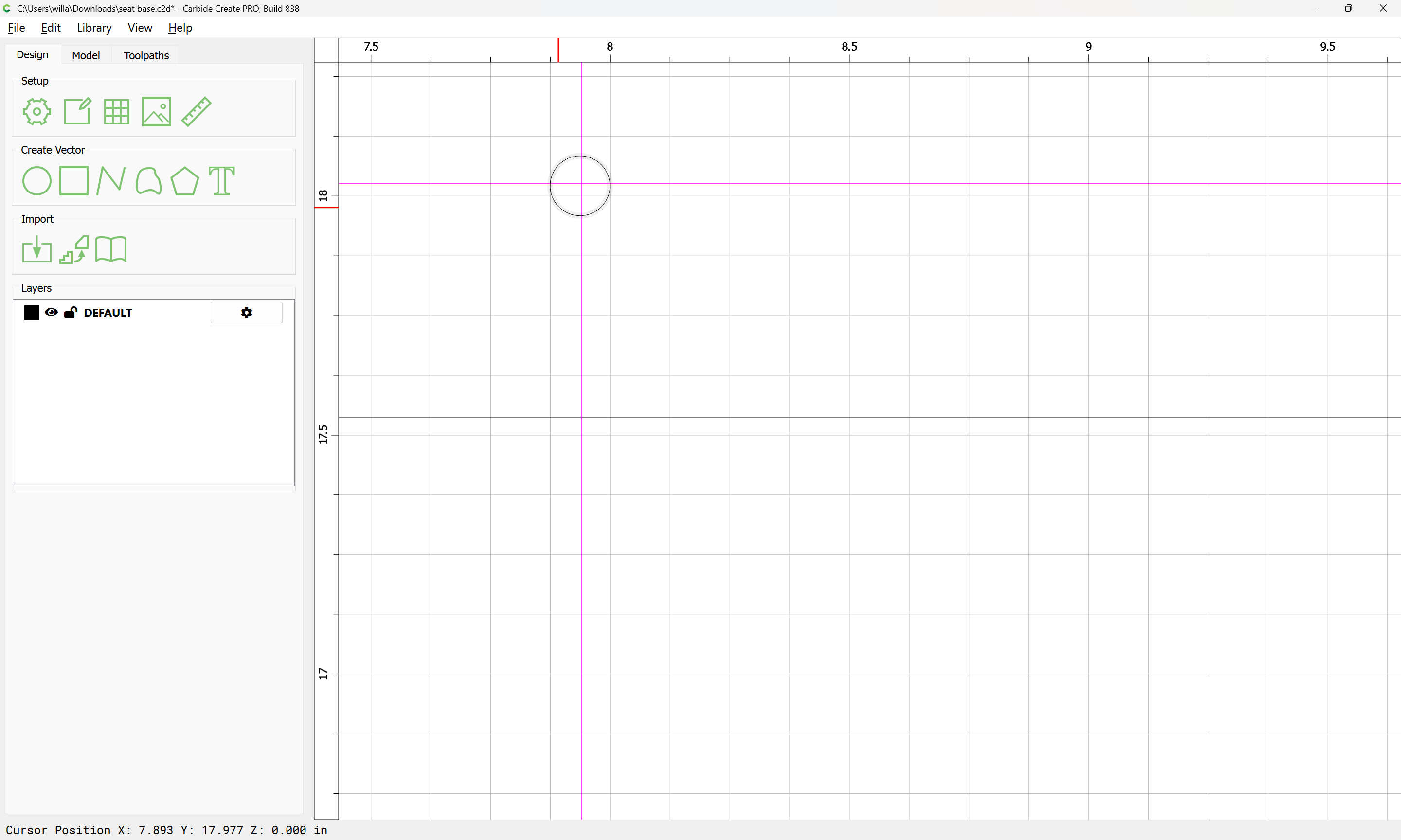

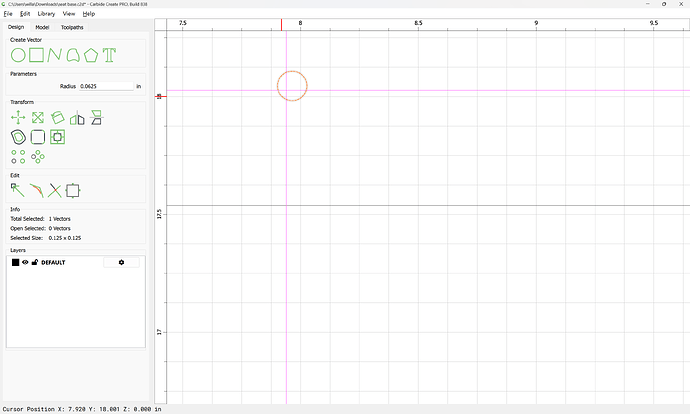

Drags diagonally:

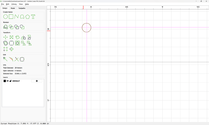

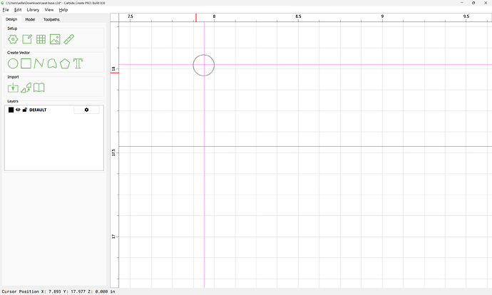

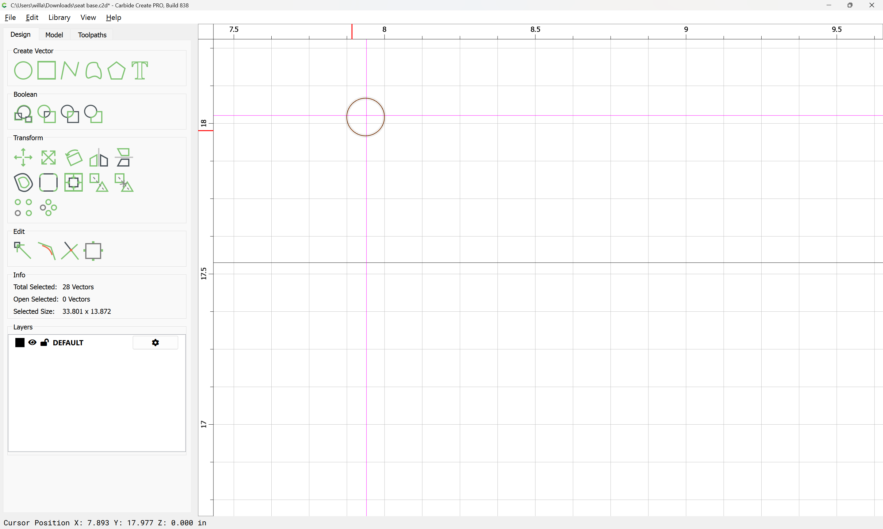

One issue is you have 29 copies stacked on top of each other:

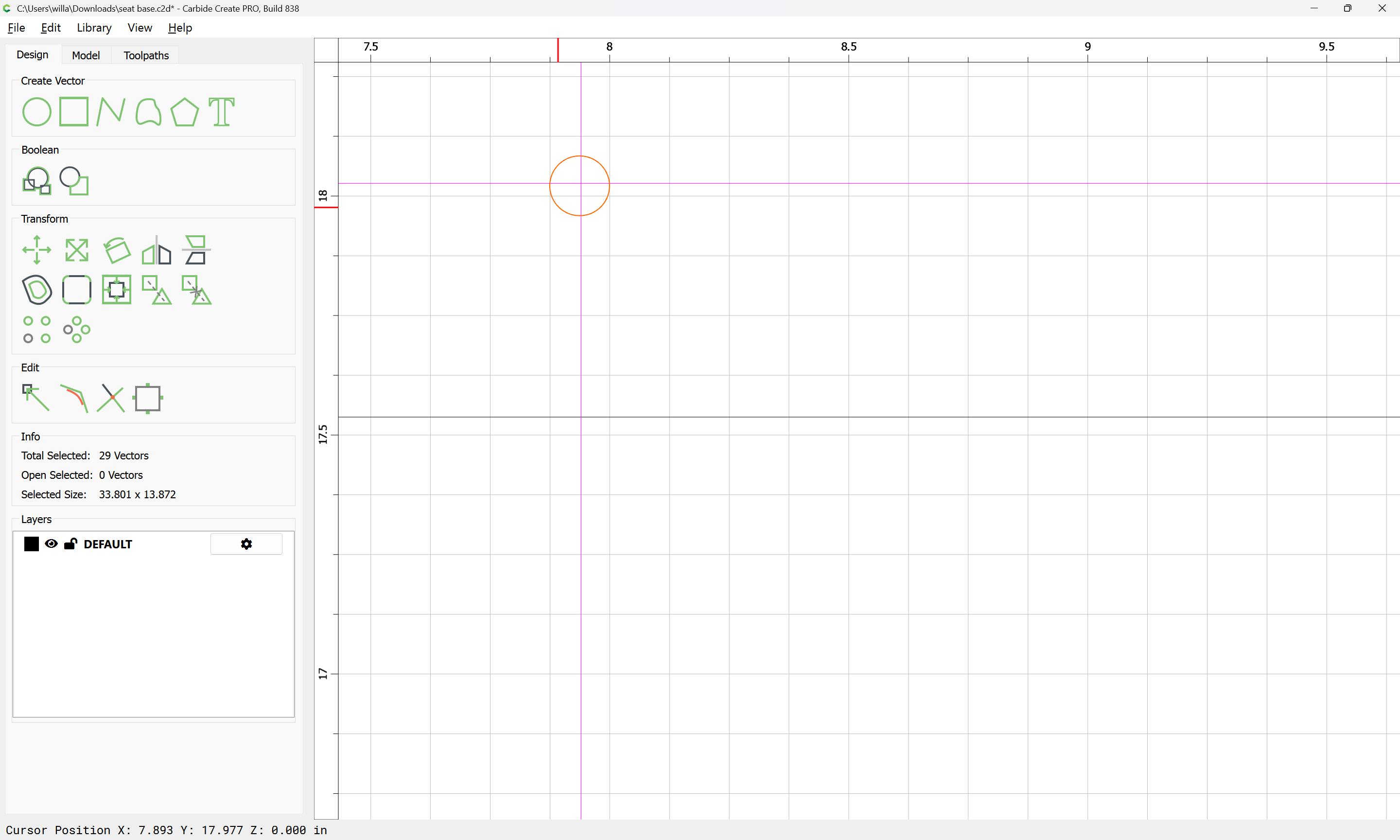

If you shift-click to remove one from the selection:

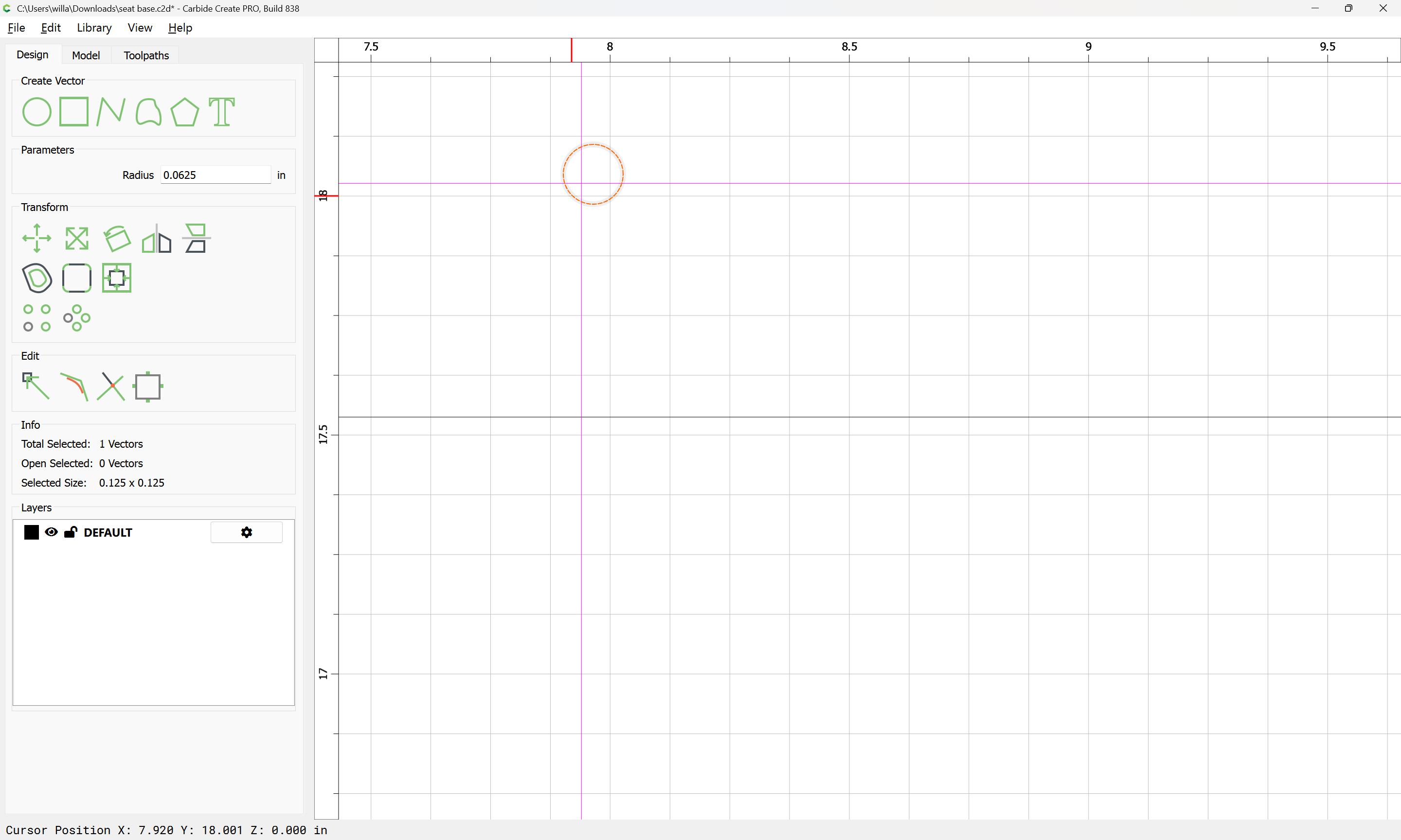

and delete:
you will find shifting easier, since it doesn’t want to snap to itself:
Really? Don’t know how that happened. Will see if I can fix it.
