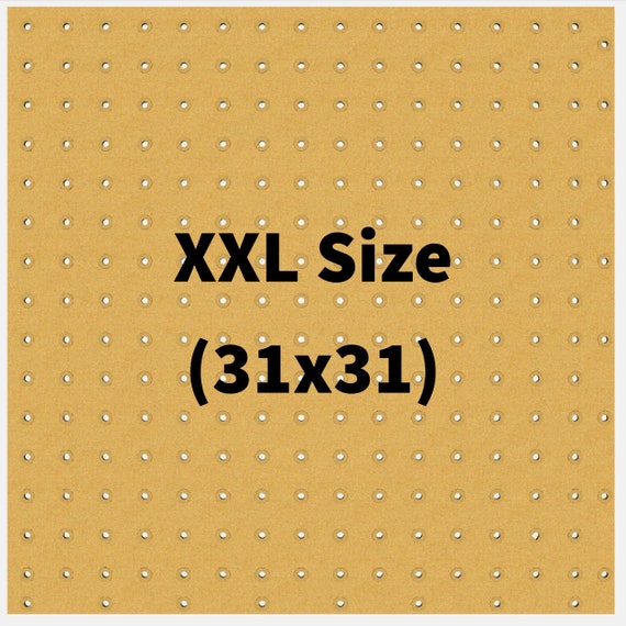

Consider the Myers Woodshop version. Works fine for me.
it did for me too, until I realized why it didn’t.
but it is a good place to start!
Works for some. I used CCs plans. But do make the board slightly smaller than your usable area as if larger, you will have a high spot surrounding your real work area

i still need to scrap my janky first Myers one!
When i make my next “good” one, it will be slightly smaller. A) The meyer’s spec one can’t be resurfaced easily, at least with my surfacing bit. I think he used a 1.5 amana and I have a 1" whiteside, so there is a .25 rim that i had to hamfistedly carve down, and
b) it butts up too close to the front of the machine; my next one will make sure there is clearance for the surfacing bit to not grind on steel.
I also really only use a few of the t-nut holes a lot, and many never, so a t-track and threaded insert combo instead of a solid grid of them is kind of compelling.
