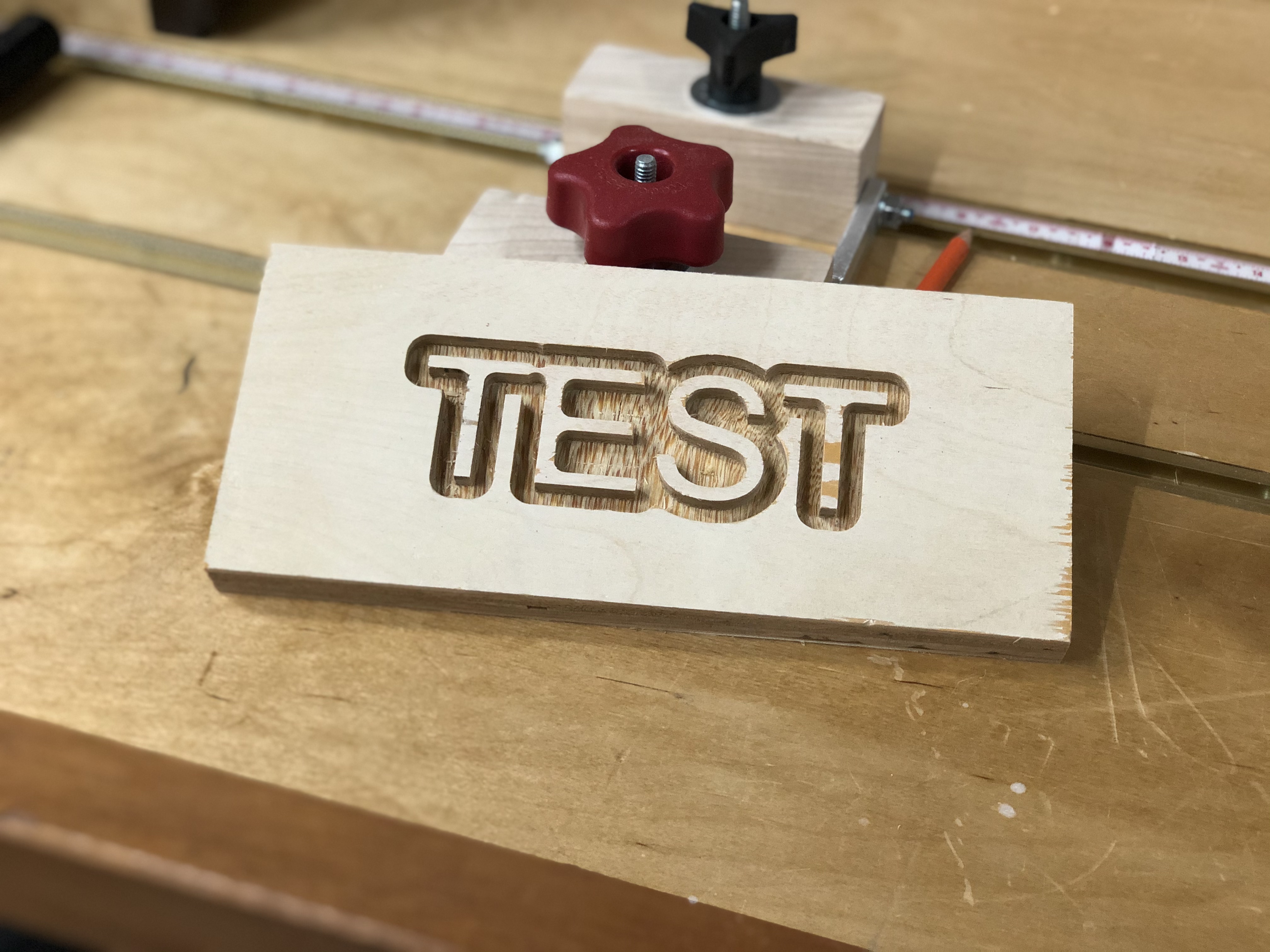

Having some issues with my projects being offset up and to the right.
My initial v carve tests seemed ok. I decided to v carve something for real. So I did my normal workflow in CC. Project size and depth was correctly set to my work piece Set start to lower left, as I always do. I setup an advanced V carve, ran the sim and it looked good. I used a #201 for the pocket and 90deg v for the 2nd tool.

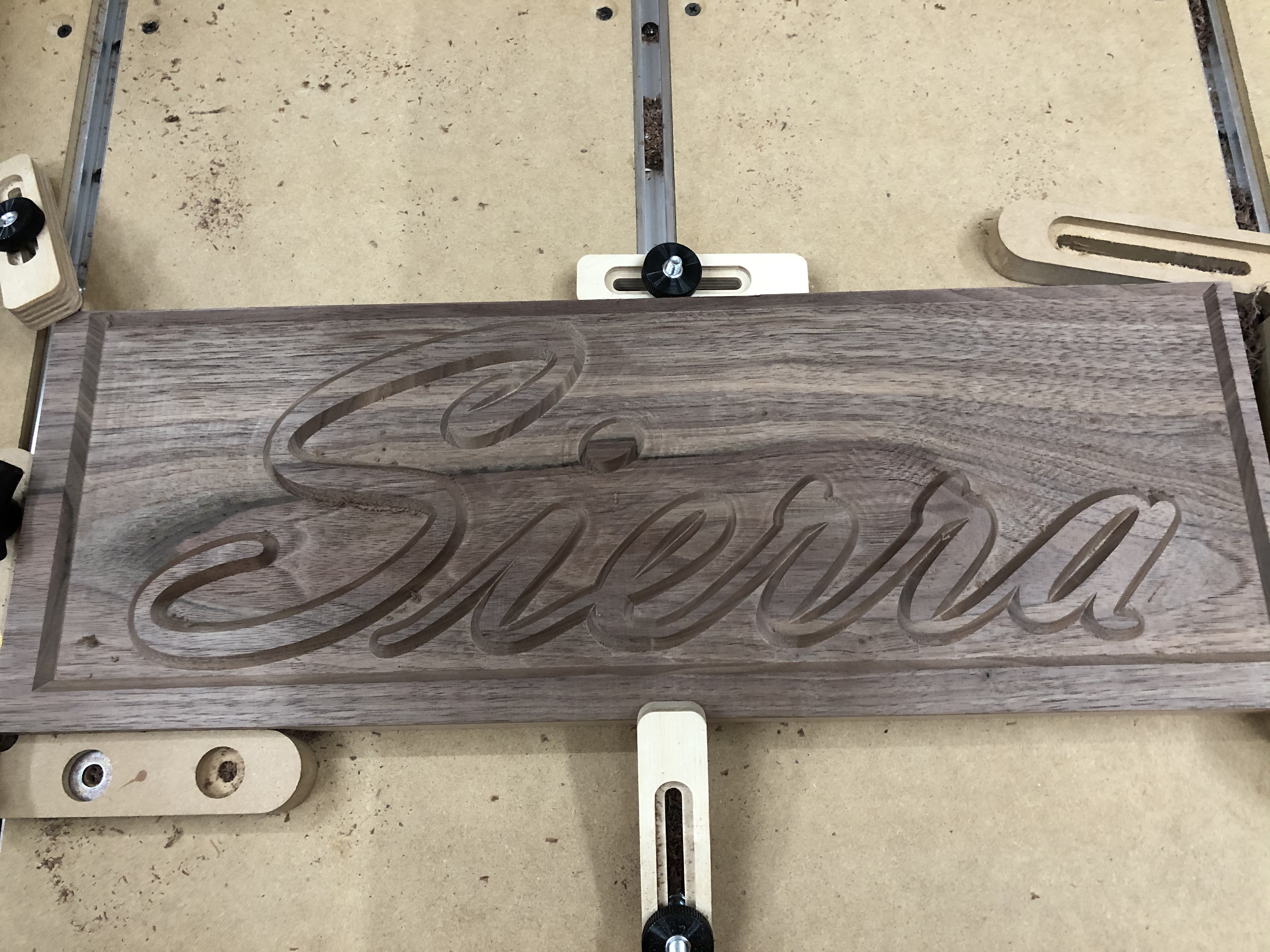

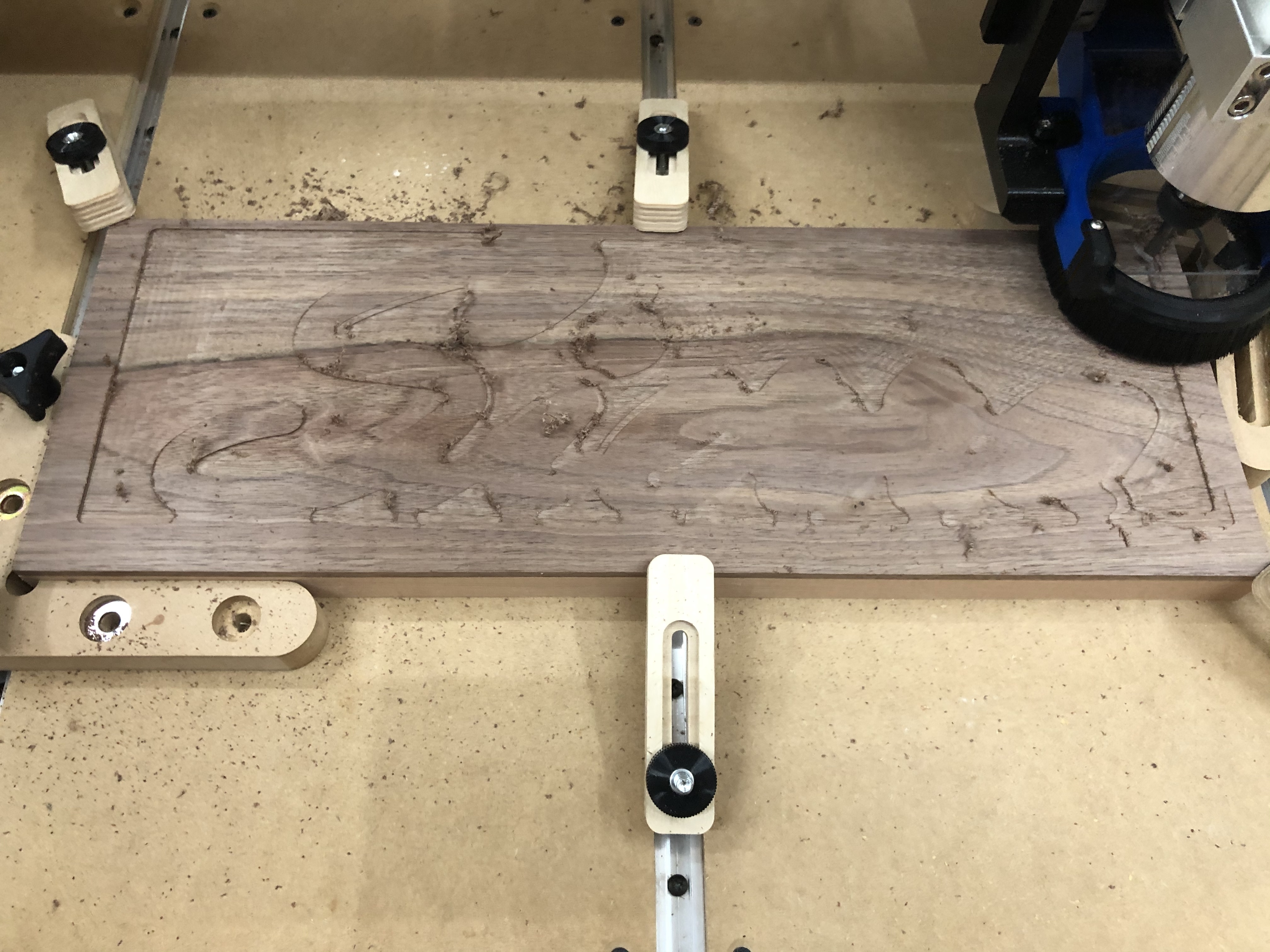

In CC my project is centered to the stock. I have a 1/2” border around the whole thing. Looked perfect in simulation. Here’s the starting cut and the final.

Here’s the CC file and gcode generated from it. I have a feeling its something machine related. That, or my setup prior to the cut isn’t taking something into account.
So I’ll go into detail of how I’m using the bit zero. Actually, I’ll start with what my machine does when I turn it on and initialize. I initialize the machine, it does the normal back right corner home procedure, then runs to front center for tool change (bit setter). I change the tool, or run it as-is. The machine heads over to my bit setter to check the bit. I watch it plunge down, the bit setter turns red both times. After that runs, it comes back front center. I place the bit zero at the lower left corner of my stock. Z only setup. The full bit zero is on top of the stock, no edges hanging over, its flush at the corner of my stock. I jog over then slowly find what looks to be the most centered on the bit zero’s circle I can get. I hook on the alligator clip and run a probe in Z only. After that, I remove the clip, and go back to the jog screen to zero X and Y in their current coordinates. I leave Z as-is, since the bit zero has already taken the offset in to account. I clear the bit zero from the cutting field.
I then load my file, and start the job. So this part always strikes me as odd, as my bit setter runs again. Maybe I should be loading my job first and foremost? After that, It asks to set the router spindle speed, then my bit runner starts the machine after clicking resume. I think I have to click start one more time? Maybe? Either way, the job starts and runs from that point on.
This was a 3h 48m job. So i’m a bit bummed it didn’t pan out. Not a big deal, I’ll bandsaw some more walnut veneer and try again, once I figure out this issue.
So what I have for stock, is a .25" piece of walnut, laminated to a piece of soft maple. So that was pretty much my intent, to have the letters and frame walnut, but the background be the maple. It worked, and looks just as I thought I would, minus the offset, haha. I did have to adjust my depth and I re-ran the job a 2nd time to get the desired depth correct.
I just measured my bitzero, Center of the circle is .250” in from the edges.
Assuming I understand your process, you zero Z on Center of the circle, with bitzero on top of stock. Then proceed to zero XY at same coordinates?
You should be jogging so the absolute Center of your bit is right on the corner of your stock, so go 250” south and .250” west. That should be your XY Zero.
I didn’t read carefully. @David.Curtis is exactly right…your zero wouldn’t be on the circle engraved on the BitZero, it would be centered over the corner of the BitSetter (also centered over the corner of your stock).
