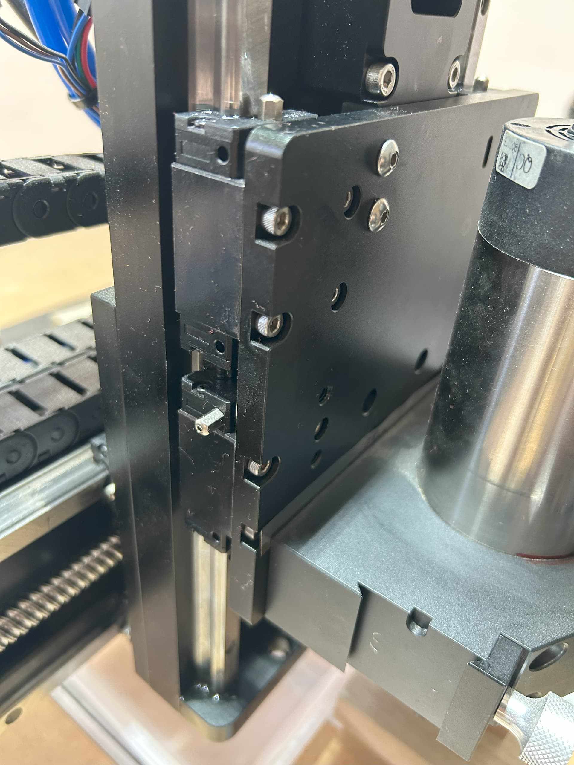

Folks - Help me please… I have a 5Pro 4x4 with 60mm spindle. Works like a charm. Challenge is getting to the lower ports on the Z. The two on top and the two on each side are no issue. But how do I get to the bottom ports without removing theHDZ and turning upside down. The videos provided said ‘you can do this without disassembly’.

Vactra #2 is fairly thick. So I use a plastic syringe I got in a pack off of Amazon and just inject it up into the bottom ports. Then quickly put the screw back in. I have a plastic tray under the Z to catch dribbles. Works great.
Lubrication connectors on the side. Hiwin Guideway Assy. Instructions 8.3.2 page 43.

I agree it needs to be easier, but adding anything that sticks will hit the side gantry uprights. Does that port get removed after lubrication?
These fittings only stick out about .2". With my z axis/spindle as low as possible the fittings go over top of drag chain. No chance of hitting anything.
Hey all, both oil ports lead to the same reservoir, so the side that is accessible to you (top side of the bearings for the upper HG15s, underneath the carriage for the bottom HG15s) should be enough to thoroughly oil the entirety of the block.

The real risk of disassembly comes from gravity - if you don’t remove the HDZ from the carrier plate and lay it flat on it’s back, it’s possible for those bearing blocks to slip off the rails, you then run the risk of losing individual balls from the blocks themselves, rendering them pretty useless. (You could try to put them back in by hand, but good luck buddy).
Yep, same here, eBay syringe and squirt the Vactra 2 into the top ports on the top blocks and bottom ports on the bottom. As you say, the block end reservoirs both feed the same ball bearing circulating paths anyway, once there is fresh oil being deposited on the rails, the blocks are oiled enough.
Using side lubrication connectors requires no disassemble. Tap hole with m4 bottom tap open passage with pin punch. (You could try fighting gravity, forcing oil up into the block, but good luck with that mess buddy).
