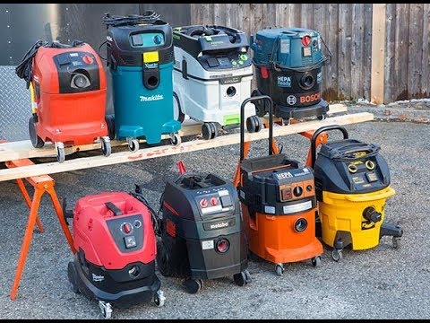

Comparing two very different levels of vacuums IMO. Dust extractors, like Festool’s, usually are $200+ due to OSHA compliance and HEPA certificates, revolving around the size and percentage of dust particulates it removes before exhausting. Along with duty cycle, suction, noise levels, warranty and all else the brand’s ecosystem (accessory, tools, attachments).
A video I referenced when deciding on the dust extractor/vacuum I wanted to buy, around performance (I went with a Makita VC4710):
Festool dust extractors, in particular around here - I think the attraction the the very, very good dust containment. It’s just plain good. Expensive, yes. Impossible to match with a $100 shop vac as far as I can tell, even with “hepa filters”. I think that’s the bit in particular to the festool dust extractor.
