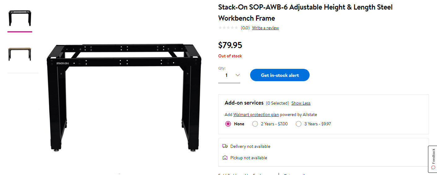

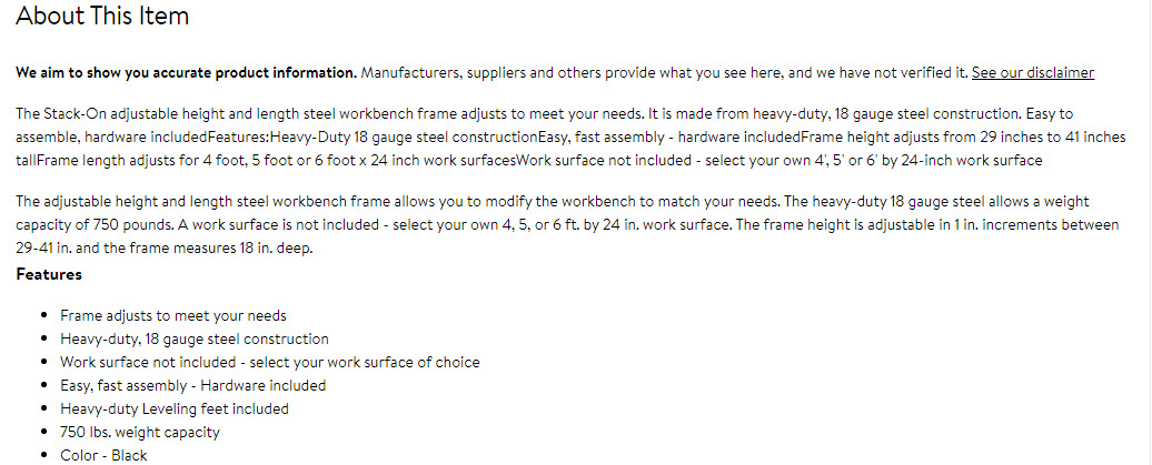

My issue was a little different but similar. I didn’t have much floor space left in my garage.
So I purchased a work bench frame from a company called Stackon. It has adjustable width and height. I set the height and width so i could slide it over my table saw then added a 2 x 4 under each leg and mounted a set of appliance rollers to the bottom of each leg. It works great, i can use the CNC where it is and just roll it out when i want to use the table saw
Table
Table
Legs
I believe this is the frame i bought
I added two additional angle braces in the back like the ones in the front just for extra stability. This bench doesn’t have a horizontal cross brace like most so i can slide to over my table saw easily
