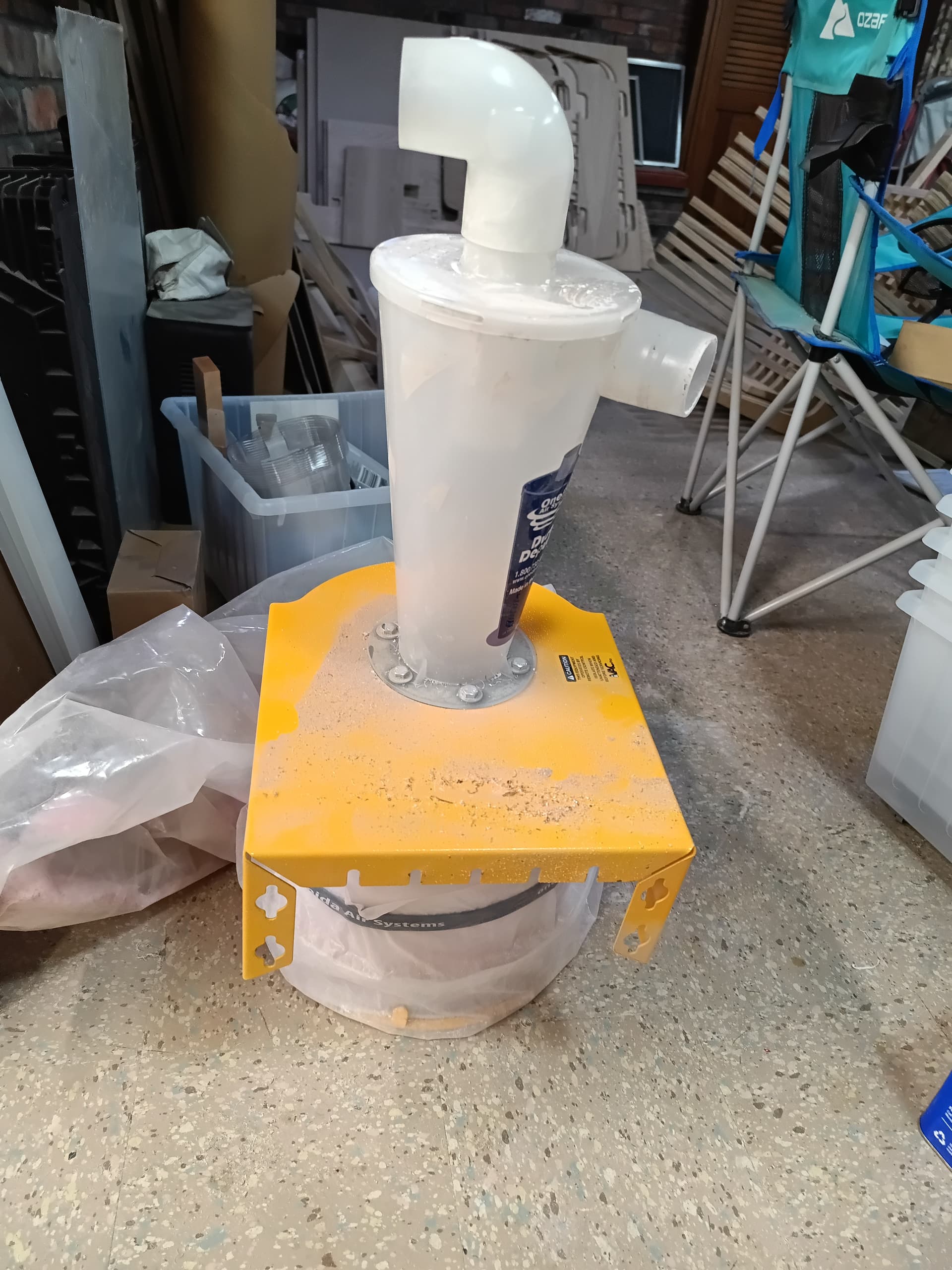

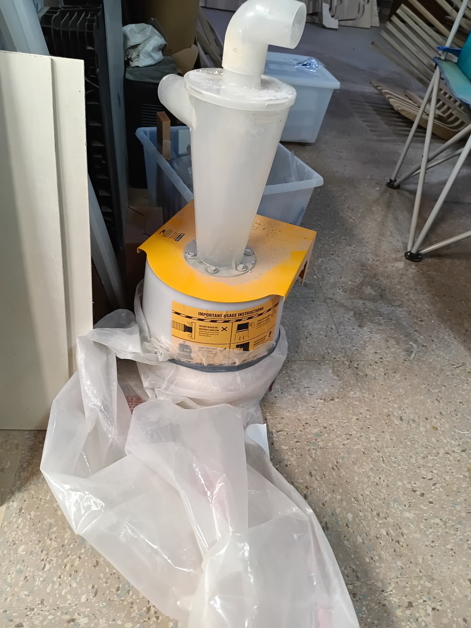

Oneida Air Systems Dust Deputy Anti-Static Cyclone Separator (DD Bagger), wall mount, for free, just need shipping costs, will be a rather large not too heavy box since I do not want to disassemble the item, is a little tricky.
https://www.amazon.com/dp/B084611MM2?ref_=ppx_hzsearch_conn_dt_b_fed_asin_title_3
Worked well, Oneida said anti-static, I am not so sure, I earthed the hoses, and still while cutting Epoxy resin the static electricity could be felt when touching the cyclone, and the connection to the main unit was lost several times.
And handling the bag, held in place with a rubber band, was rather bothersome for me: was in a kind of far a way corner.
When it was stuck the dust was sucked up to the vacuum, what filled the filter there fast.
However otherwise it worked well. So despite being -surprise- dusty it works well, and I should have another bag somewhere. Indeed this one is the first from 2021. Oneida does not offer this type of device any more.
Can be picked up of course in Glens Falls, NY too.
(I use this item now: 2 in 1 Dust Cyclone Collector Separation Vacuum Cleaner Wall Mounted Wheeled Modes Dust Collector Woodworking Tools Contractor Polish Pollen Ash etc Focusing Small Dust (Whole Rocket Set) - Amazon.com)
Hope less static electricity issues. But this item also appeared better in the videos than it works in reality: the valve that automatically should release the dust into the trash can does not work as automatically as expected: with mi first attempt the dust got stuck there, and I hat to poke with a piece of dowel to release it…
