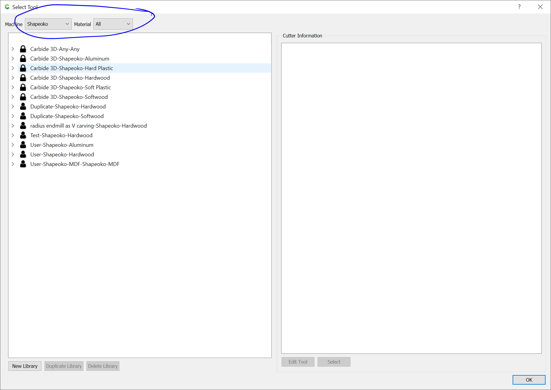

When I try to select a different tool and go to the tool library, all I get are 3 Shapeoko “user” tools. MDF etc. no tool library! Also don’t know how or where to pull images for (example) playing card symbols!

What version of Carbide Create are you using? I think you should update if you’re not running the latest version (623) Carbide Create
I had something similar happen with the tool database the first time I loaded Carbide Create. But it went away on its own after just rerunning Carbide Create. So I am not sure about that. You may need to uninstall and then reinstall Carbide Create.
