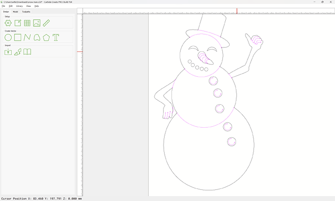

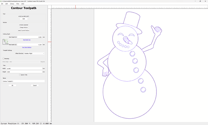

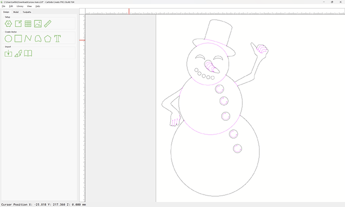

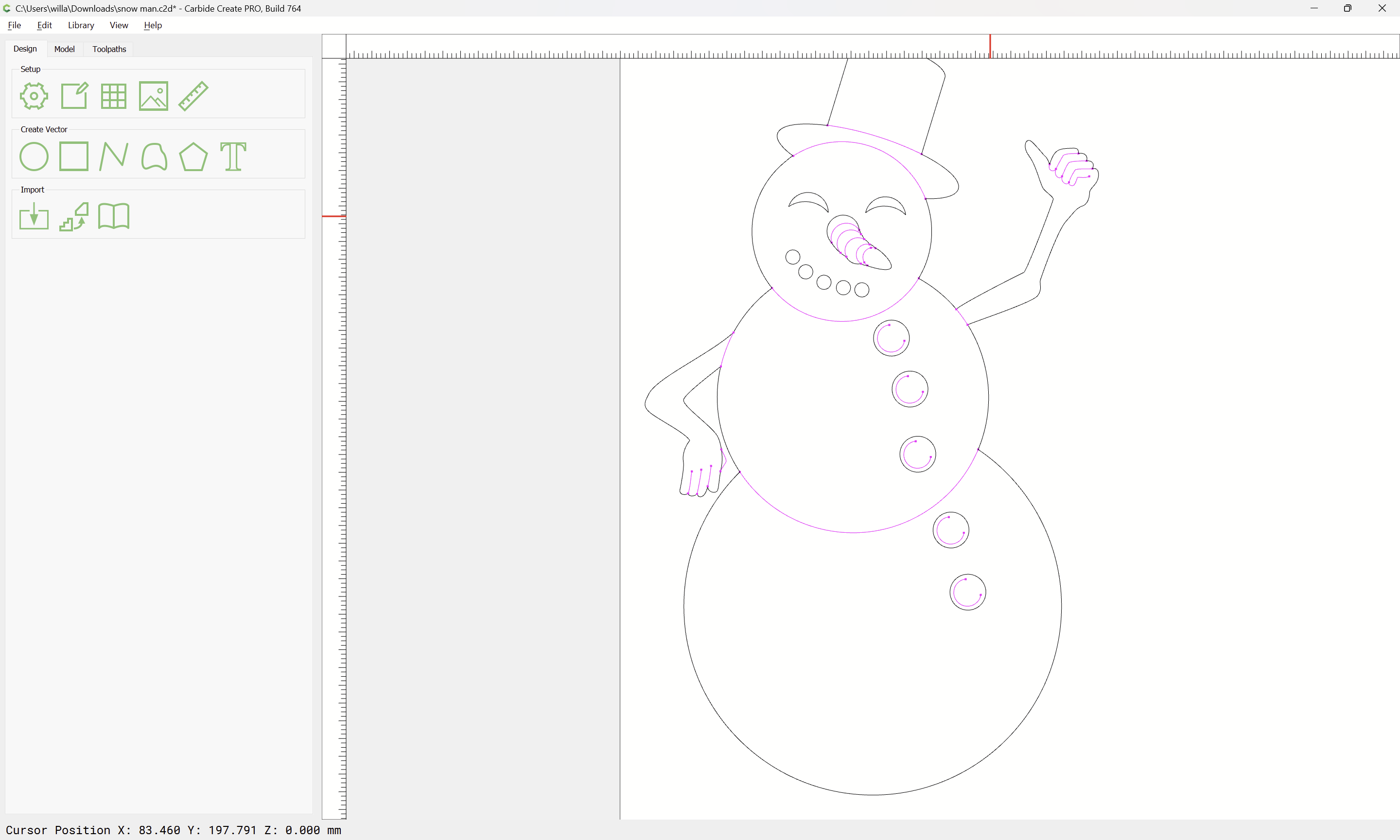

I am very new to using a CNC and i decided it would be better to use files from the Carbide Library.

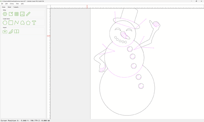

I opened up the Snowman and it has a load of open vectors. Can someone tell me how we close these vectors. I have tried everything i can think of.
snow man.c2d (84 KB)
I have found this on a few other files in the Carbide Library, i would have assumed these would be good files. Is it something i am doing wrong.
Thanks

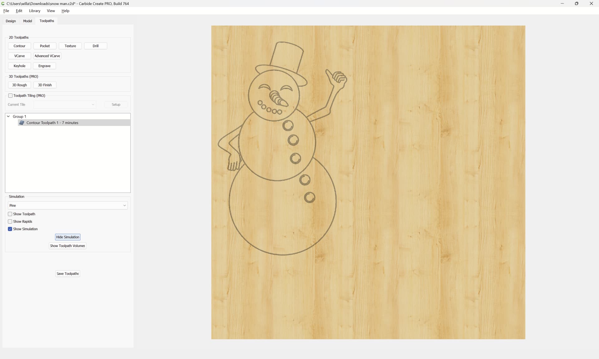

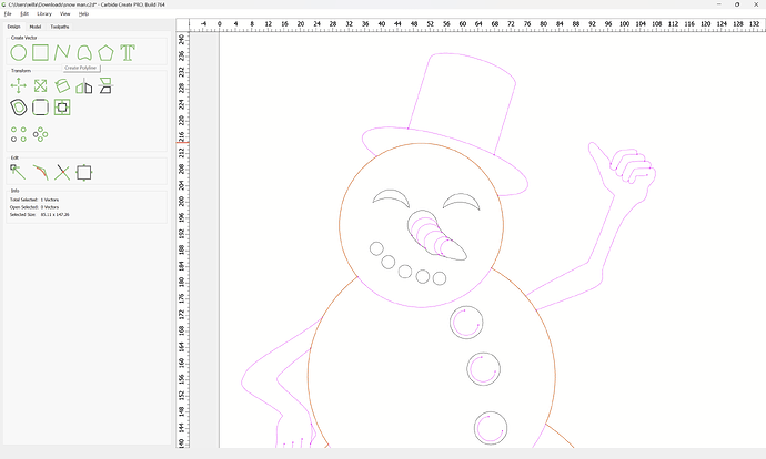

The design is fine for decorative use using No Offset Contour toolpaths:
Setting it up to be an outline suited for cutting out or for V carving would require a bit of duplication and so forth…

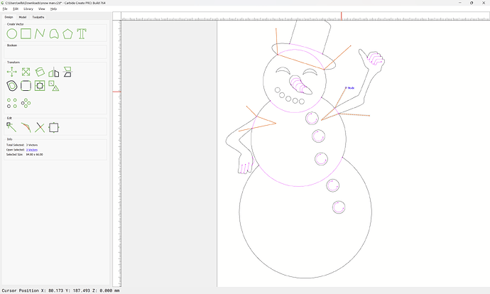

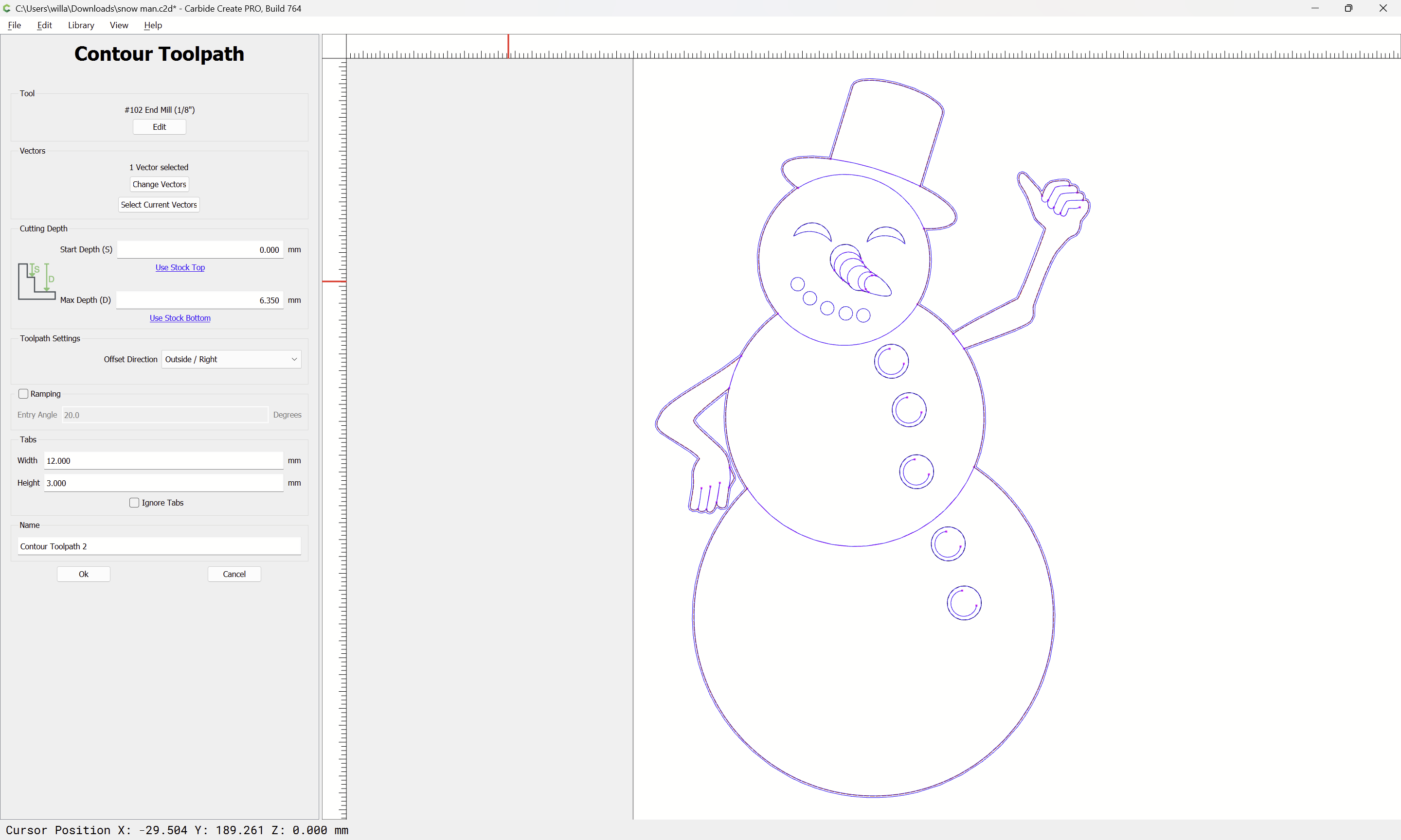

Hello Will

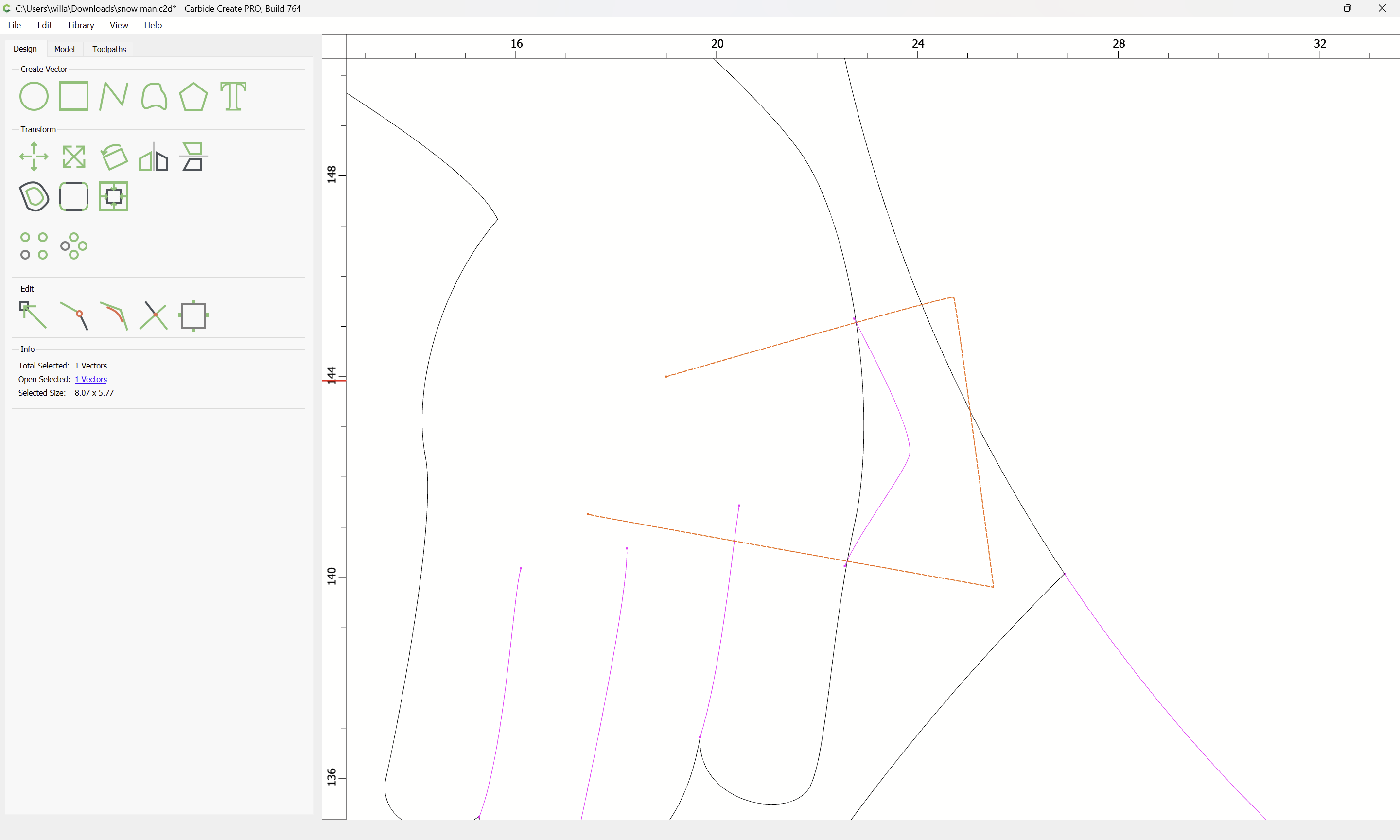

As i am begineer how do i do this. When i attempt to do a V carve i get alot of blue lines around the middle of the snow man. Thanks again

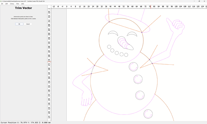

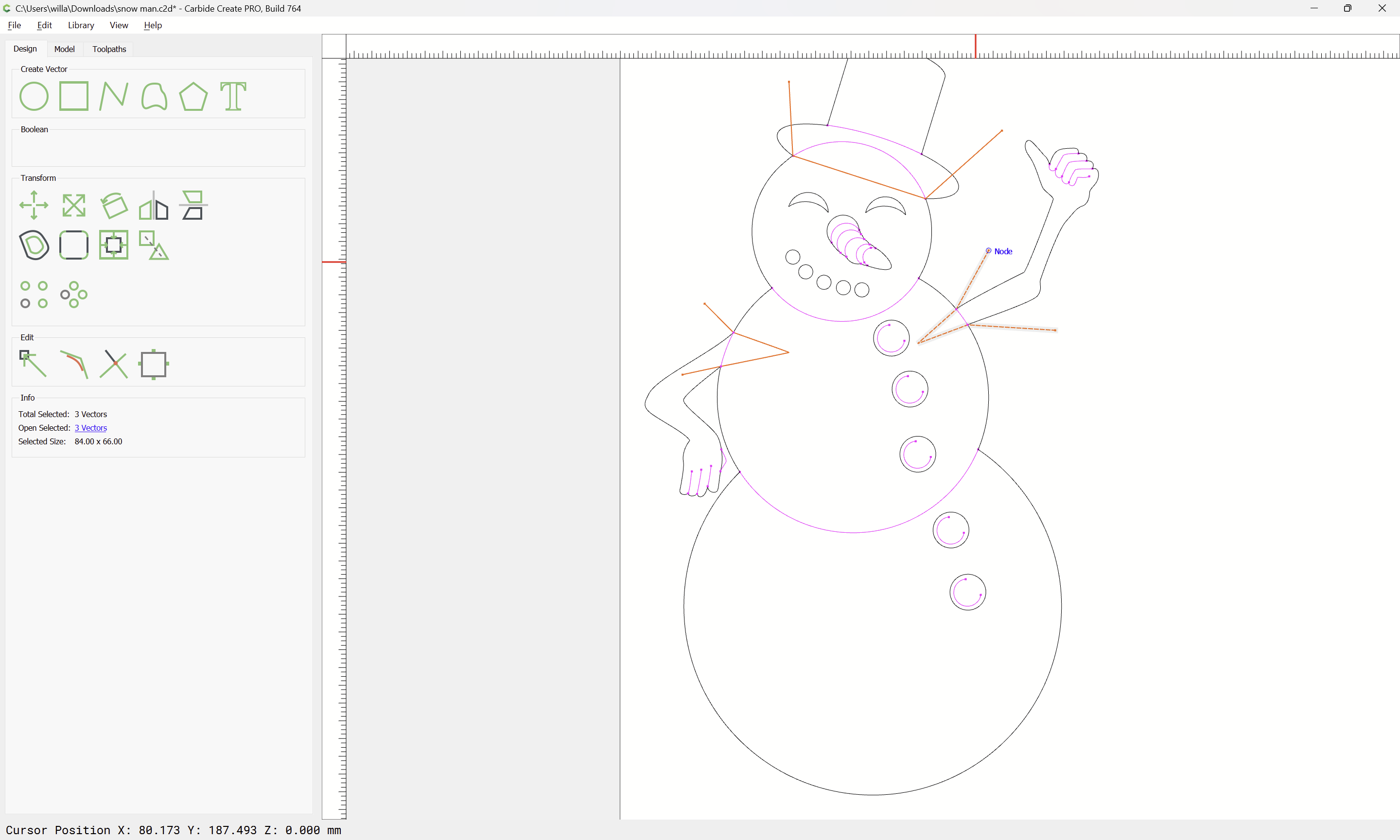

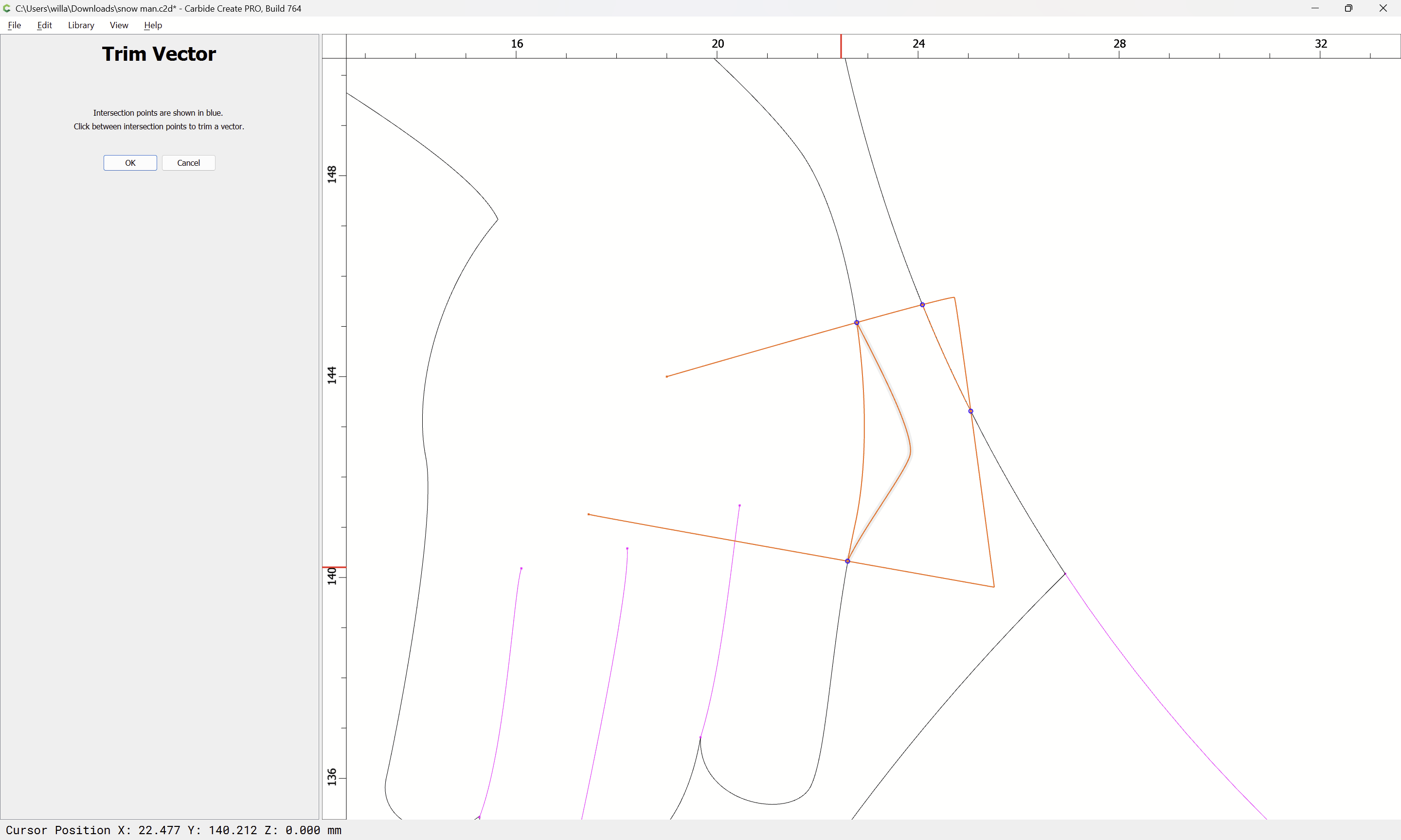

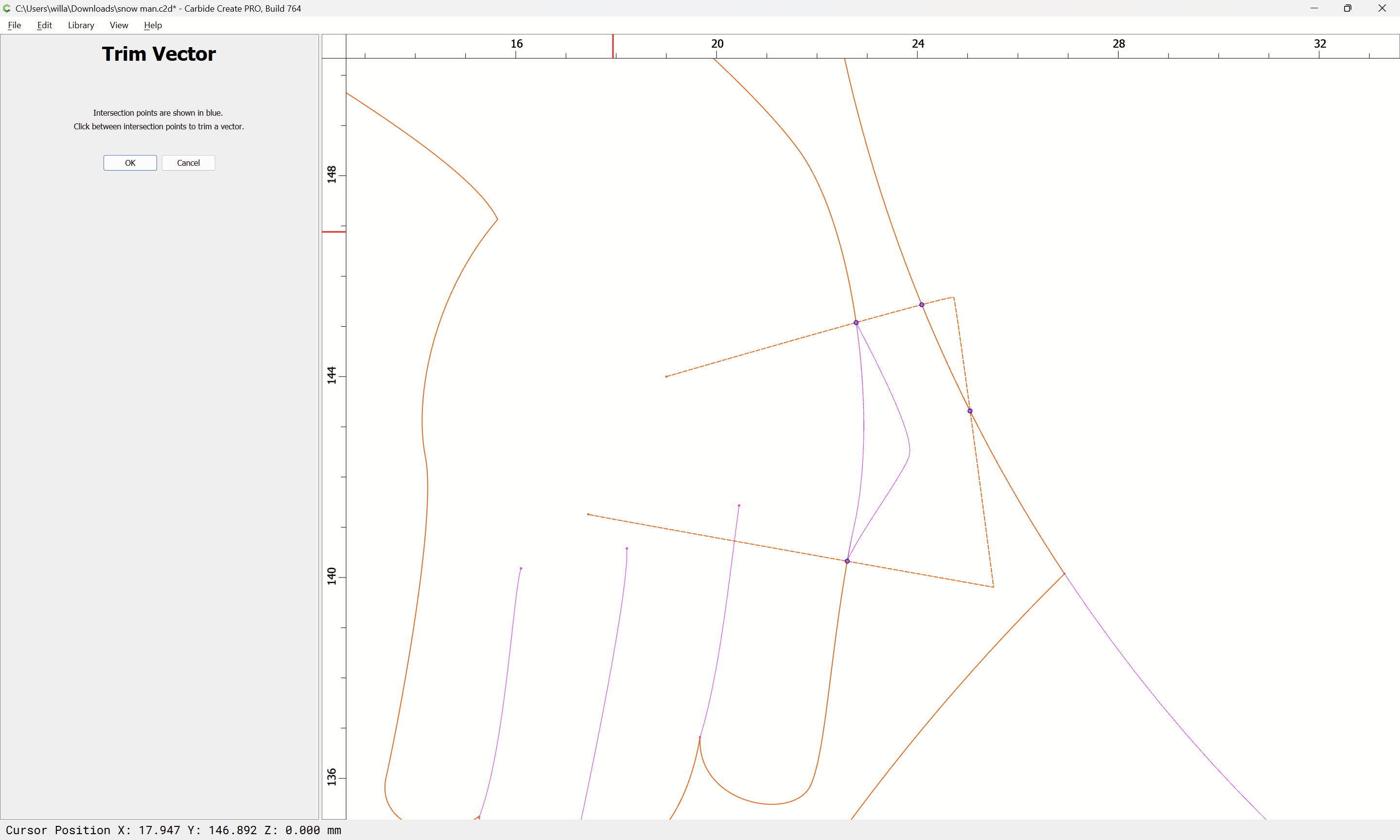

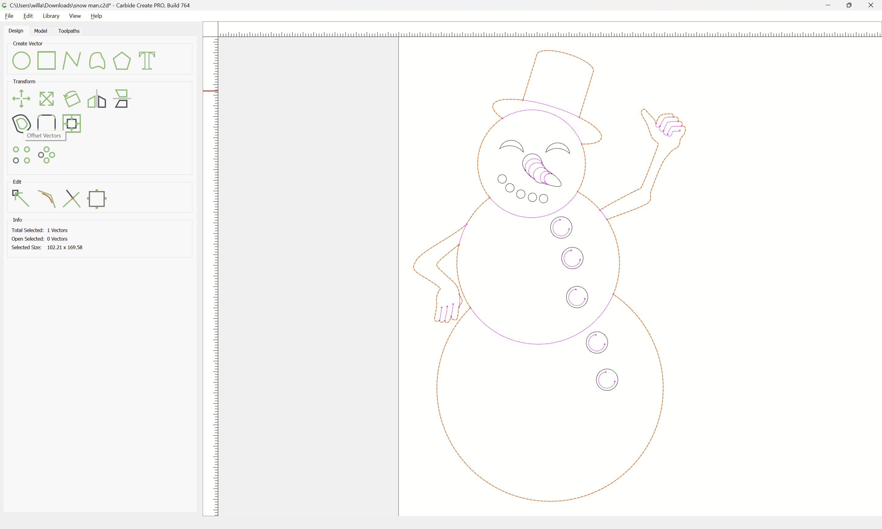

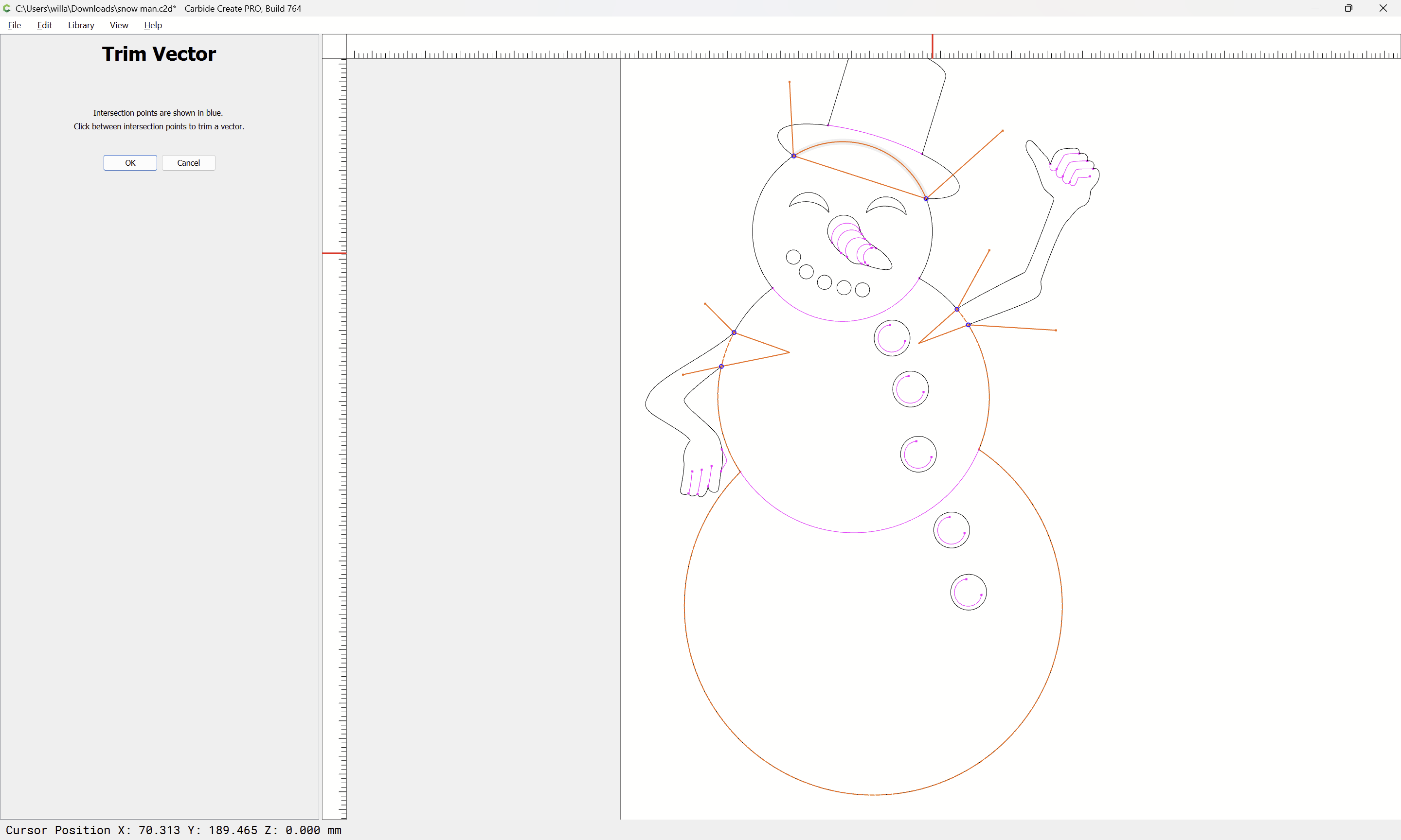

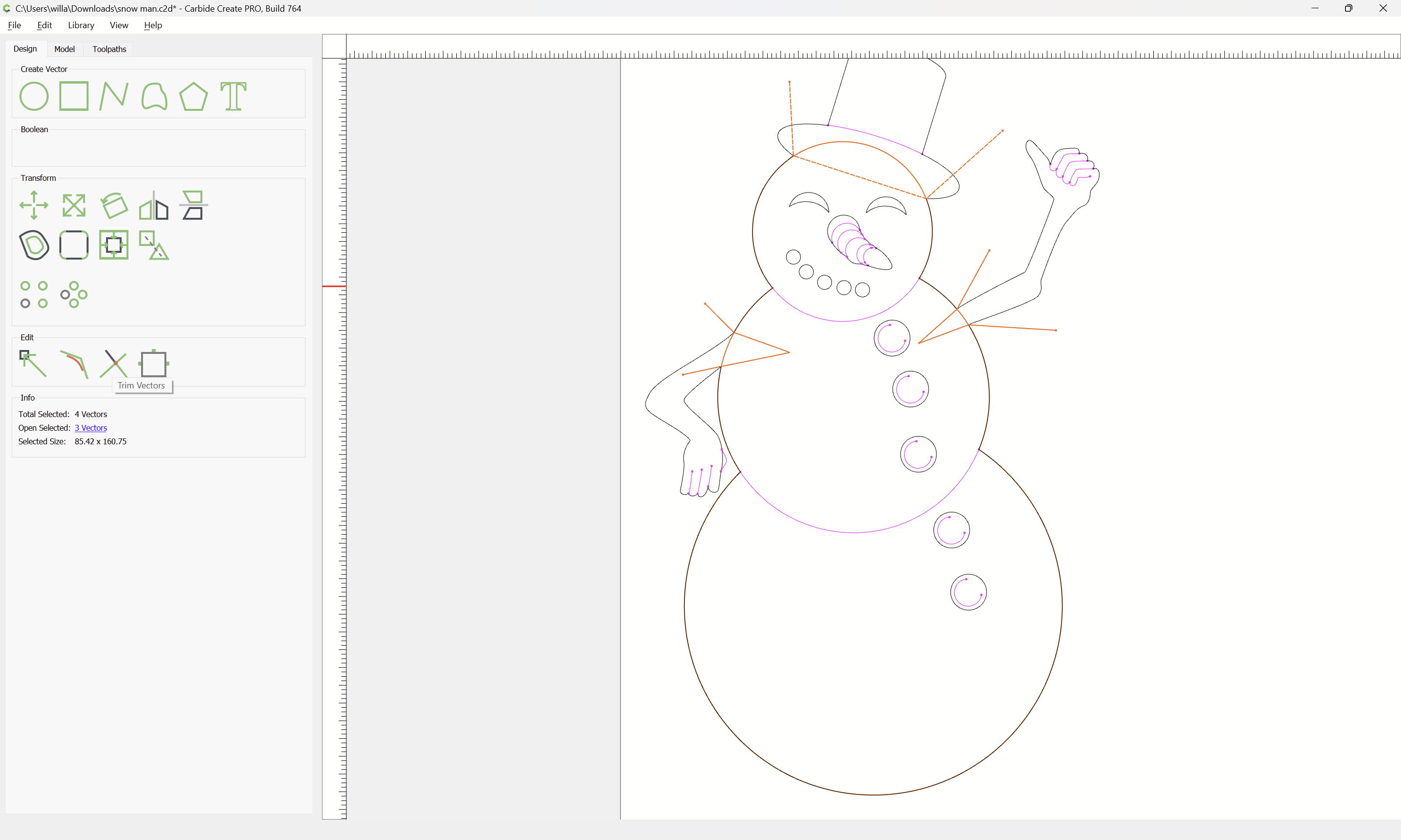

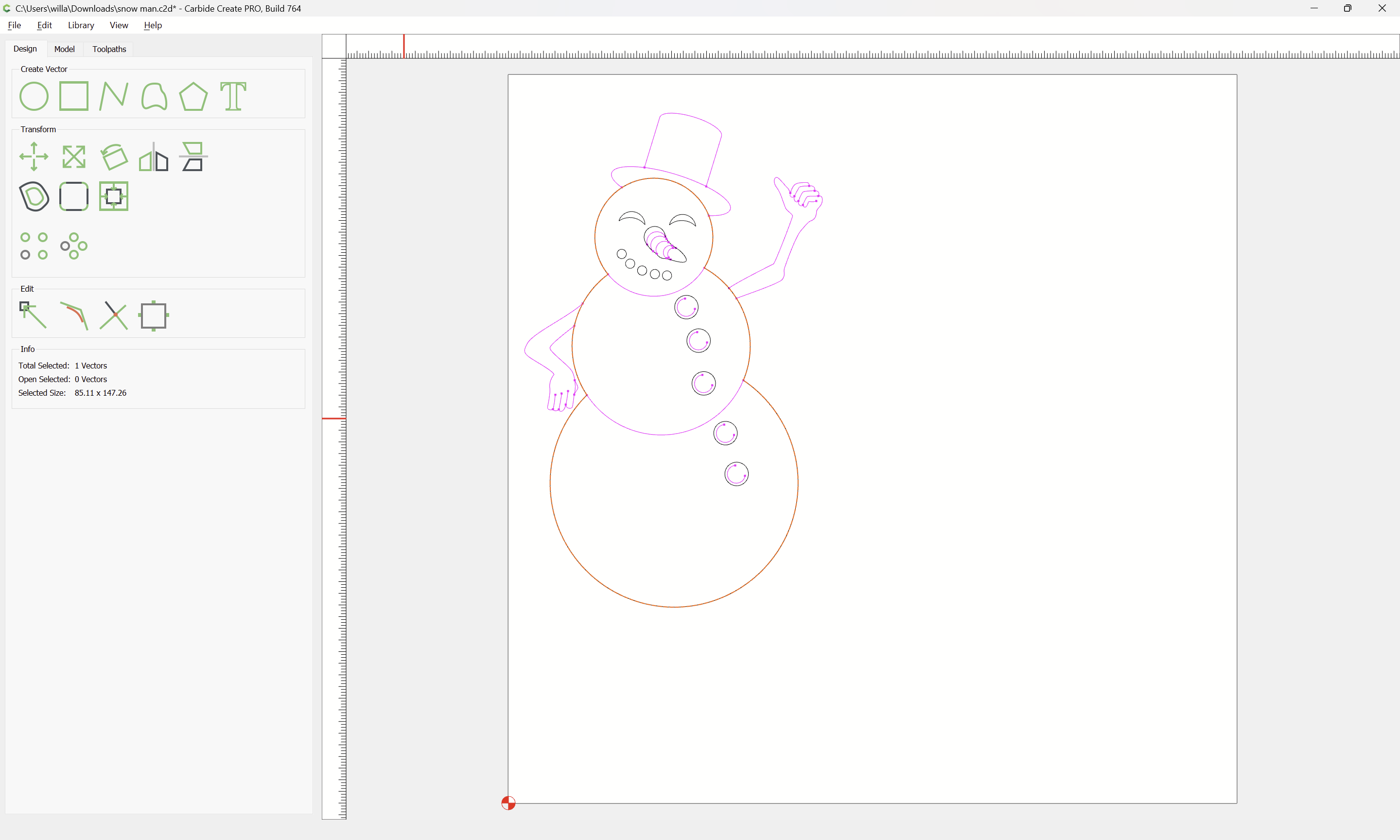

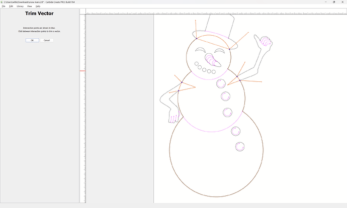

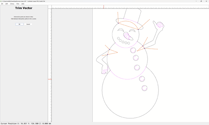

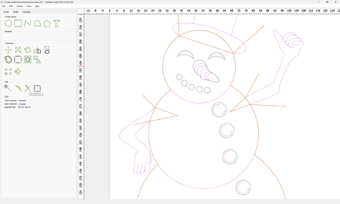

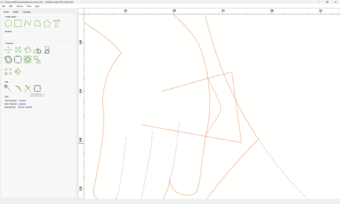

Select the closed geometry and duplicate it:

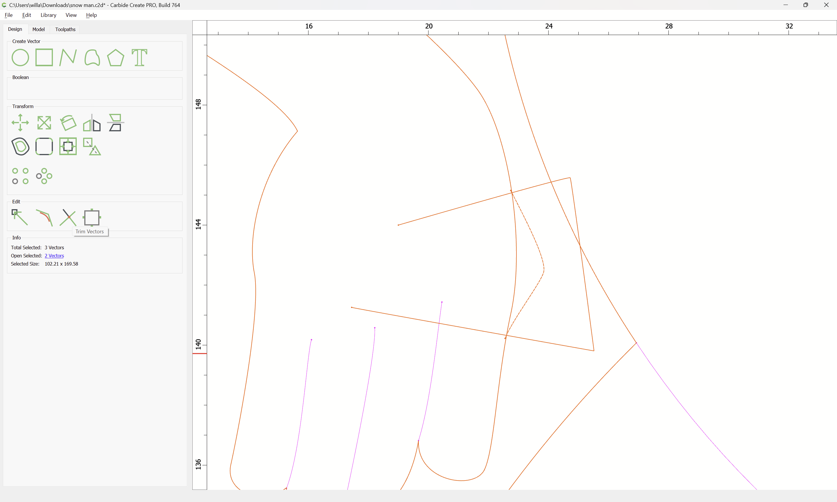

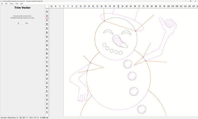

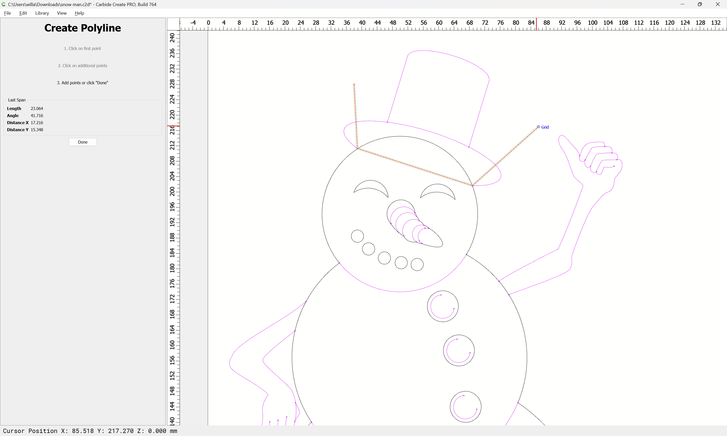

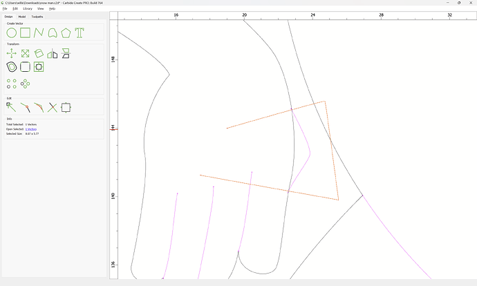

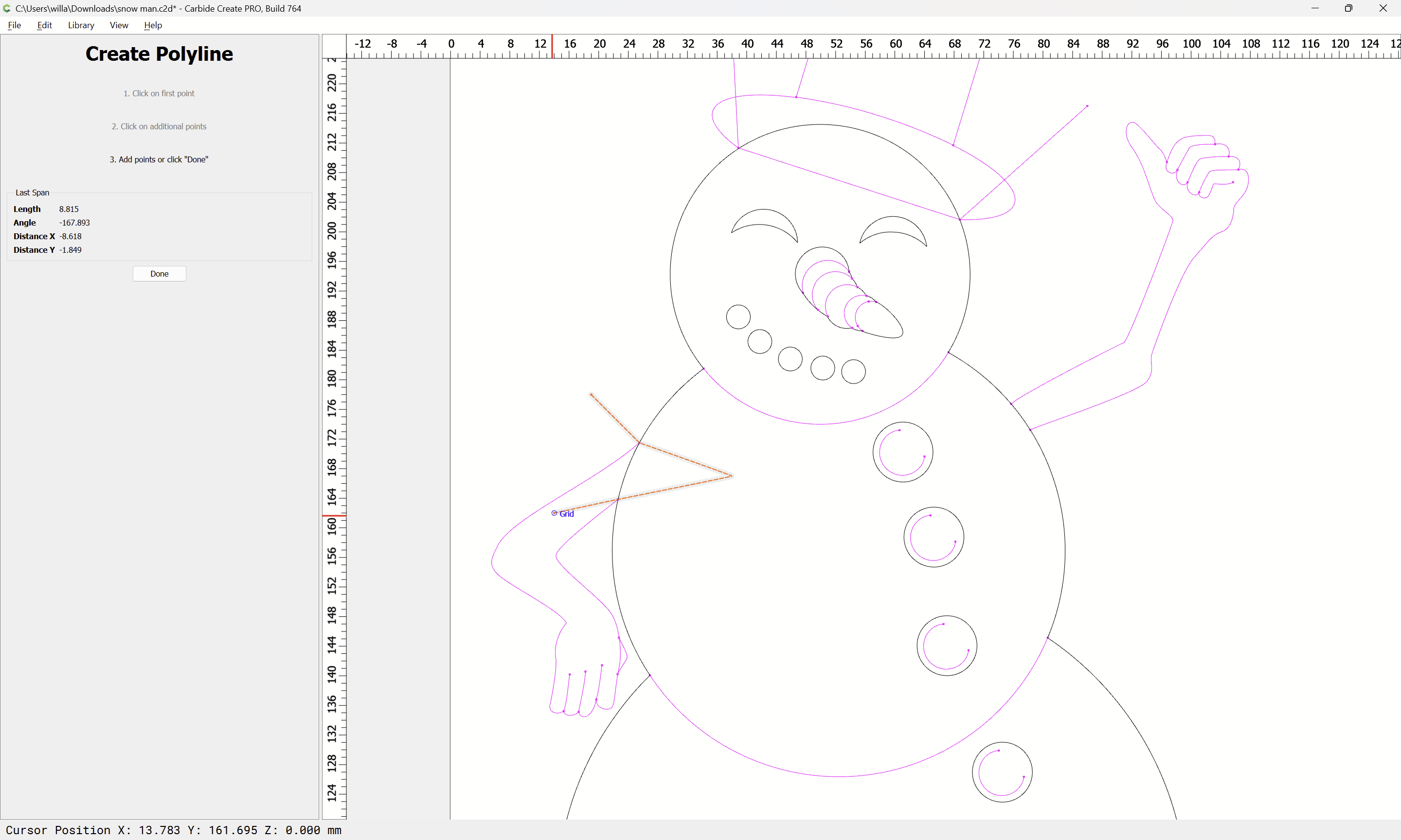

Zoom in draw in geometry which will define where the geometry must be cut:

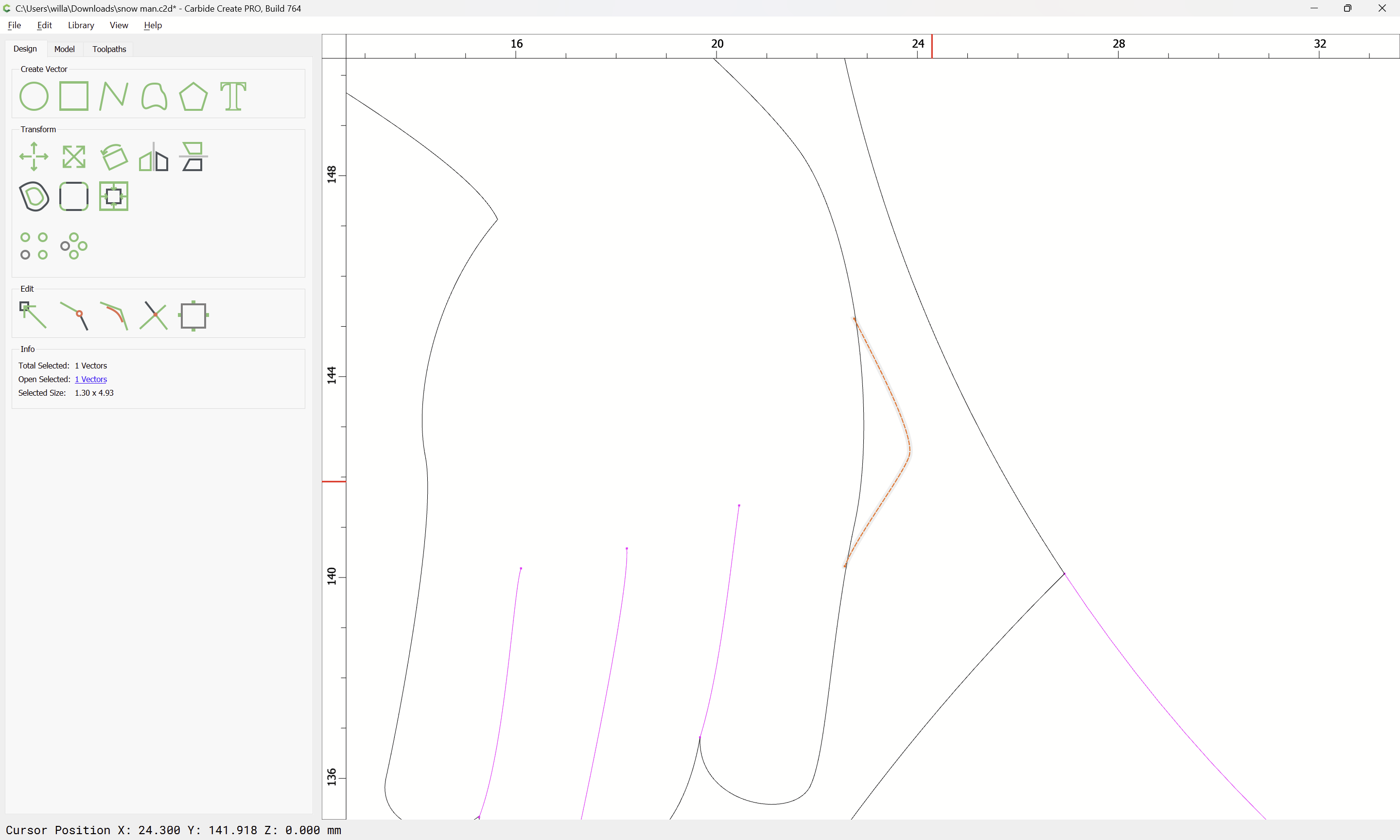

Select the geometry:

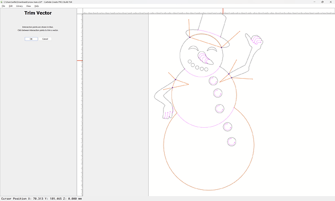

and use Trim Vectors:
OK

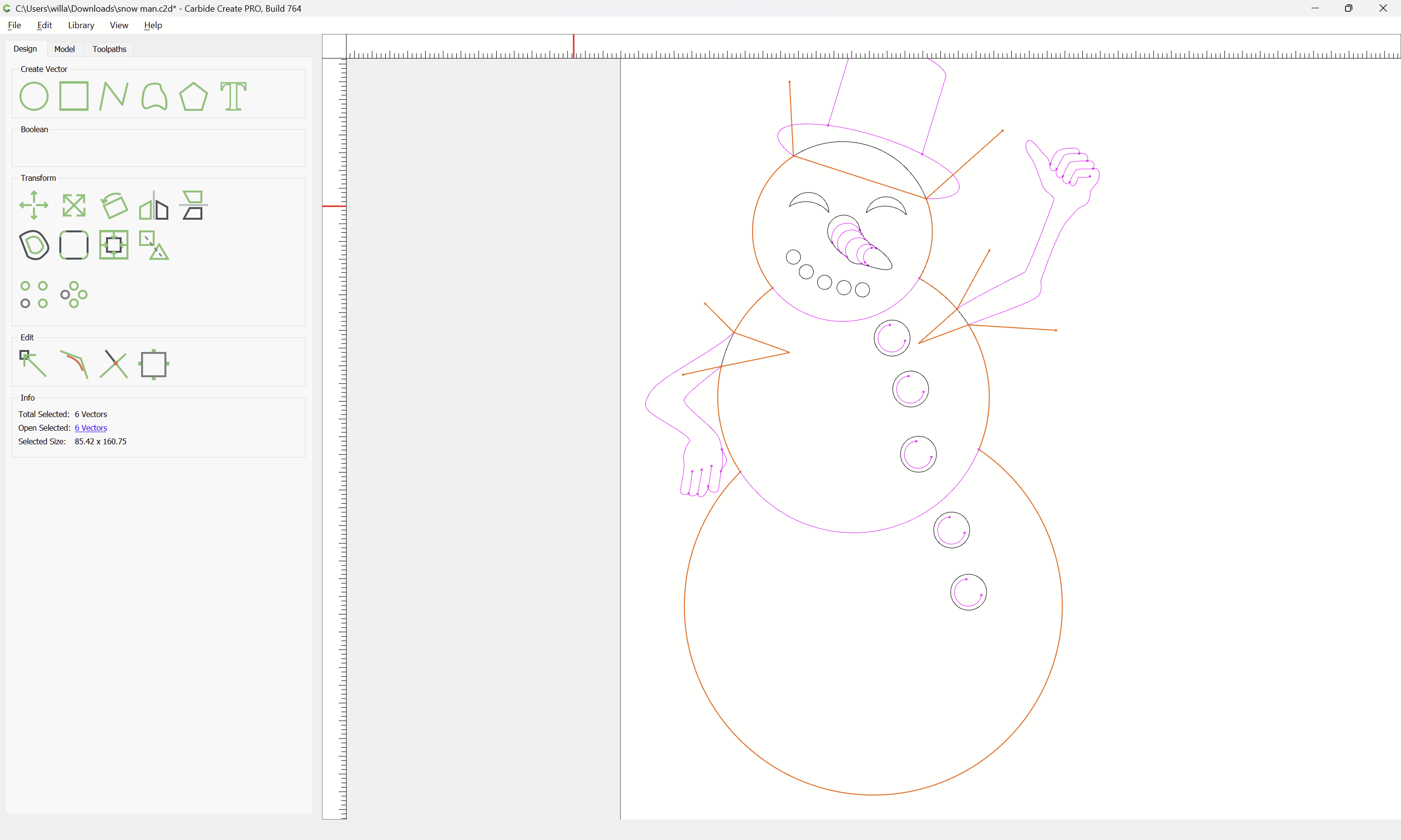

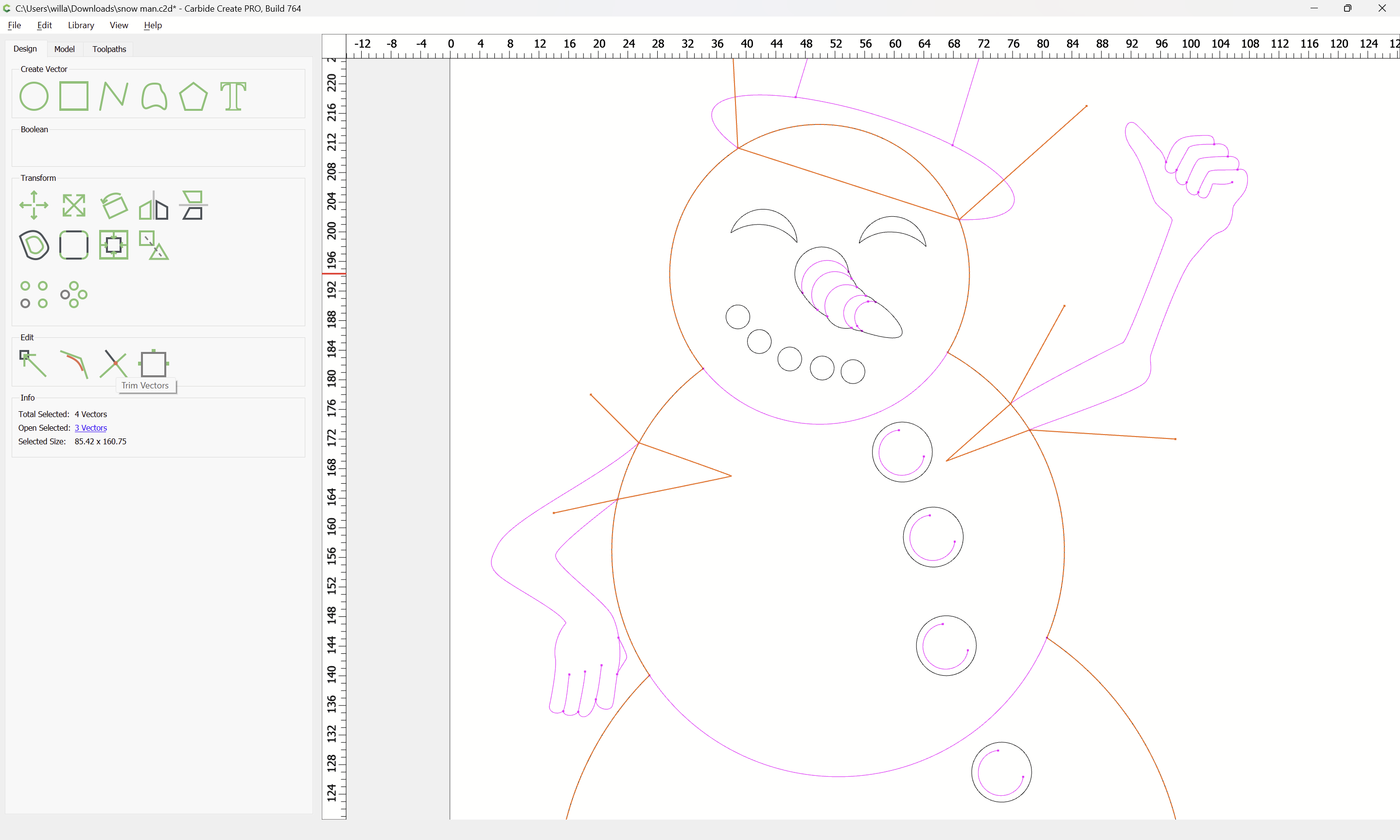

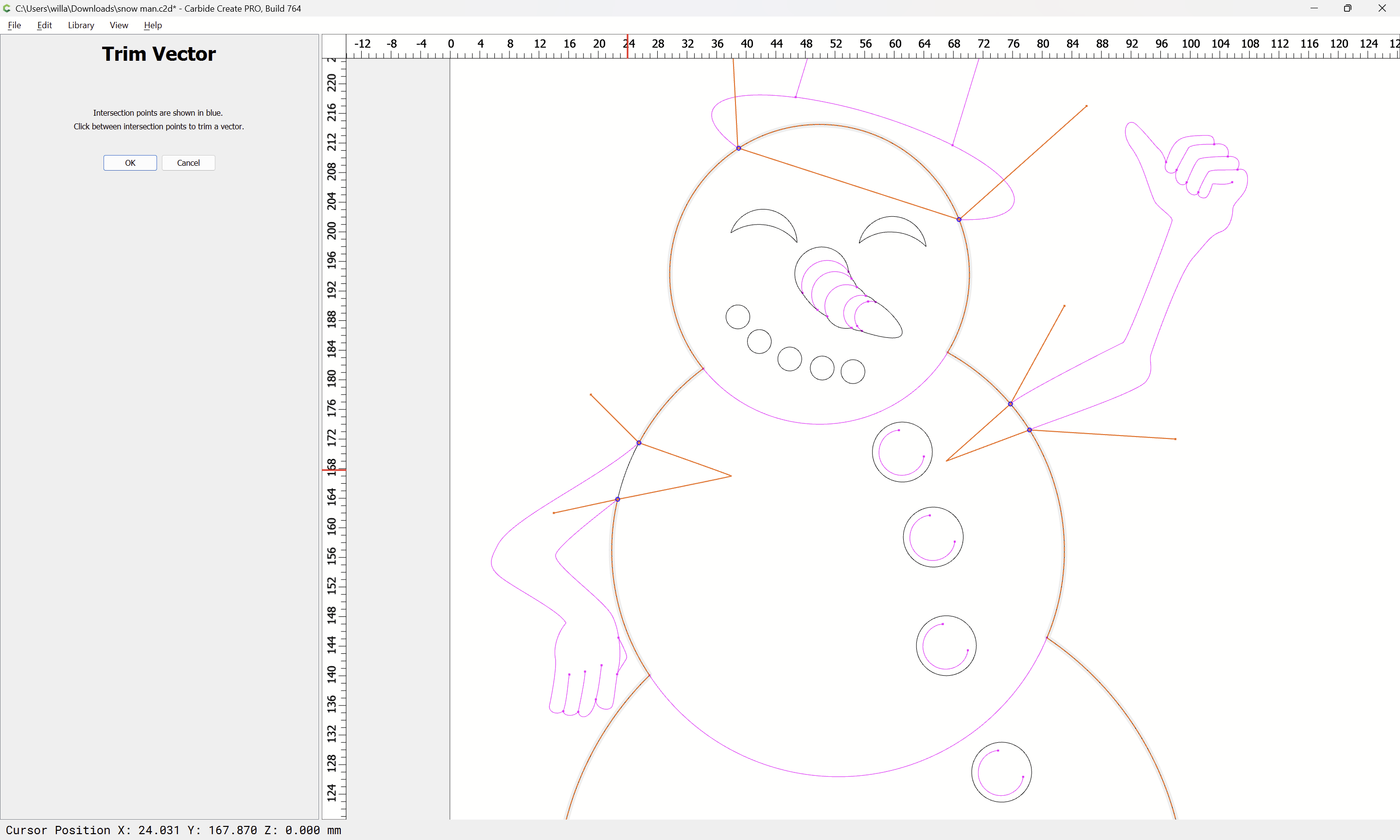

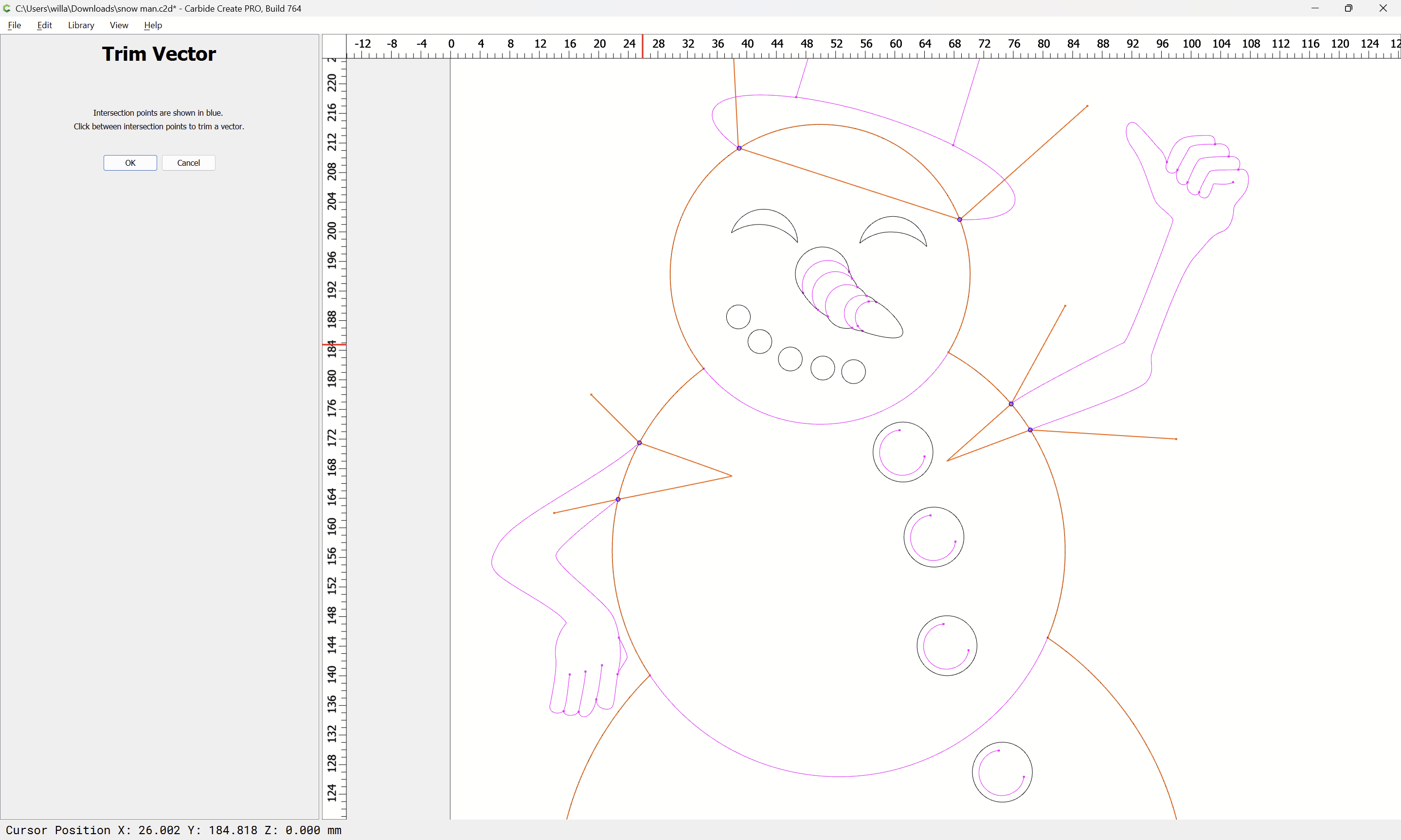

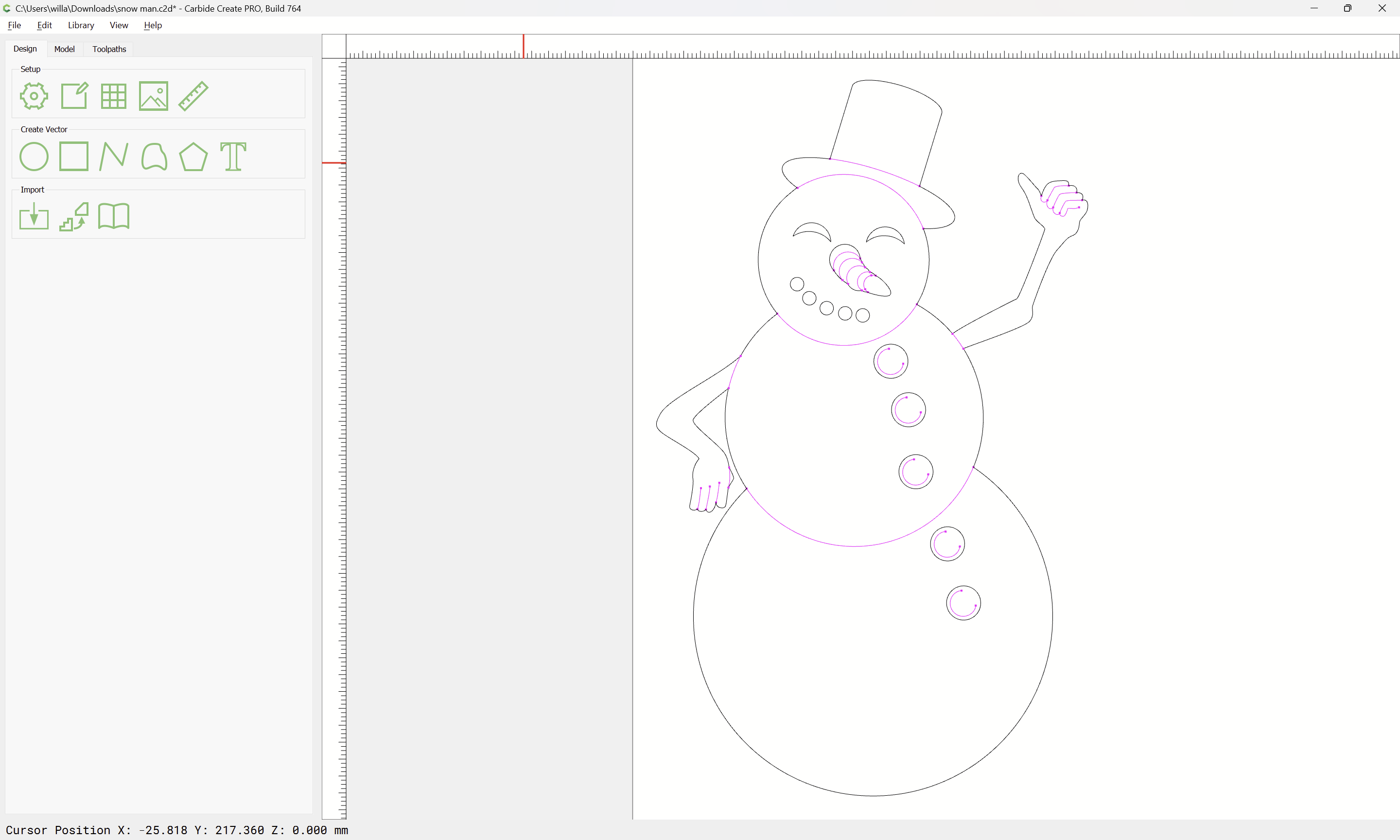

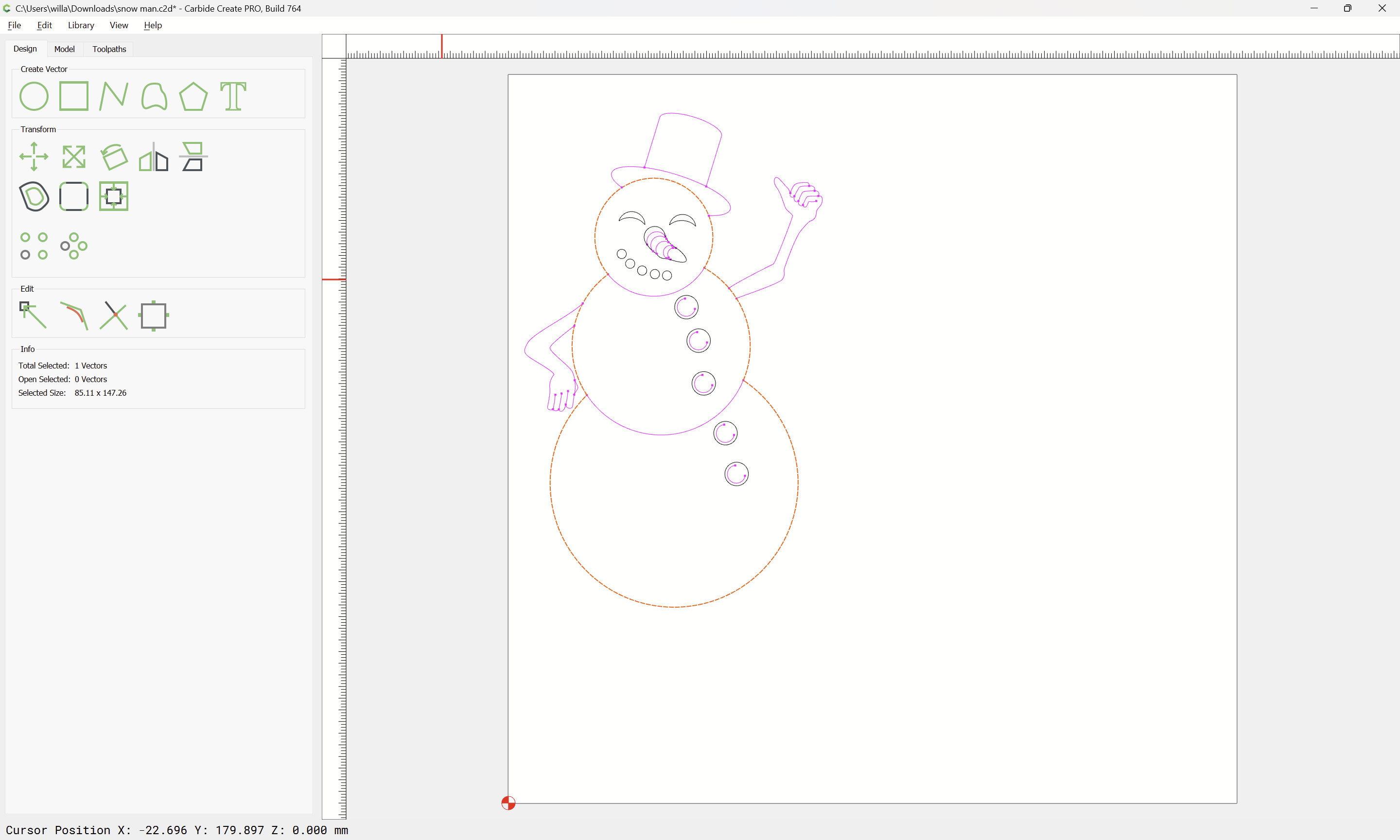

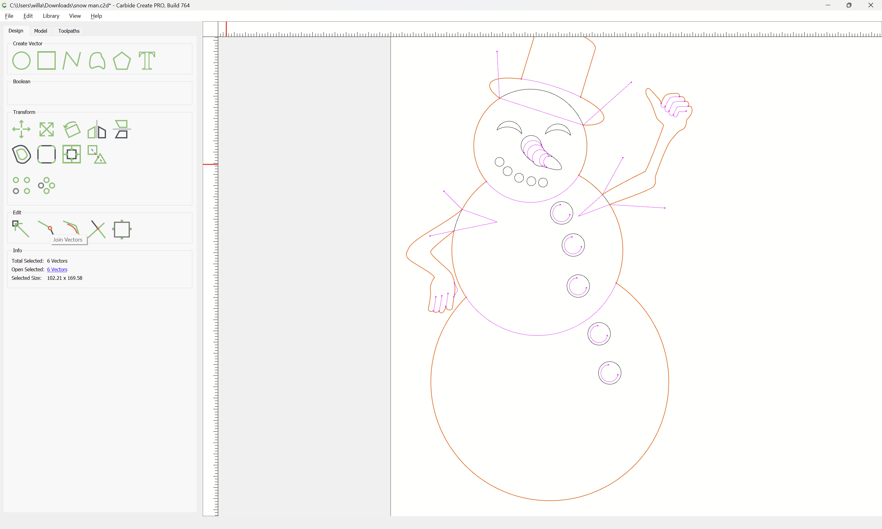

Select the geometry which defines the outline:
Yes

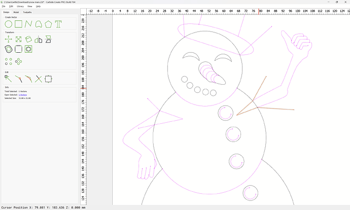

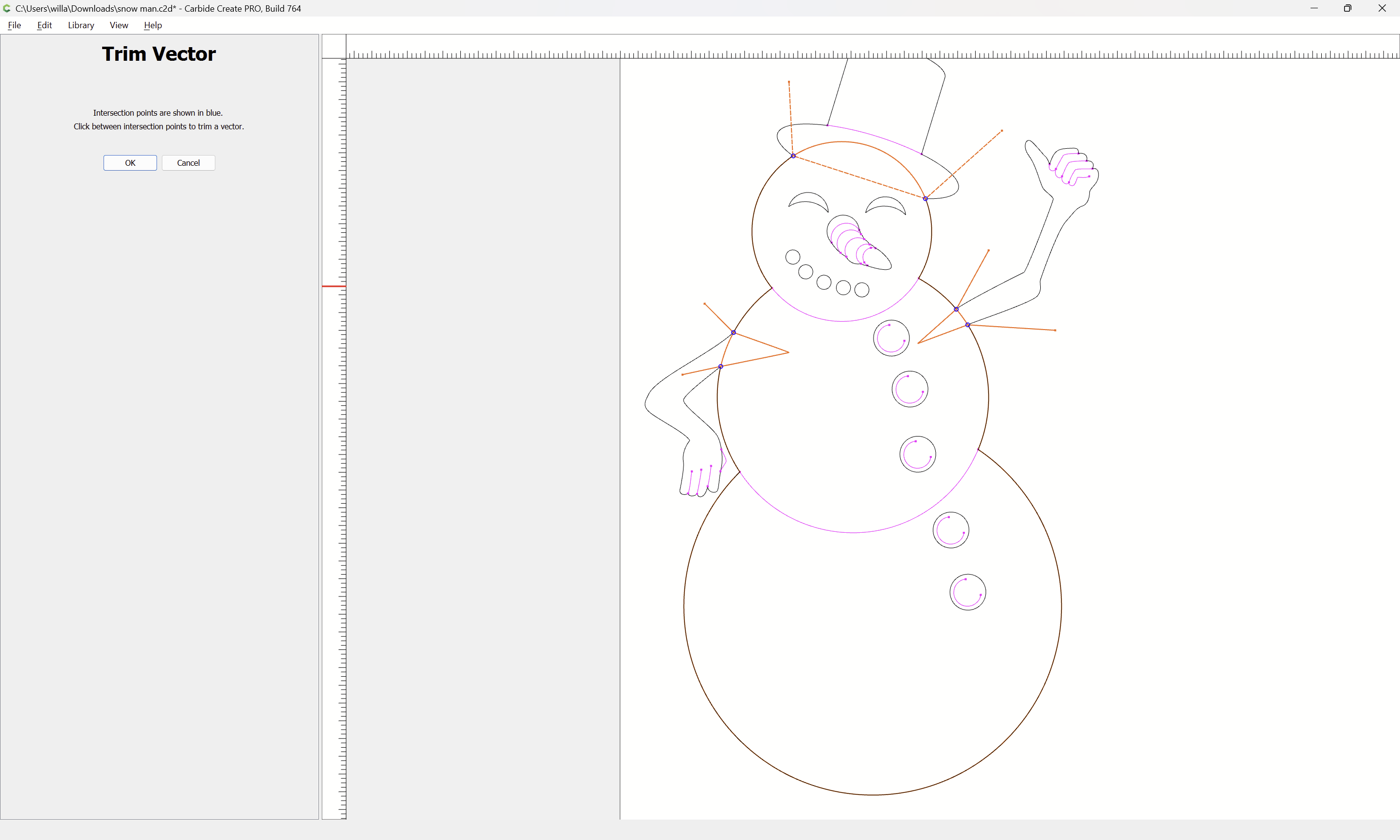

Then do the opposite to preserve the lines for the design:
OK

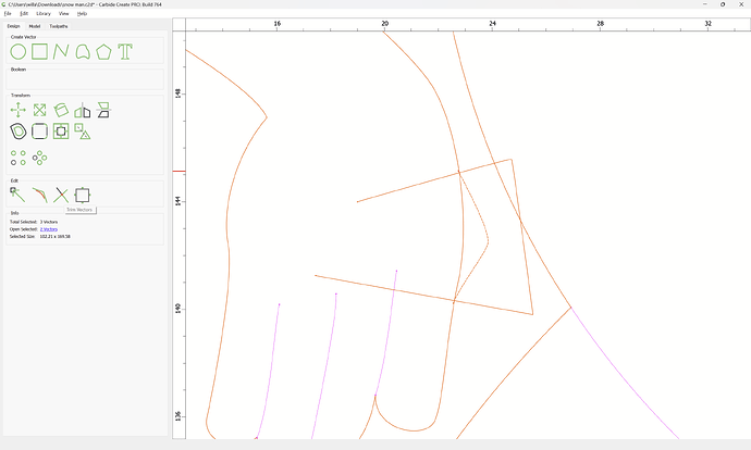

Select and delete the geometry which is no longer needed:

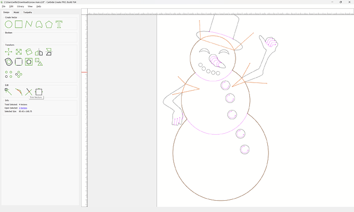

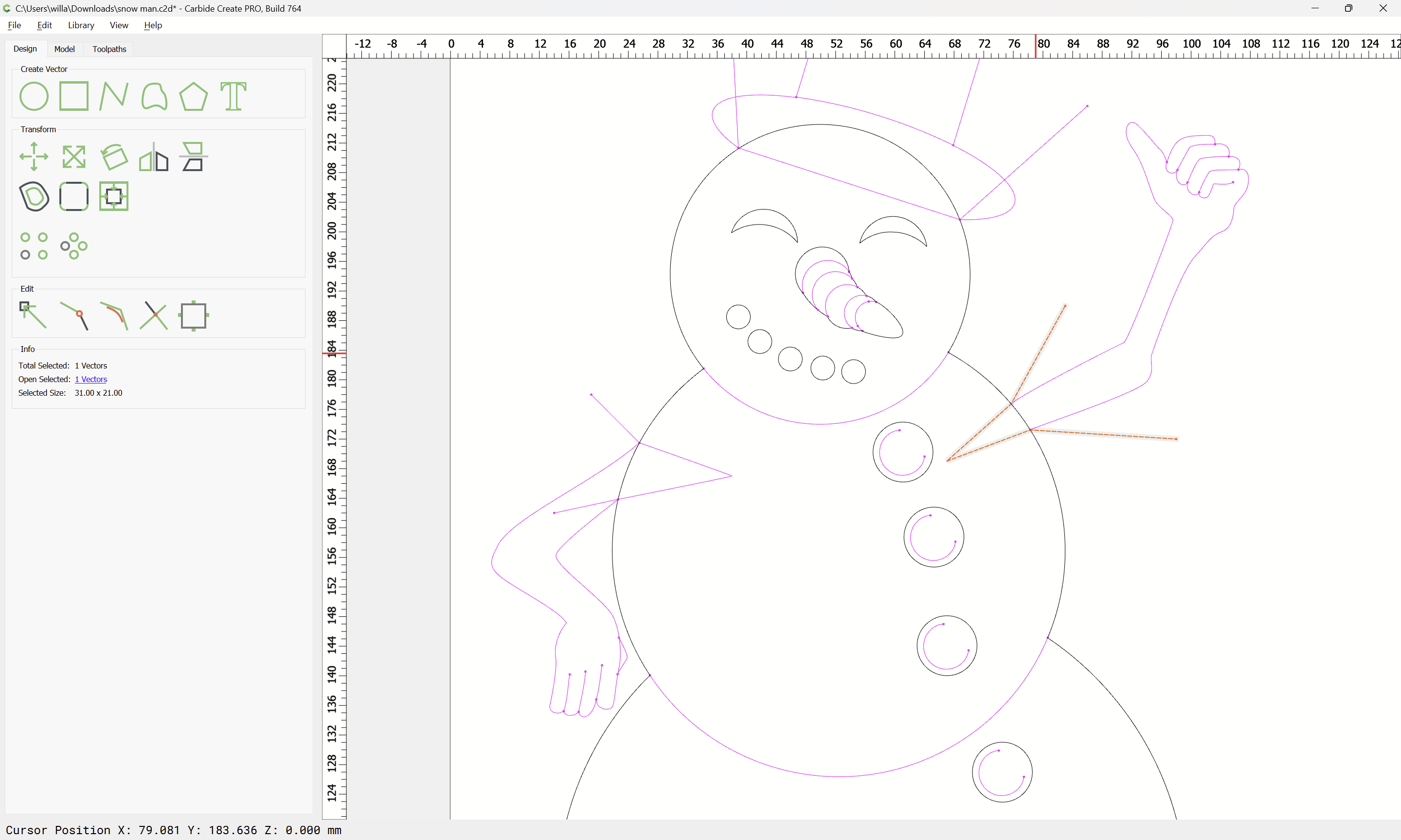

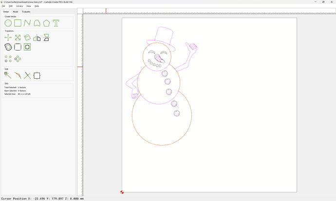

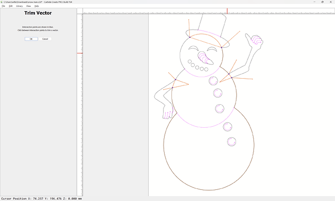

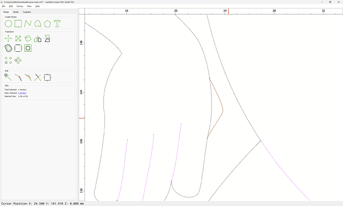

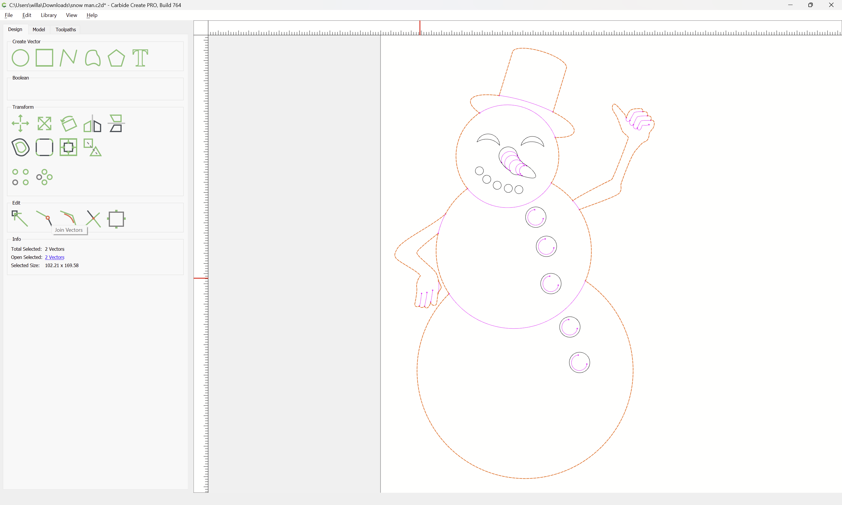

If a region was missed:
repeat the process:
Trim Vectors:
If need be, duplicating geometry and repeating:

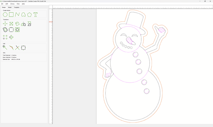

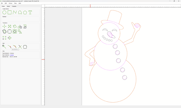

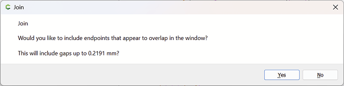

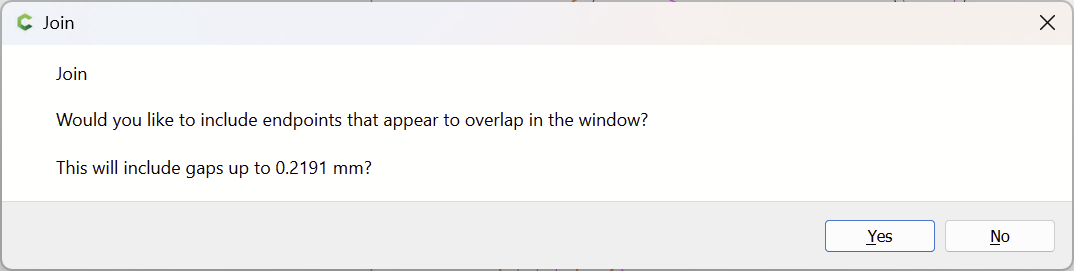

and Join Vectors:

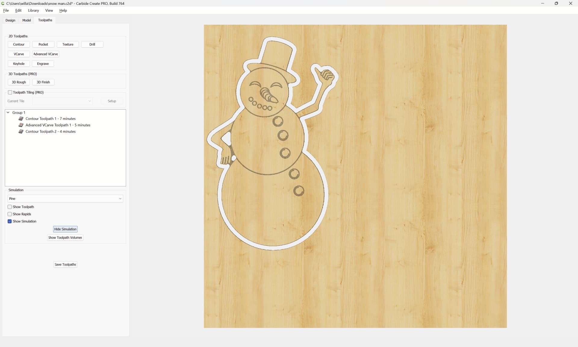

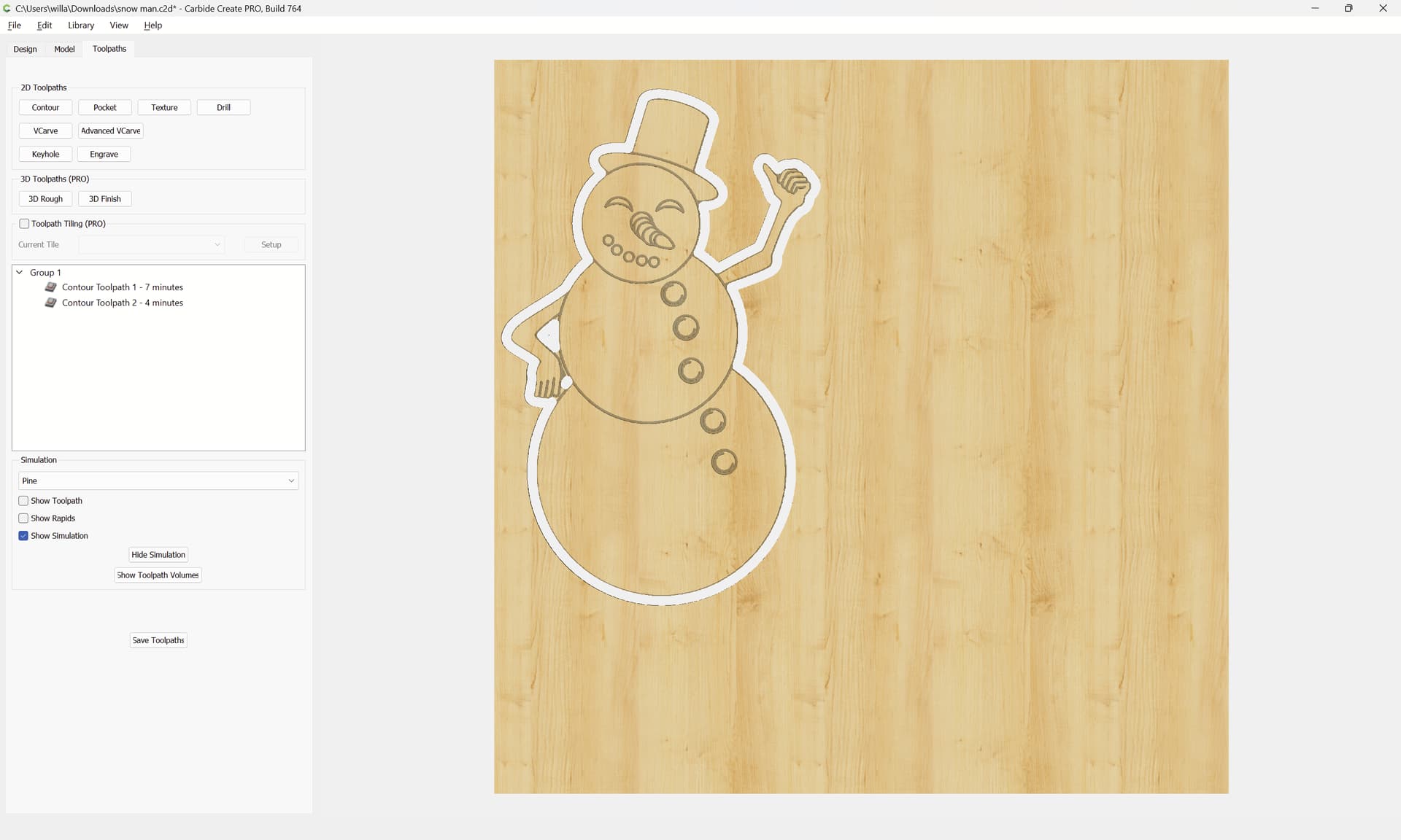

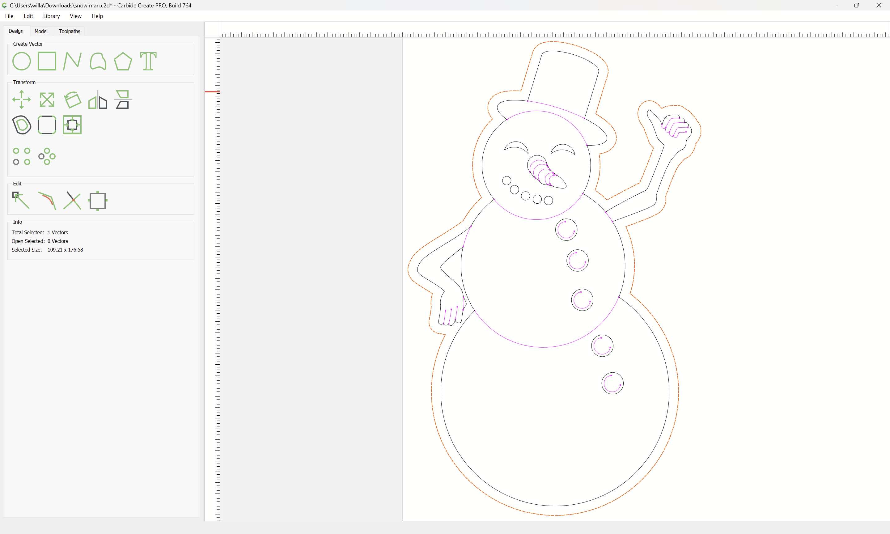

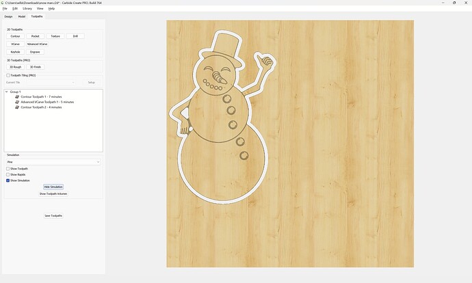

Then cut out:

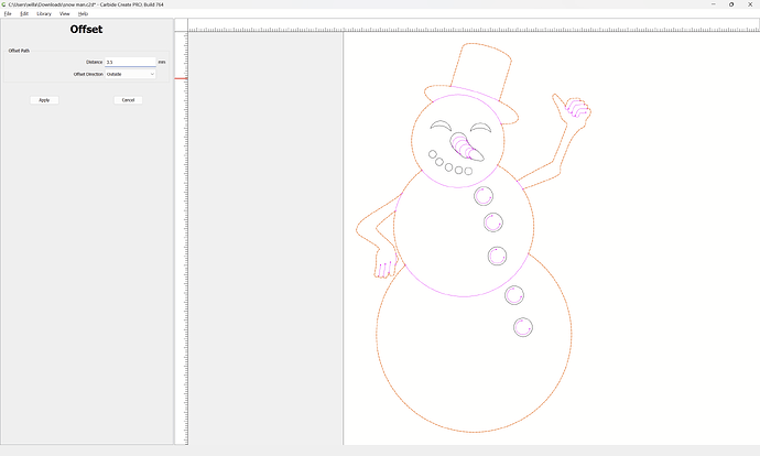

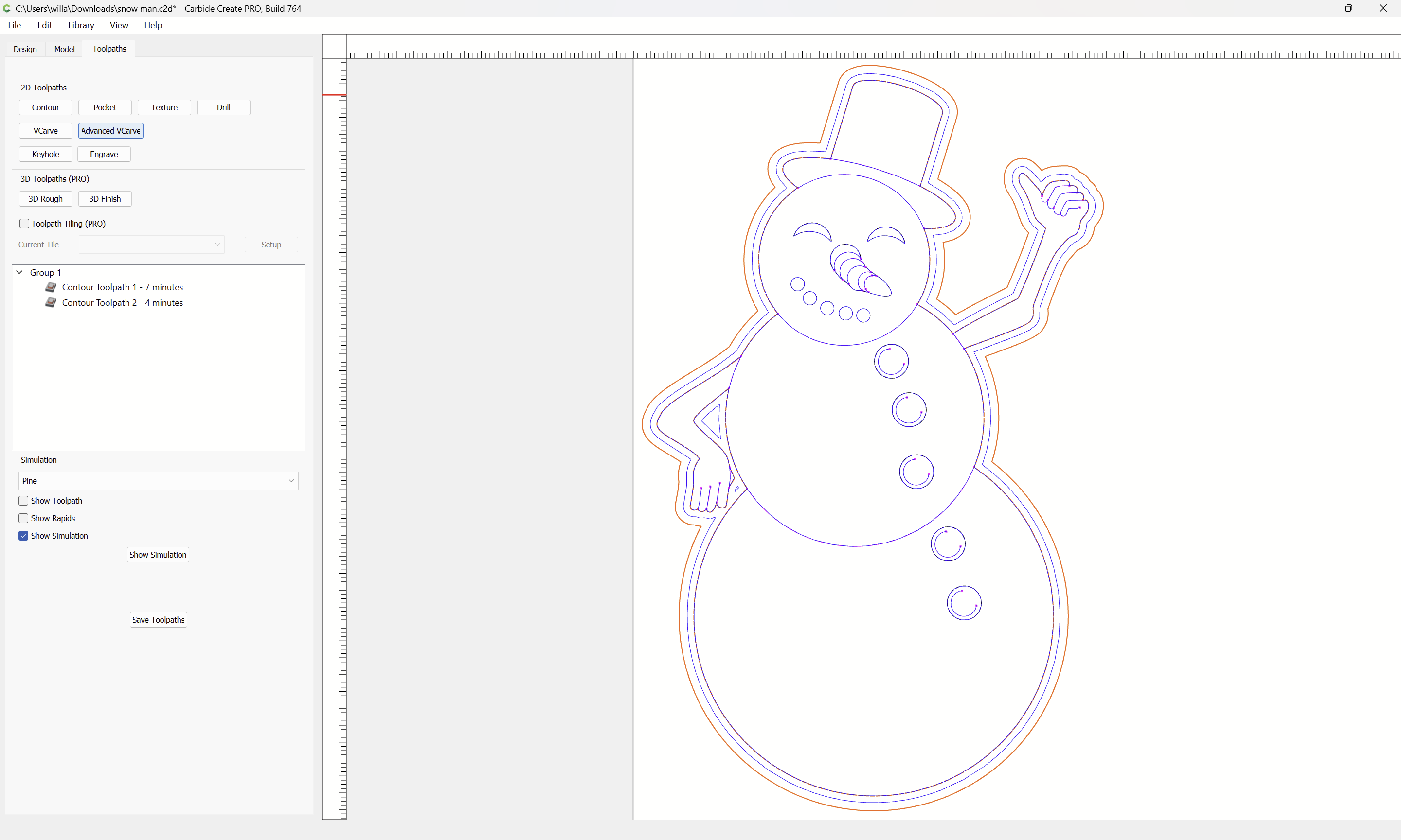

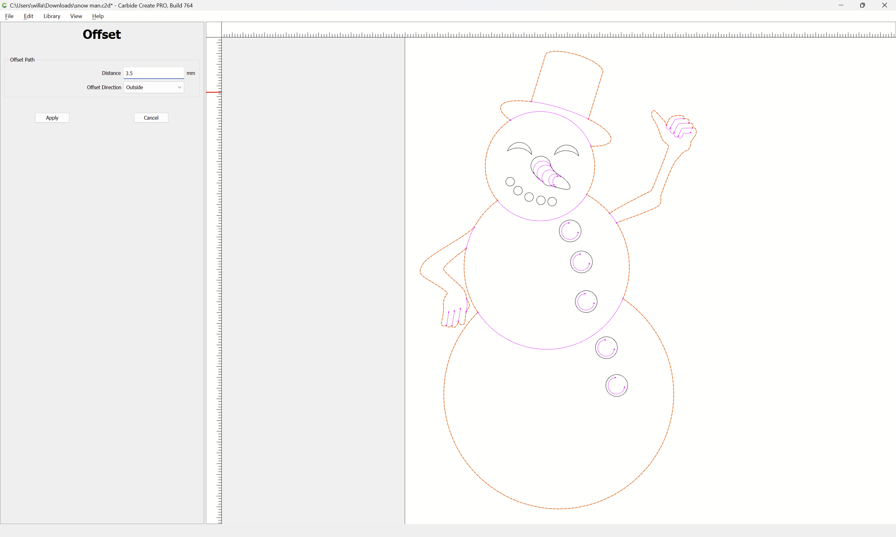

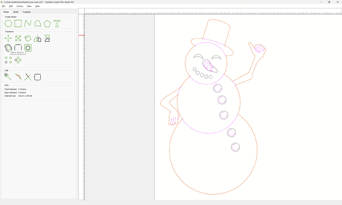

To get better detailing, offset the geometry to the outside by the endmill diameter plus 10%;

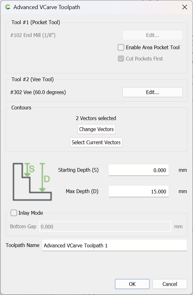

Then do an Advanced V carve:
Attached as a v7 file:
