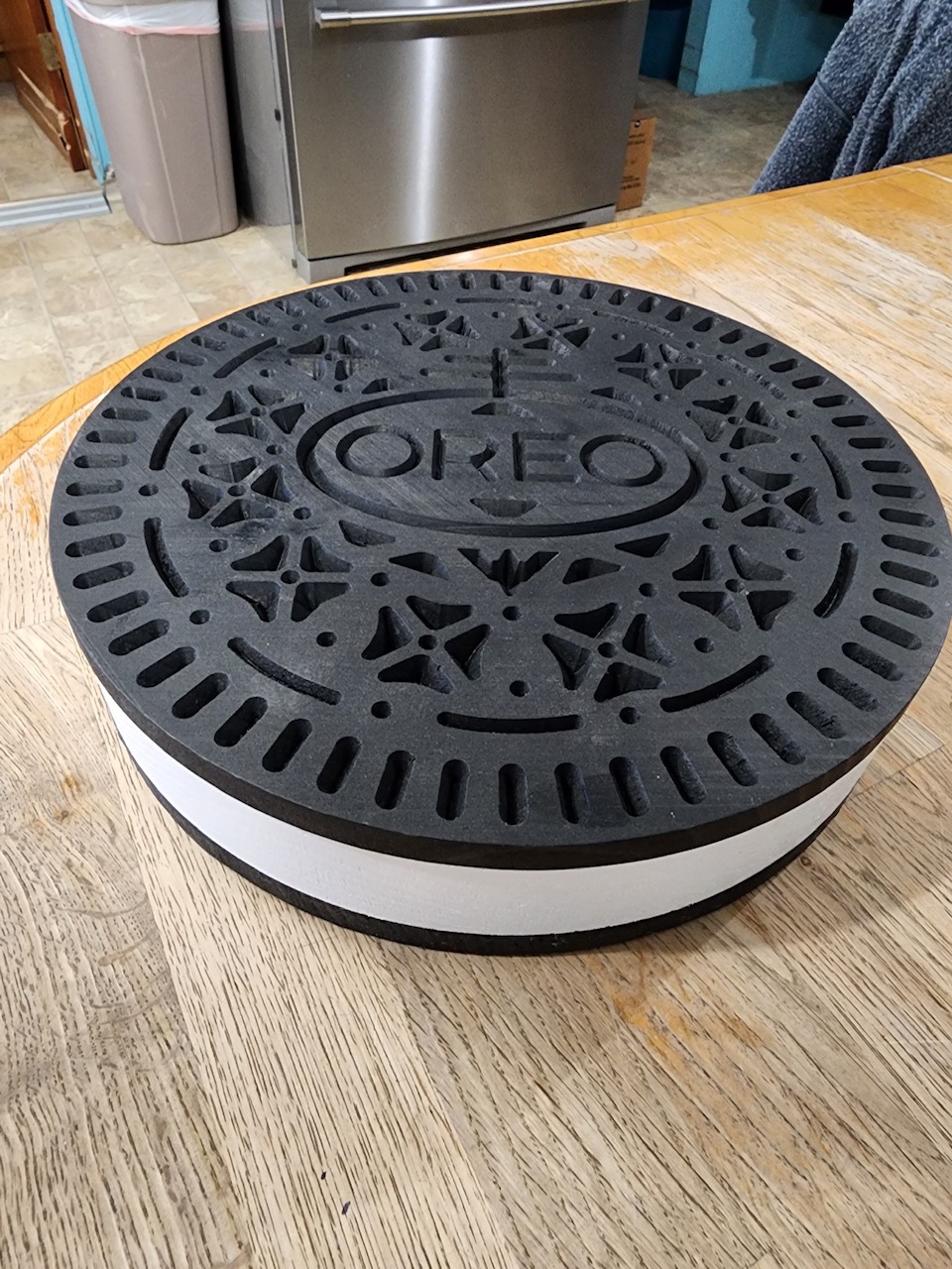

I gave 5 of these as Christmas presents. I made them out of some pine, 1"x12" for the cookies and 2"x12" for the double stuff.

It looks quite large, but I don’t see any dimensions other than you made it out of 12” material.
So, how did you get it to look black without showing the wood grain?
Looks great!
Pic with the lid off?
