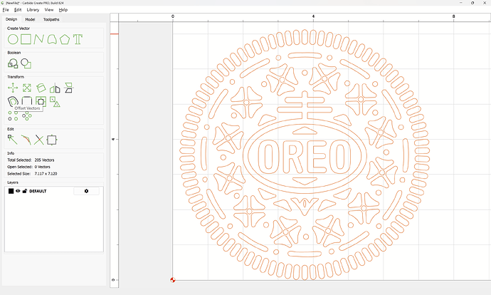

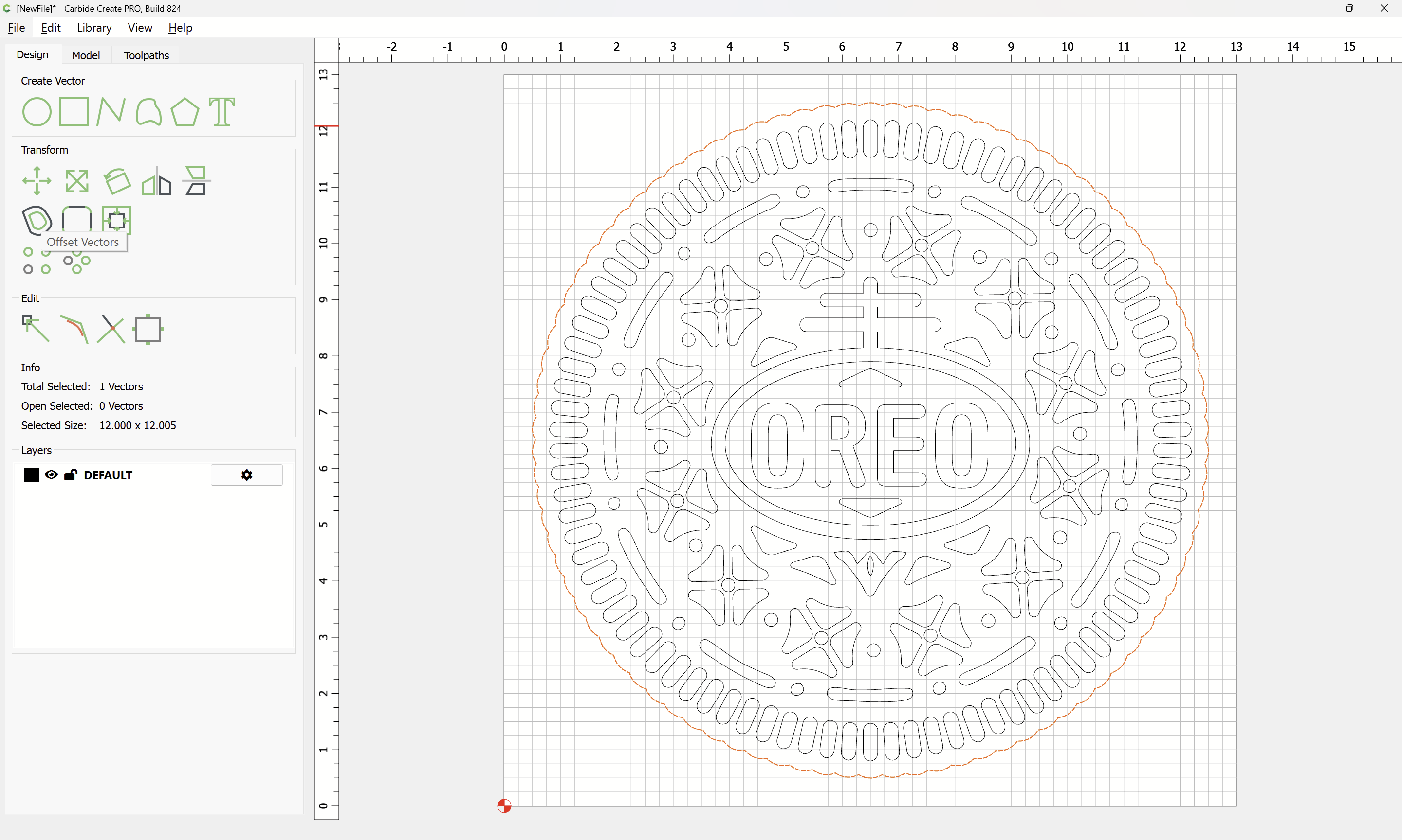

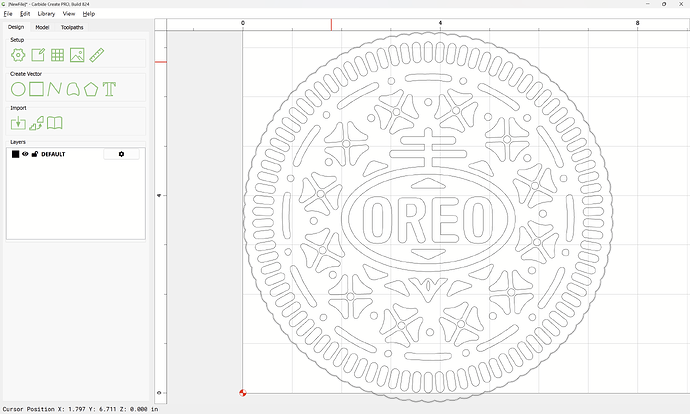

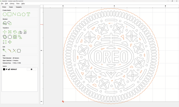

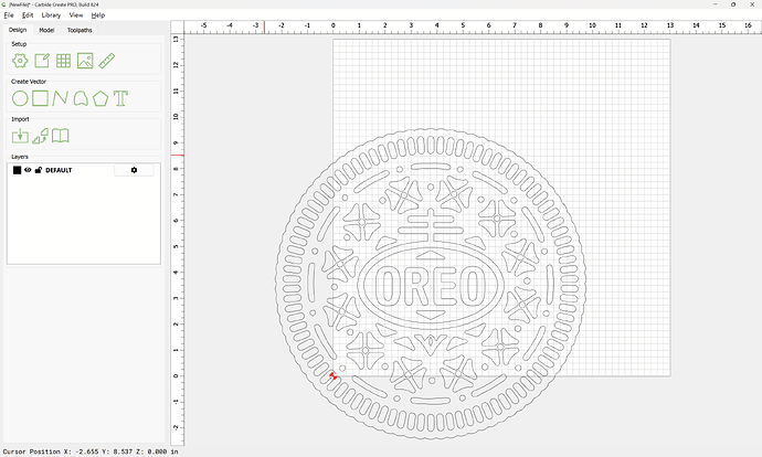

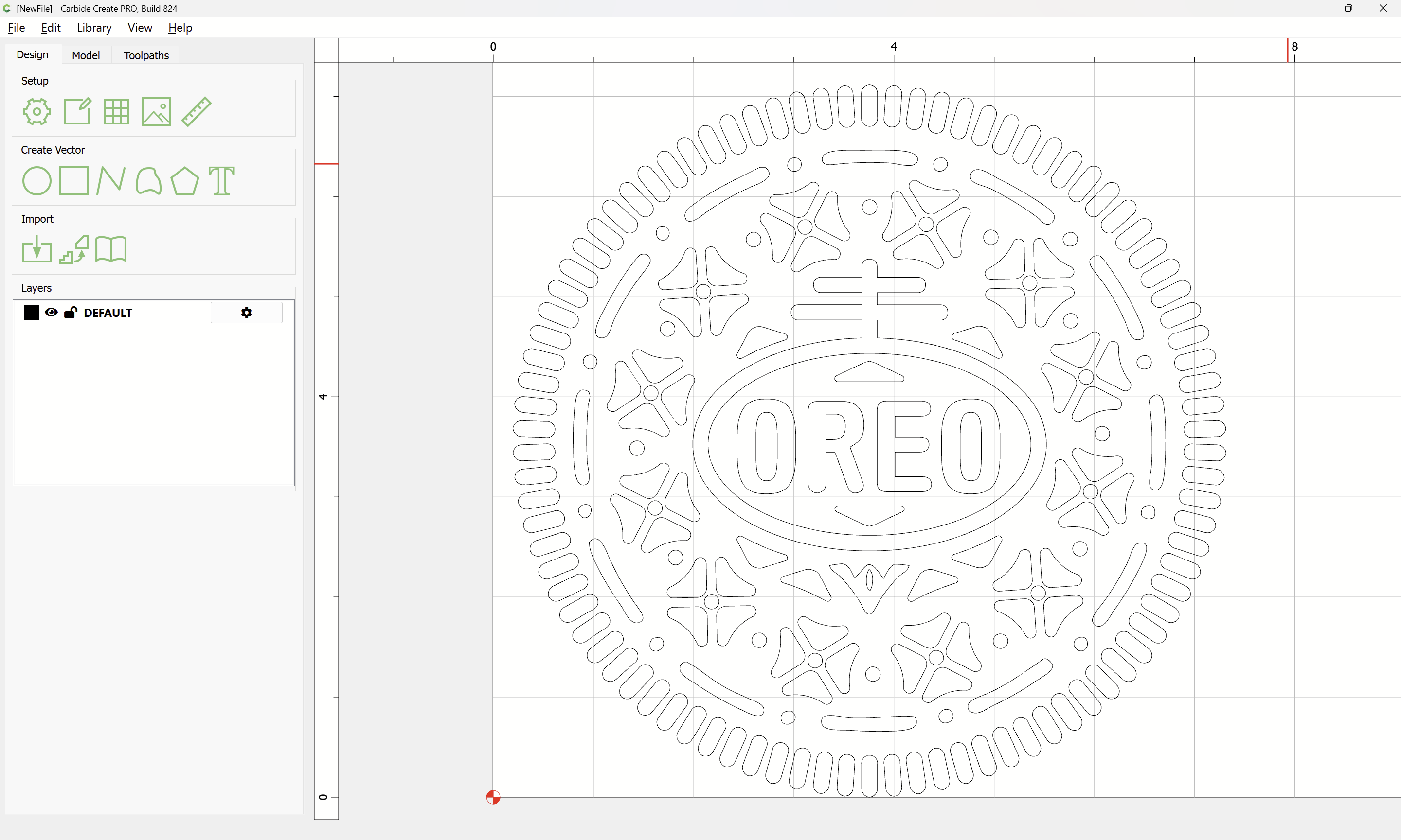

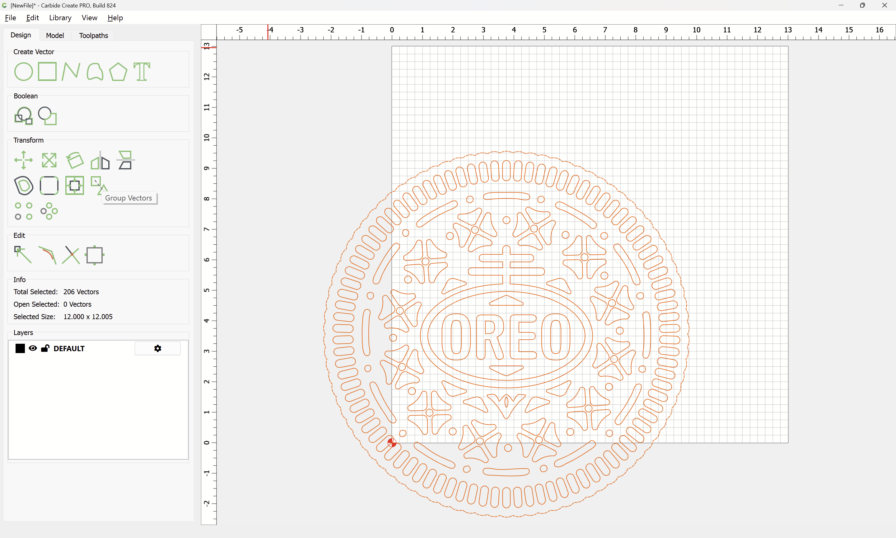

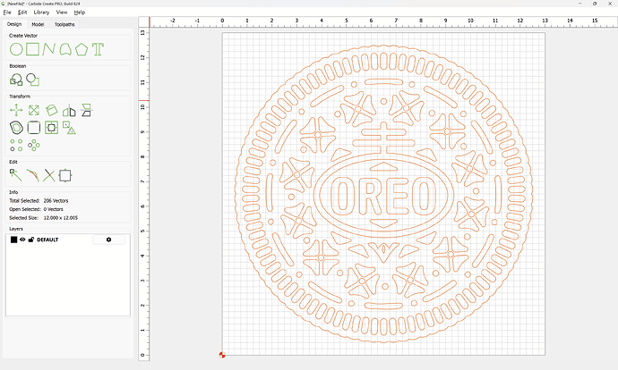

There is an SVG for this on Wikimedia Commons:
File:Vector Oreo.svg - Wikimedia Commons

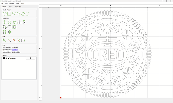

which opens as expected into Carbide Create (though there is a warning about open vectors):

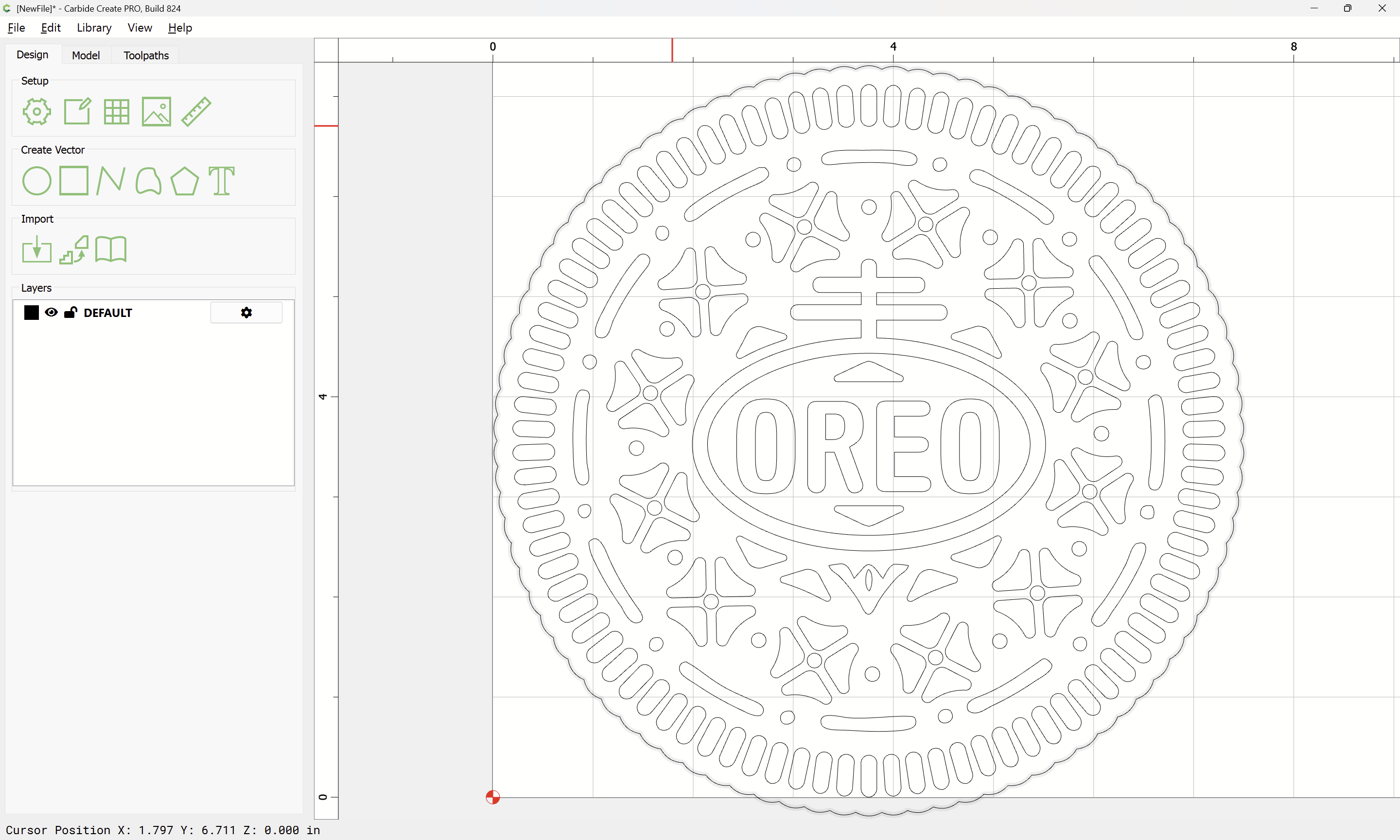

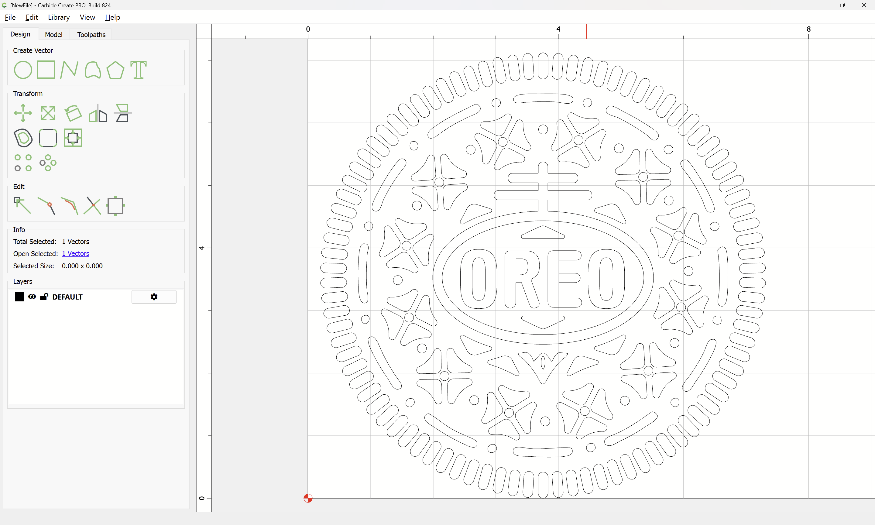

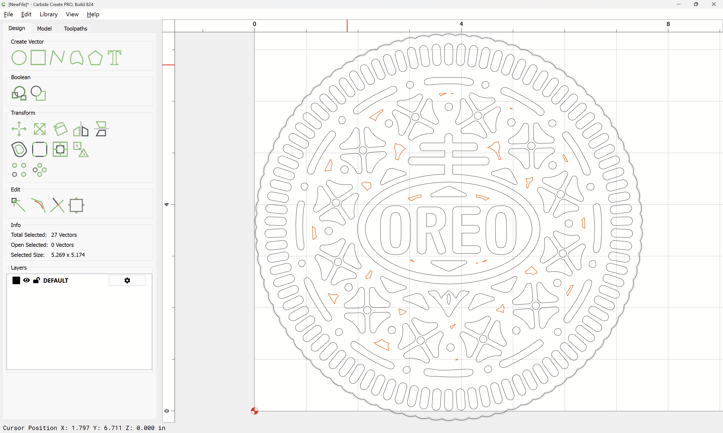

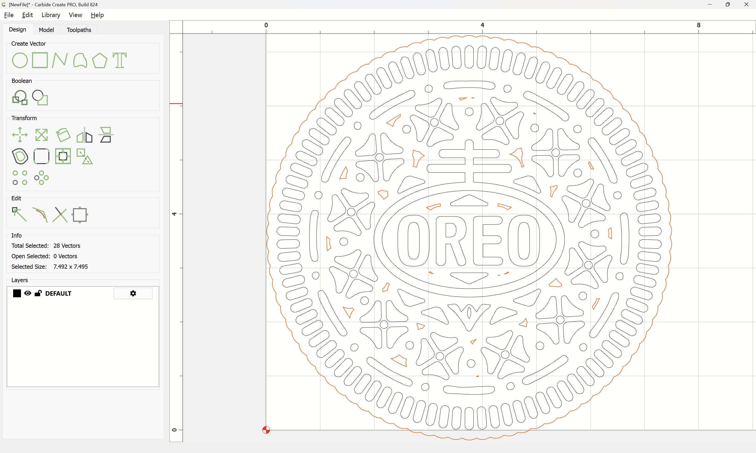

but selecting open vectors:
and then deleting addresses that.

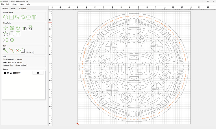

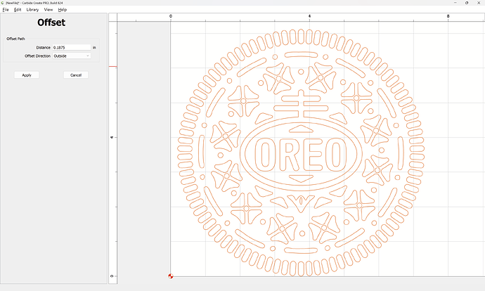

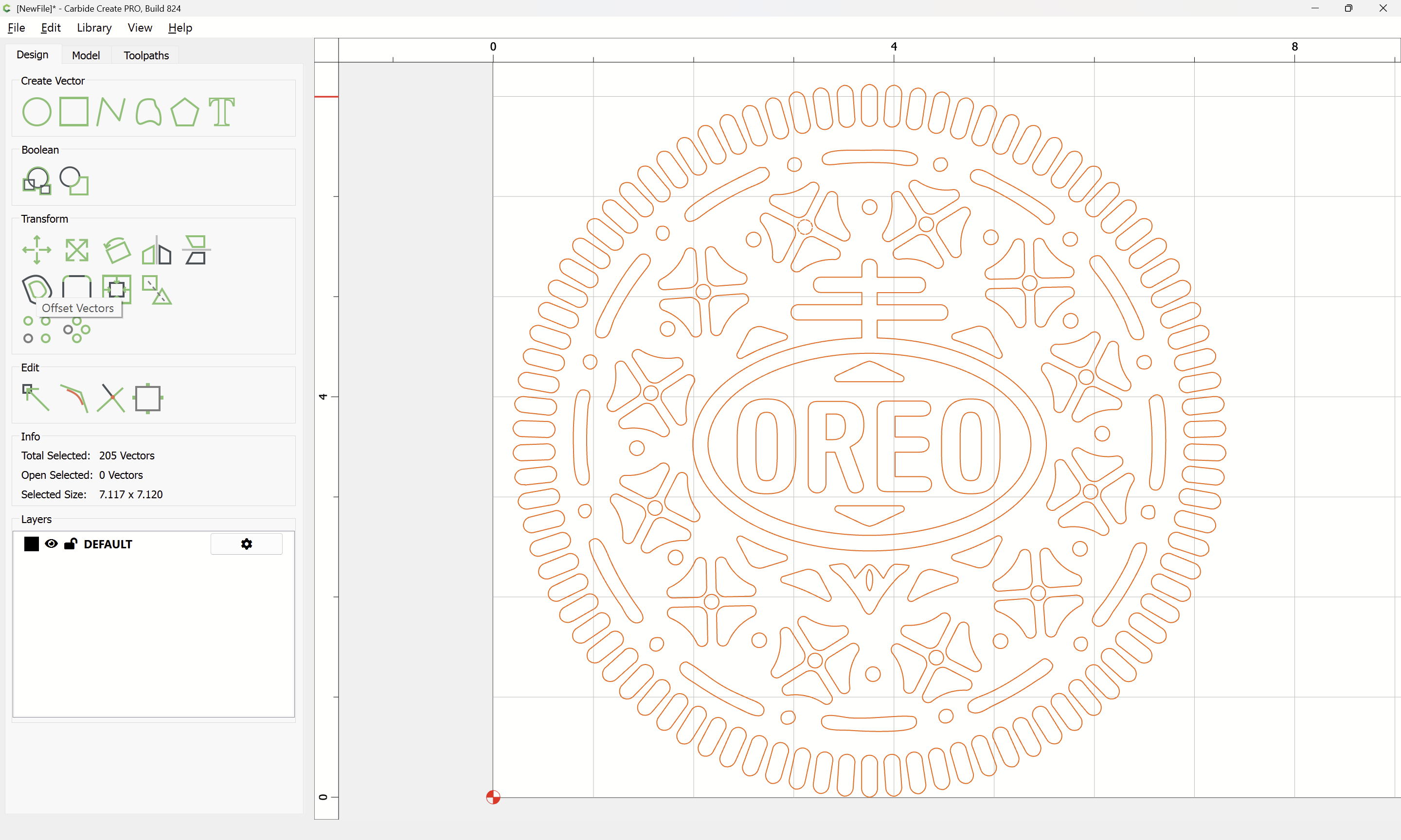

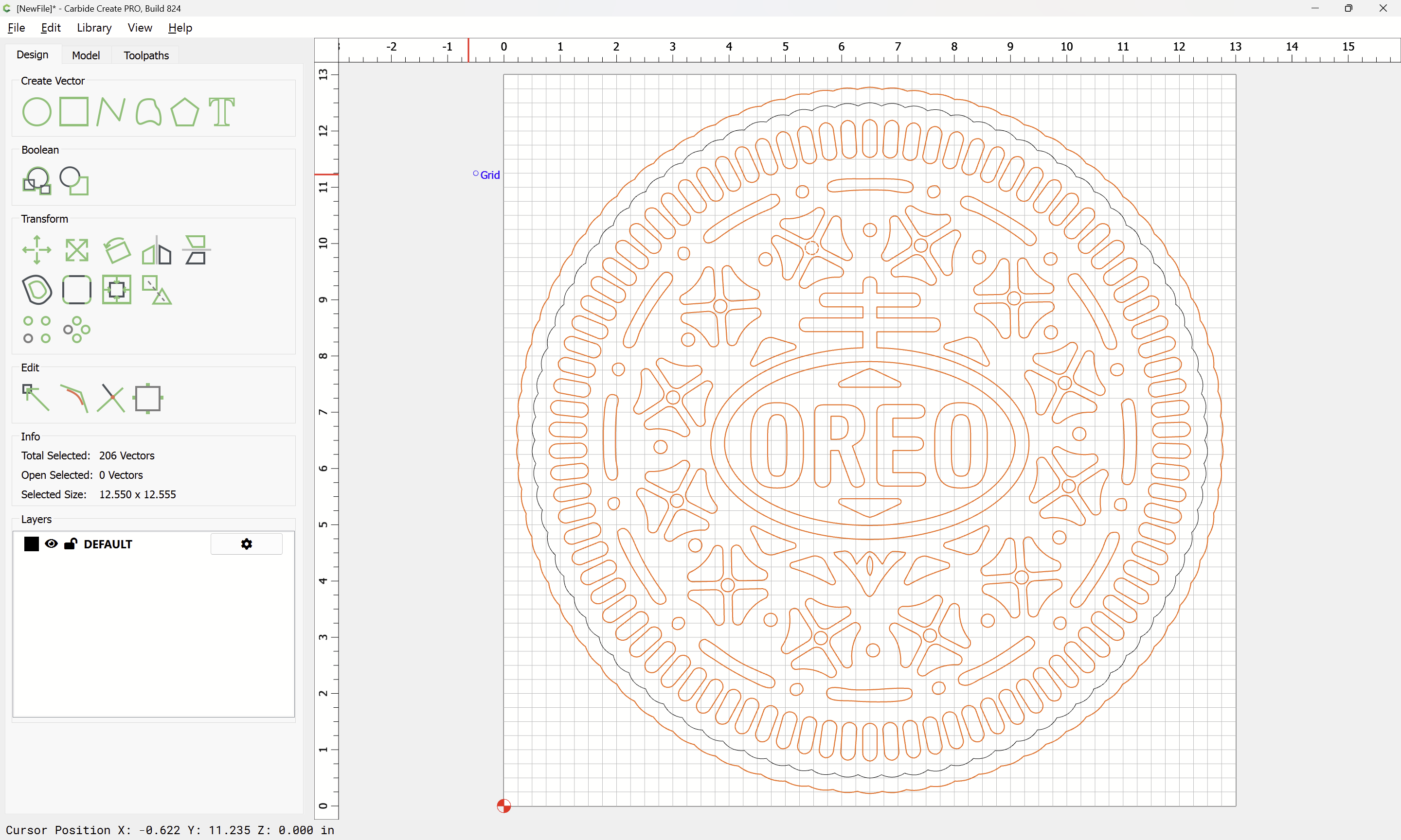

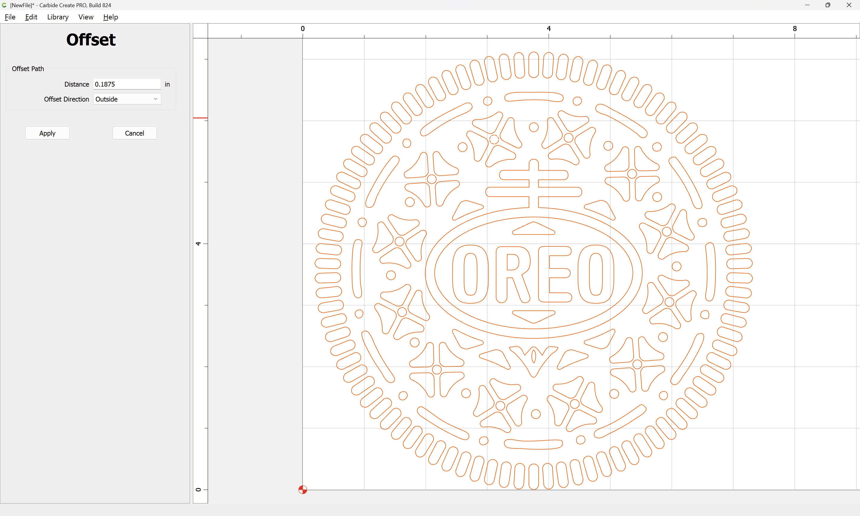

The design represents the raised design of the cookie, so one will need surrounding geometry, select:
Offset Vectors:
to some reasonable dimension:

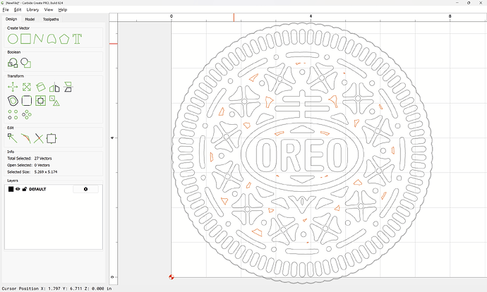

Then shift-click to deselect the border geometry:
and delete to clean up:

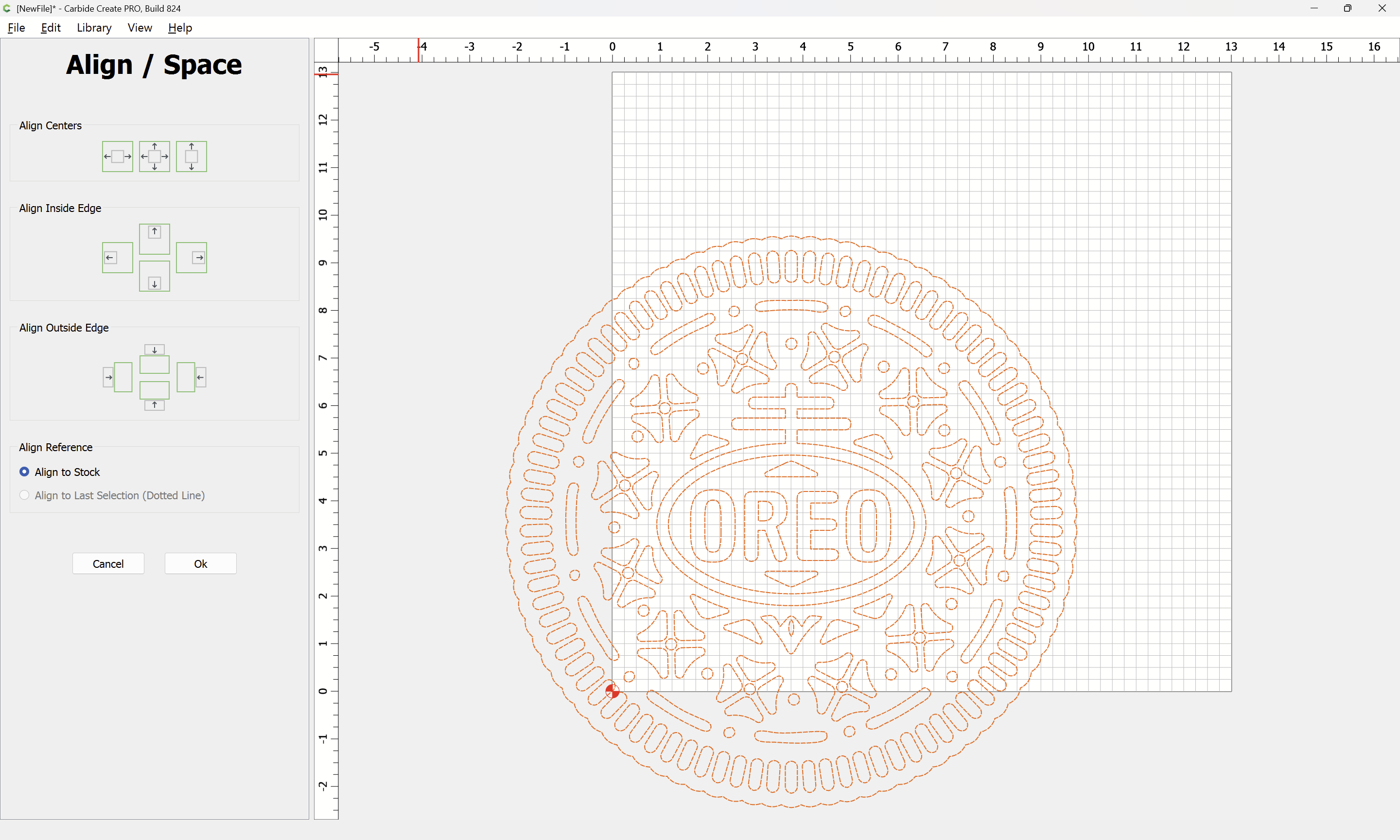

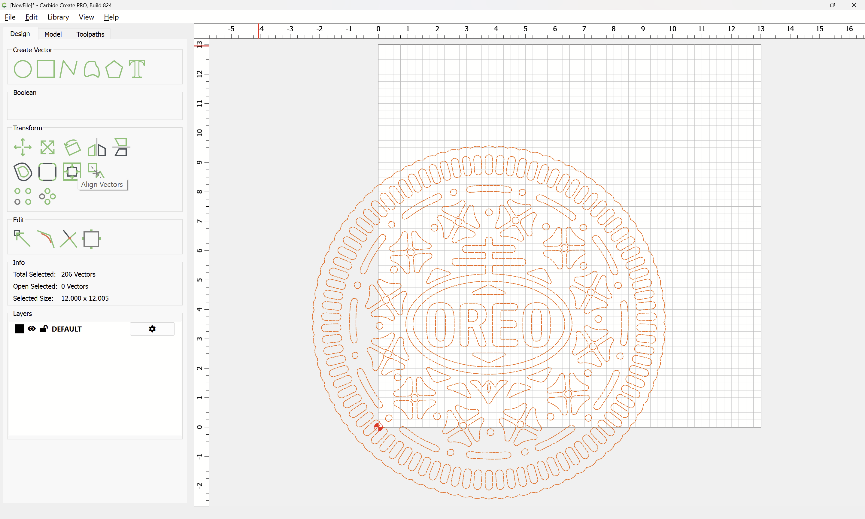

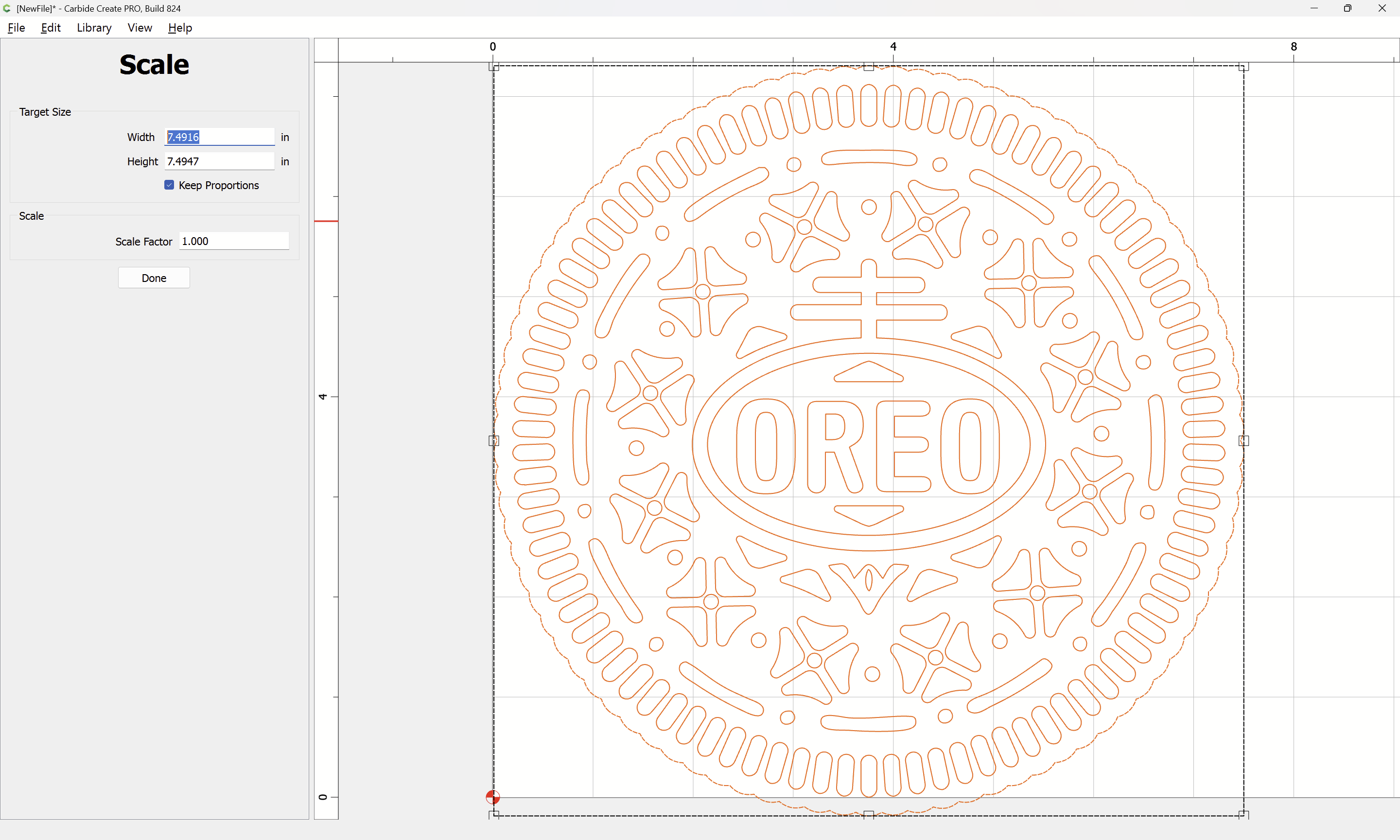

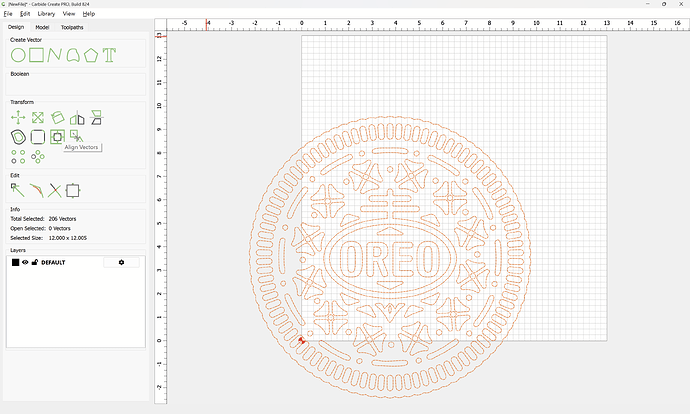

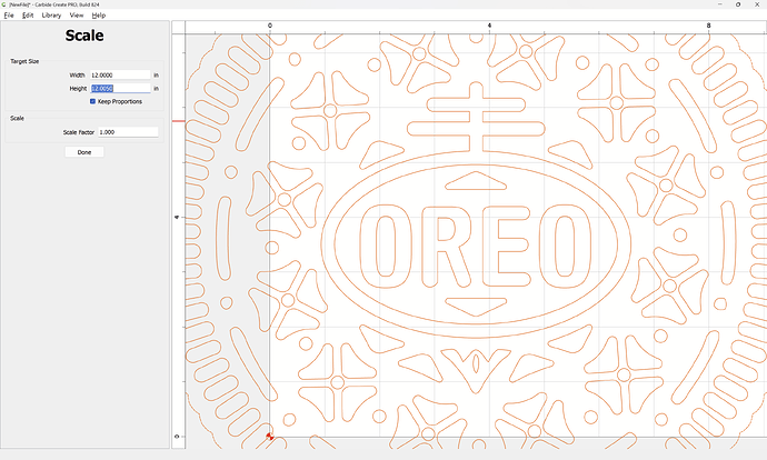

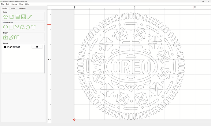

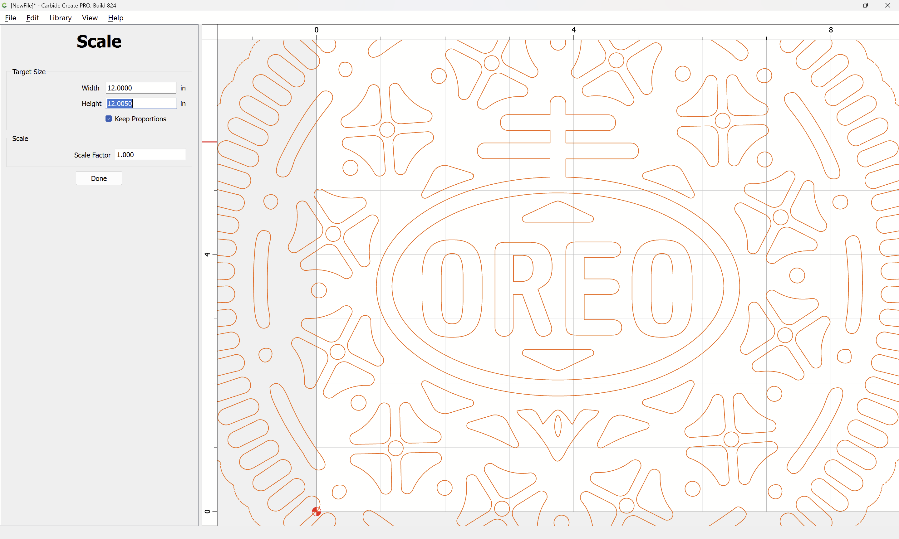

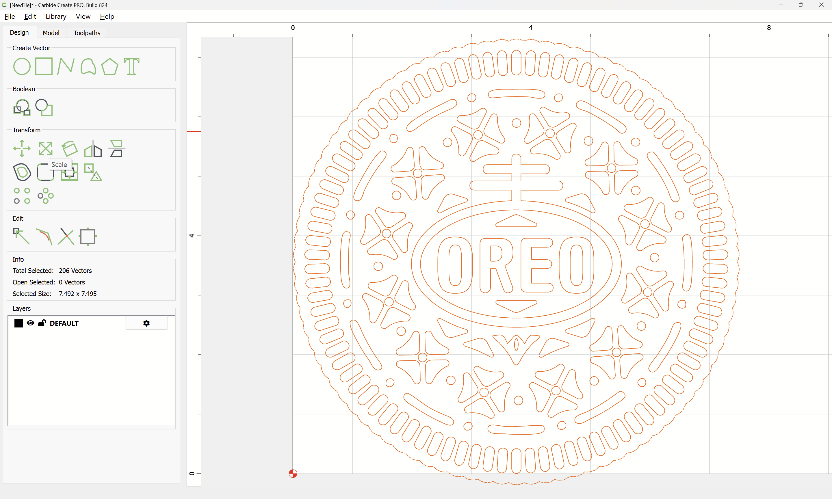

Select everything:

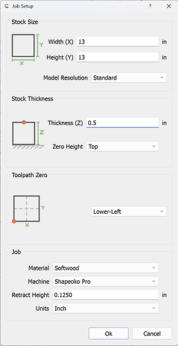

and scale to suit your stock:

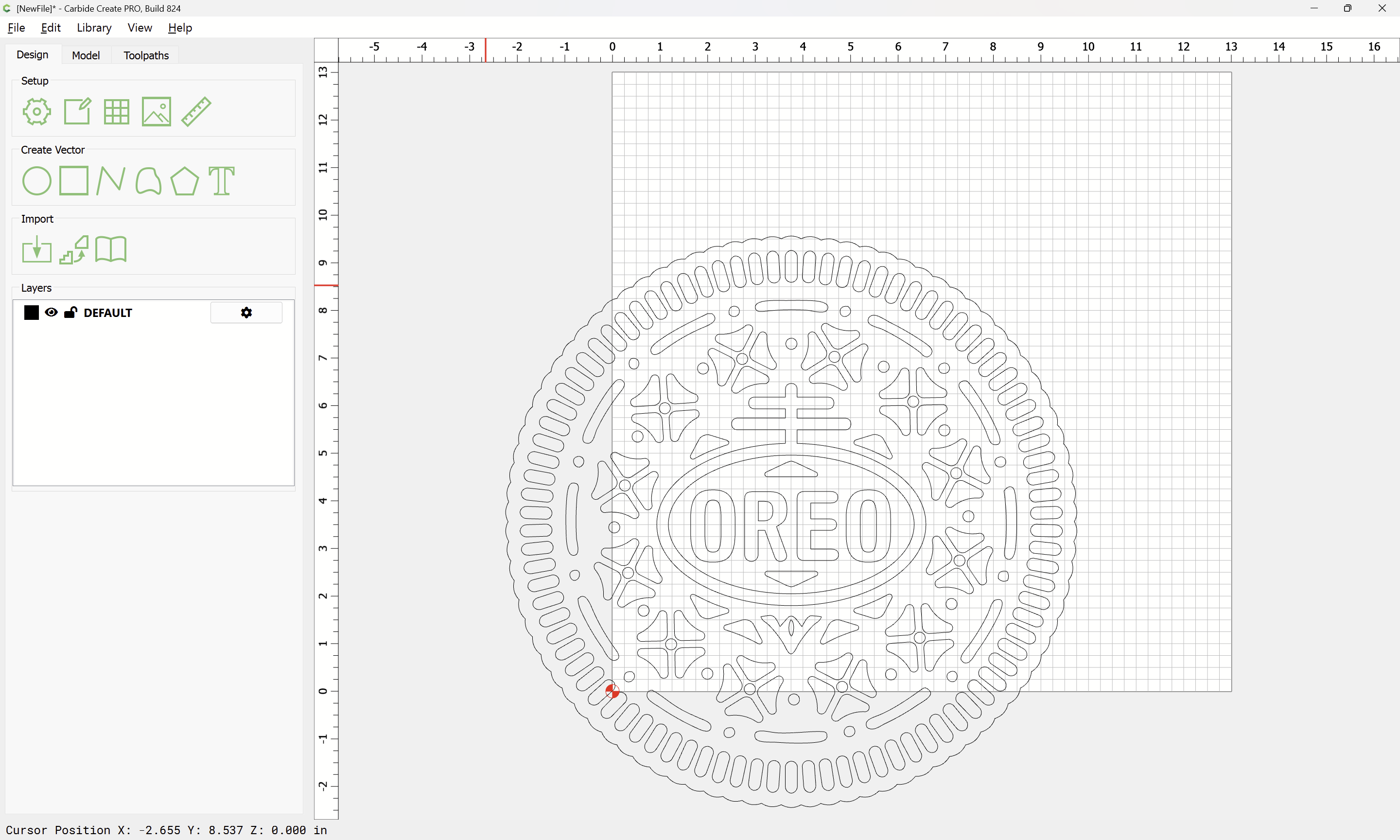

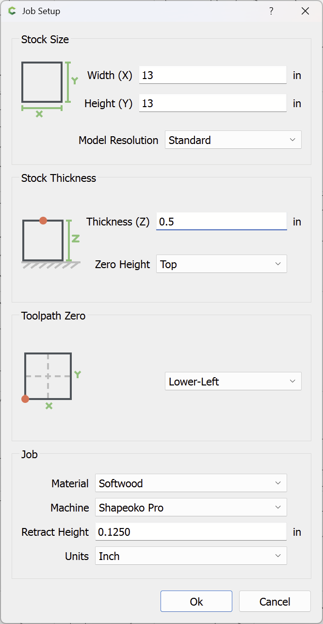

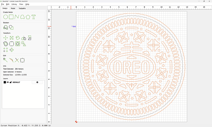

Then re-size the stock:

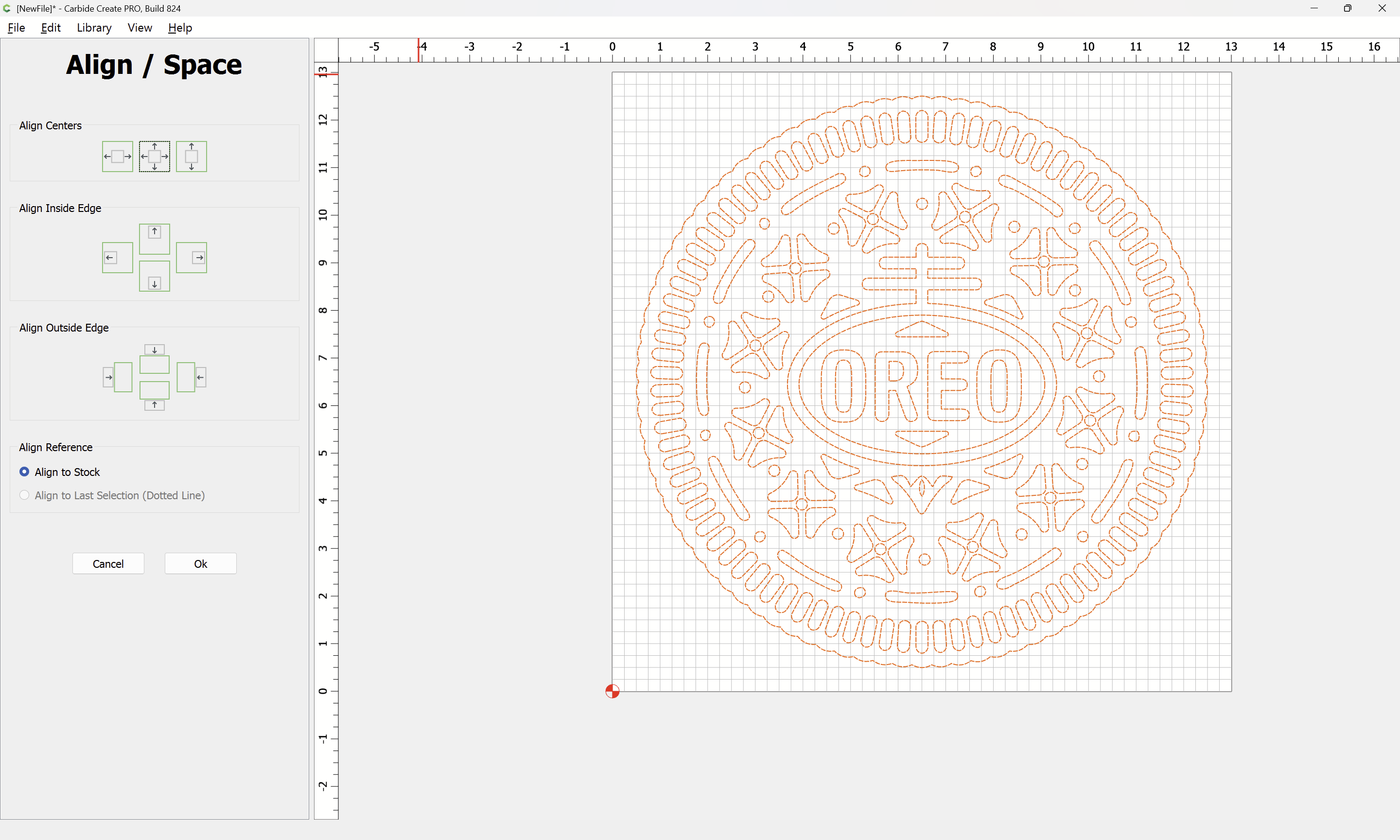

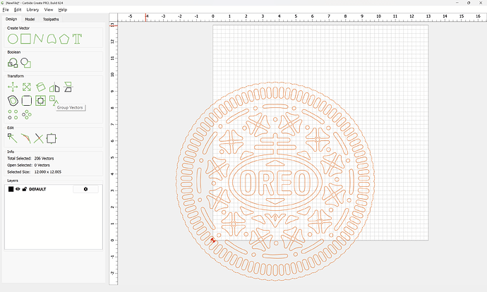

Select everything:

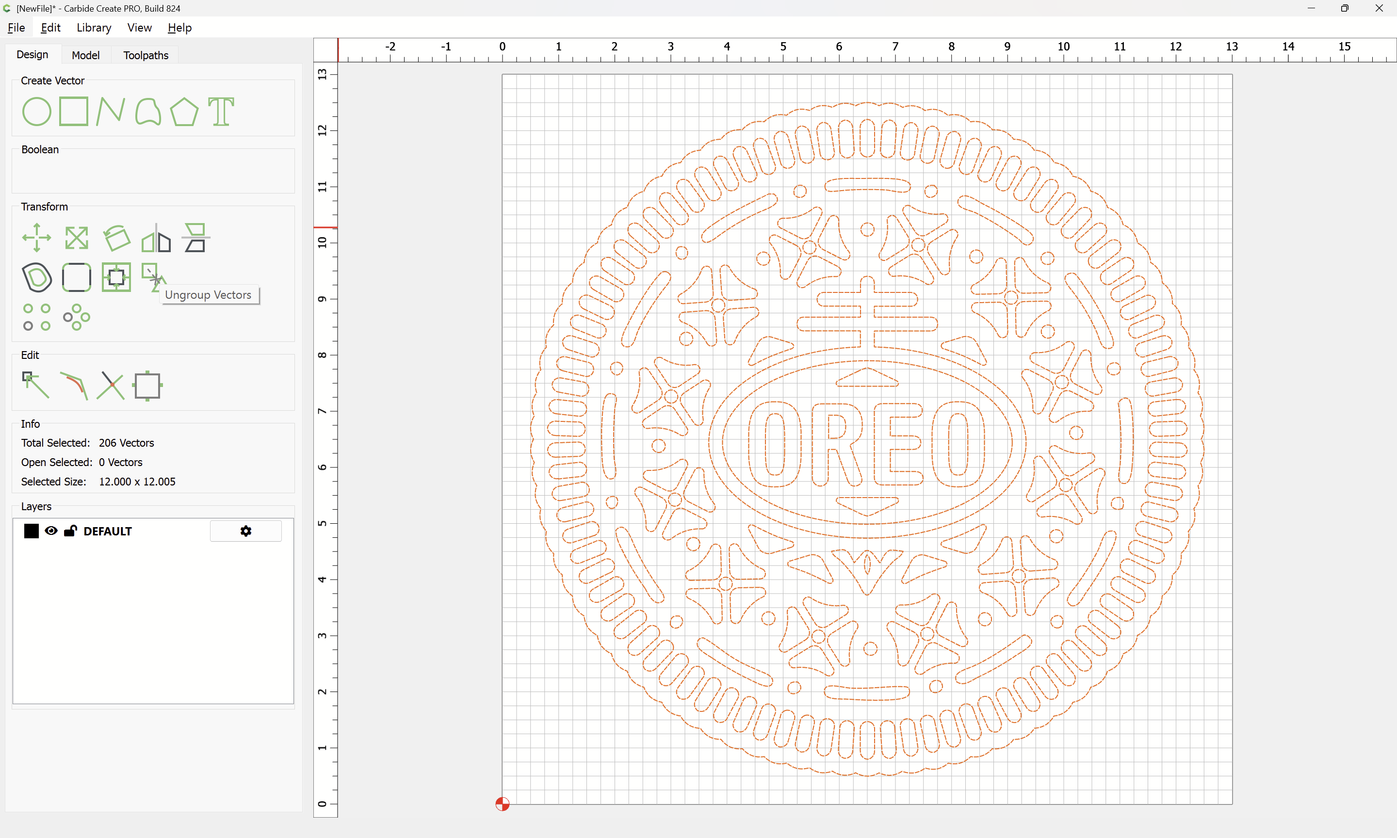

Group Vectors

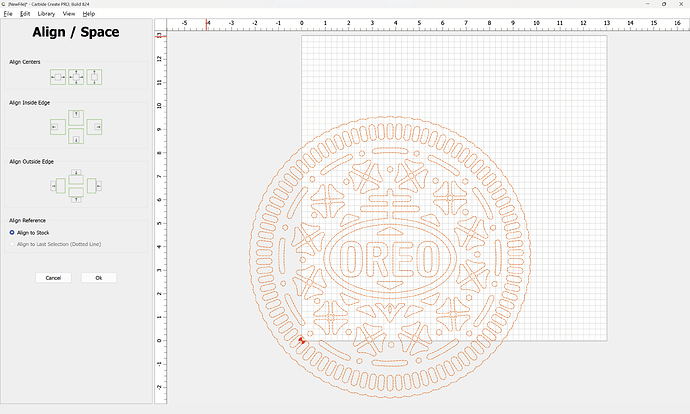

Align Vectors
to the center of the stock:
Ungroup Vectors

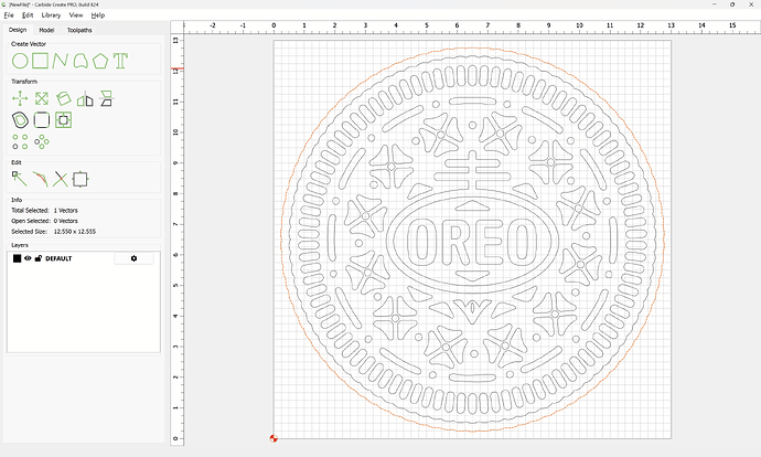

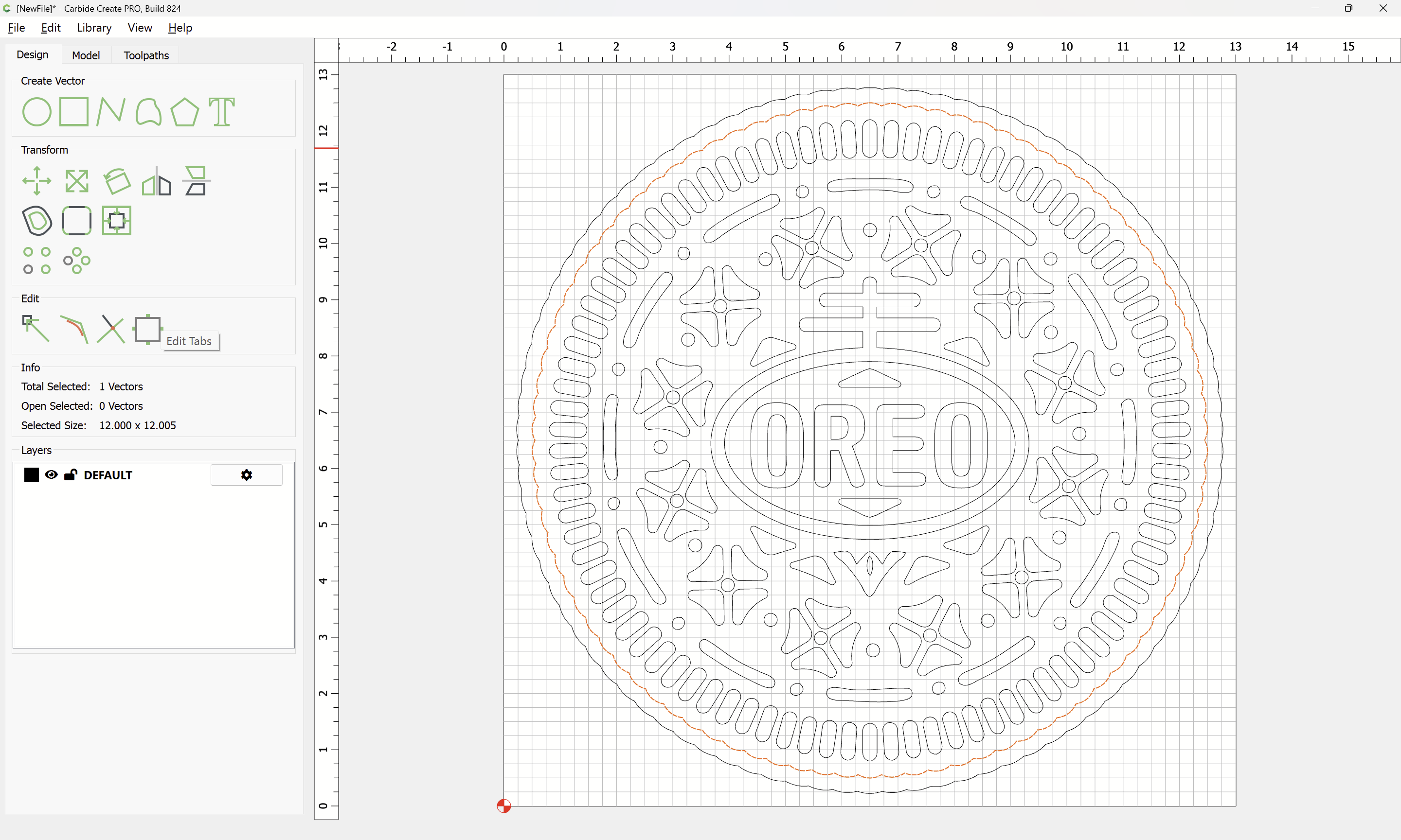

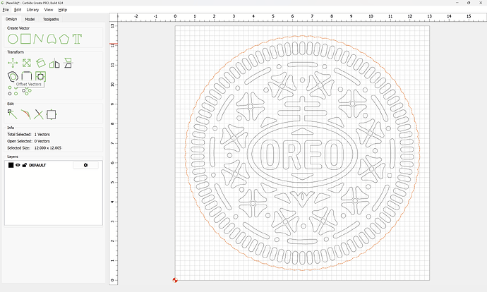

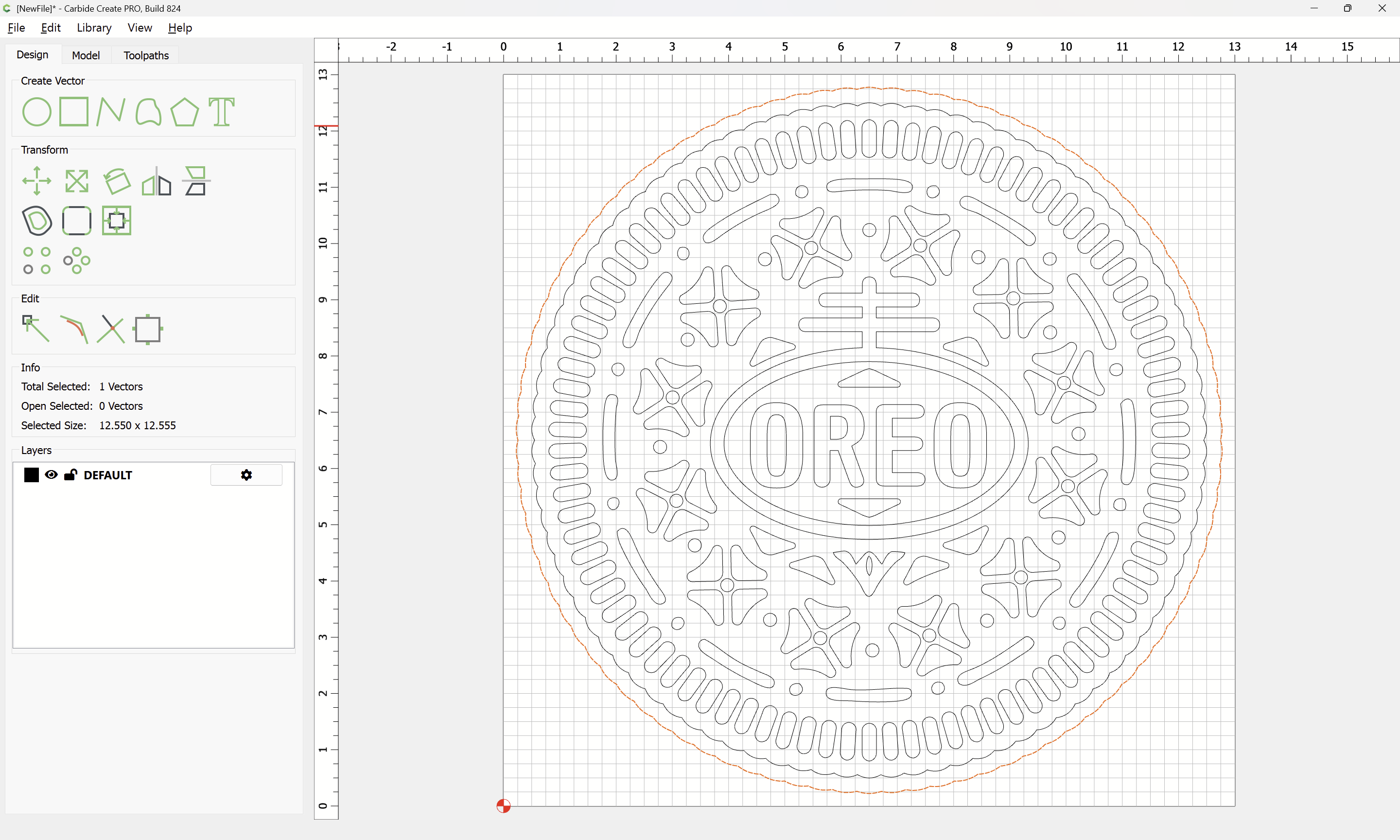

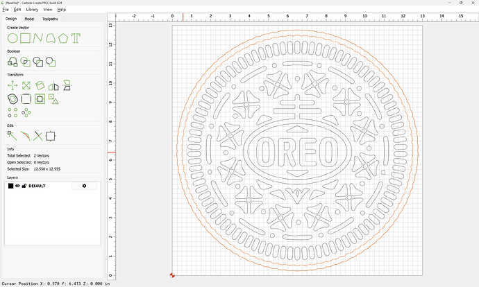

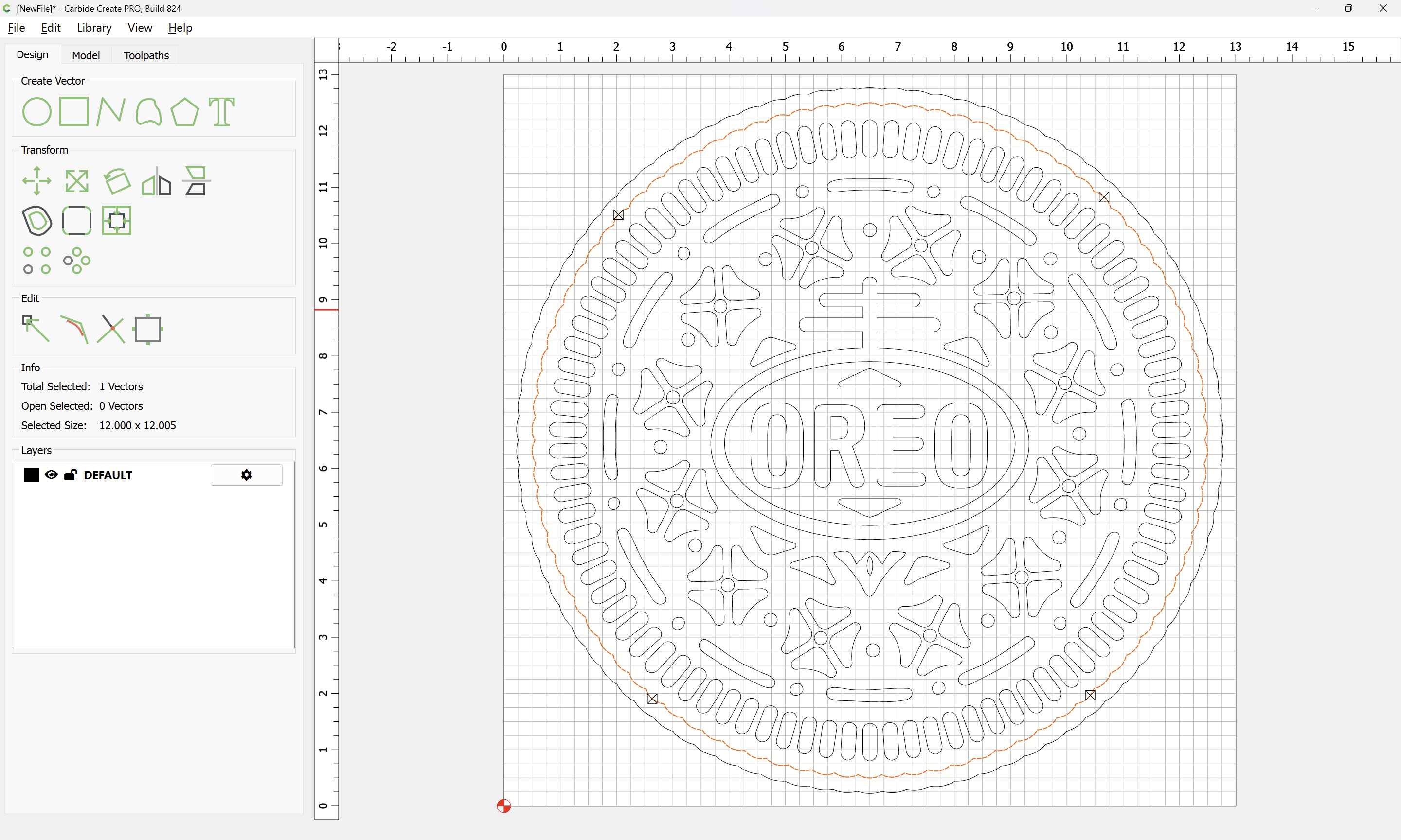

Select only the surrounding geometry:

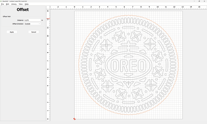

and use Offset Vectors again:
to offset by tool diameter plus 10% or so:
Apply

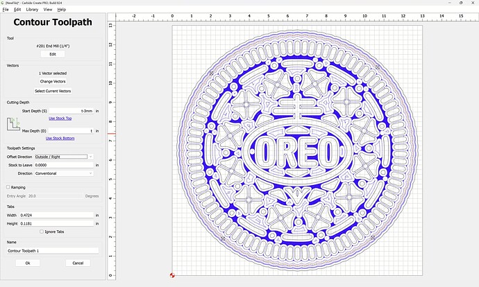

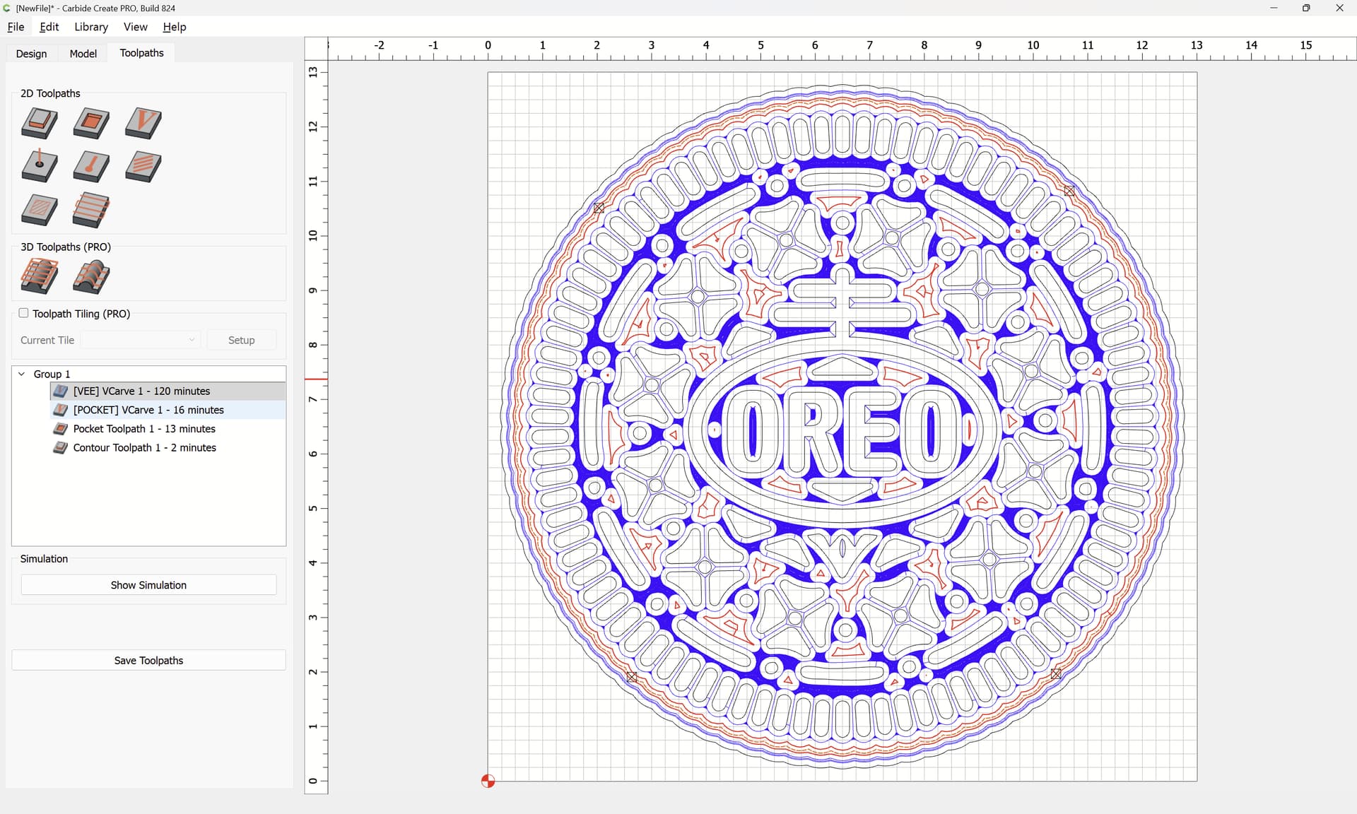

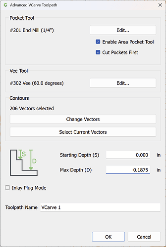

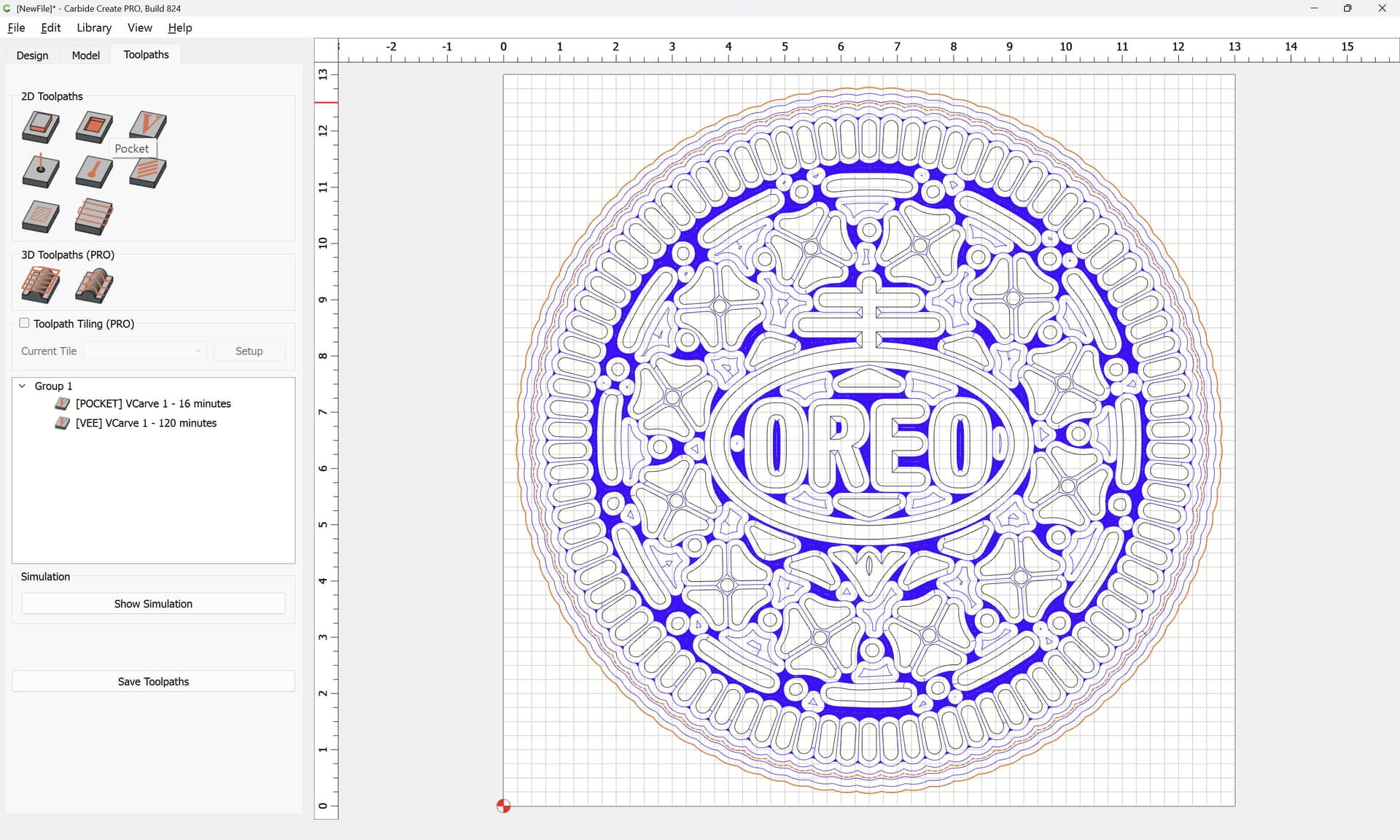

Select everything except for the original border geometry:

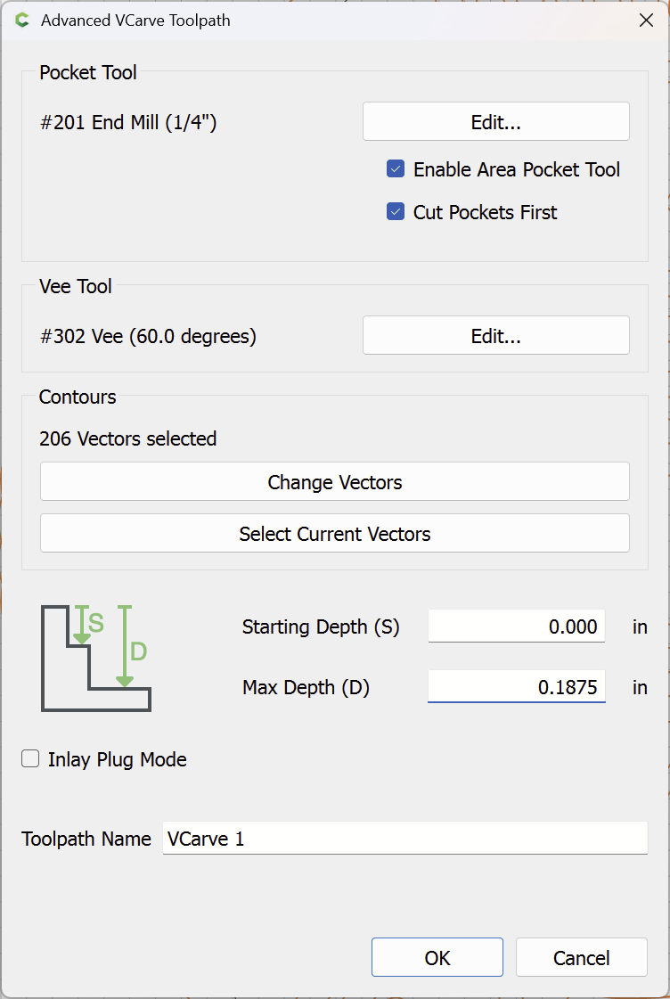

and assign a V Carving toolpath to a suitable depth:
(might want to use a smaller tool)

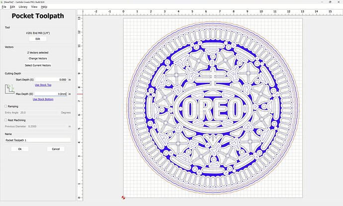

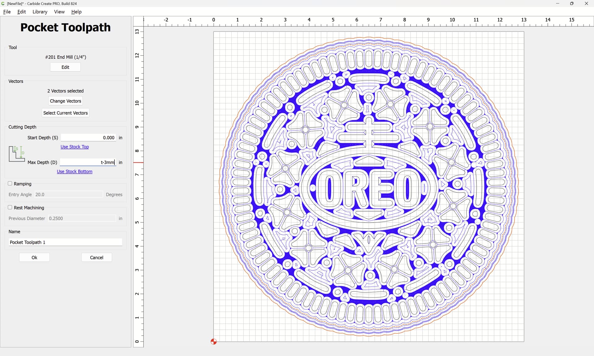

Select the two border geometries:
Assign a Pocket Toolpath down to tab height:

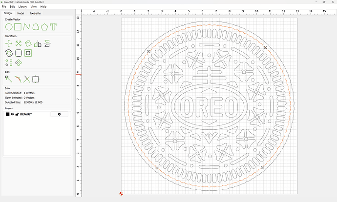

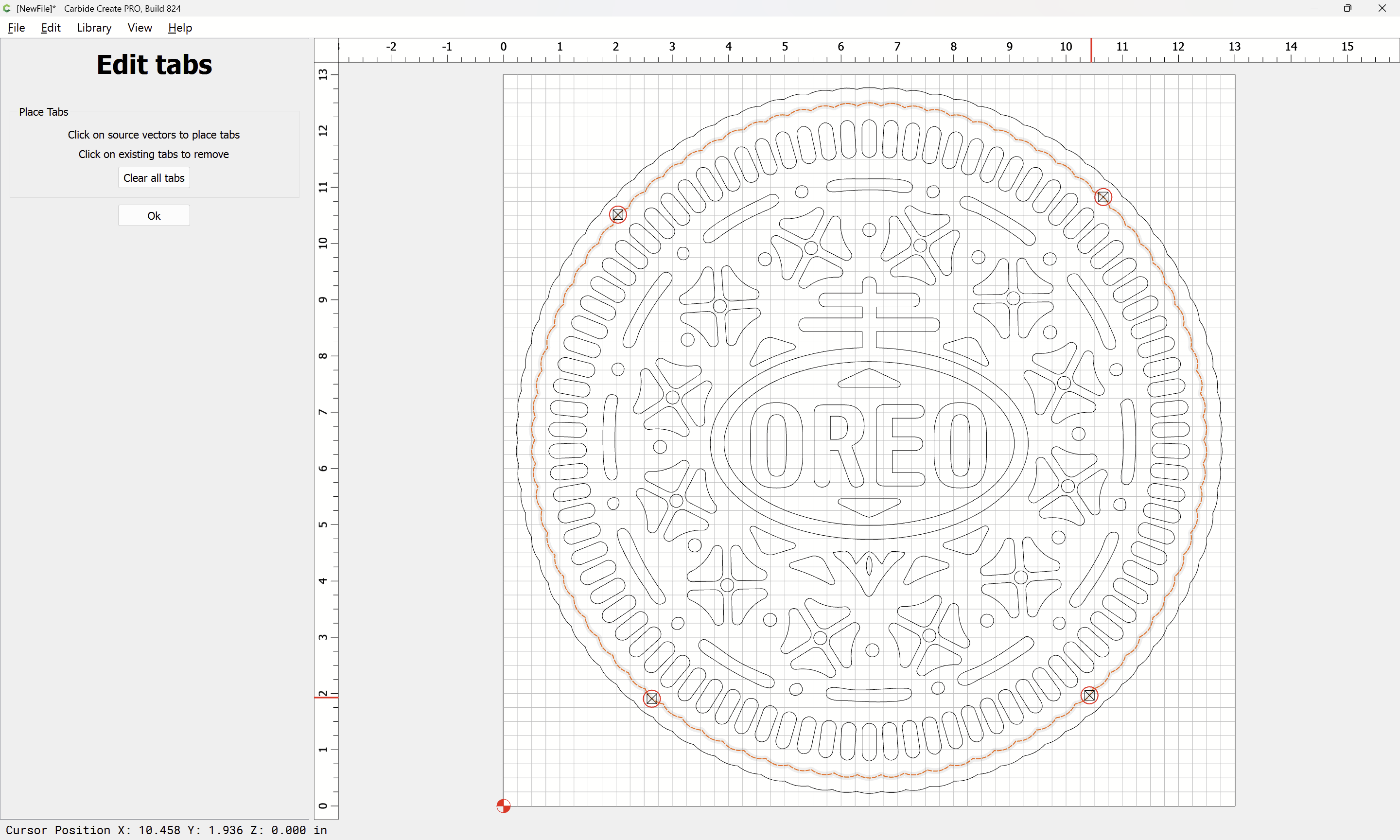

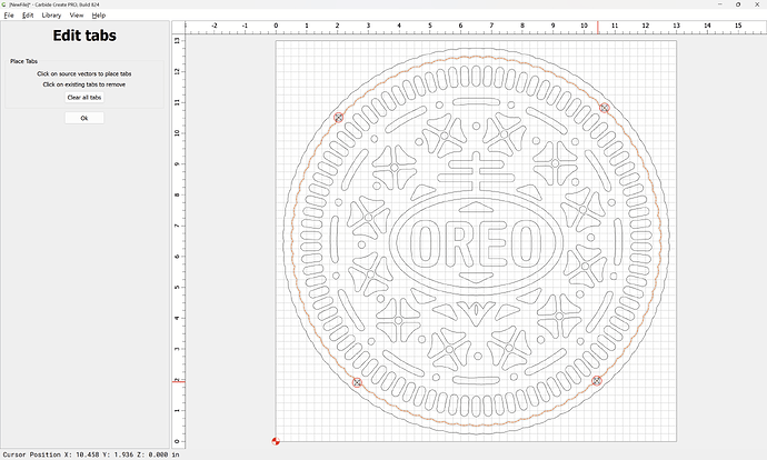

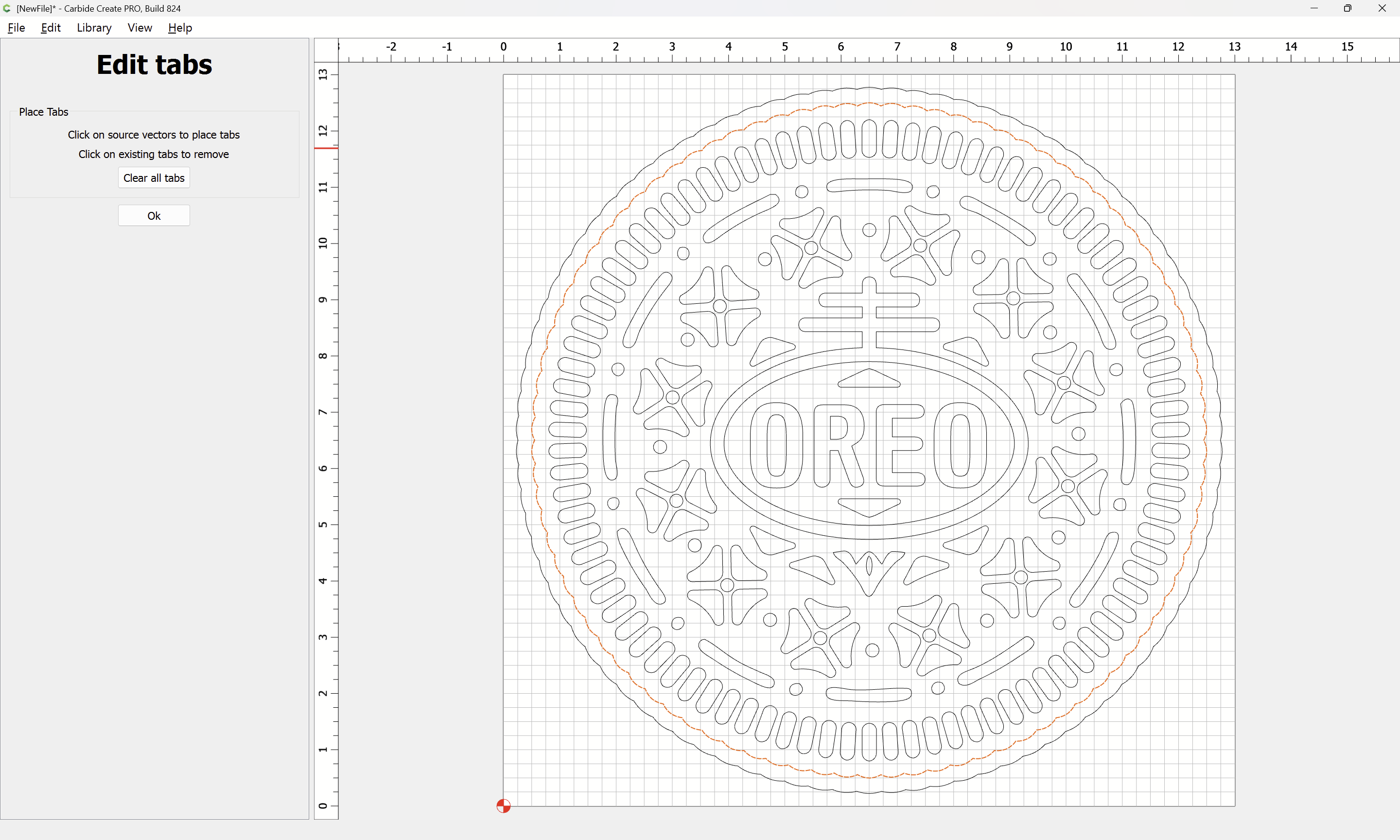

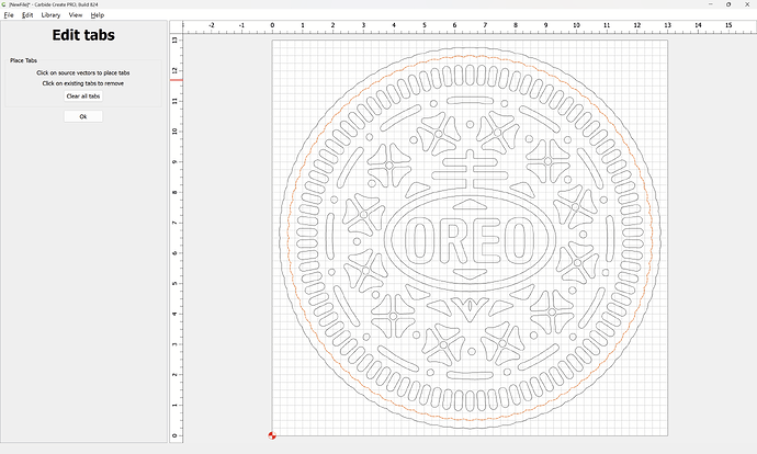

Select only the first offset border geometry:
and apply Tabs (unless using workholding which will secure things w/o tabs):
OK

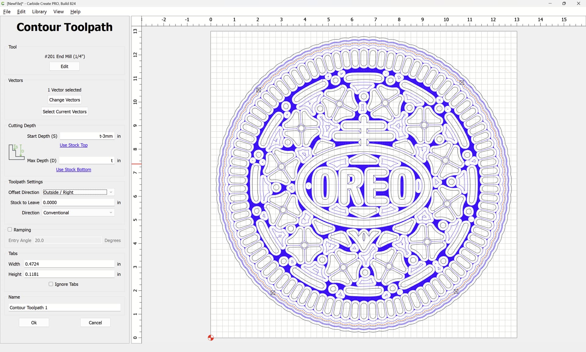

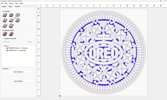

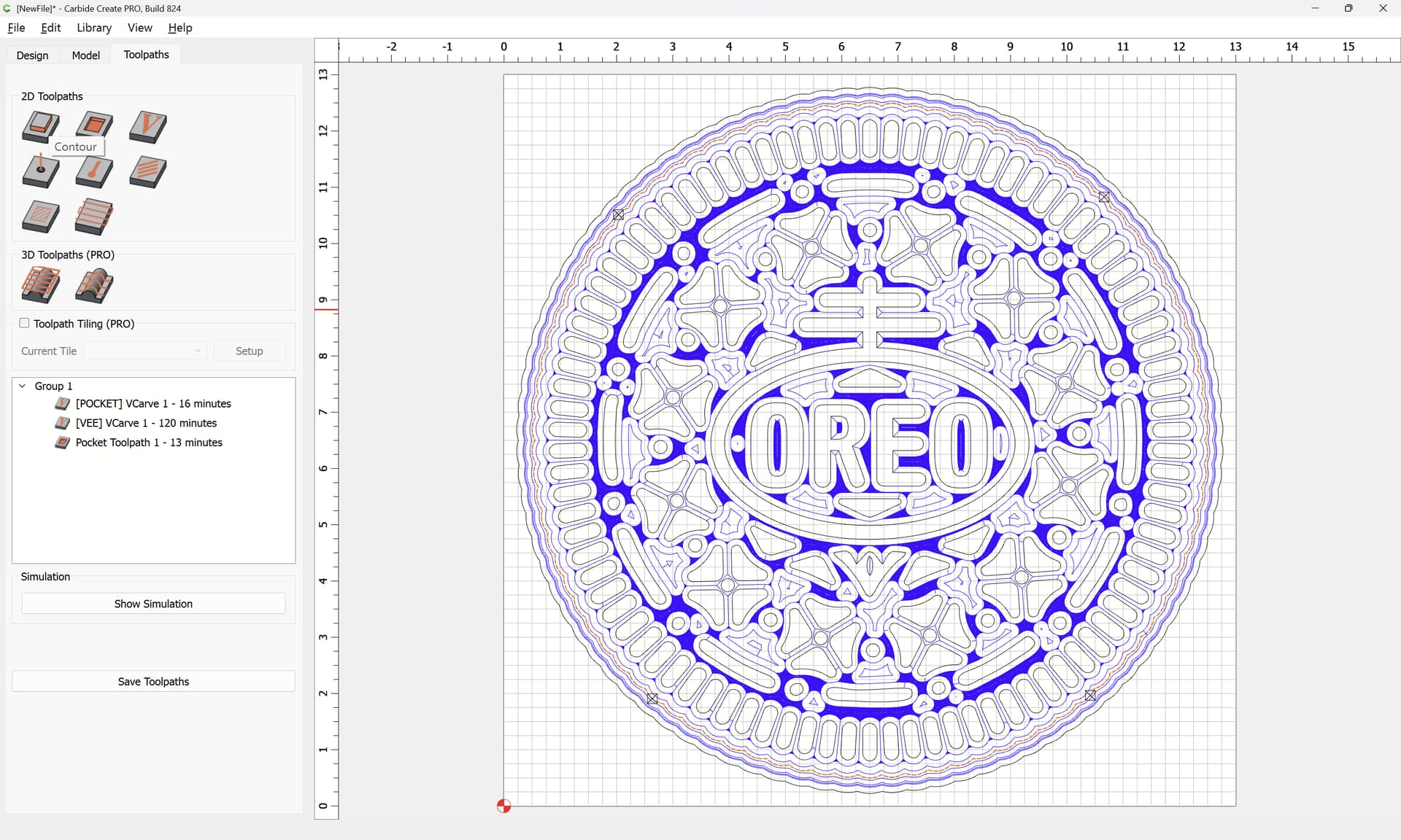

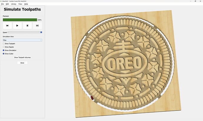

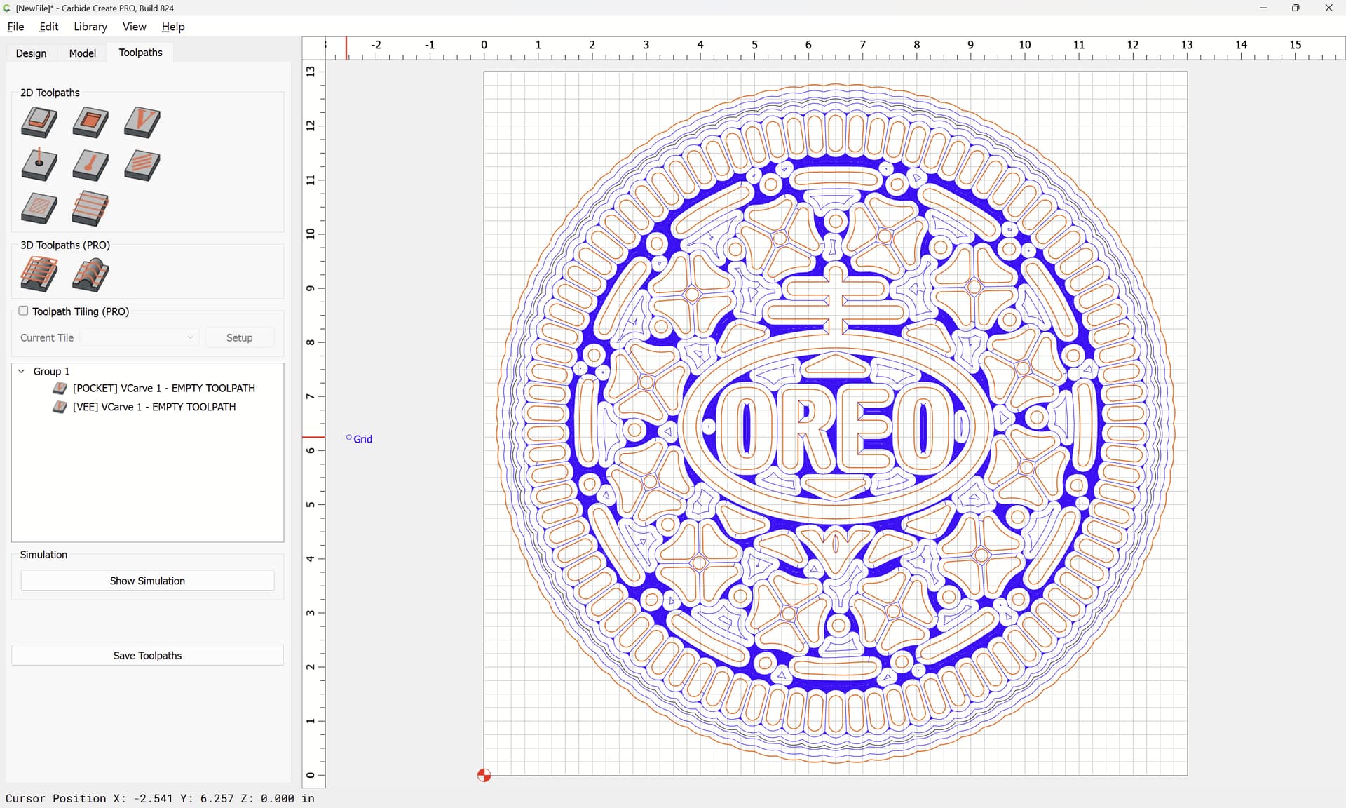

Assign a Contour toolpath which starts at the bottom of the previous toolpath:

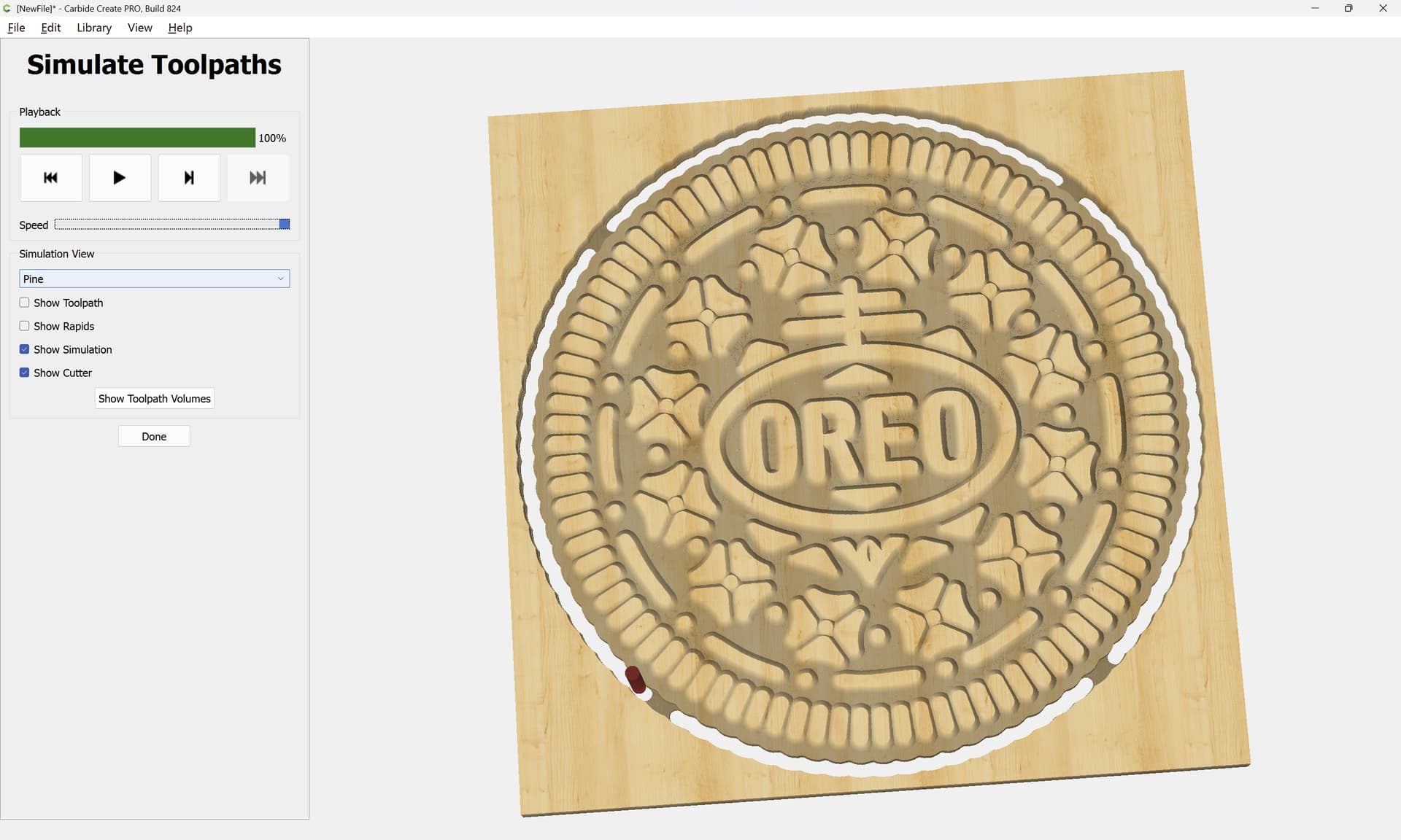

to arrive at:
and re-arrange toolpaths for minimal tool changes by dragging:
