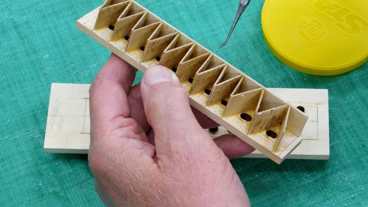

I am building a Senior 20 crank organ, I am having a problem with the tracker bar which should be a straightforward cnc router job
I am trying to cut a D shaped hole 6mm dia and 9mm long on the straight side, and 2mm deep. I also need other smaller D shaped down to 4mm and 4mm long.
I am having sizing problems, either the circular bit is too big or too small,and I cannot get a straight line on the flat side.
Can sombody help me with this, I am a beginner and struggling,
Advice on the cutting tool required would help as well.

Are you talking about something like this?
I create an oversized copy of my tool and use it for a roughing pass. Maybe 0.005" bigger than the nominal tool.
I’m guessing it should look something like what is shown in this video at the timestamp 0:18
So, Tod’s example seems like the basic idea, but more than one and all in a row and precise sizes.

That is exactly it. How to do it in carbide create is the question.

The tracker bar has a paper roll, with holes punched in it to play the notes. Air pressure flows through the holes and is piped to flutes via the tracker bar.
