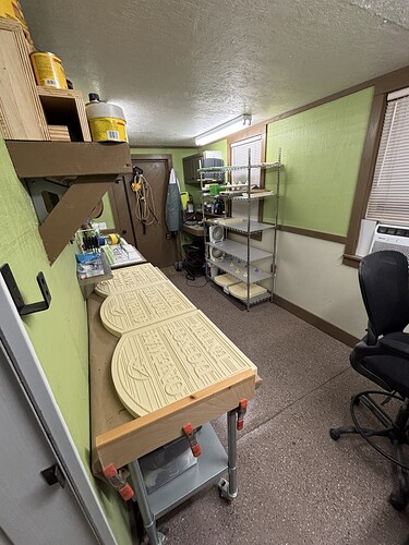

Our paint finishing room

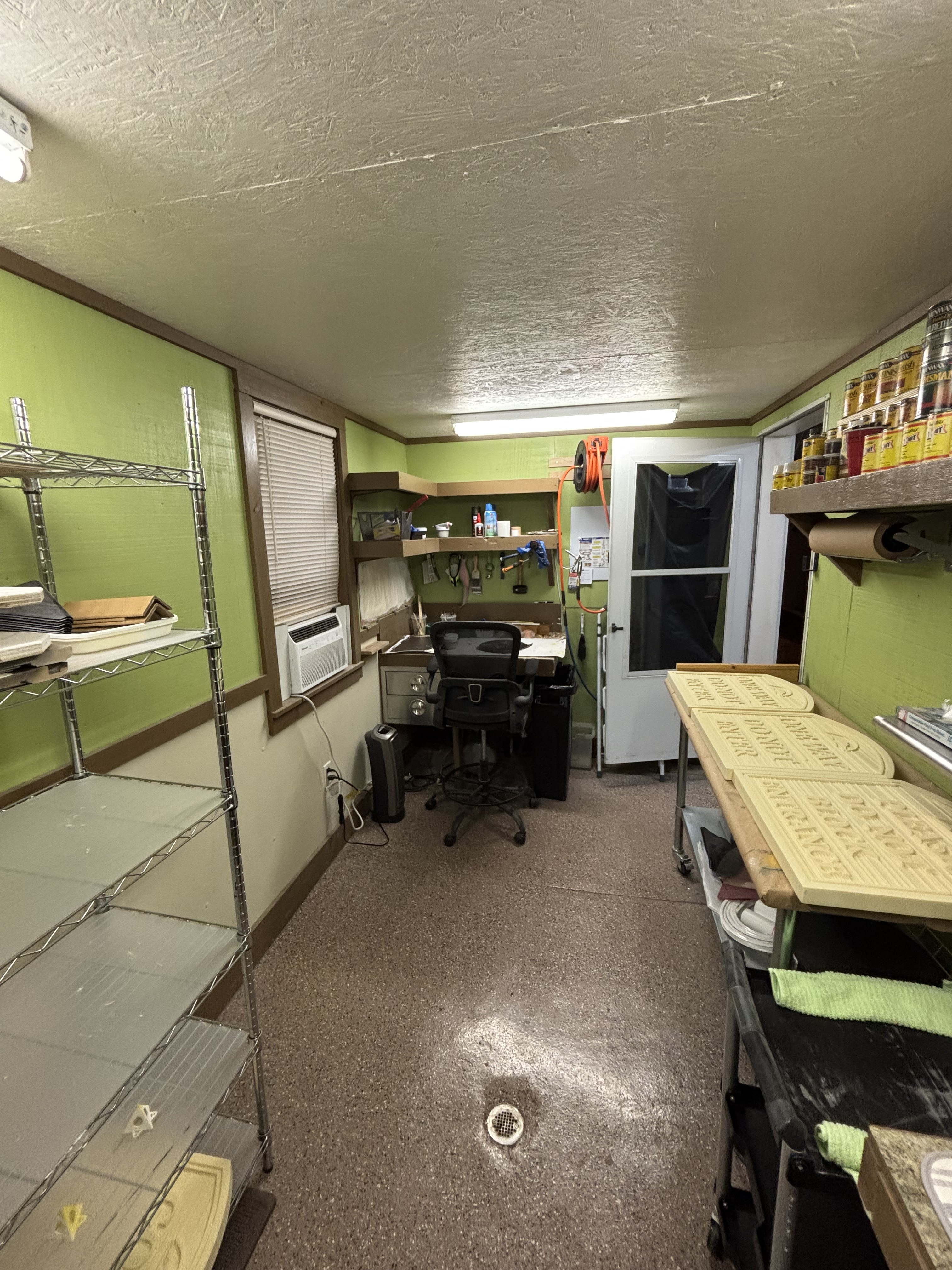

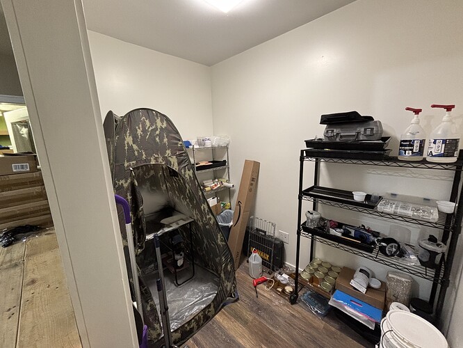

I thought I would share my wife’s finishing room set up. I’m that lucky guy who does the CNC design and running work while she is the one who takes it from there and does all the epoxy, staining, painting, and finishing. She has a separate “tent” small room for spray painting.
Fun fact. This space has served for a few different things. It was original part of our lower deck to our house (NEVER used). Then enclosed for a pottery studio for our daughter (thus the colors). Then as a storage area for puppy whelping supplies (no we didn’t “store” the puppies there :sweat_smile:). It has an 8 year stint as a storage area for my wife’s asphalt seal coating business (yes it was HER business and she run it and operate it doing the work in the field as well). Then as a Microgreen tray prep/cleaning/storage area. Now it’s the finish room for our CNC business.

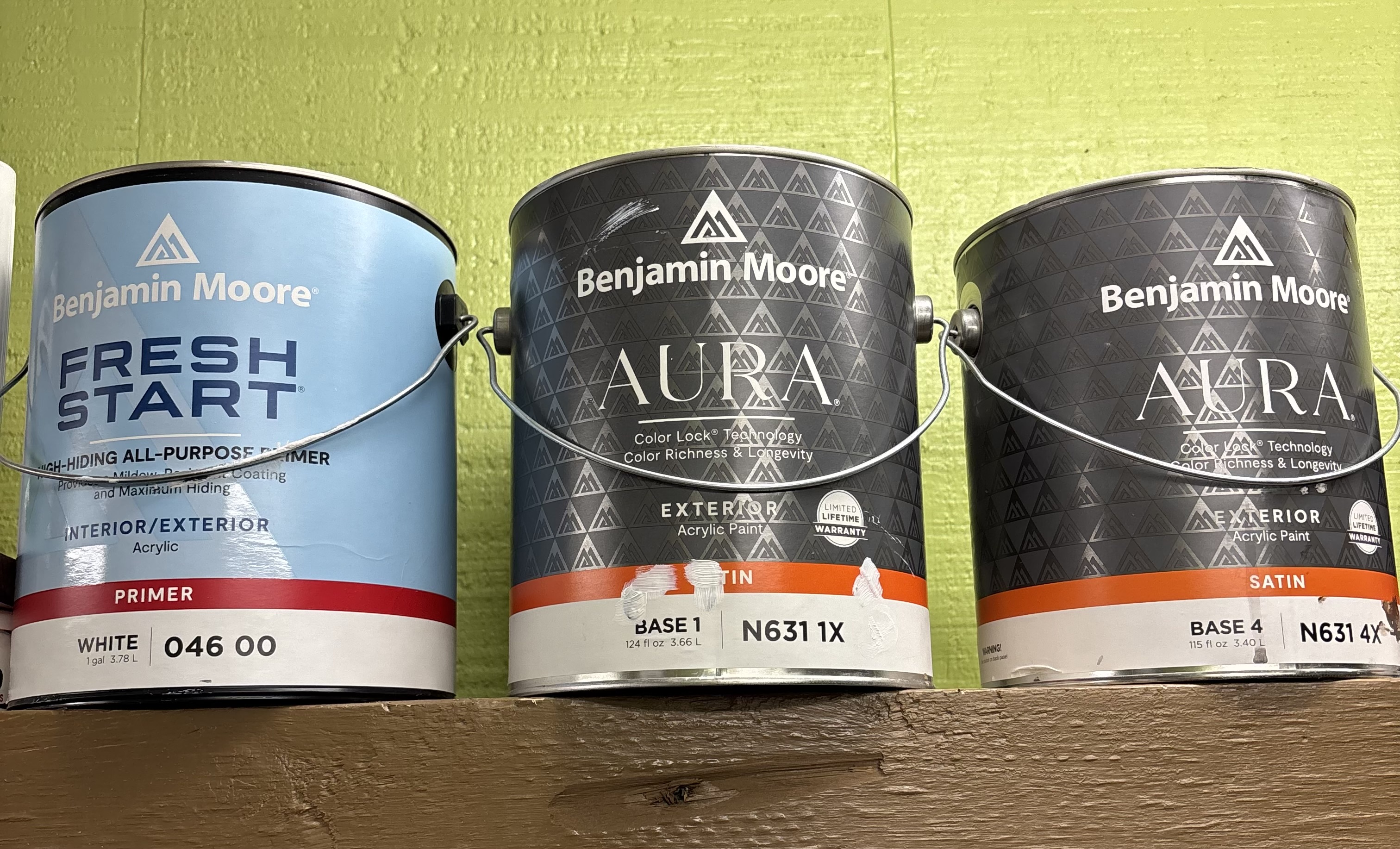

What paint and sealant do you use for covering the HDU material ?
This is what she uses. 1 coat primer, two coats of paint. It’s more expensive but really a great long lasting product.
Thank you very much. The sign will be very near the ocean. Not a lot of direct sun.
I appreciate the knowledge.

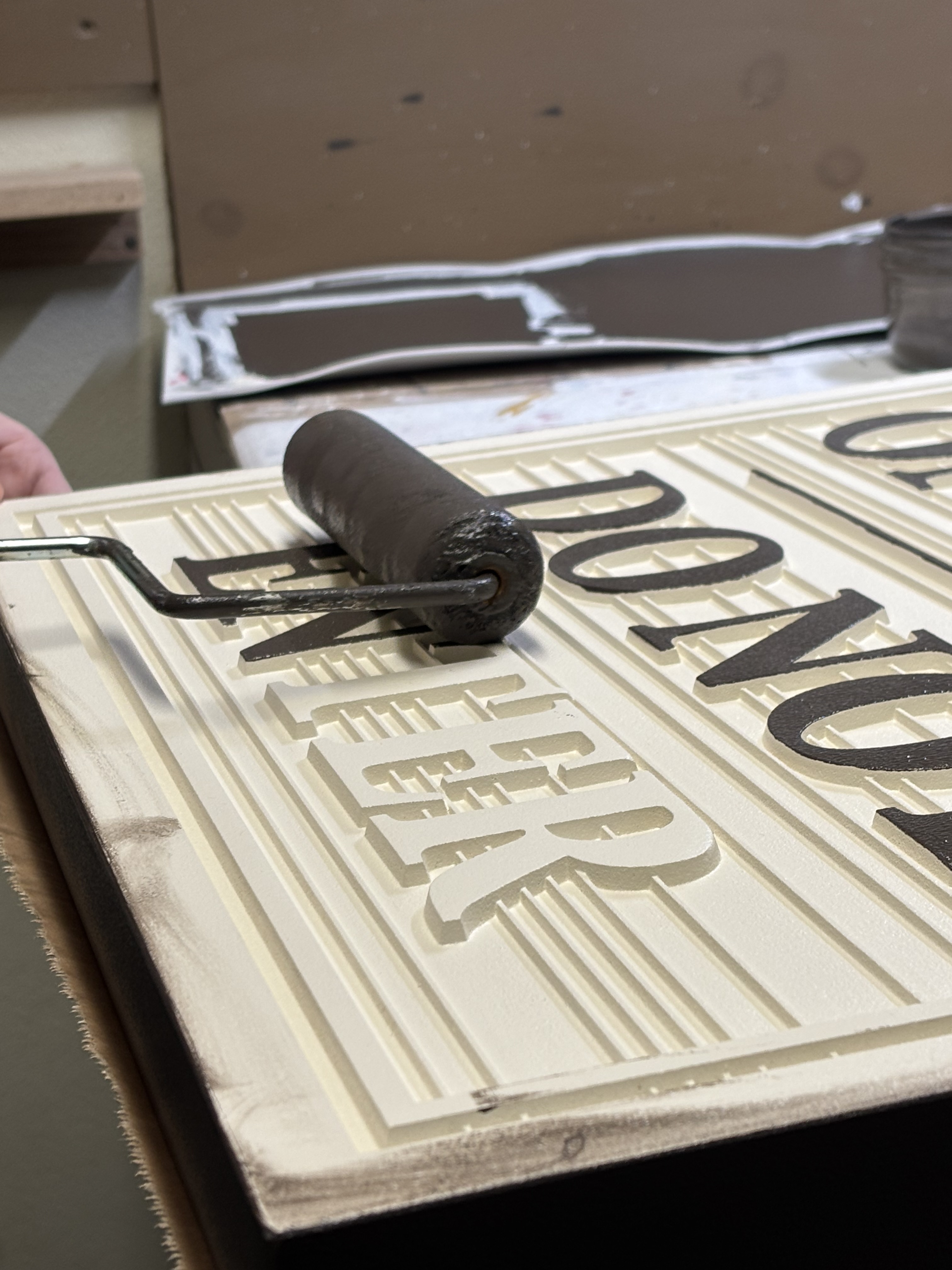

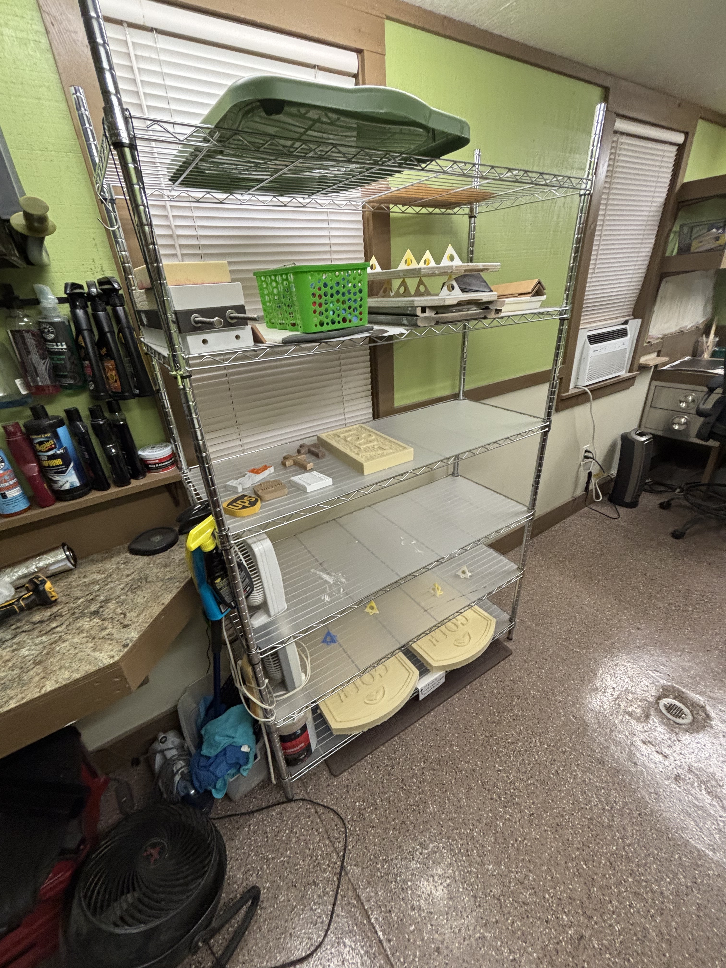

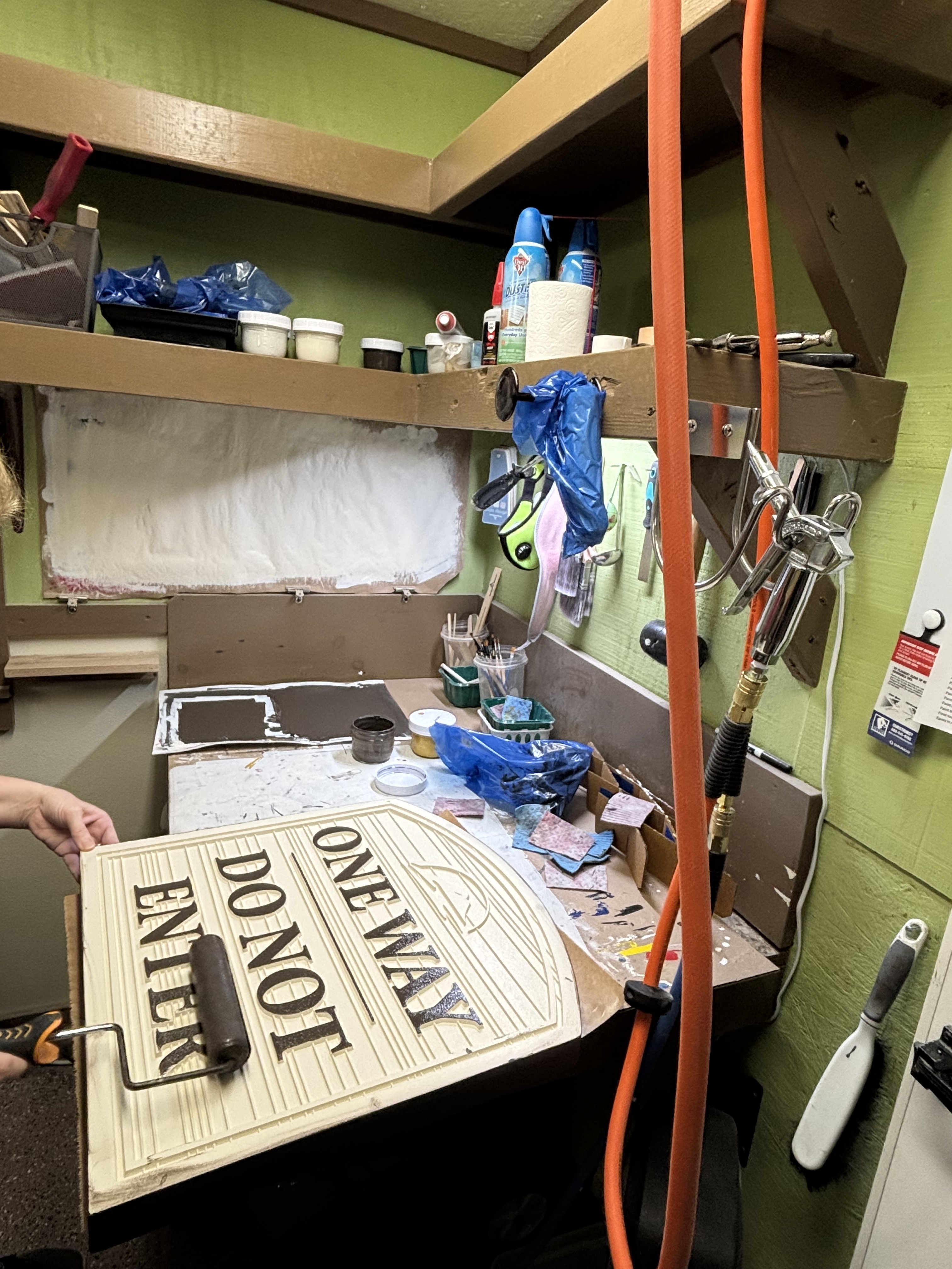

A close up of her main work area.
Her technique:
The primer and lighter color she sprays with a paint spray gun. Once she has those done and dry she rolls the back and sides.

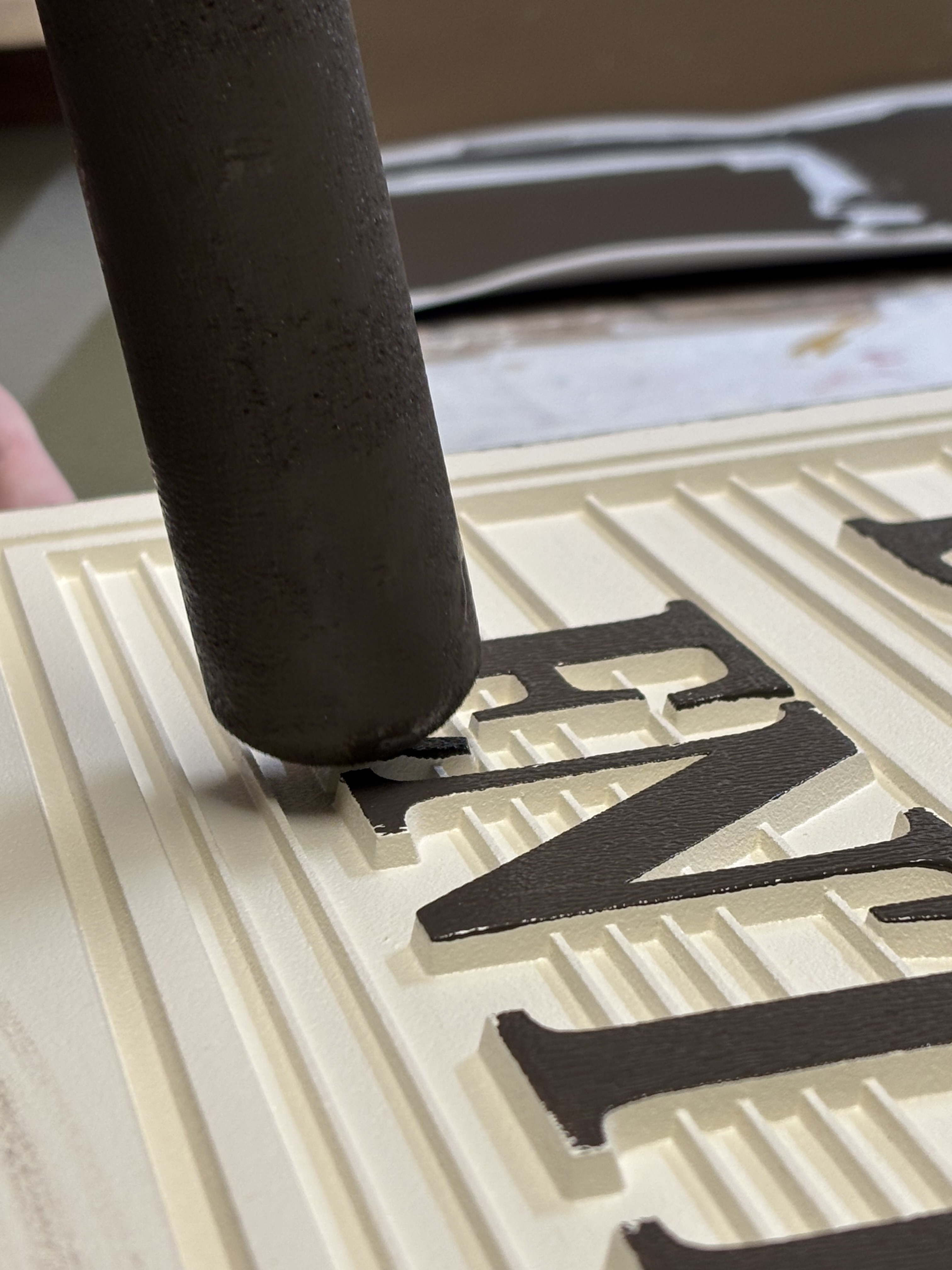

What she has found is the best way to get your paint on the surface of an hdu sign: She loads her foam roller with paint and then rolls it on the paper to her left getting the excess paint off the surface. Then she rolls the surface of the letters with light pressure. She then does some light dabbing to get the missed areas.
Once dry, she will go back with a small painters brush and do fine touch up. She takes this part quite seriously, looking for perfection.
All in all she does 1 coat primer, 2 to 3 coats of the lighter color (she is set up to spray, and it only takes her a couple minutes to get going), two coats rolled, then small brush touch up.
She tries to do a minimum of three signs to save set up time. But really only likes a max of 5 at one time.

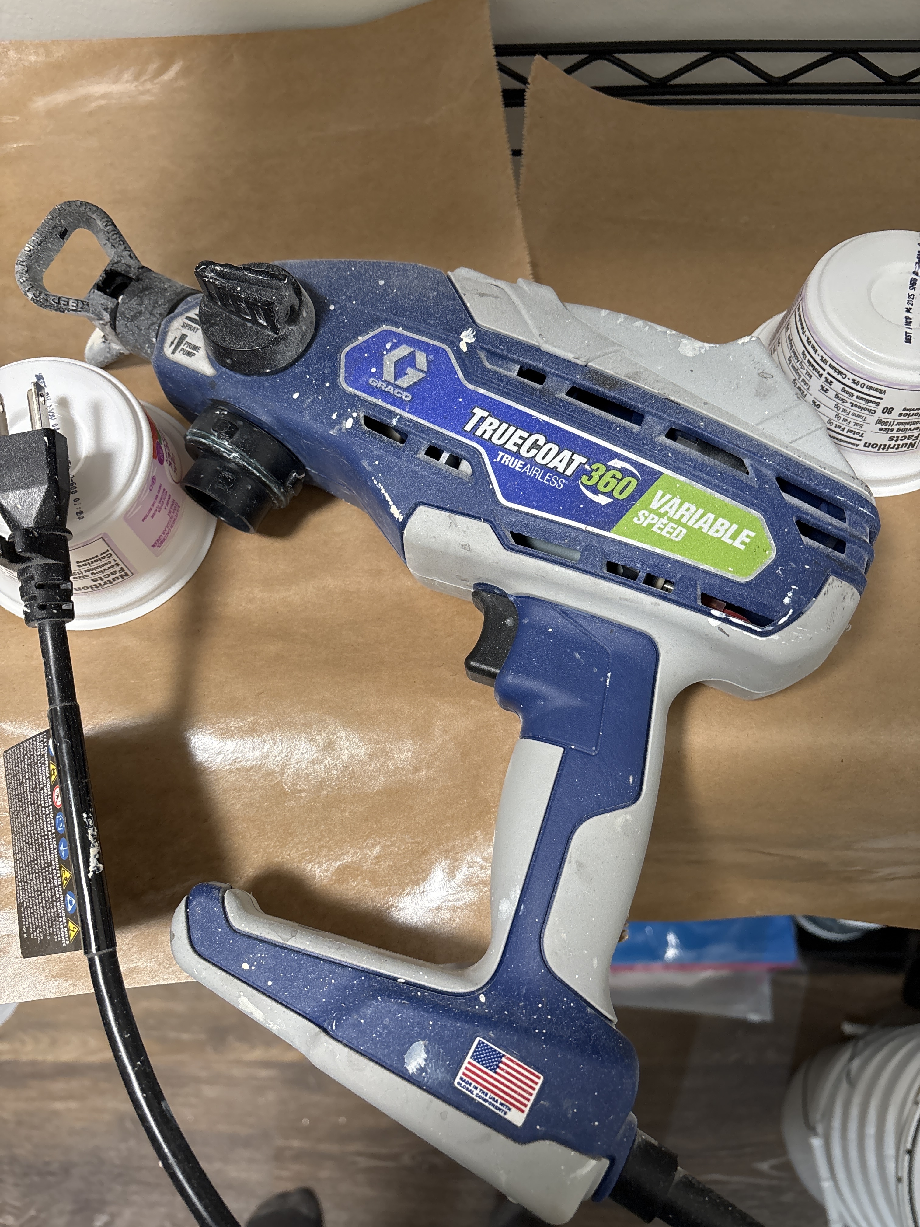

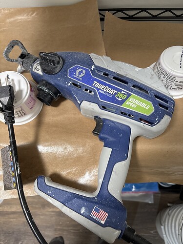

Can I ask which spray gun she uses?
@documenta
Boy do I feel like a jerk. I didn’t see the question until yesterday!!
This is her spray gun.
She said, “It works for what I am doing. There is a definite learning curve on it.”

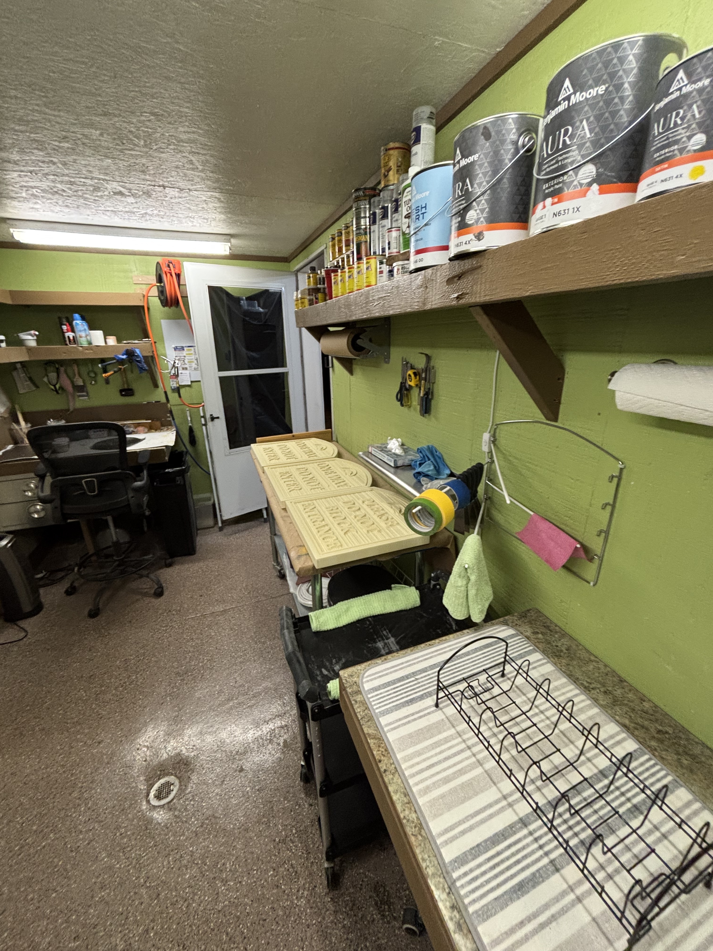

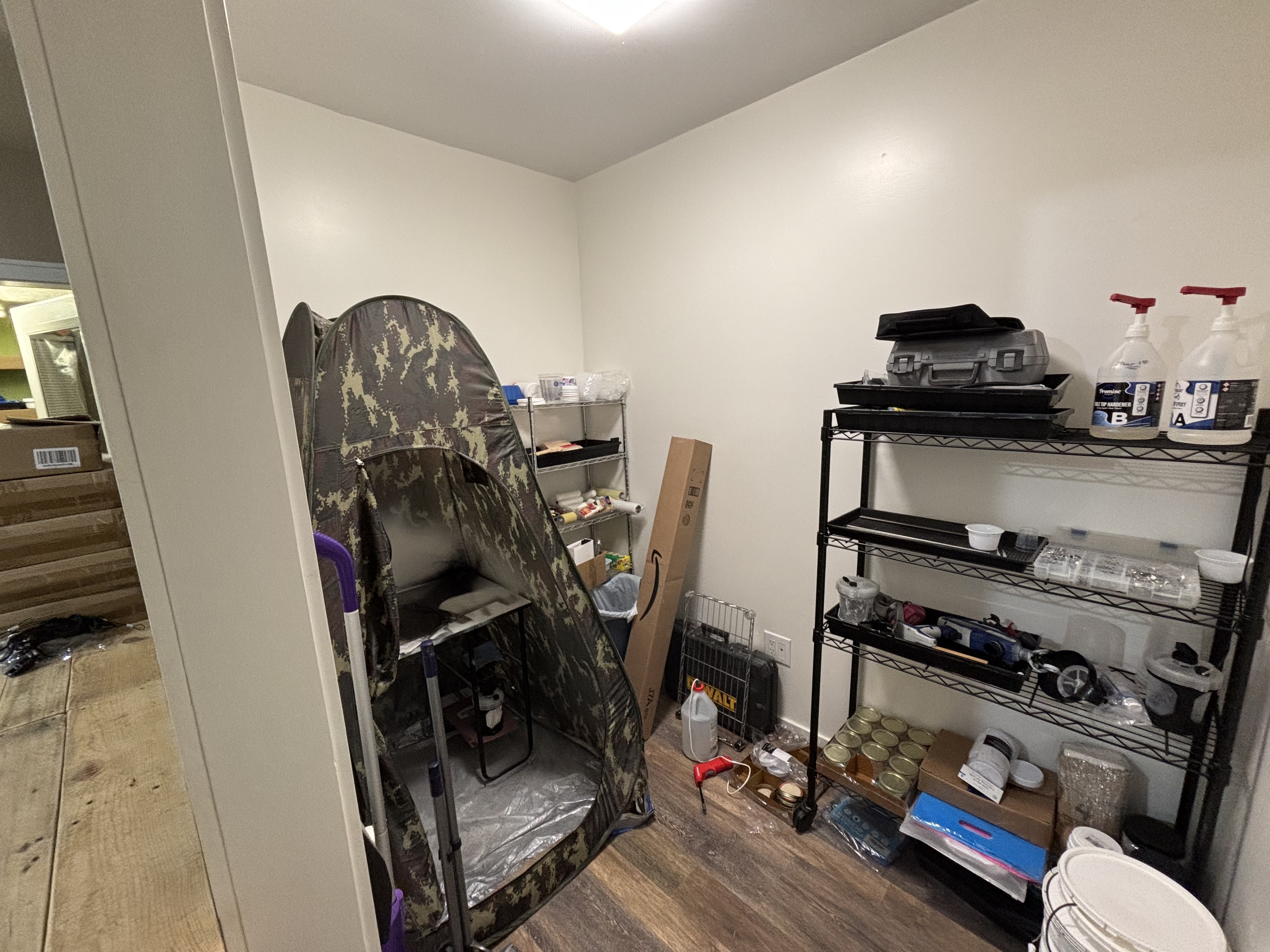

The finishing room is a mess today, but that’s because we are in production. Lots of blanks for future sign carves, several signs in production/complete, or getting ready to be painted.
The finishing room extends out into another adjacent room with posts getting painted.
Currently the spray paint room (behind the blue curtain in the last picture) is being used as a “kiln” of sorts. The fresh PT post came in a little wet and she needs to get it dry. So the curtain is closed and the heater is turned up on high! Oh… and a couple other 6x6’s getting dried too.
