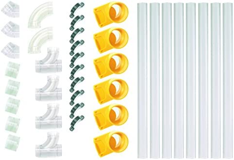

I’m looking for an outdoor dust collector that would be powerfull enough to collect dust from 9 different tools including my Shapeoko. I already purchased two of these:
I need an outdoor unit so I don’t have to deal with the noise from my shop vac. I found this on Amazon, but it’s not for outdoor.
