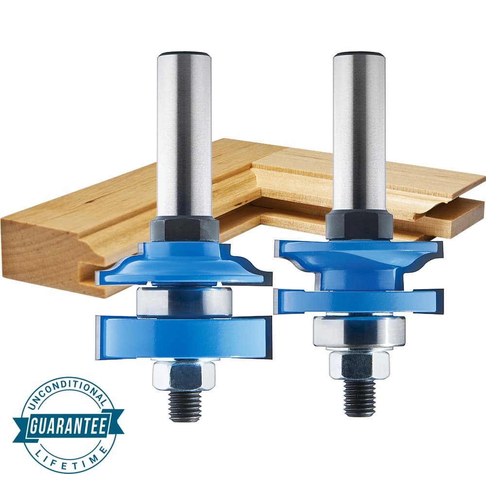

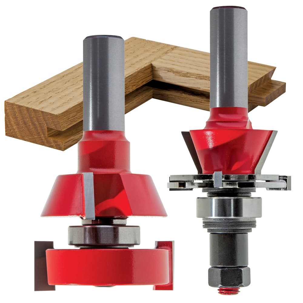

I have made a lot of cabinet doors. If you have an entire kitchen it would likely be easier to make cope and stick doors. If painted then the referenced video would likely work fine but if you are going natural wood then cope and stick would be the way to go. I have the Frued router bits that can make extended tenon and the cutters to make glass front doors. It is a fantastic system for making traditional doors. Personally I like Shaker style and flat panels but the raised panel bit can be used for raised panel doors.
I also have the Rockler ogee bits but they are not adjustable like the Frued.
Both brands need at least a 2 1/4 HP router to run them efficiently. Plus you need something to hold the parts in place while routing.

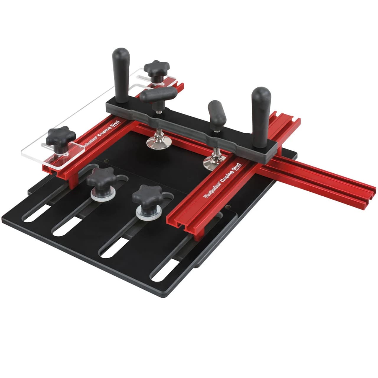

I have the Woodpeckers coping sled. I have had cheaper ones but the Woodpeckers is much superior.

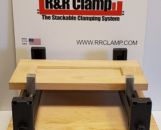

If you are going to make a lot of doors on a continuous basis you need a lot of clamps. I have many Bessy parallel clamps but the R&R cabinet door clamps are superior for doors. You can stack them and get a lot of doors clamped at once.
