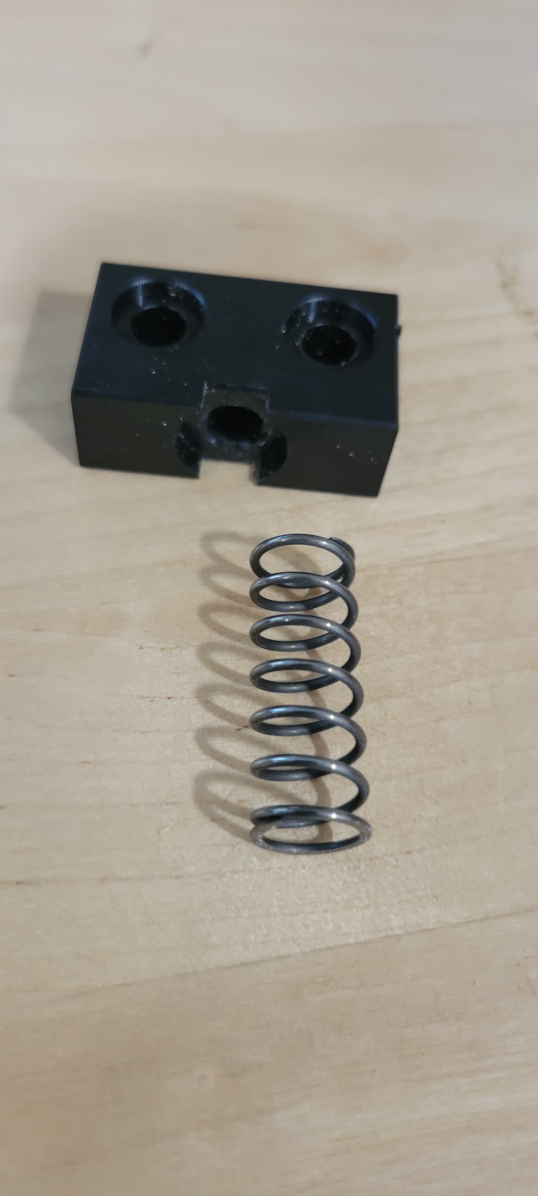

Part and Spring fell off of my Shapoko near or around the Z-Plus Z-axis assembly, behind the Dust boot somewhere…possibly.
I was carving a 3.5 in post and accidentally set my zero wrong. Everything works perfect at this point after checking it and jogging it around.
Please see parts in question.
Those are the anti-backlash nut and spring.
Pretty straight-forward to reinstall — write in to support@carbide3d.com for instructions and a photo.

Be very careful to keep the unit flat when removing the plate that mounts the router UPWARD and flat. If slides come off the Slides/rails under it, ball bearing may come out as the PDF states. I had one fall out and put it back
