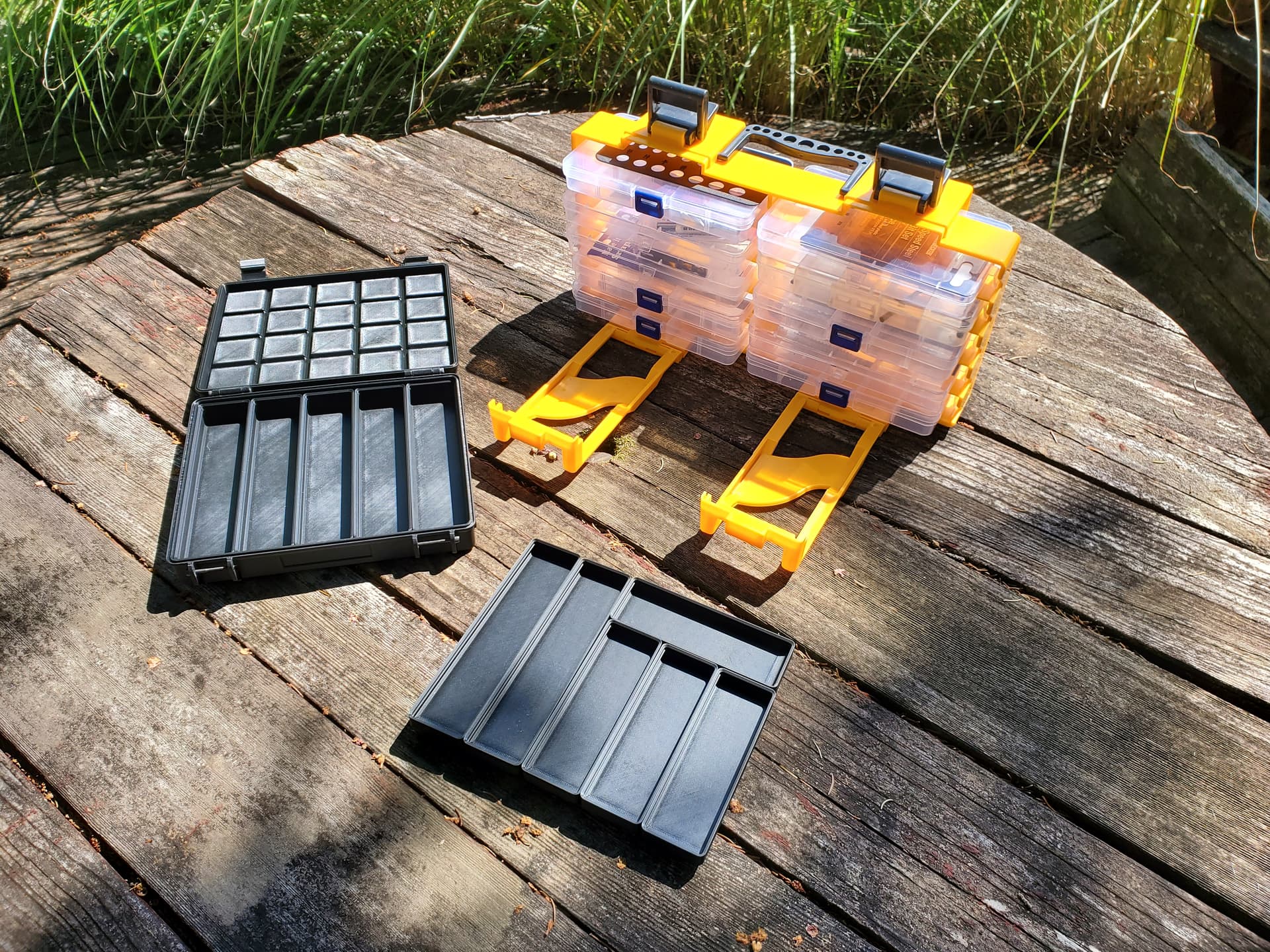

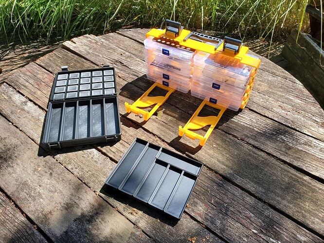

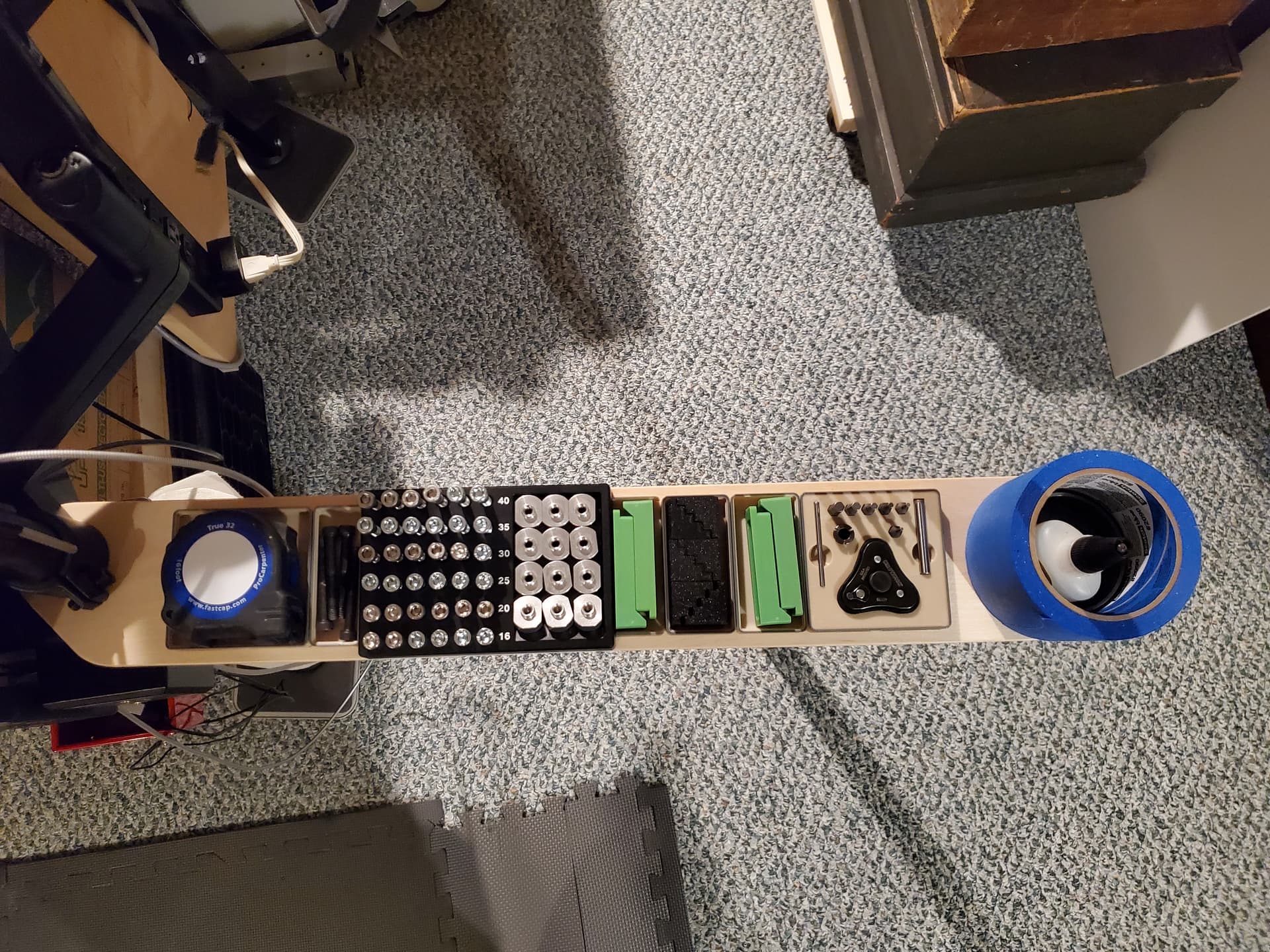

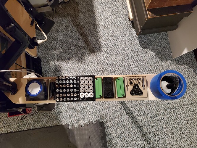

This has come up a few times since, and I’m considering standardizing on it myself — towards that end, I have made and printed one small case as a test:
which worked well to hold most of my odd drill bits and associated odds-and-ends.

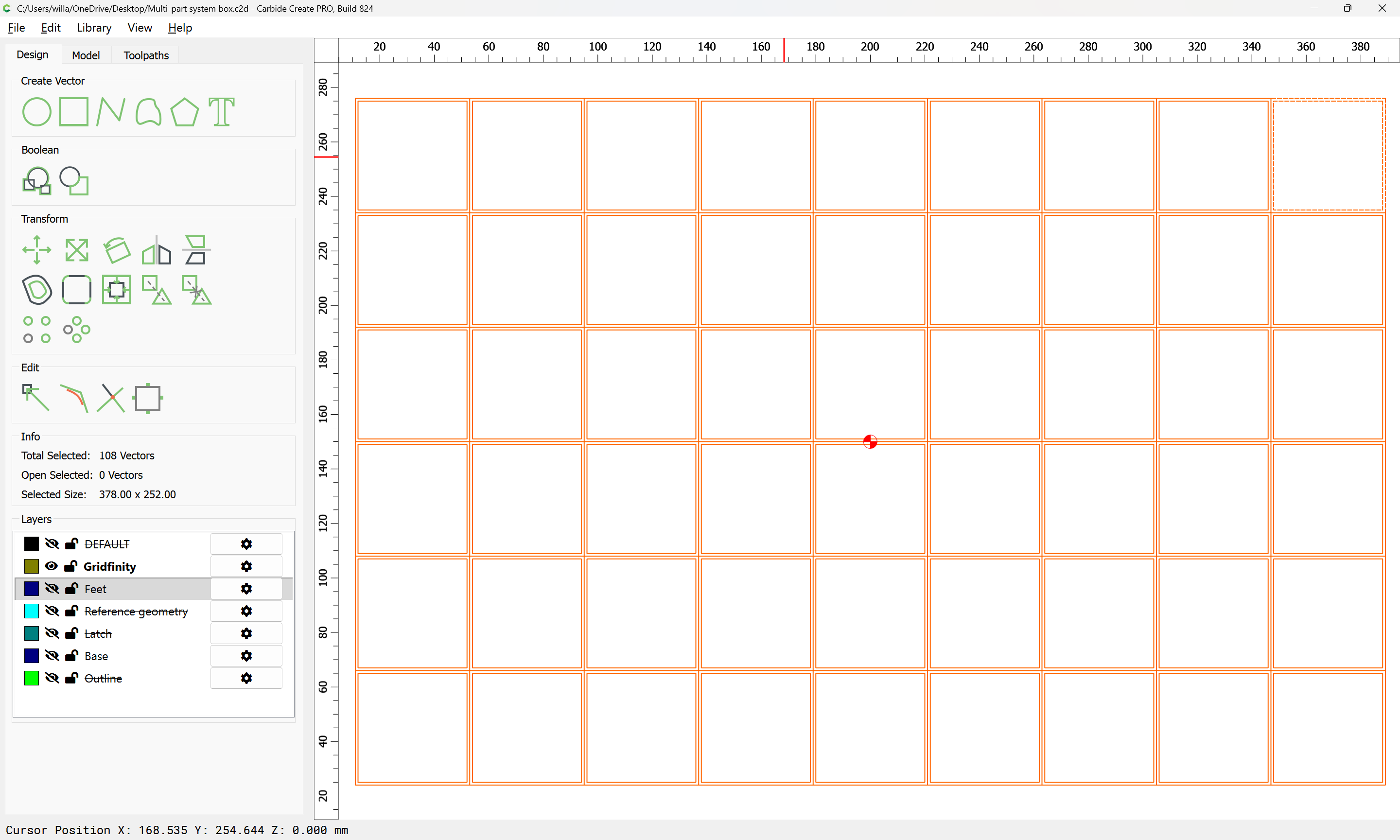

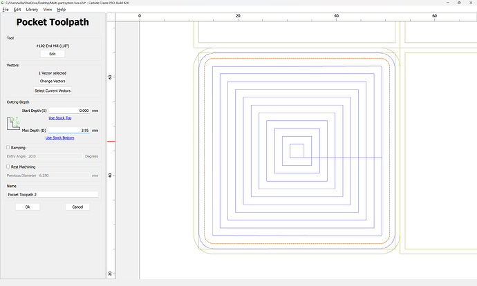

for which there is a PDF drawing, so adapting that to make on the machine seems promising, but the first thing which is needed is a baseplate in Carbide Create (assuming that it makes more sense to cut one as part of cutting the bottom of the box…)
Given that the dimensions are written up at:
and I’ve rather consciously chosen not to use magnets, this should be pretty straight-forward:

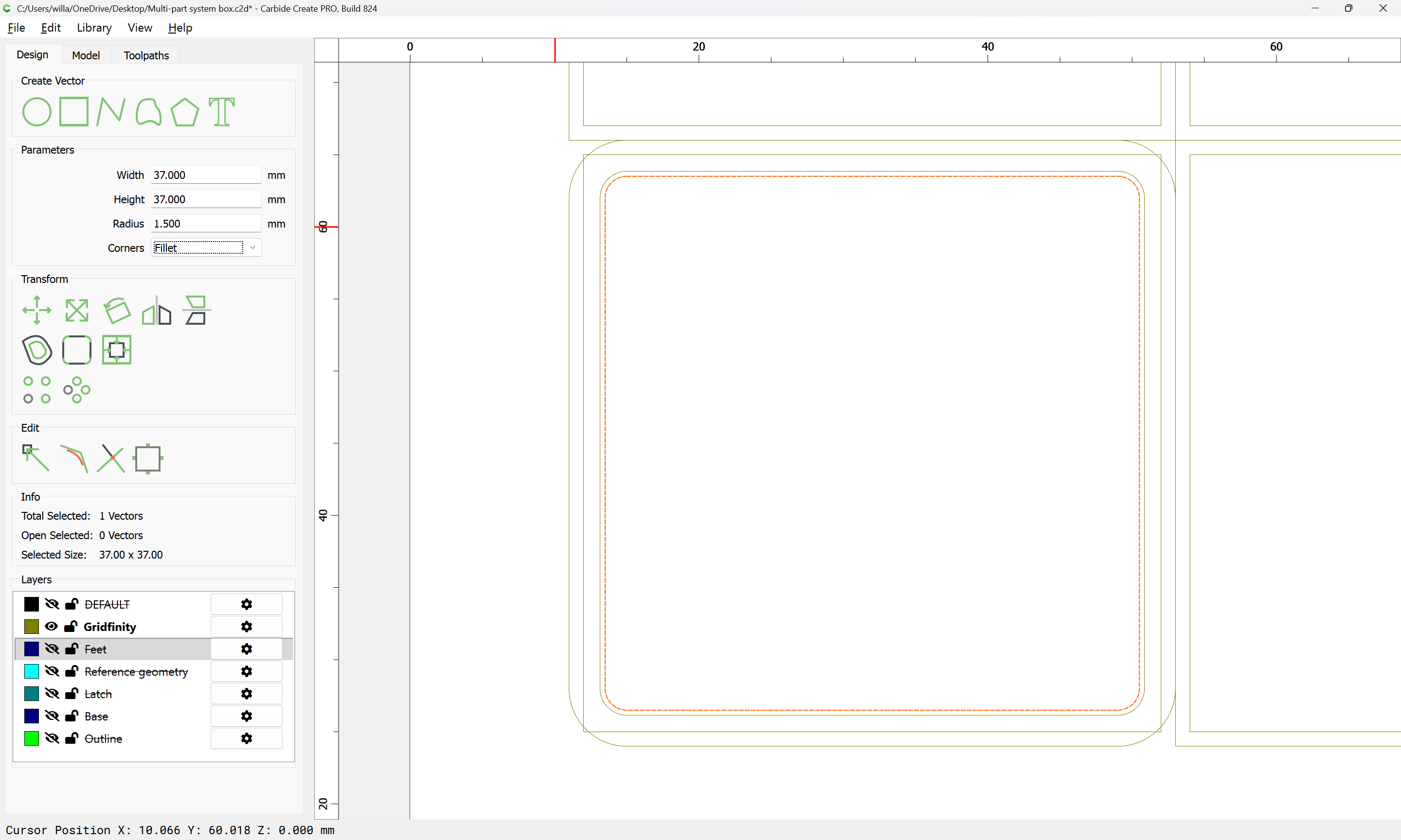

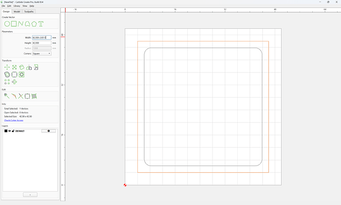

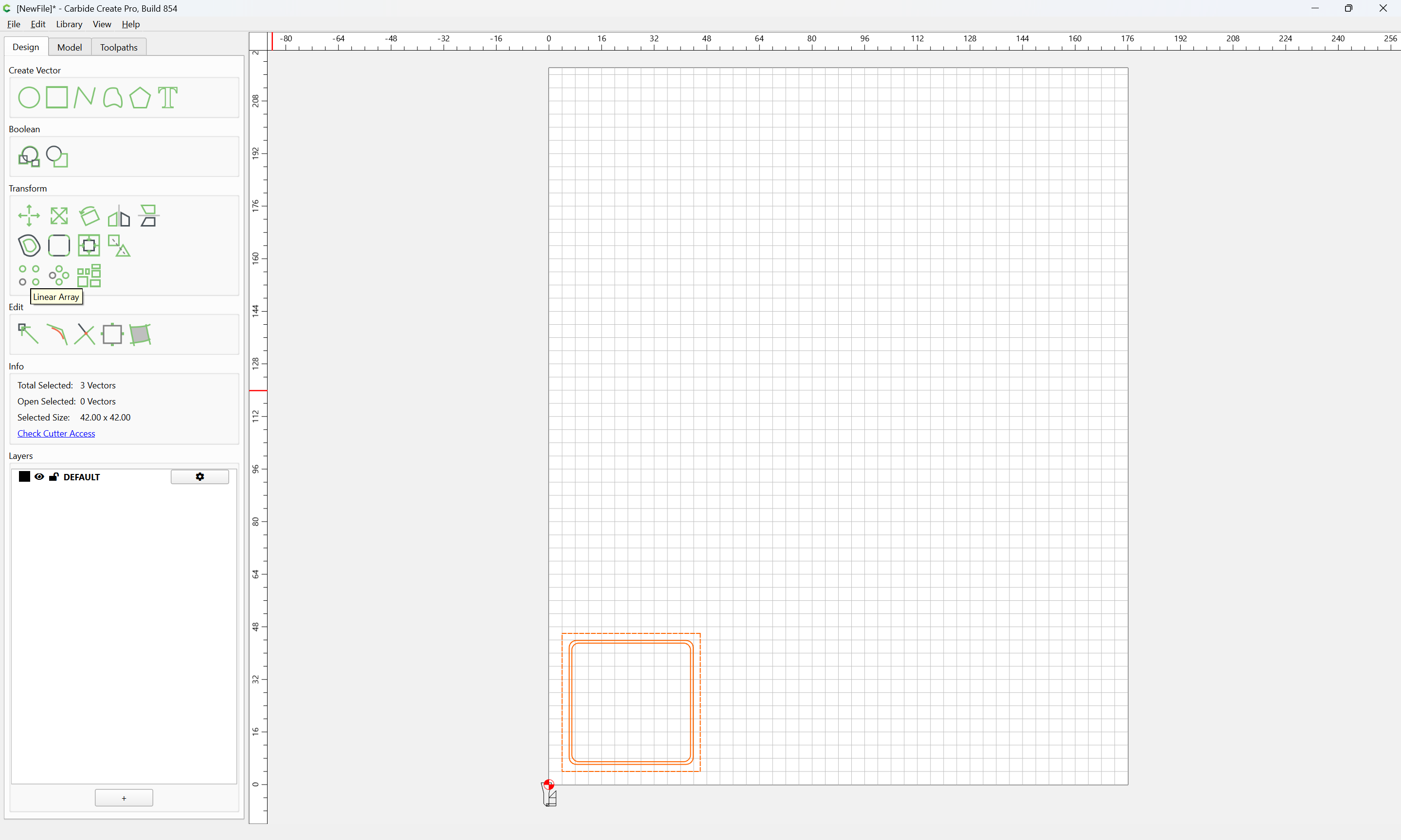

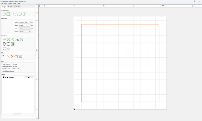

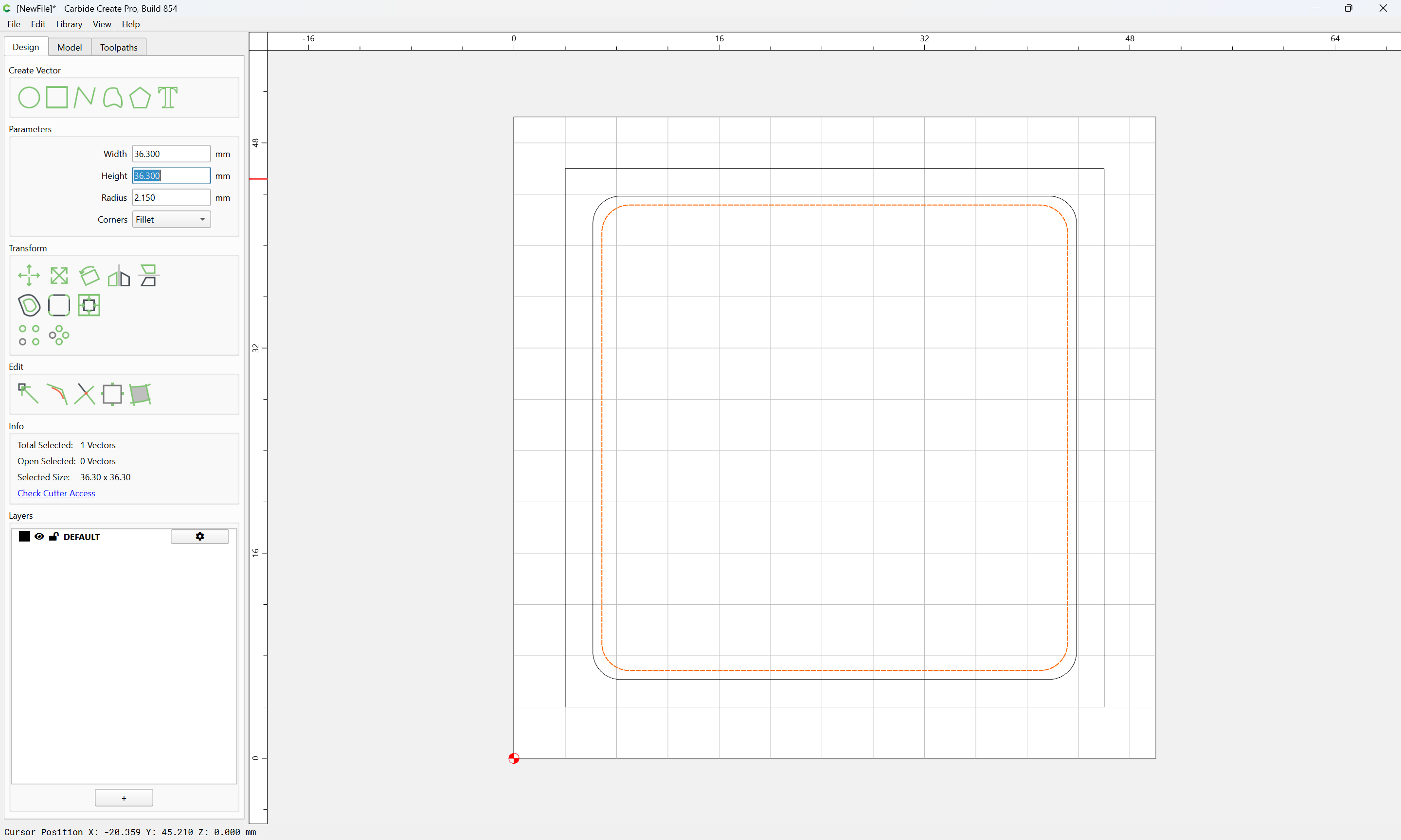

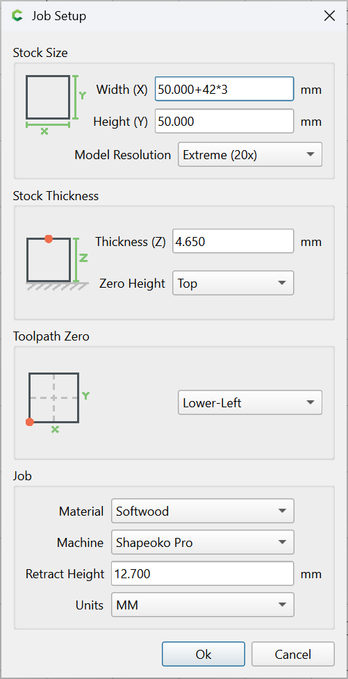

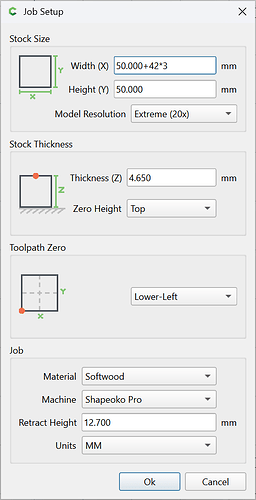

The underlying grid is 42mm square:
so it should be pretty-straight-forward to just draw up the geometry and assign toolpaths to cut this into a surface…
The baseplate grid is simply a pair of nested rounded squares:
with appropriate toolpaths:
to appropriate depths…
until one arrives at the lowest angled section:

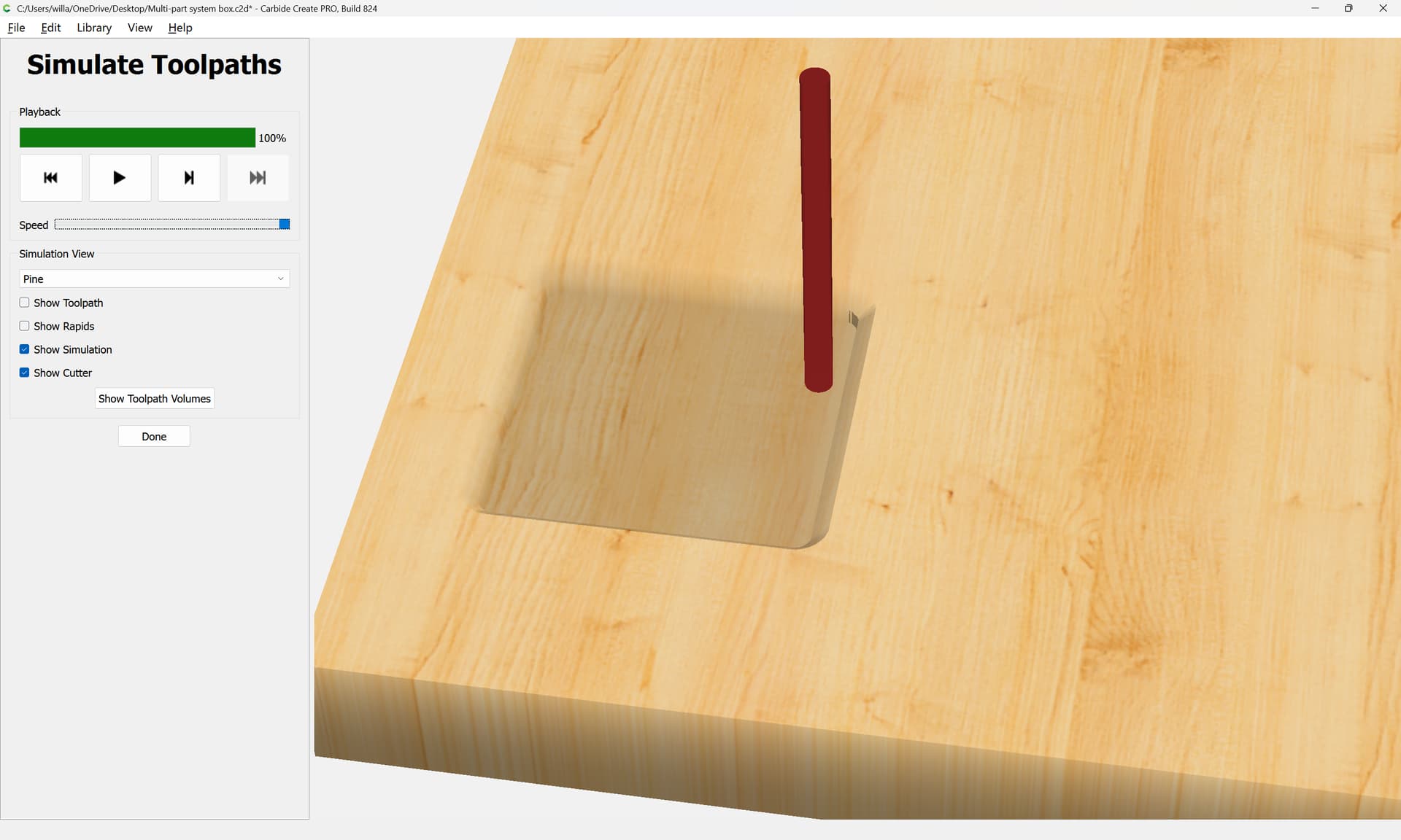

which wants an 0.7mm diameter 90 degree V endmill with a rather long/delicate shank…

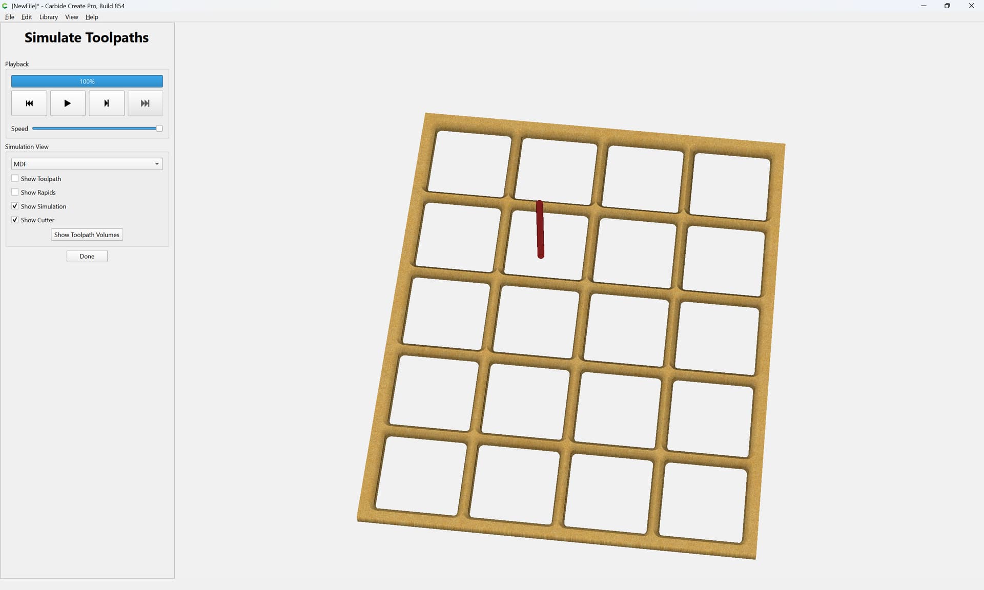

Initial preview (once geometry association w/ toolpath was fixed) seems promising:

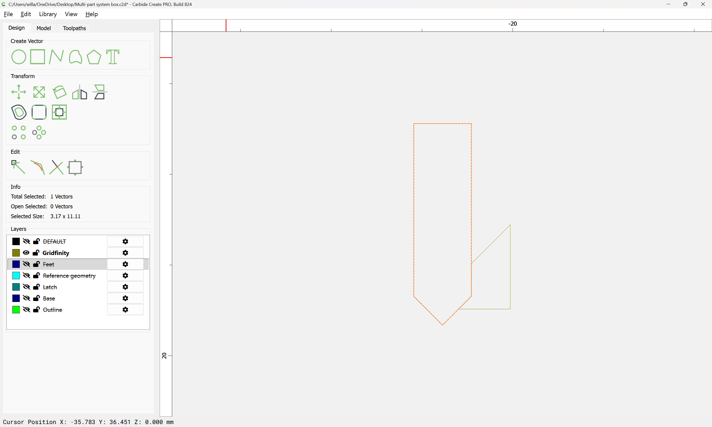

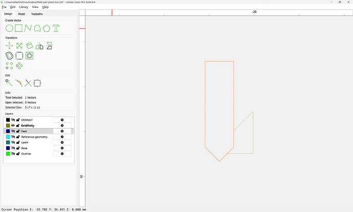

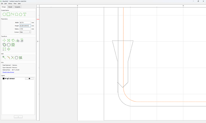

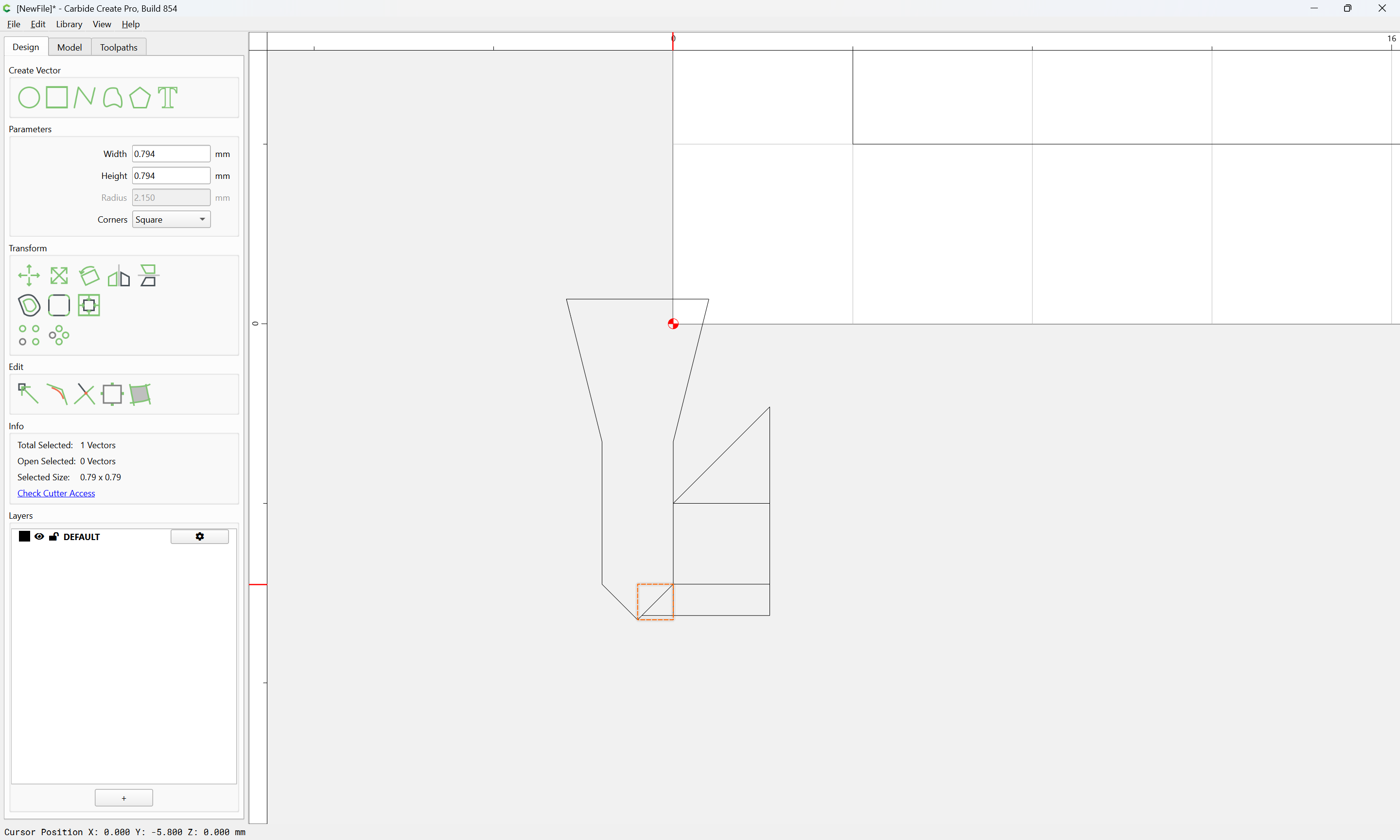

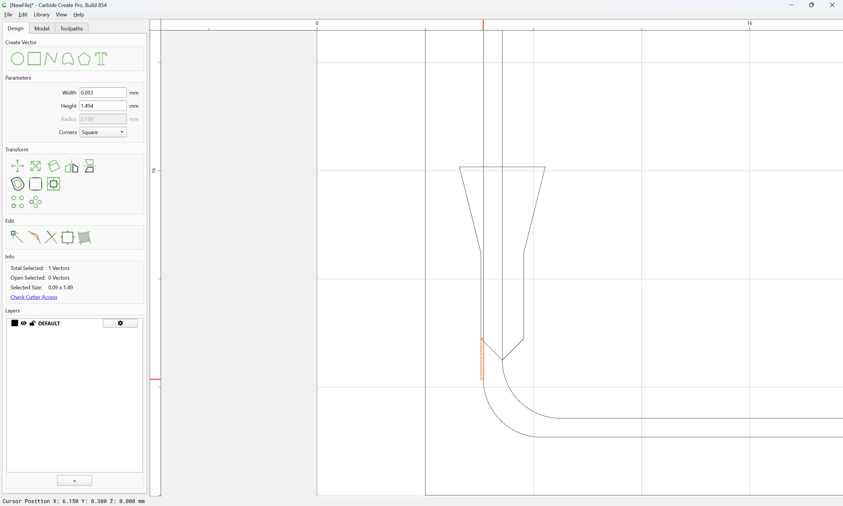

Drawing up the baseplate in profile, as well as a 1/8" 90 degree V endmill we get:
So if the bottom pocket/angle is increased in depth by:
we should be able to preserve that geometry, but a V carving toolpath would not work since it might try to lift out at an angle — instead, we use a No Offset Contour at the appropriate depth and if we also cut all the way through with the V tool, it shouldn’t be an issue to find a small enough square endmill to finish the cut.

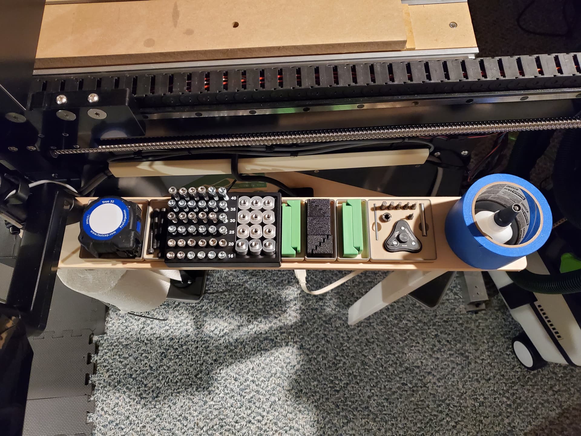

What is this part called?
Those are the clamp steps from:
https://carbide3d.com/3d-print/clamp-step/
Thank you. Printing now.

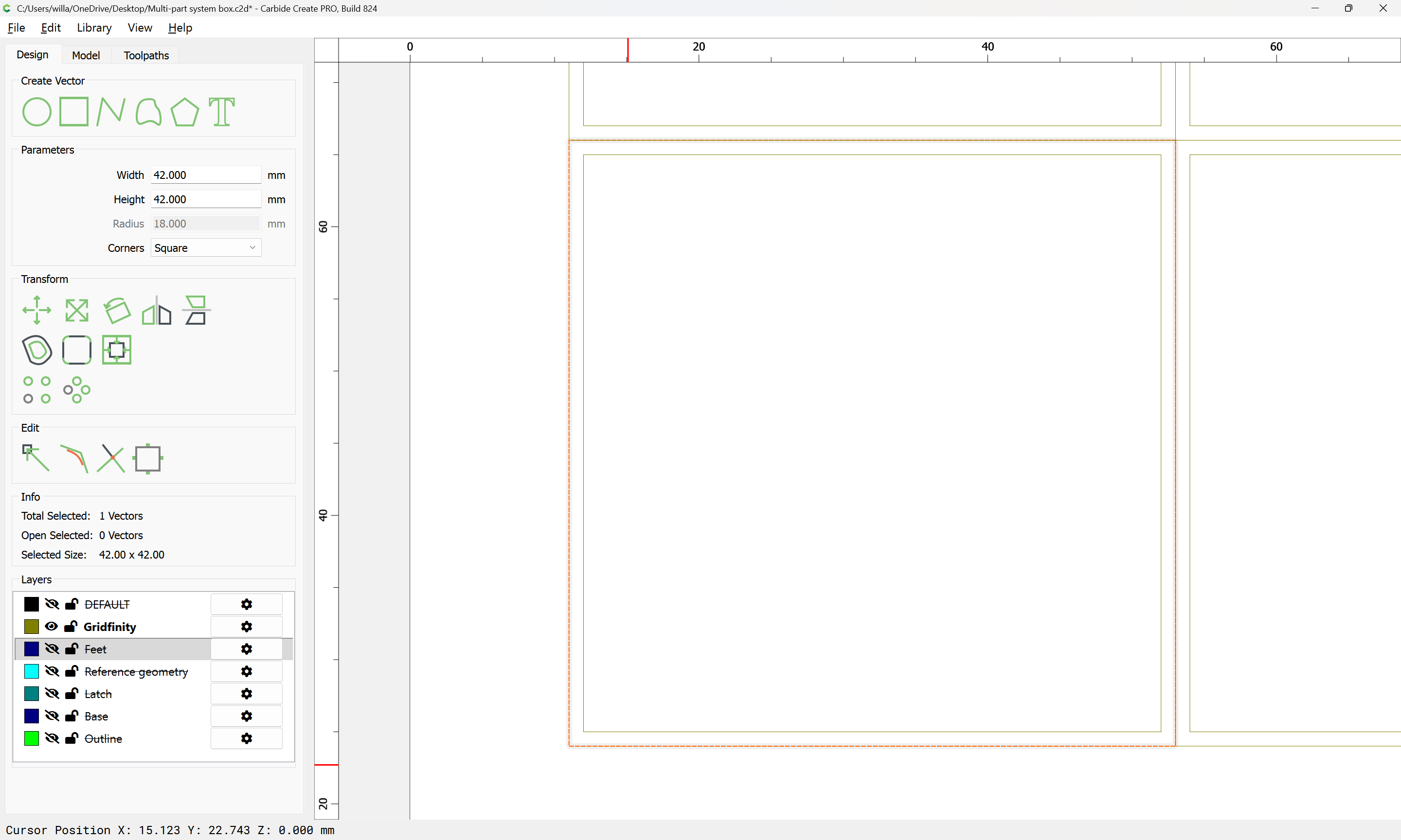

This looks to be a very clear drawing of the design:

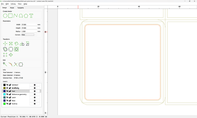

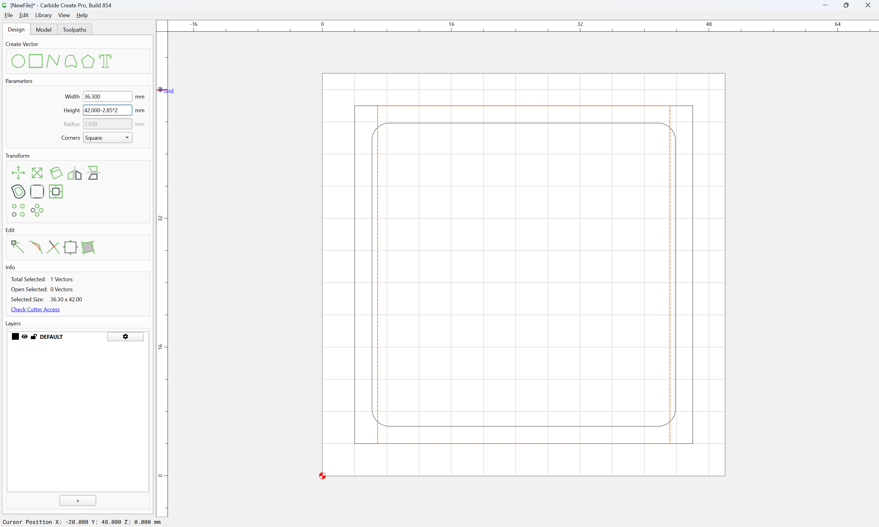

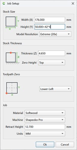

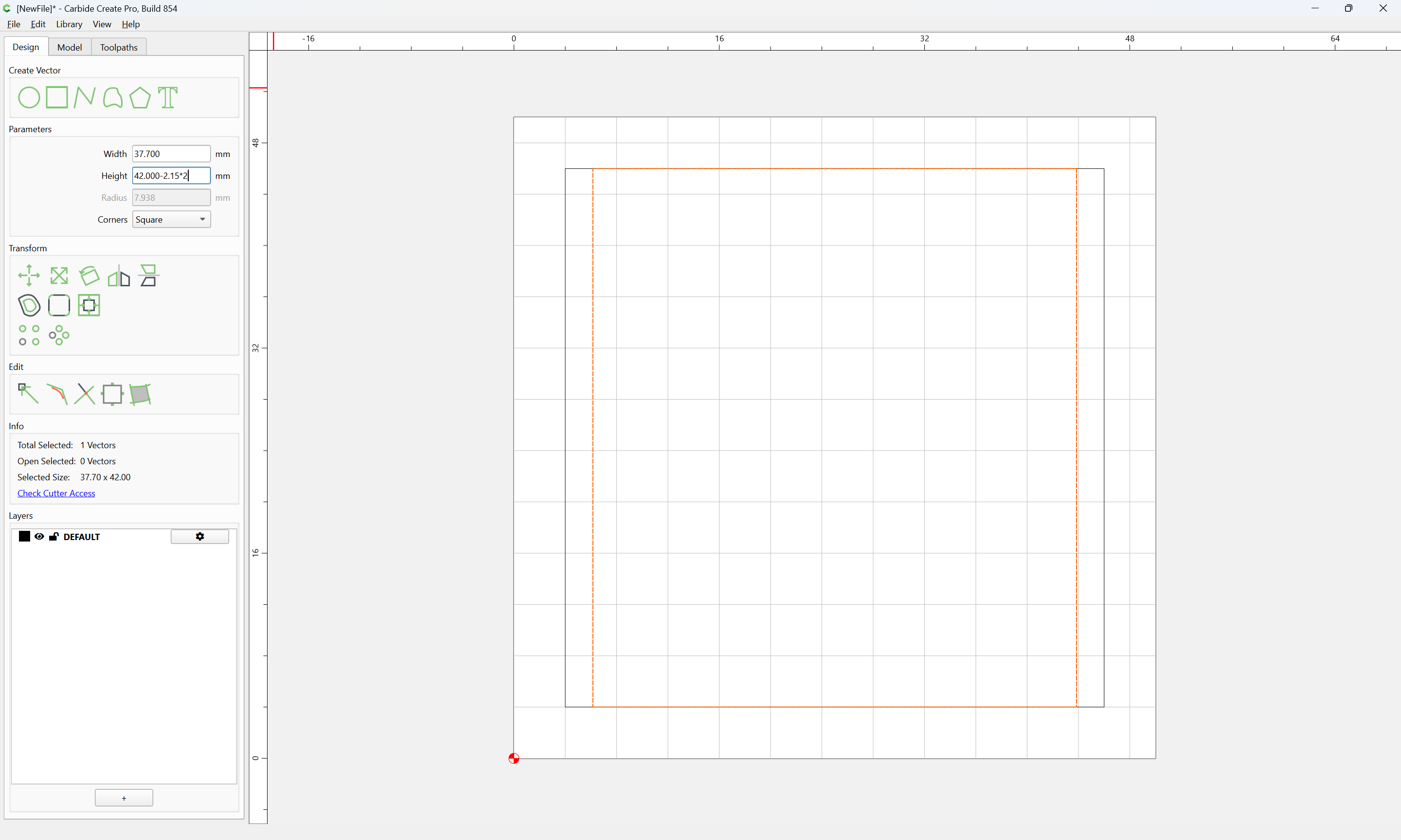

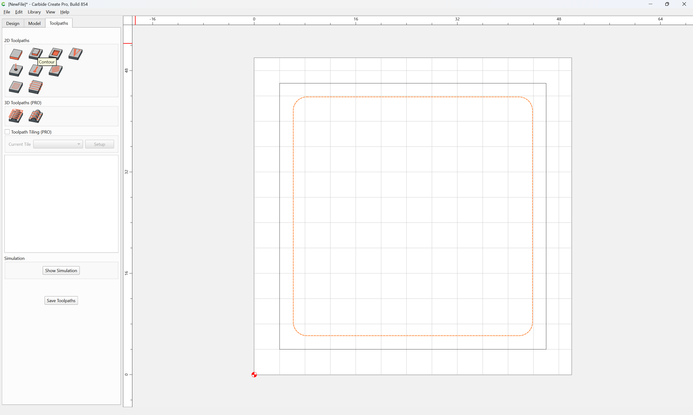

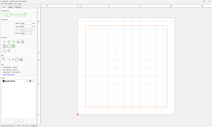

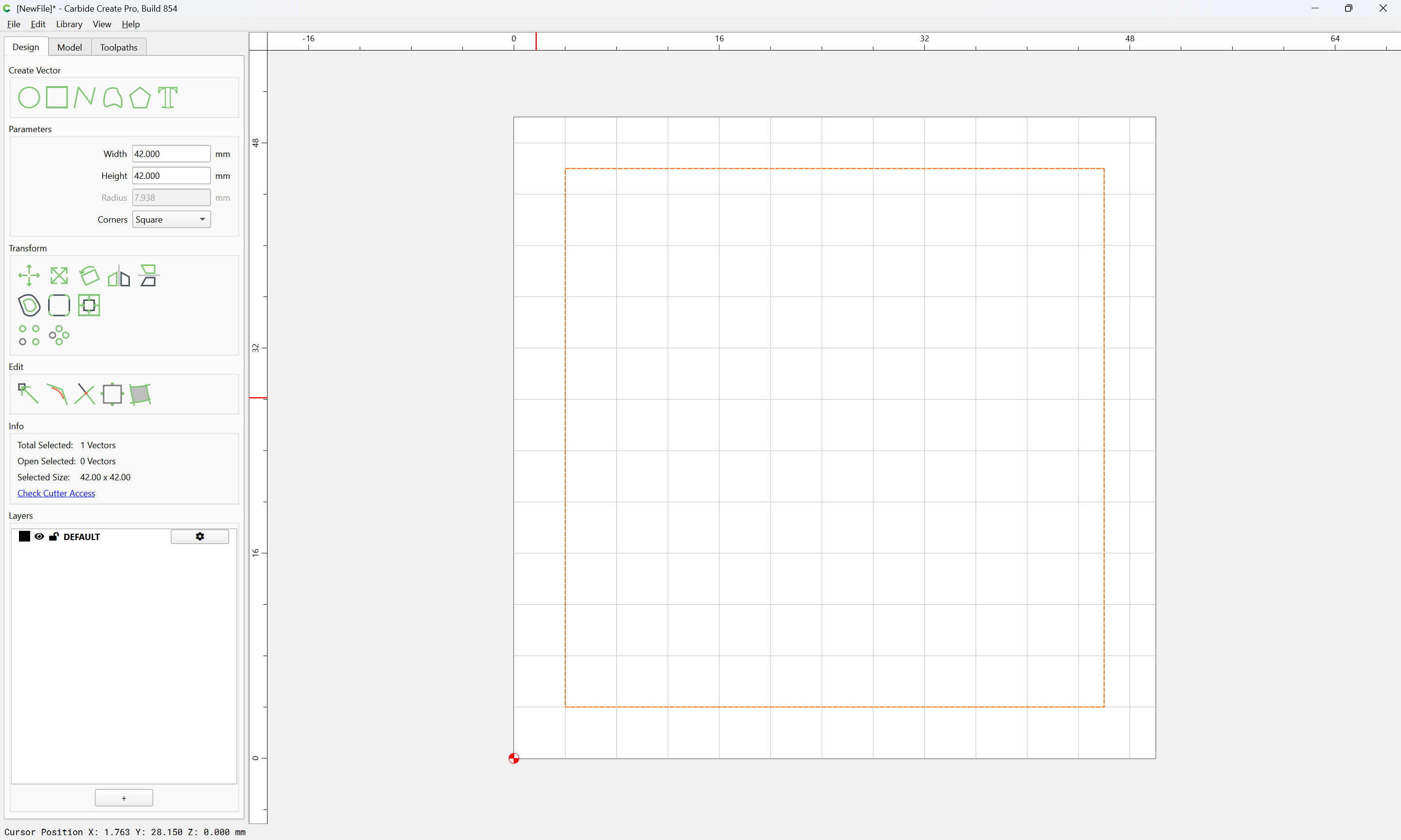

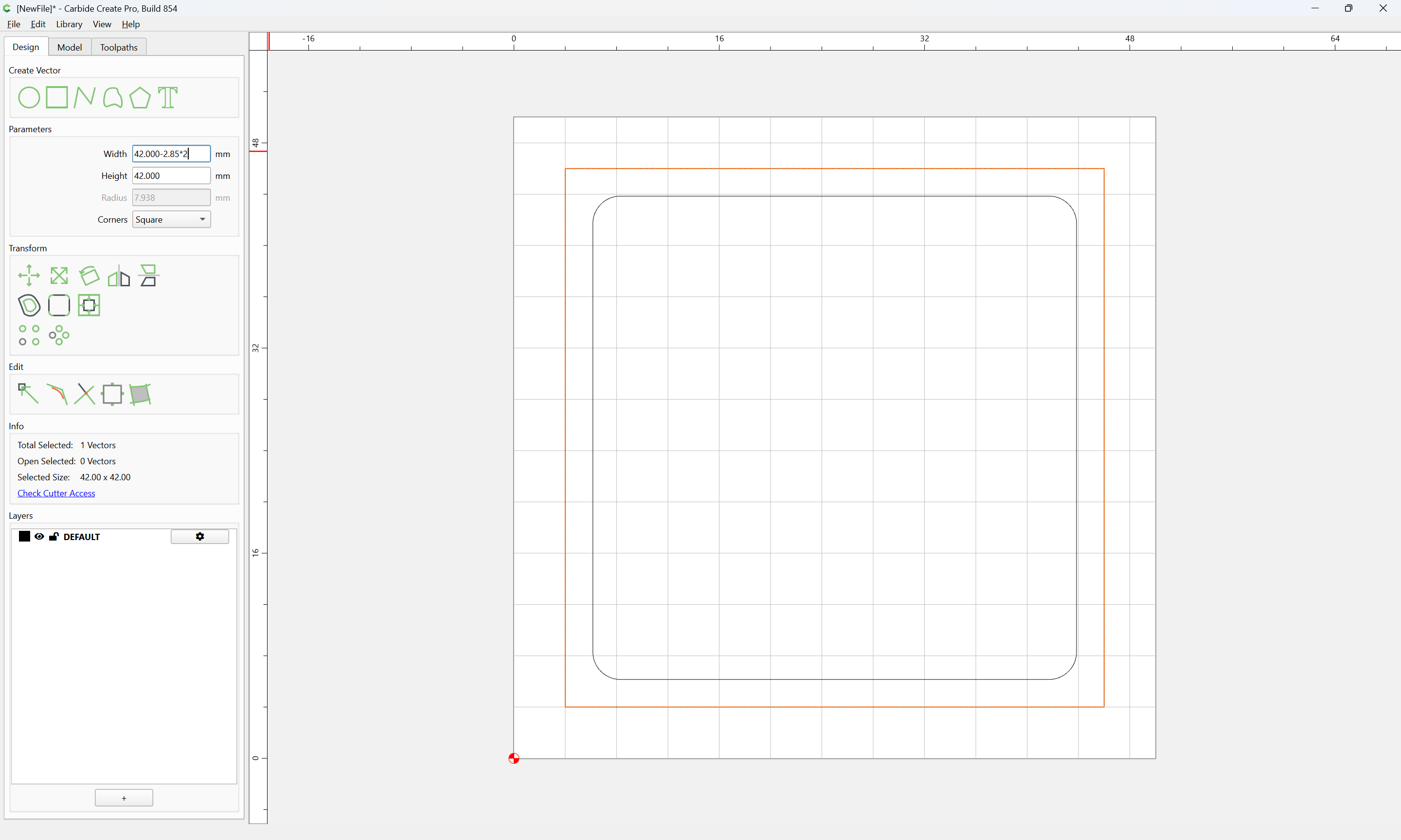

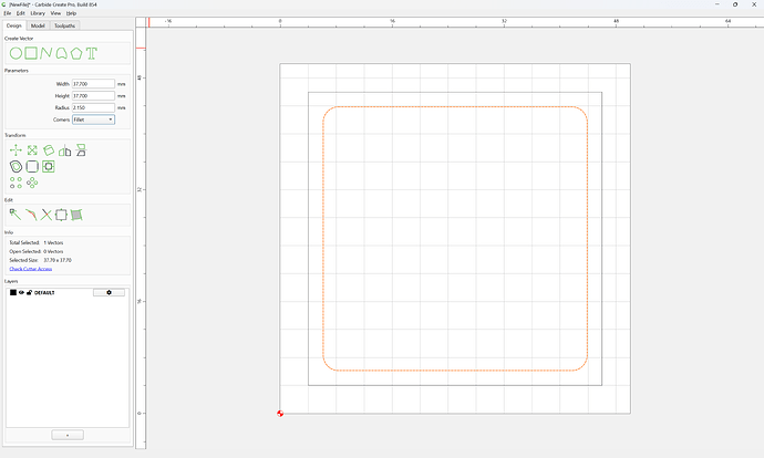

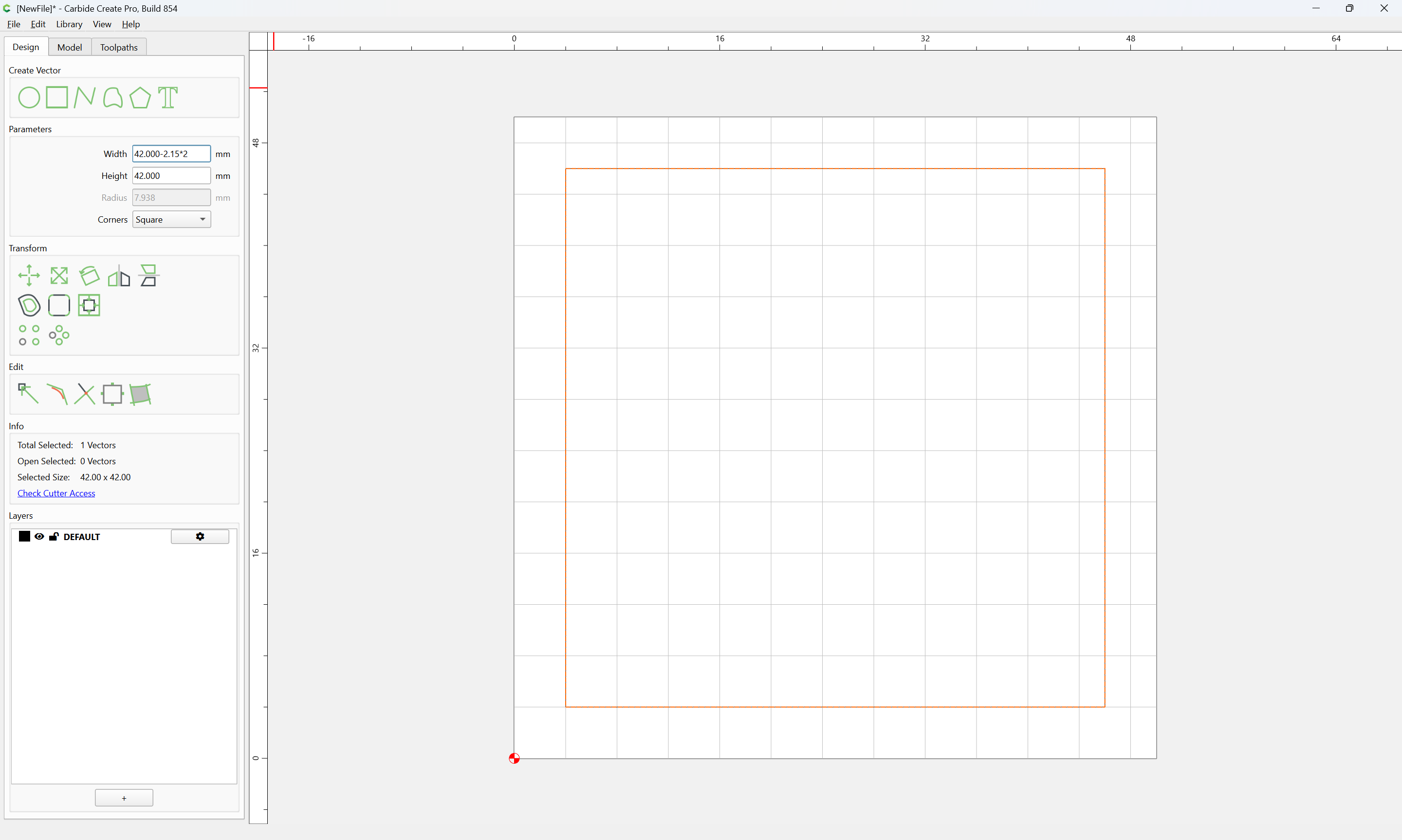

Since we will be using No Offset Contours, the basis is a 42mm square:

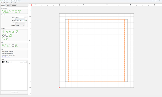

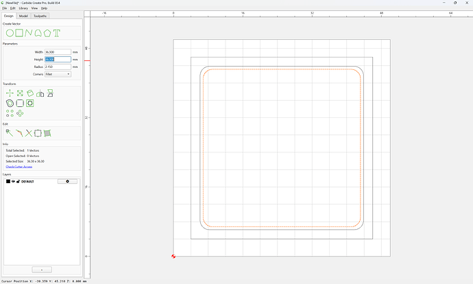

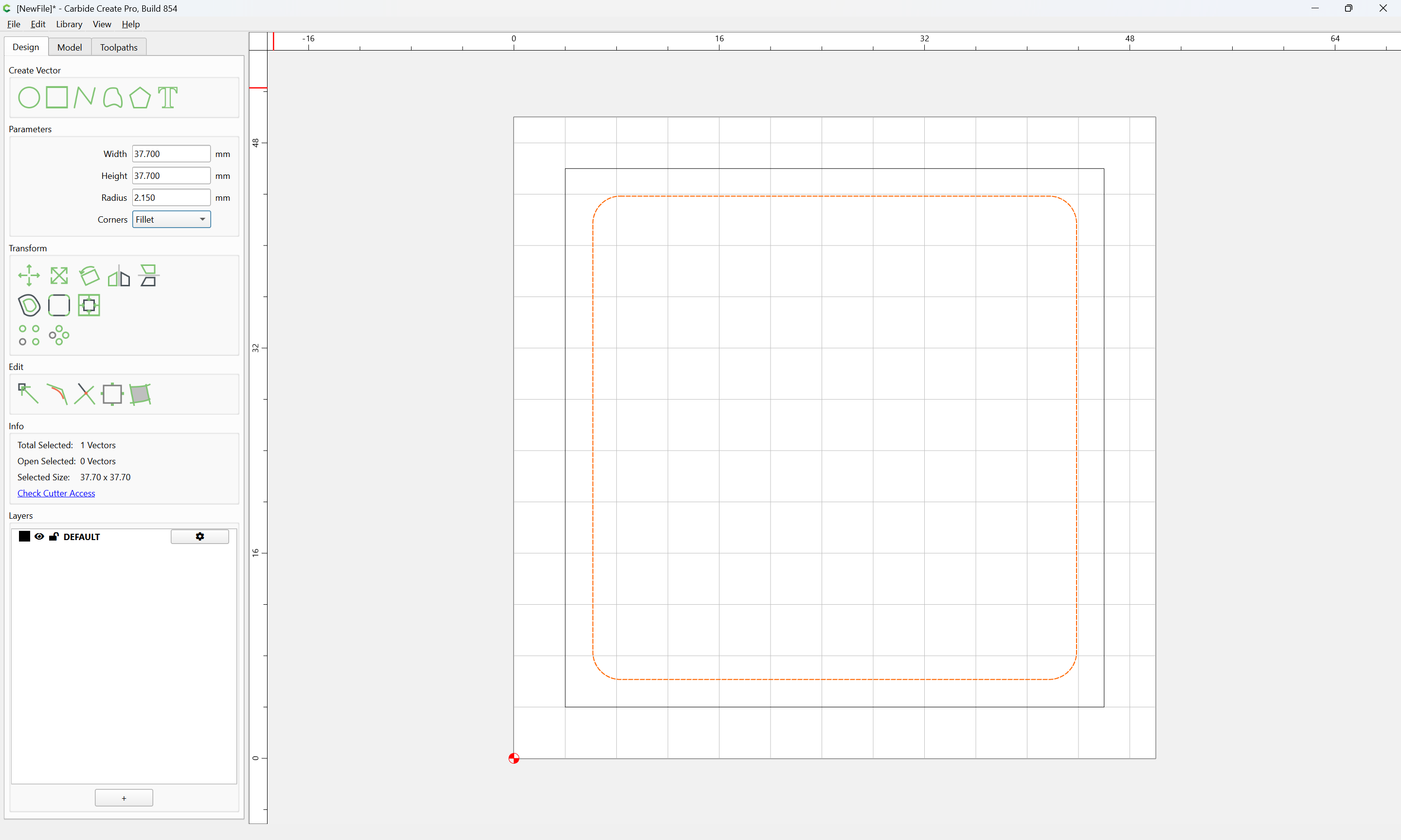

Duplicating that we then reduce the size:
and set the radius to match:

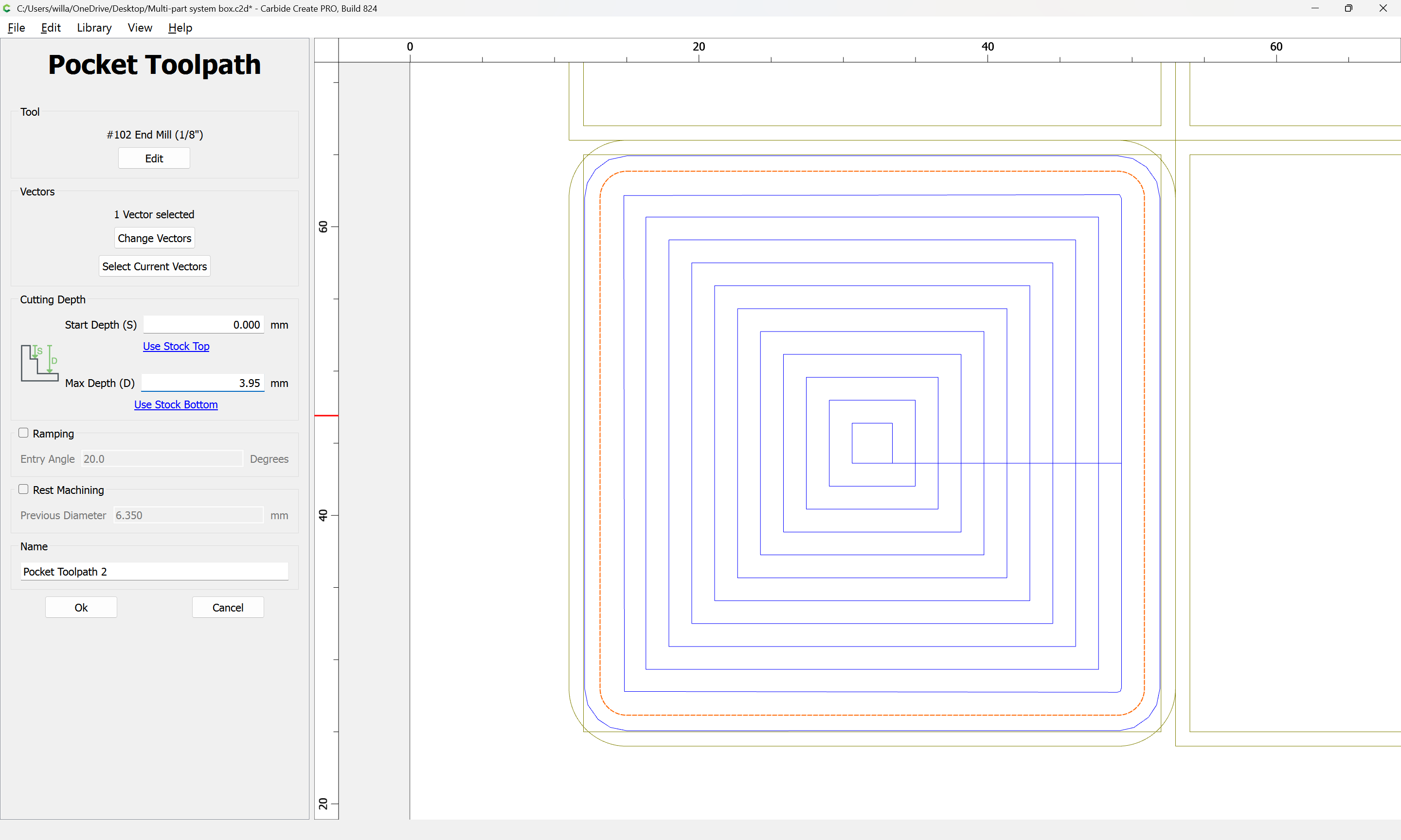

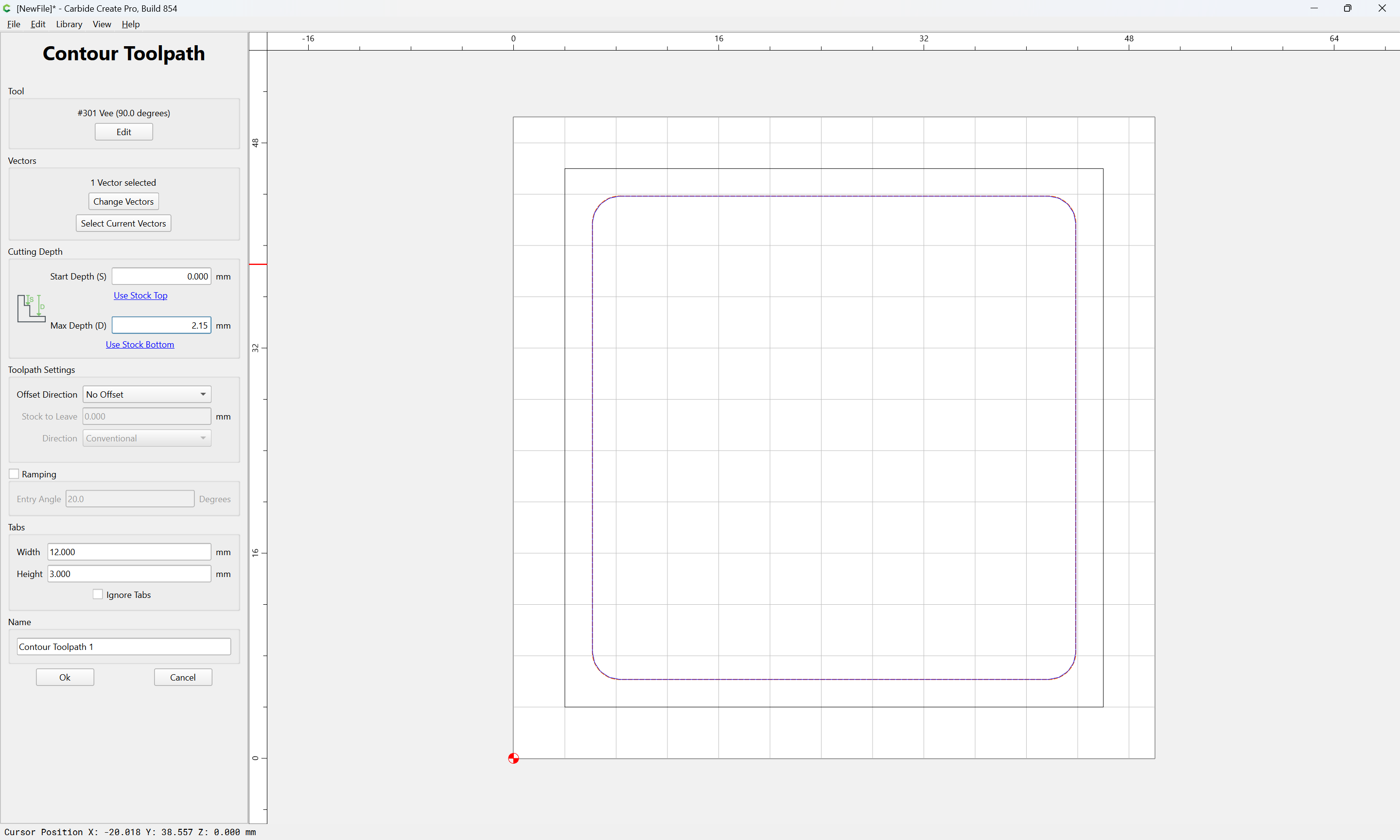

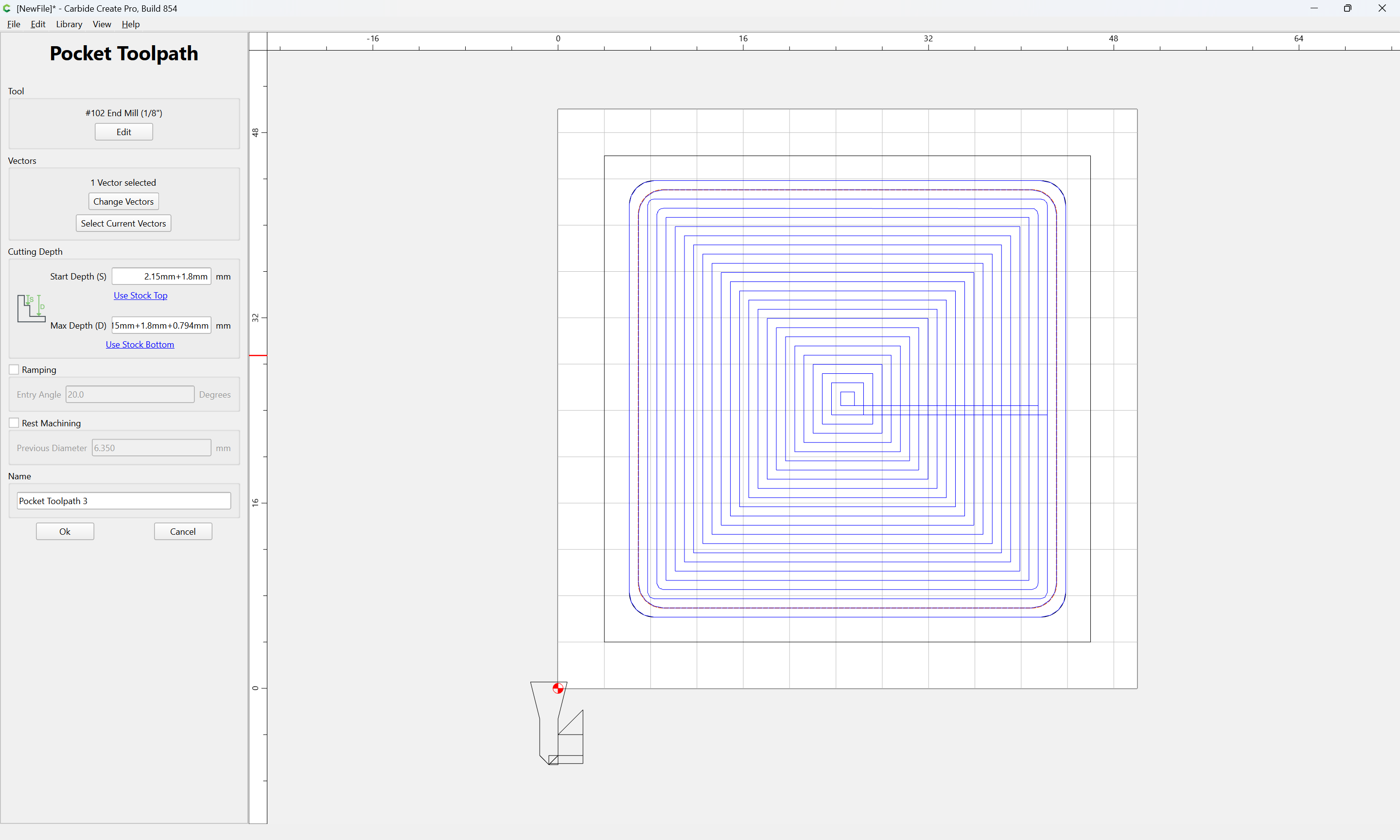

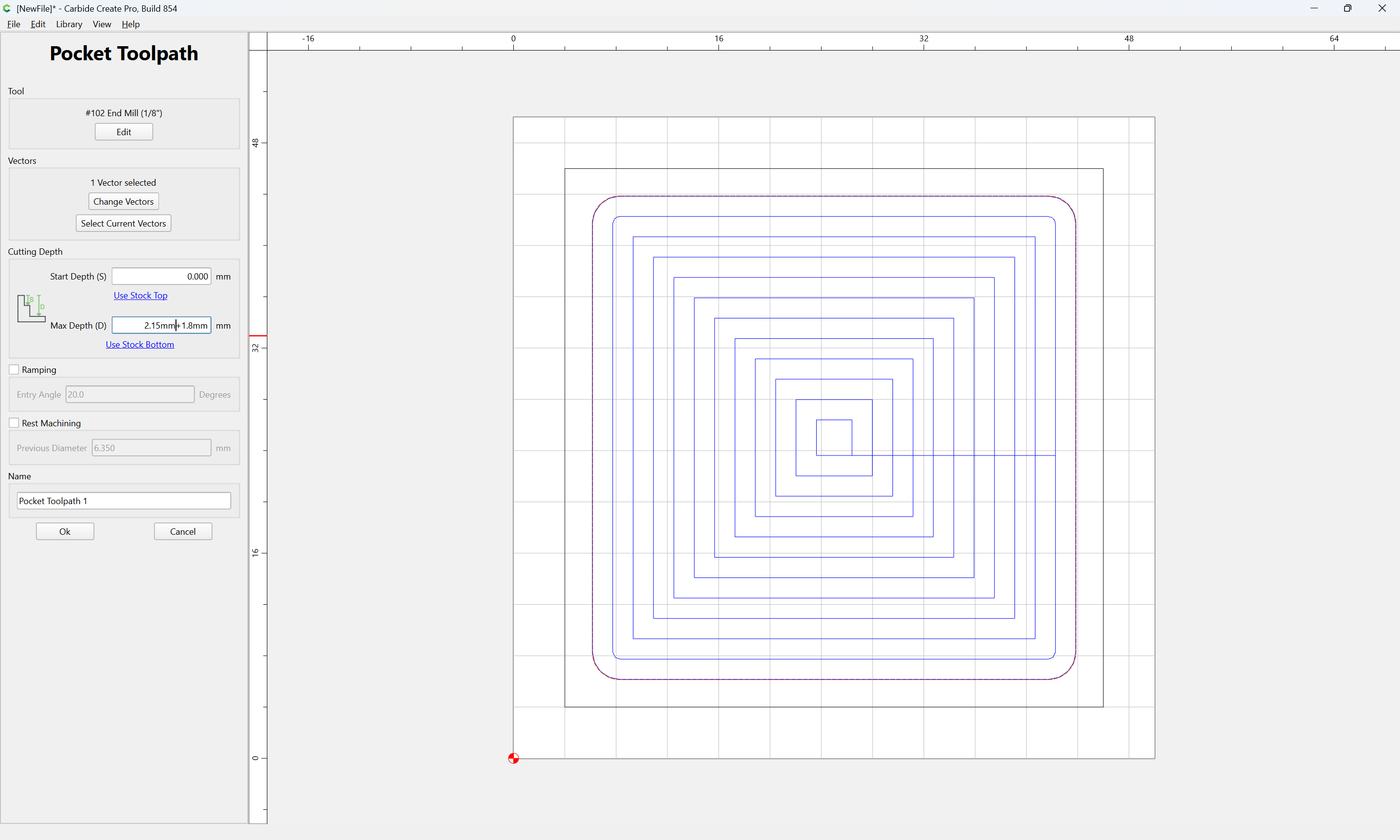

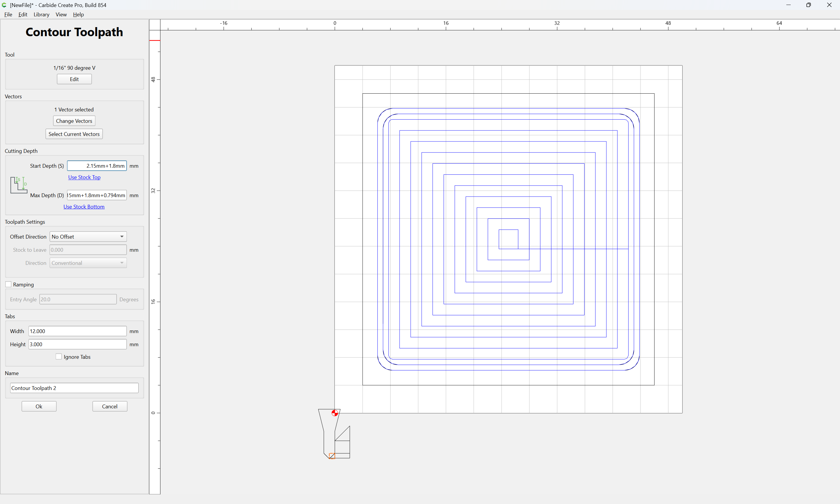

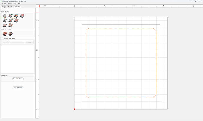

This then gets two toolpaths:

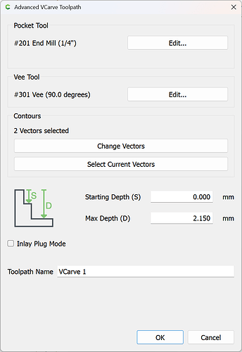

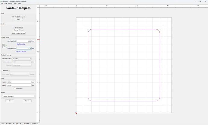

A No Offset Contour with a 90 degree V endmill:

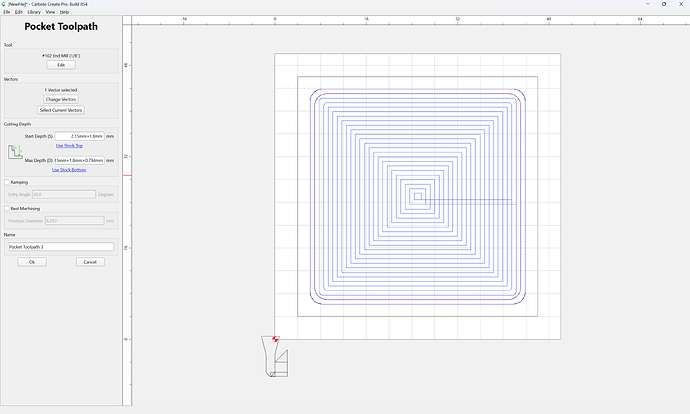

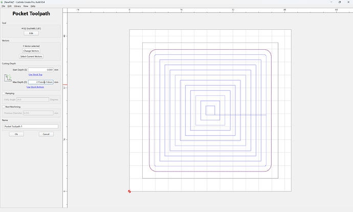

and a Pocket with a suitably small tool:

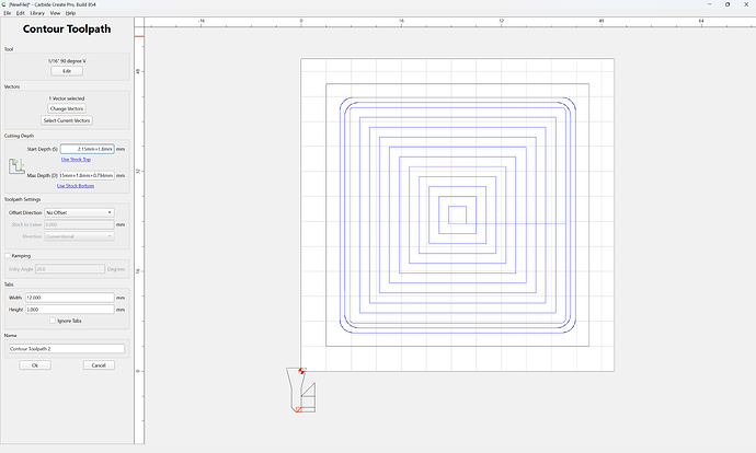

Then we make one more inset square:

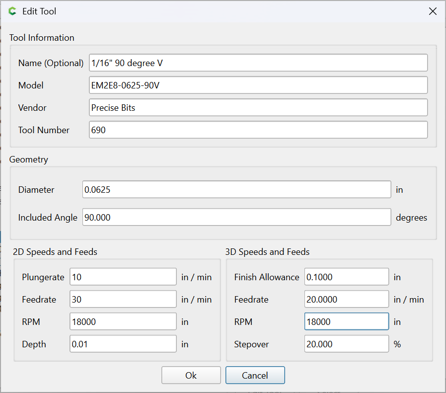

This will want a tool such as:
which we define as:
(feeds and speeds will need to be tested)

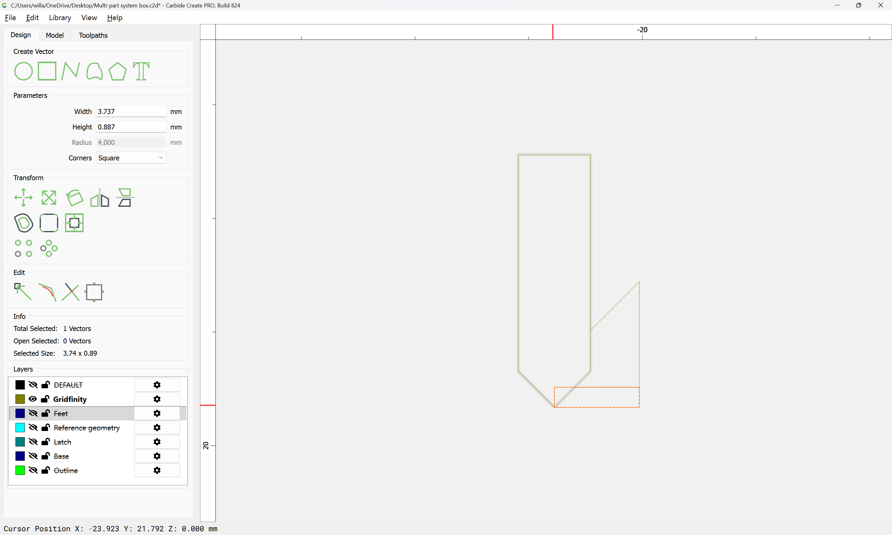

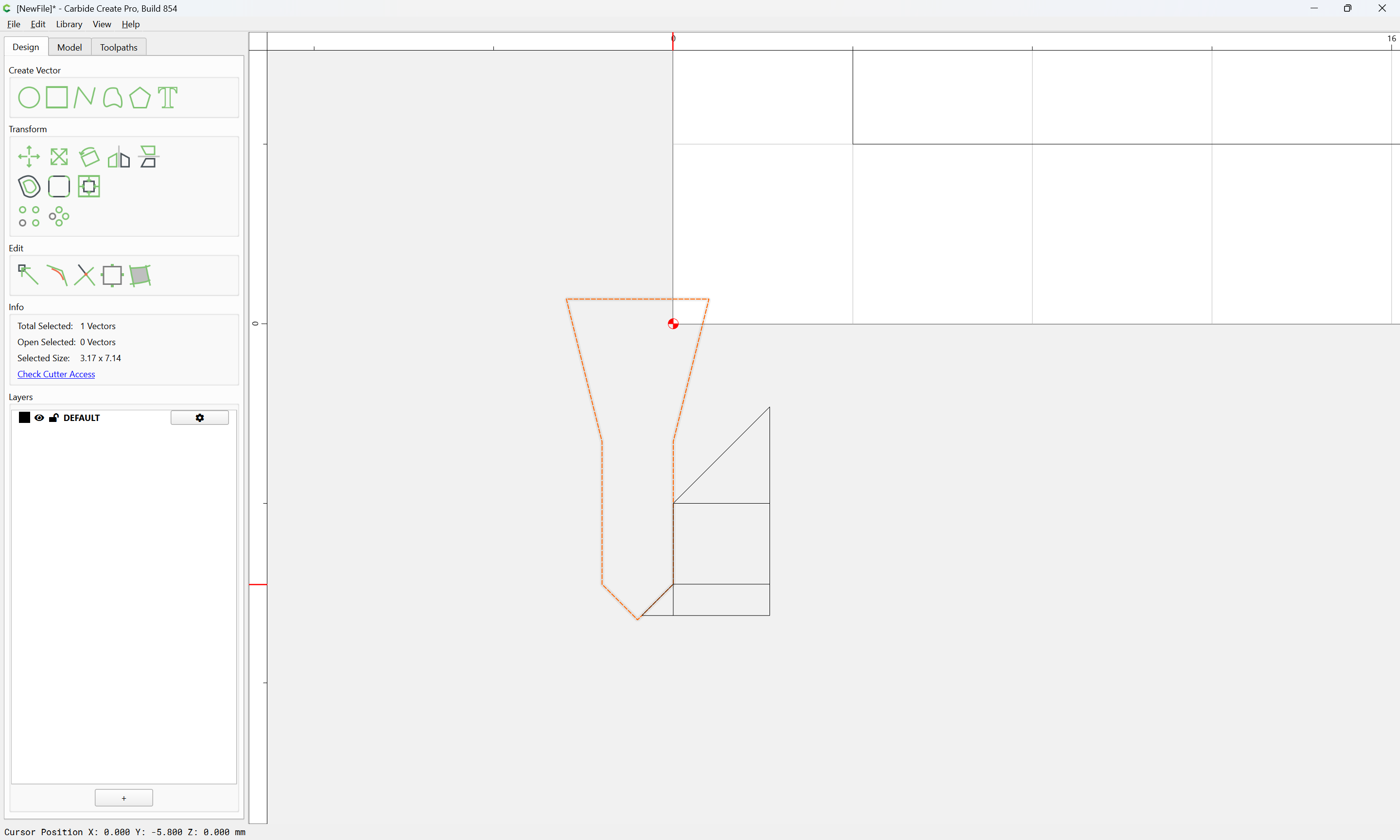

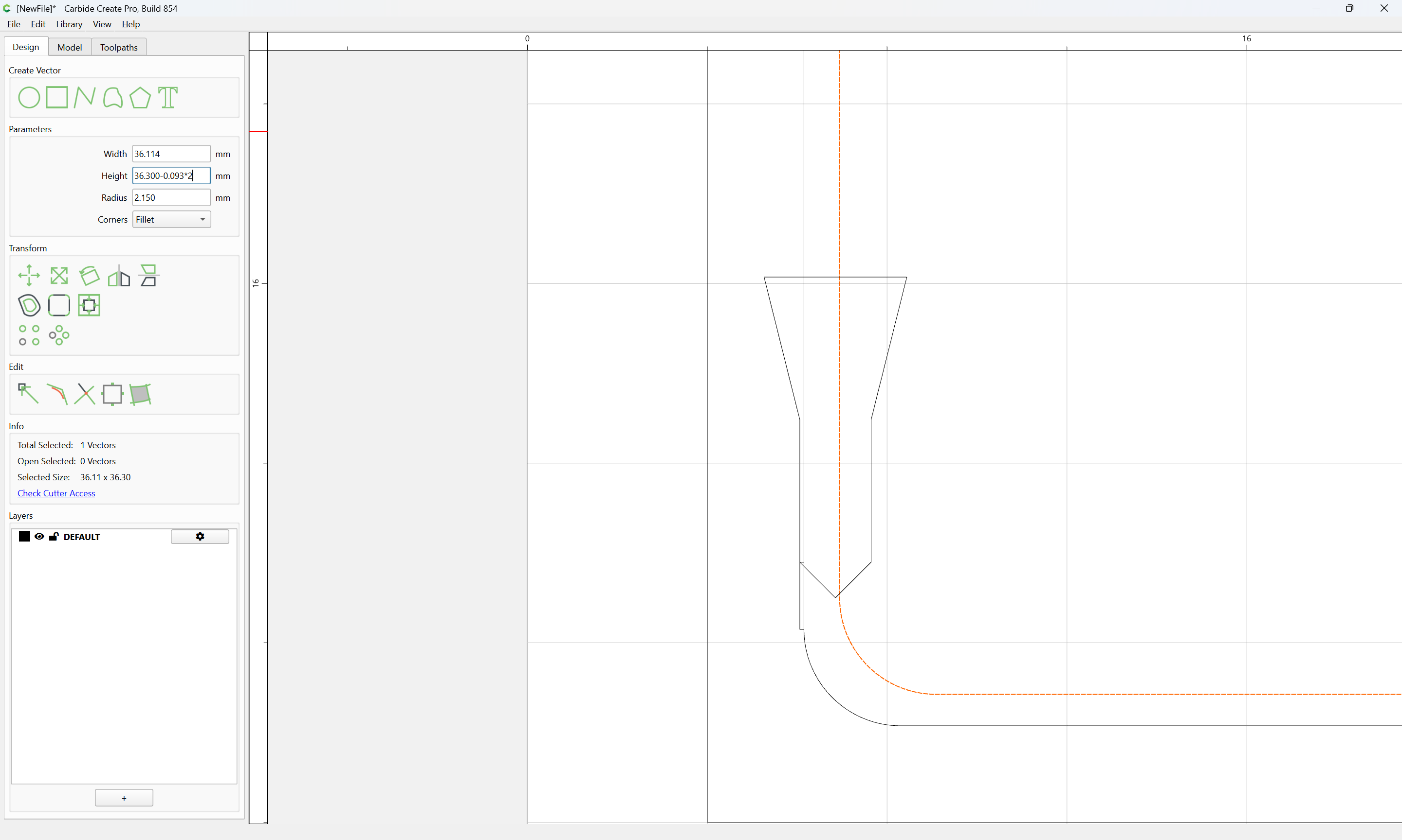

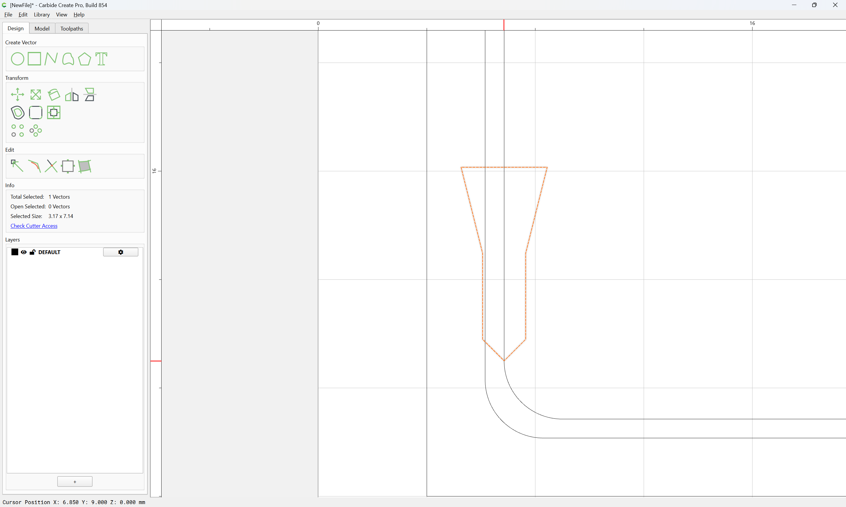

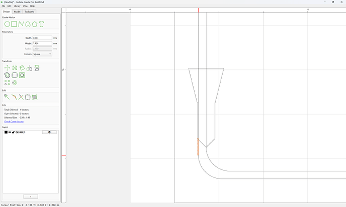

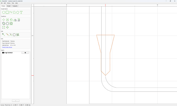

Drawing the tool up in profile we arrive at something like:
which argues for a bit of adjustment:
which should then allow things to fit — as an additional check we draw the baseplates up in profile:
and we see:

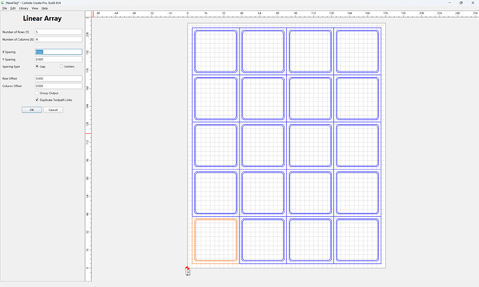

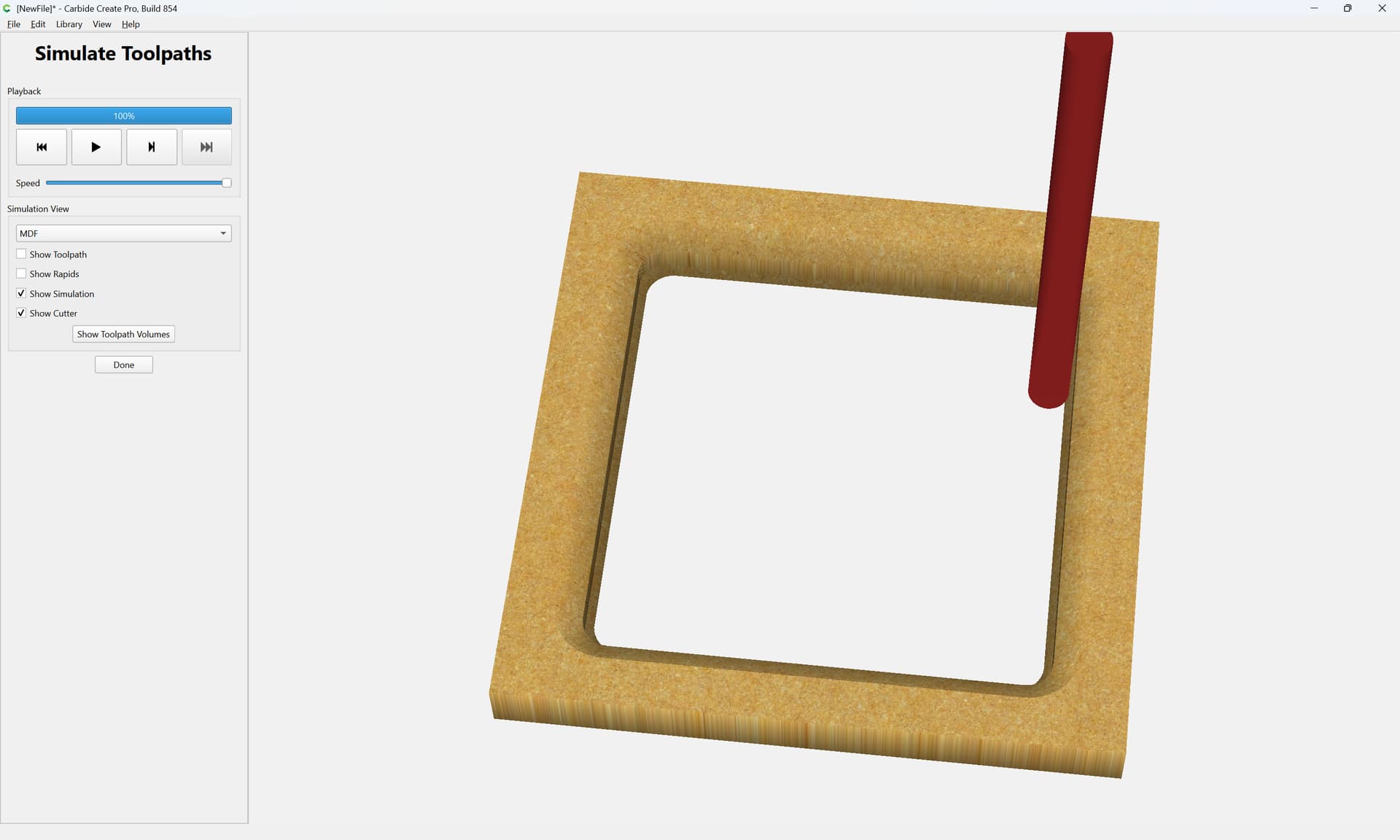

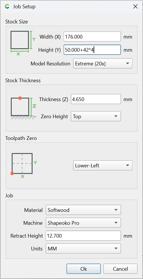

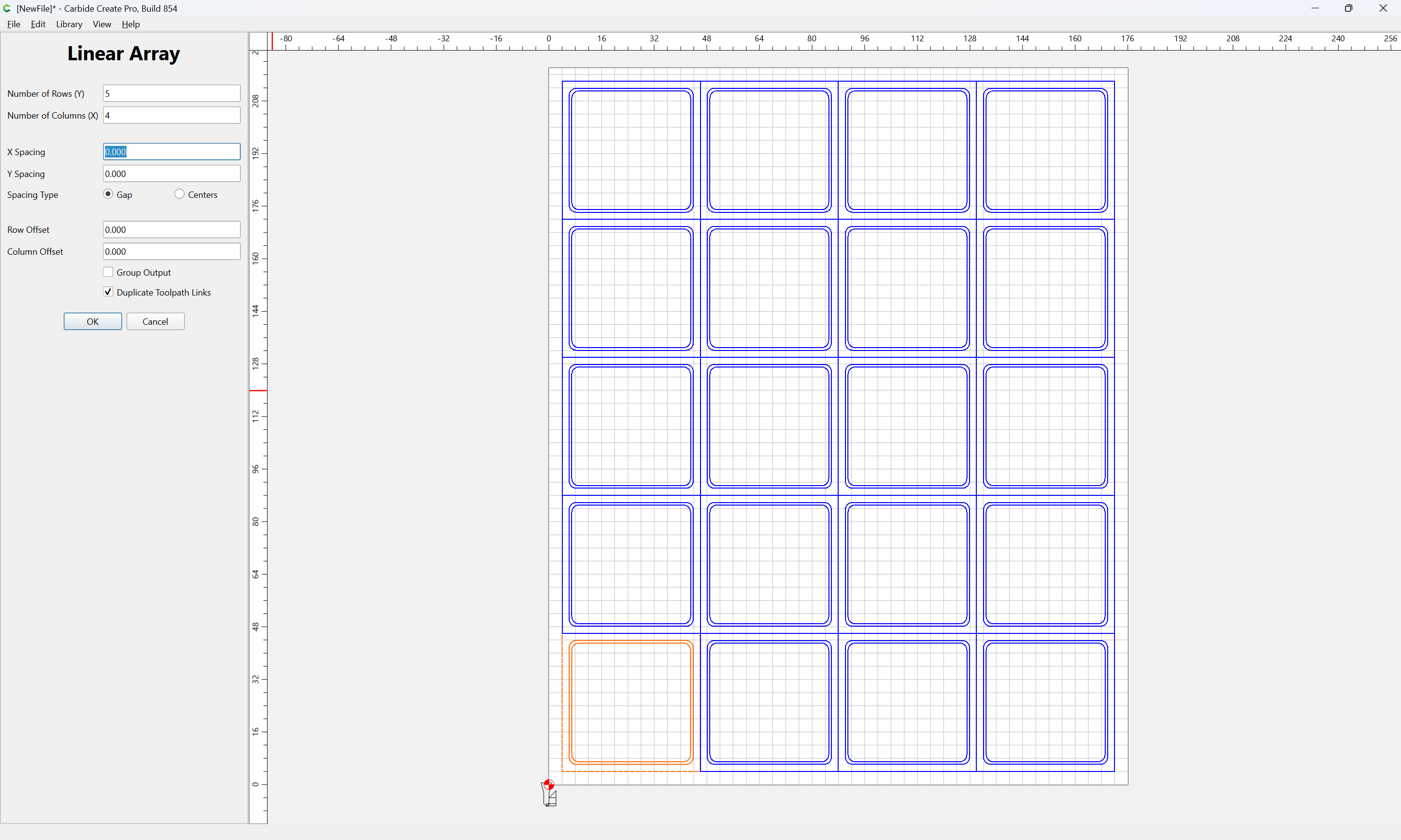

which previews as:
and which may be extended as desired:
