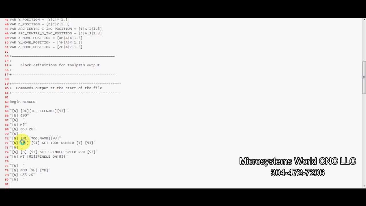

Well, it is fairly easy for a standalone program to parse the gcode file looking for M6 tool commands and saveout the tool number in a comment, as well as parsing for G1Z commands for increasing steps for pass information and comment that out as well. Carbide Motion already does parse out the tool number into the pop up prompt but does not add to status line, but that would be simple to do.
Tod1 is correct in that the program works great on contour toolpath files, but goes wild on vcarve and other toolpaths.
So in my testing what I found is the most efficient place for this kind of thing is in the CAD/CAM software rather than the sender software. To my surprise I found that Carbide Create already places the “hook” comments into its gcode (it places toolpath types comments into the code). So a little program such as mine could work much more efficiently on a CC file.
But for us Vectric users, not so much, it would take the similar functionality of CC to be added to the Vectric software.
