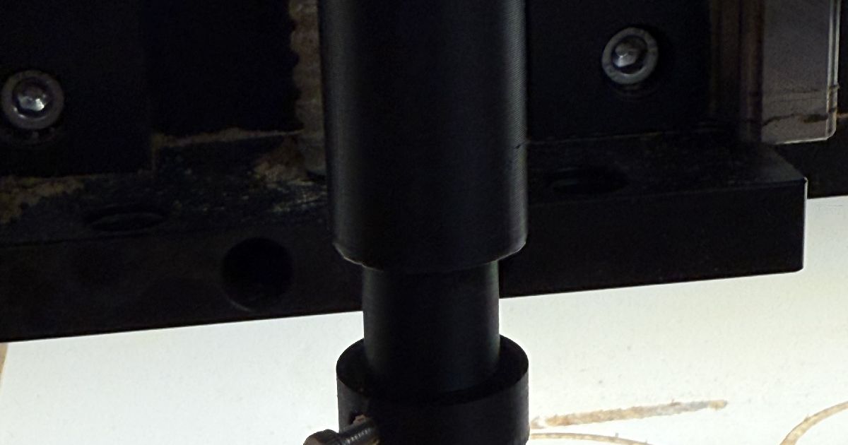

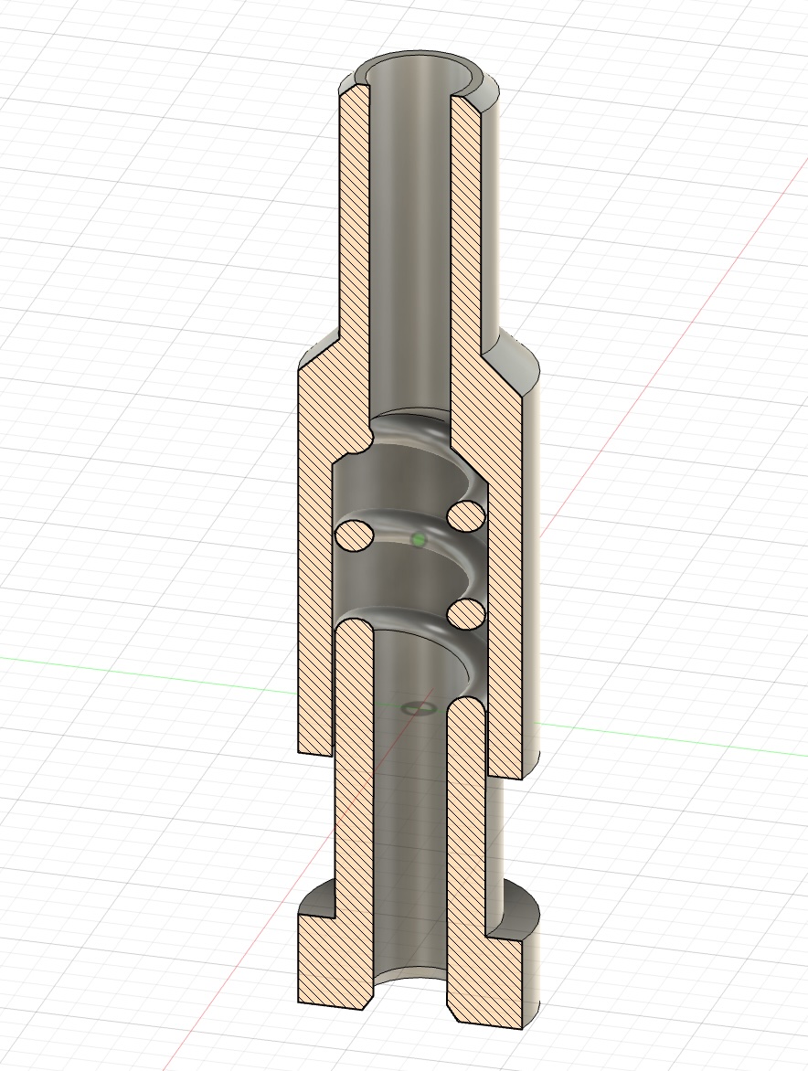

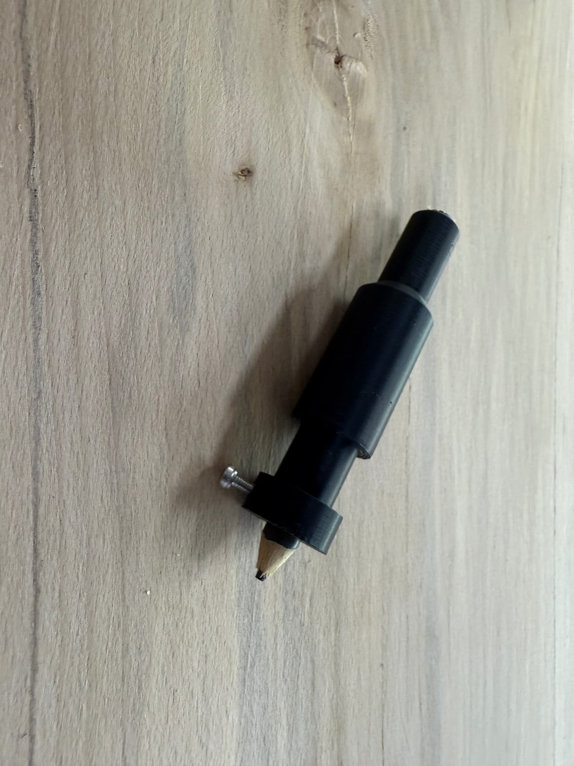

I have been making some custom live edge charcuterie boards, and began adding a juice groove that followed the profile of the live edge. I needed a way to verify the position of the juice groove before actually cutting the material. So I designed a 3-D printed pencil holder that can be installed on the half inch ER 20 collet. if you are interested the files are linked below.
