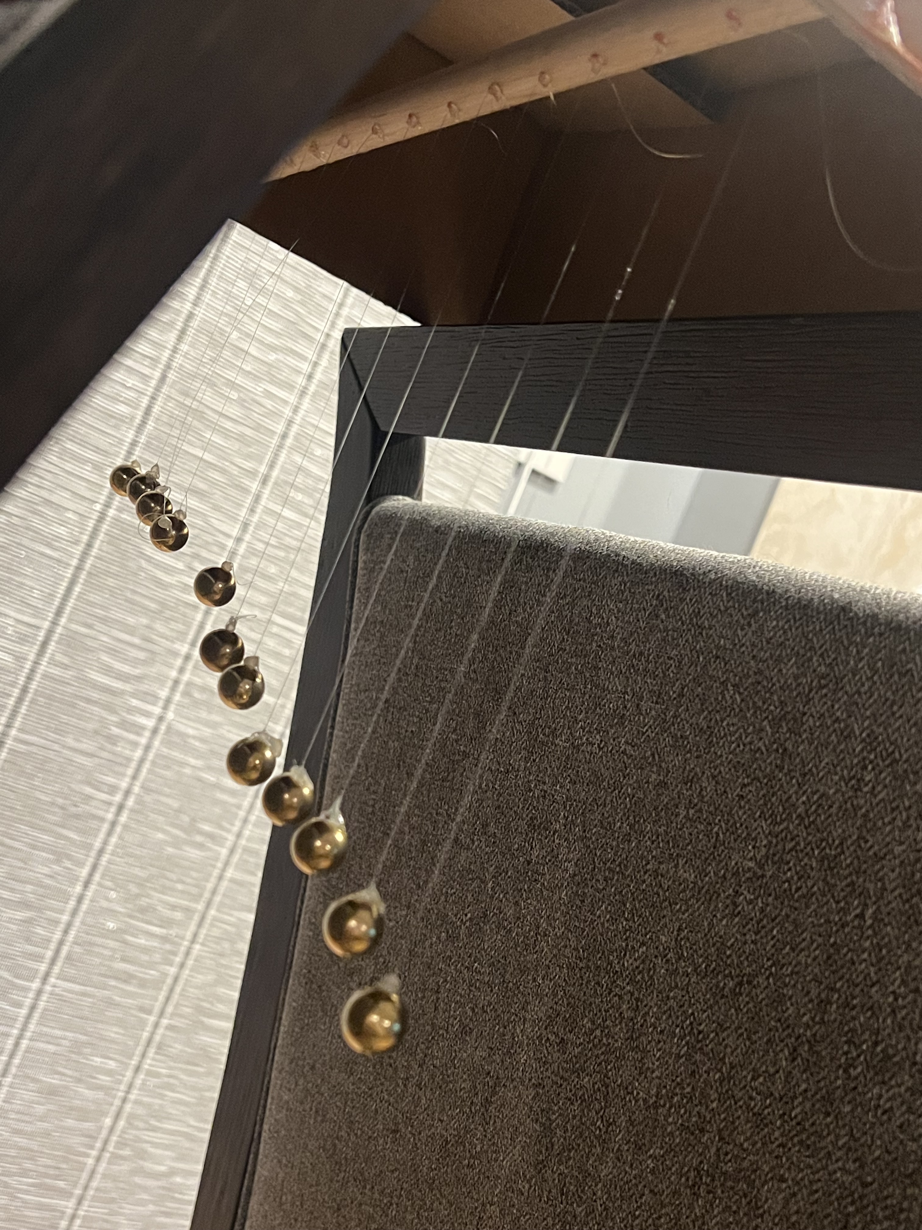

My proof of concept is just going to be some wooden dowel with holes drilled and a few nuts suspended by string. I’ll report back when that’s done.

Some dinner and a bit of tv. Doesn’t make for a very precise prototype :yum:
Good enough though, I’m making one of these things for sure!
Lessons learned:
Clear line is interesting. It’s also really annoying to work with.
Hot glue is nice but it takes forever compared to just getting off the couch and drilling holes :person_facepalming:
Being lazy AND stubborn makes for a bad combination.

My “math” brain is cramping up. It’s telling me the exact math isn’t as important as making sure this line is straight…
I think I might use the calculator for the first & last, the fine tune in between.

So it’s actually pretty elegant, the curve is necessary to set the timing of each pendulum swing.
Say the first pendulum swings 60 times in one minute, the second should swing 61 times in a minute, the third at 62 times, and so on.
So long as the center of masses are all the same, they all start at the same height, and they hinge from the same point, the only force acting on them is constant and also the same across them all (gravity). That just leaves one variable to play with in setting the timings of each swing, string length :slightly_smiling_face:
Another note is that the lengths in the calculator are from the hinge point at the top to the center of mass of the weight. So to get it just right, you’ll need to account for the size of your weights when cutting the strings.

The lines I used in the test is from a hidden seam sewing kit. It’s probably just thin fishing line and almost certainly has some stretch.
Another important string aspect is in the mounting strategy. With just a single mount point the weight is free to swing any which way. While this works, it means you have to be pretty accurate in how you stage and drop the weights, else they start to smack into each other :sweat_smile:
Seems most folks use another mount point to better constrain the motion.
