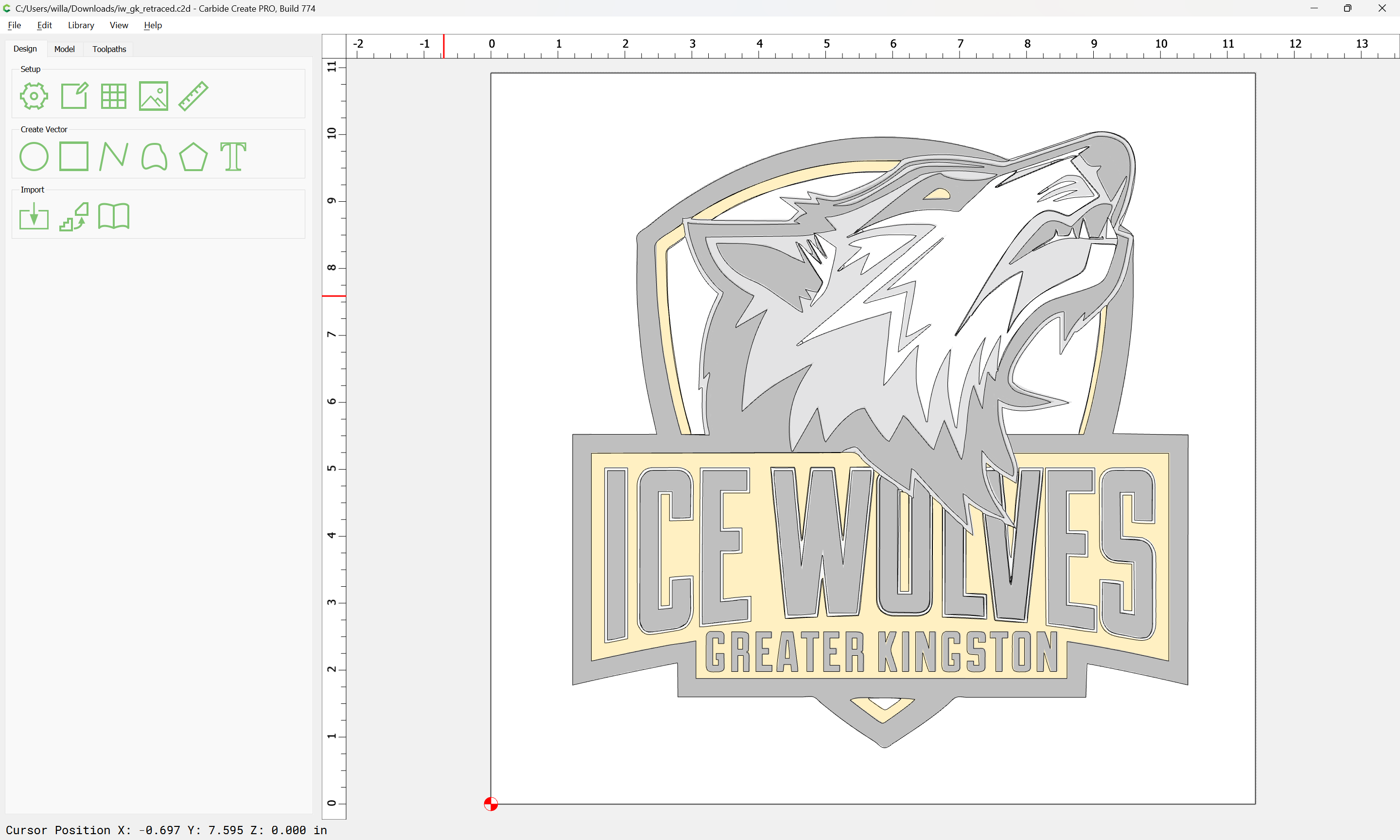

You’ll do better with the original logo.png file:
which will then trace:
adjusting the threshold a bit we get:
Trace Image:
OK
Importing the pixel image for reference:
One can then re-trace to get further details:
which may then be edited and merged together to create a workable version — unless of course one could get the original vector.
Attached as a v7 file.

Here is a quick re-working:
iw_gk_retraced.c2d (592 KB)
