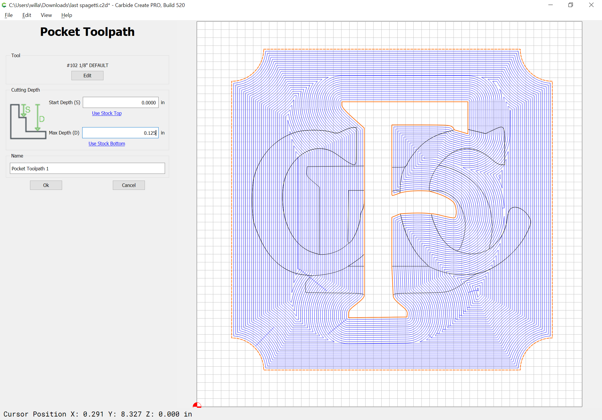

Pink lines on program

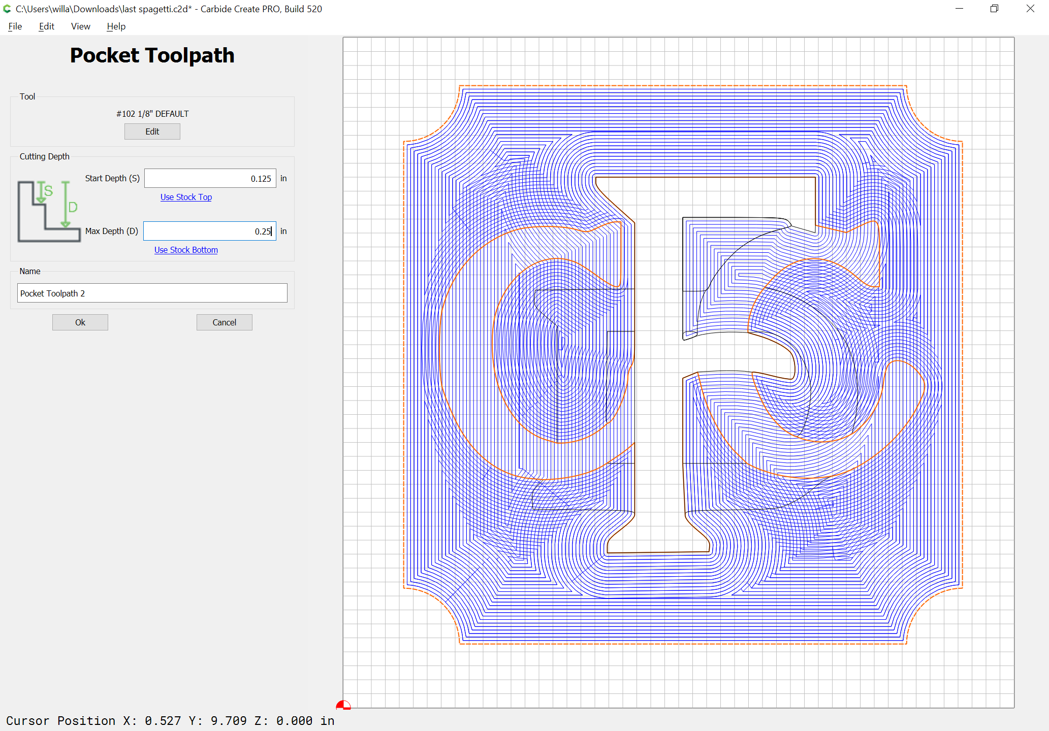

Eventually one arrives at geometry where each level can be selected:
which simply leaves one to make toolpaths.
No Magic today. Can anyone recommend a good place to have artwork done that is carbide create compatible?
Please stop with workaround. I appreciate it but, I am not a graphic designer a major.
which previews as:
No magic, just some vector editing.
Attached.
last spagetti.c2d (119.9 KB)
This is not a work-around — it is simply the fundamental geometry necessary to cut this particular design.
The issue will always be that Artwork is one thing, cuttable artwork is subtly different. If you brief someone who is CAD/CAM conversant, you will get approximately what @WillAdams has just done for you. Carbide Create is coping with artwork and cutting together, hence the extra layer of effort required.

If you simply wished to cut the file out as it was, then all that was needed was selecting everything and doing a no-offset contour:
