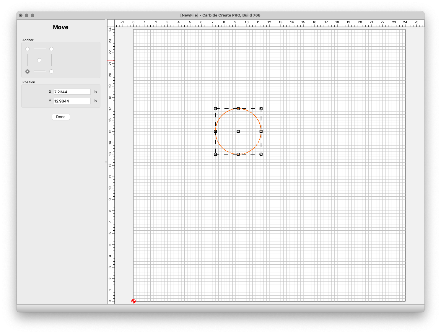

Is there a way in Carbide Create to place a vector a measured distance from an adjacent vector. An example would be placing a hole 3/4” from the vector that represents the edge of the part I’m creating by activating the hole vector and typing in a plus or minus distance to move the hole. I’ve seen this function in other design software.
This is done using the "Move"m command in Carbide Create:
