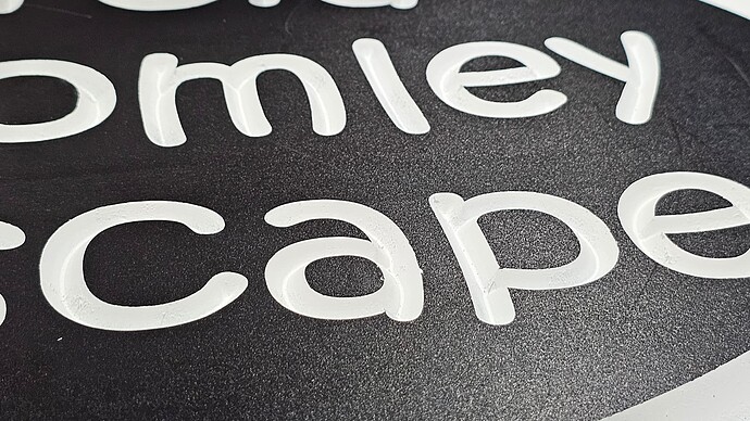

Hi All…
I have a Shapokeo 5 pro 2x4 and received a job for a 40" x 40" Playscape Sign
with dedication memorial wording…
The material is a 1" black PVC board
I used masking tape before using a “V” carve bit for the wording
so I could paint it white per the customer’s request.
I had never cut anything bigger than my machine before, but wasn’t going to turn down a job
I did some research on Carbide 3D and used "TILING’ function and it worked great !!
What do you think?

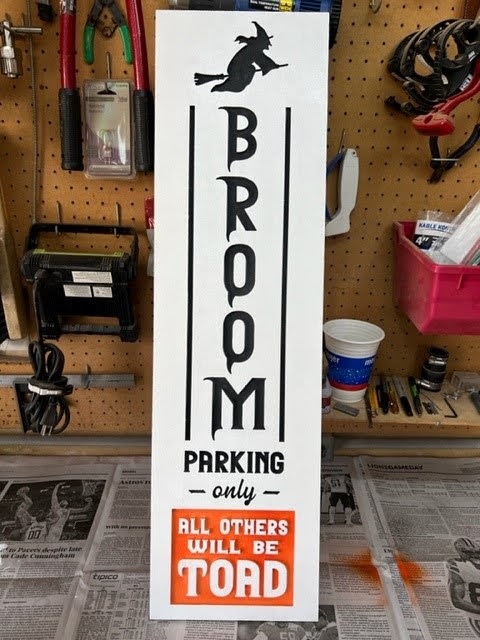

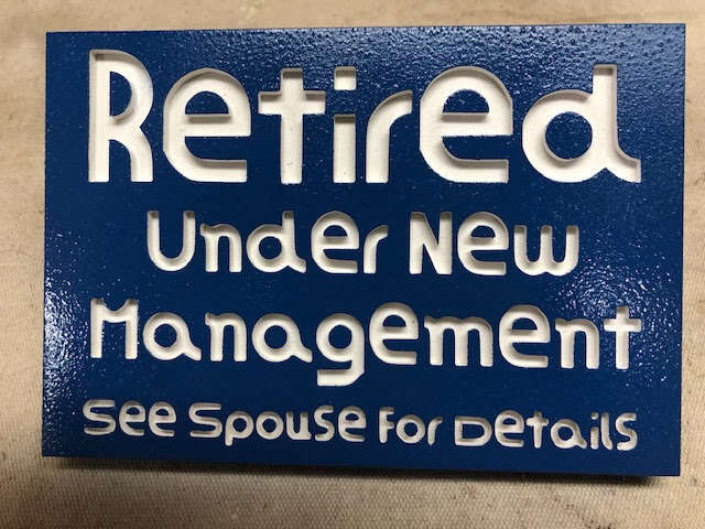

I use PVC and paint it all the time. Standard Rust Oleum spray for cut areas where needed and 2 inch foam roller for top coat. Covers nicely and makes a nice finish. Sometimes also apply clear coat for extra protection if it is an outdoor sign. I use standard 3/4 or 1/2 PVC board from Home Depot, Lowes, or Menards. Comes in various size boards in 3/4 or 2 x 4 sheets in 1/2 size. Royal Building Products in a common brand.

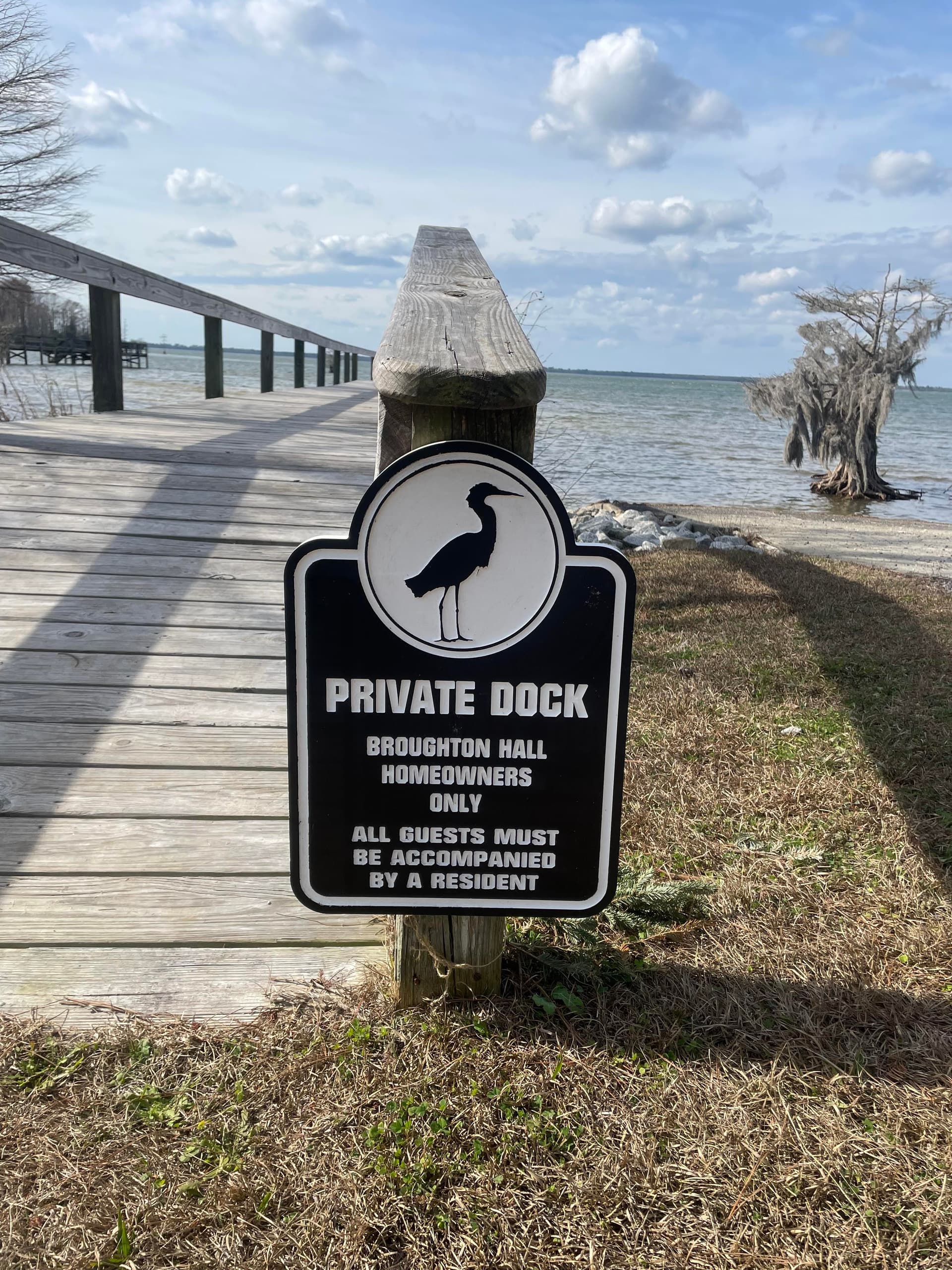

I painted PVC with Black Krylon Fusion and carved outdoor signs. It’s 2-1/2 years old now and still looking good. I did the entire HOA street markers as well.
I buy white PVC and spray 3 coats of flat paint (Rustoleum 2 in 1) and then carve designs to just 0.6mm to etch through the paint. It works great and is easier, cheaper, and faster than masking. I top coat with gloss or satin clear when done.
