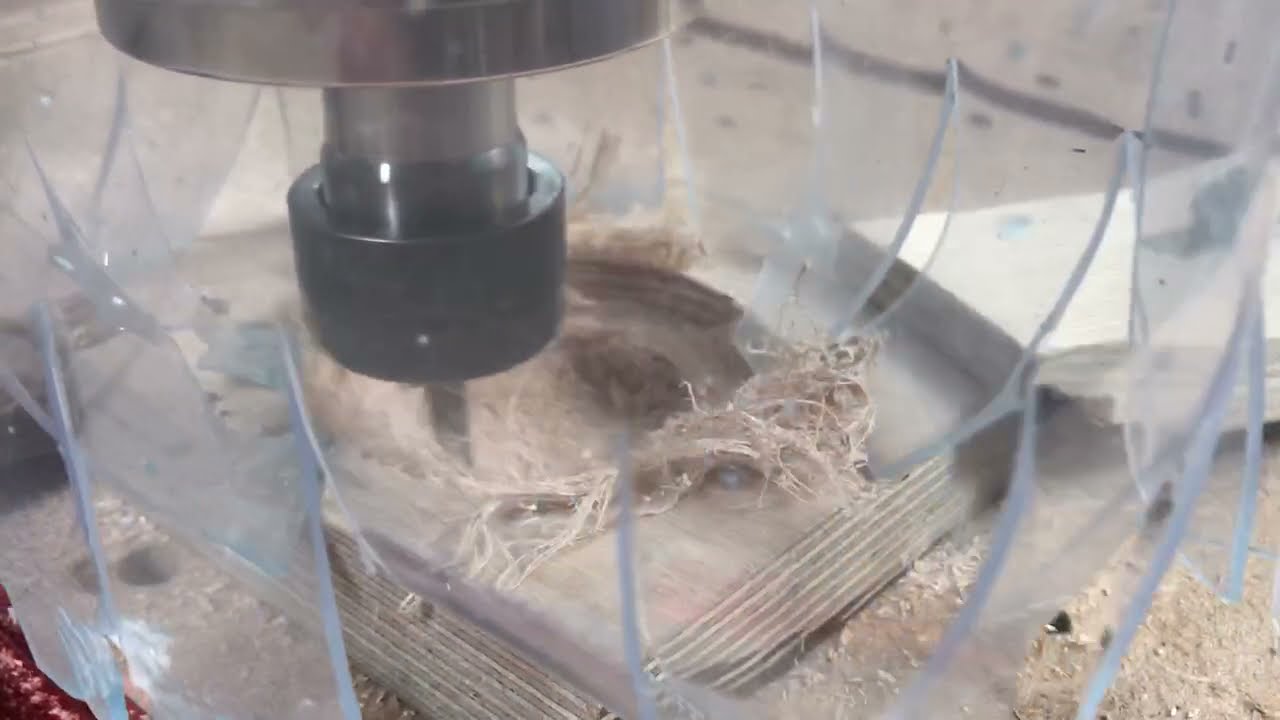

To follow up my previous;
That’s a test cut on my machine with linear rails and substantial belt upgrades which was deliberately more than my XXL machine could handle without making nasty noises on V wheels and regular kevlar 9mm belts.
95IPM
24kRPM
0.35" DoC
0.1" Optimal load
edit - and a blunt old 0.25" cutter in case it went wrong
