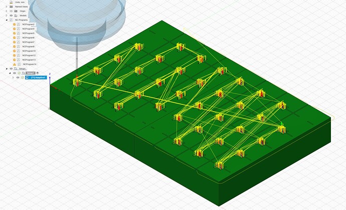

Hi Wilson,
Thank you for your help! I double-checked that the stock size matches the model in Fusion, and I also verified the tool size setup. Despite these steps, the tool still hovers about 3mm above the surface during cutting.
I’m using a Nomad 3 CNC with aluminum stock, and the cutting tool diameter is 1mm.
I’ve attached a screenshot of the Fusion 360 settings. Could you help me figure out what might be causing this issue? I really appreciate your time and help!
