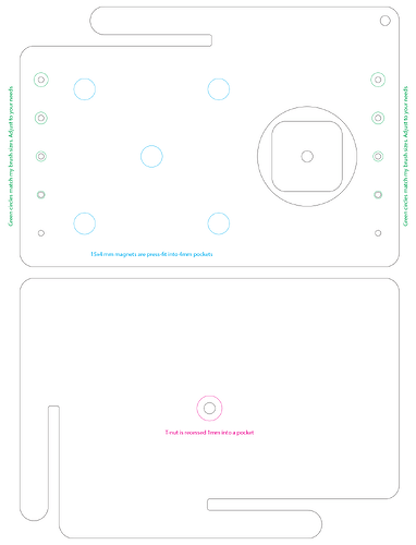

Because of this I created my own version of an A5 paper size “Plein Air” easel. There are several designs out there, but I did not like using these expensive constant torque hinges that often fail anyways.
The easel attaches to any standard Tripod and can be used both in “landscape” and “portrait” mode.
Materials:
  • One sheet of 6 mm plywood (400 x 350 mm). I used poplar, as its light.
  • Five magnets (dia. 15 mm, 4 mm thick).
  • One 1/4-20 UNC T-nut.
  • A foldable silicone cup (diameter 80 mm).
  • Two to four metal clamps/clips to hold the sketch book.
  • Wood glue for attaching the part that sits on the tripod.
  • Fine sandpaper.
  • A metal tin to store your paints and can be used as a pallet.
  • A small piece of 5 mm elastic string to use as a cloth hanger.
  • Satin wood lacquer for protection (optional).
I used a single 1/8 inch router bit, suitable for wood and acrylic.

I used a 1/4-20 UNC bolt with a hex head to attach the t-nut to my easel. This way you can pull it into the wood using a socket wrench, instead of hammering it in. Using a hammer will definitely split the wood. I placed a scrap piece of wood in between the nut and the easel to make sure it did not get damaged, as poplar is a soft material.
Below my vector files (PDF, AI and SVG).
