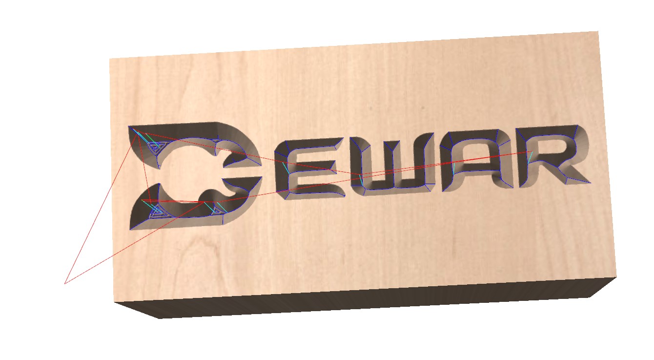

Recently I’ve been trying to do some v-carving on a logo. The lettering is small and I have been getting some tear-out. I have been tweaking the plunge and feed speeds and I continue to get the same results. Then I noticed yesterday that my changes are not taking effect after saving the new g-code. I can have feed at 25IPM or 250IPM or 1250IPM but the spindle continues to move through the workpiece at the same speed. Has anybody seen this before? How do I rectify this?
I’m using a very narrow Amana 15 degree v-bit in the Advanced Vcarve.

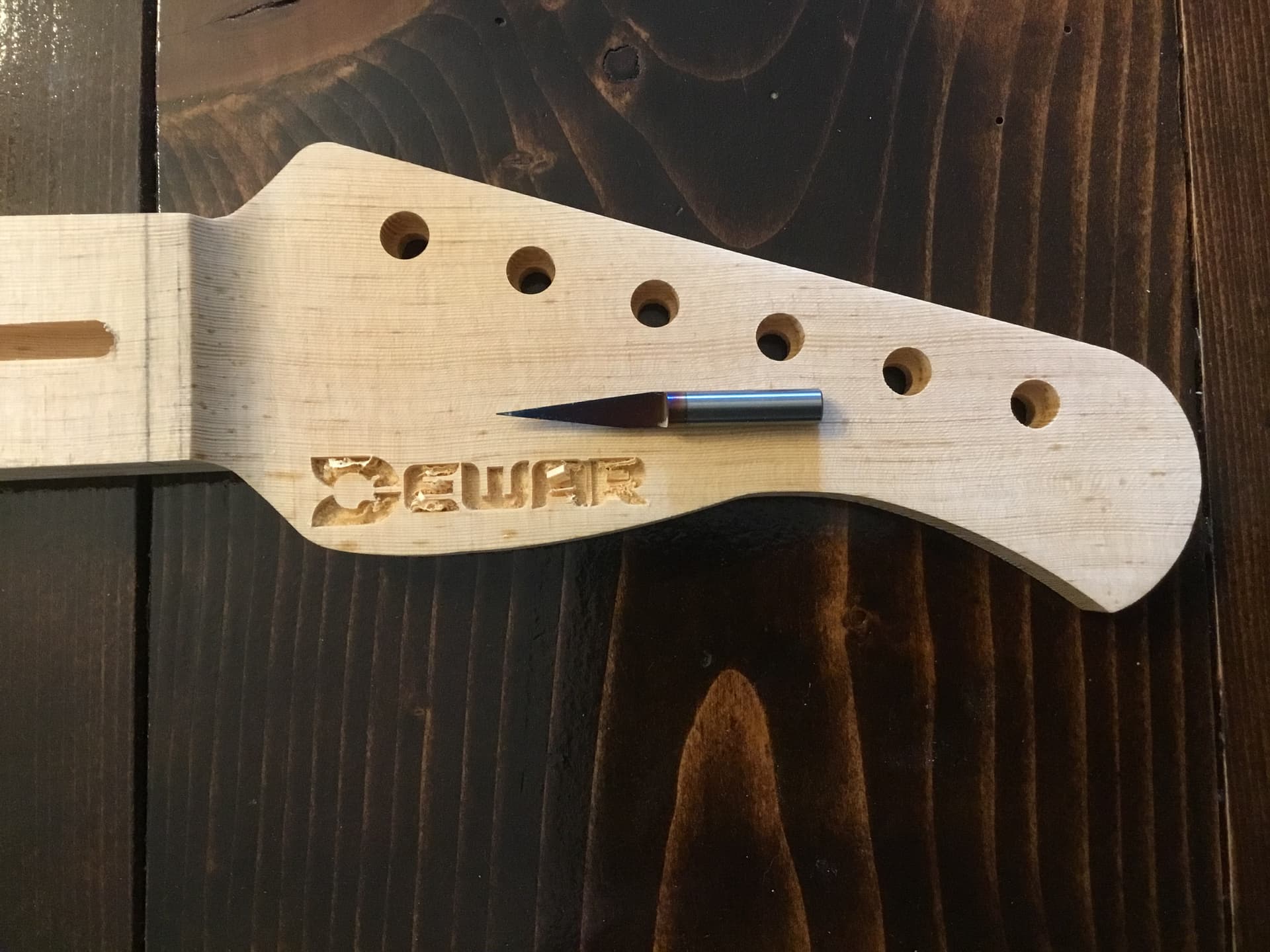

I was considering sealing it as some kind of “mask”. I’m definitely trying to slow the feed and plunge rates down but it’s just not happening. The numbers above I posted are just examples to show that I can change them in the job configuration but I do not see the changes actually taking place. The real default settings CC inputs is 203.2 mm per minute for plunge, 254 mm per minute for feed and 10,000 for RPM. Depth per pass is 1.270mm. Max depth is 2.439mm.

The max depth is 3/32". I fill with epoxy. See pic above.

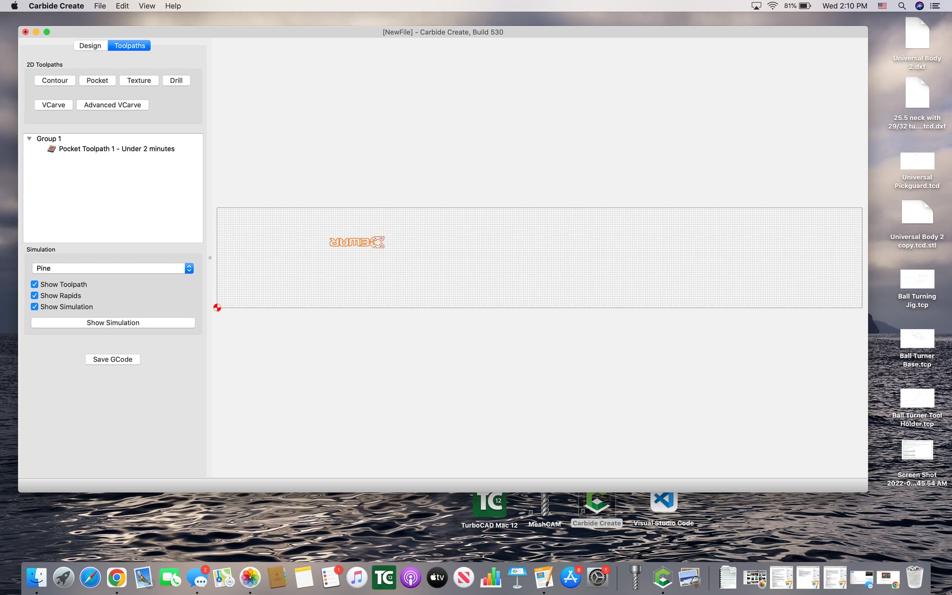

I performed a v-carve at a minimal depth to get the clean lines done and now I’m trying to create a pocket job using a .027" ball mill. The pic shows what will get routed. Why is CC not routing the entire inside?
Post the file or send it to projects@carbide3d.com ?
