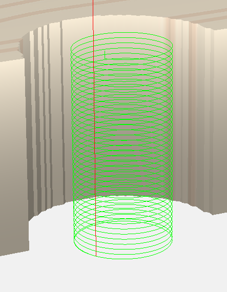

I “Hole Mill” smaller holes. (Need Pro for ramping) For a 1/4" hole a 3/16" (4mm) tool is perfect, but a 1/8" tool works.
Create a contour path, inside offset, that cuts the full depth or just a bit past. For 1/4" stock I would go 0.260 deep to make sure it’s “through”. Set the depth of cut on the tool greater than the max depth.
Set the plunge feedrate equal to the cut feedrate.
Now in the toolpath turn on Ramping and use a very shallow ramp. ( 1° - 3° )
The ramp follows a helical path to the bottom, then a single cleanup pass.
I use climb cutting so the last planar pass cleans up the wall.
