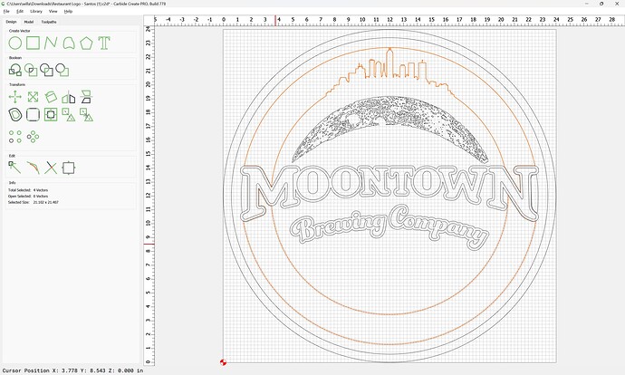

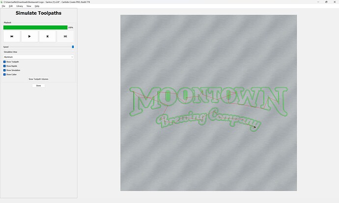

Hi All,
While I am awaiting further help from C3D support, I thought I would throw this one out there to see if someone else has seen it. I have a logo that I am trying to carve. All vectors are selected to give me the main area I want to machine out. When adding elements for the pocket, I get to the last letter, and if I add it, several parts of the drawing no longer pocket properly. Without this last letter being included, the rest of the drawing properly pockets. In the attached pic, the top shows the drawing without the “N” being included. Everything else looks correct. The bottom shows the N included, then the OO and the Brewing Company no longer machine properly. I would appreciated any insight into this weird issue.
Thanks,
Mark

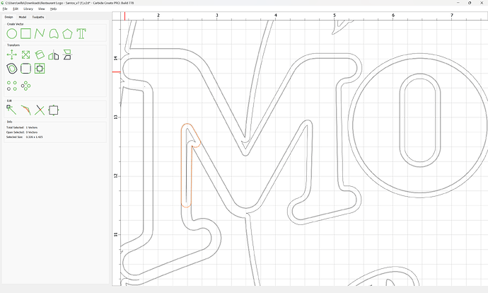

which indicates a potential work-around — offset so as to match the center of the narrow channel between the M and N at the beginning and end of the text and the surrounding geometry — measure this:
and inset to that width:
Apply

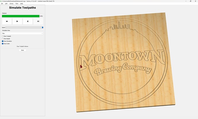

Then assign that to a an Advanced V carving toolpath:
which paired w/ the pocket toolpath has the desired appearance:
The balance of the design may then be incised at the bottom of the pocket:

Eventually one arrives at:
Thanks so much WIlliam. I know this took a lot of time to get configured and I look forward to learning more about these more advanced techniques on manipulating the designs. I also look forward to a new CC release that fixes the issue with the original svg that I was using. Now I am going to optimize the toolpaths and do a test carve to see if it will all work.
