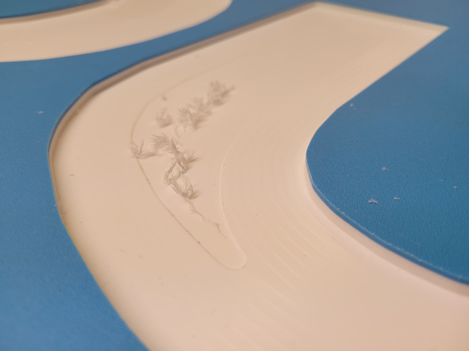

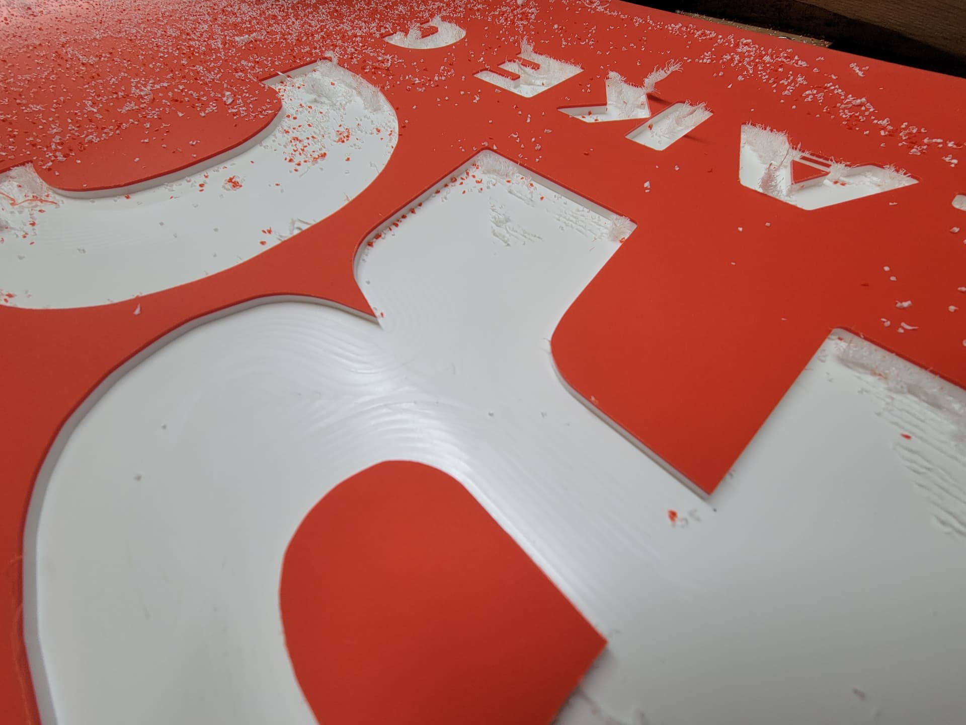

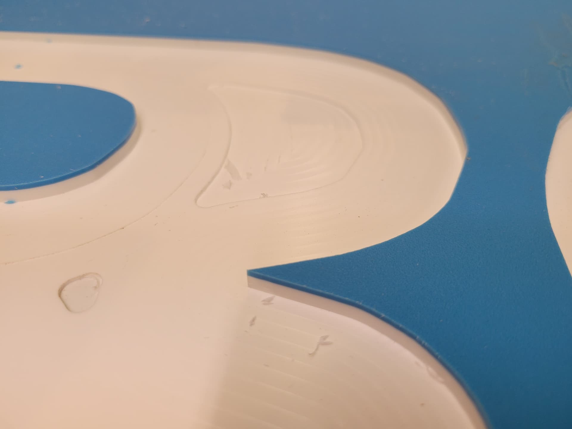

I cut a large but simple project. Single toolpath. I got a weird inconsistency on depth that repeated on a second board. Anyone have a guess why it would do this?

What are you using for work-holding? Could the endmill be lifting the material as it cuts? Your DOC is 0.05", the pocket depth is 0.200, so your last pass is a full depth pass.
You could try adjusting either the depth of the pocket, OR the DOC of the bit, so that the last pass is shallow. If the depth was 0.210", then you would get another pass that takes off 0.01". That shallow a cut is unlikely to lift the material (if that was the original problem).
Or change the DOC on the bit to 0.0475". Four passes get to 0.190", so there’s another pass taking off 0.01".
OR, try a bit more aggressive DOC. A DOC of 0.063 would end up with four passes total, the last being shallow.
Could be lifting it. I’m clamping the edges hard but I can’t camp the middle of this 24" wide piece. The color core is a little flexible.

Also, I have had the sweepy cause the center of large boards pull up so I make sure to have a good bit of clearance between the sweepy bristles and the board.
Ran a 30" piece of painters tape down the middle and used super glue. Exact same pockets.
I could run a downcut endmill next, but I’m open to other ideas.
I would use multiple pieces of tape, and then run a final finishing pass which removes only a very shallow thickness of material — easiest way to do this is to adjust Depth per Pass to take into account Max Depth, say one has a Max Depth of 0.5" and a Depth per Pass of 0.125" resulting in four full-depth passes — reducing Depth per Pass to 0.124" results in five passes, with the final pass removing only 0.004" inches of material.
Just updated the file. Looks like I was taking 0.05" passes all the way to 0.2"

This suggestion and/or the downcut bit fixed it.
You did a shallow final pass? I would have thought that would produce a lot of fuzzies.
I did, with a quarter end mill. Then I dragged a chisel to pull a few fuzzies off. Not terrible.
