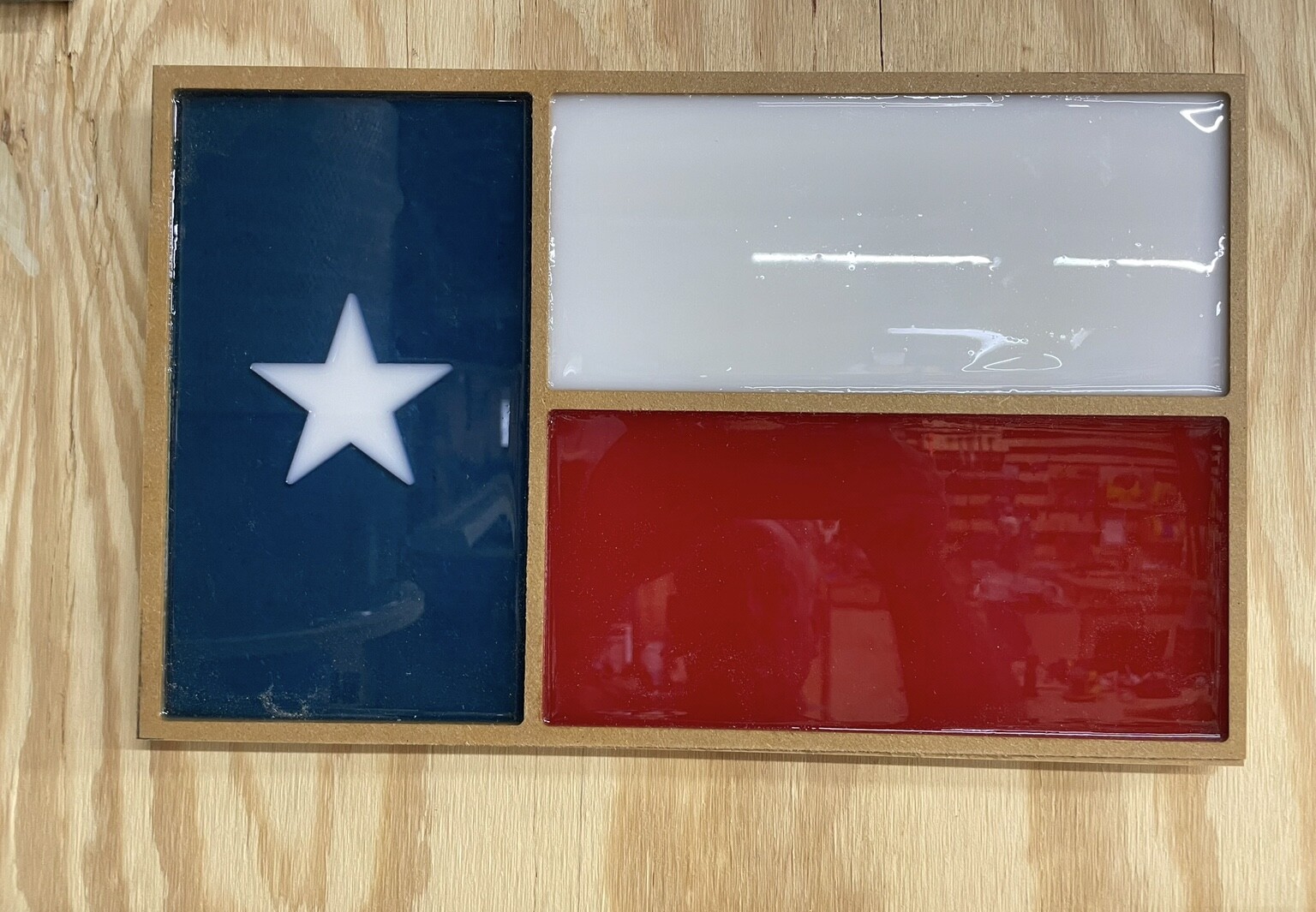

I am trying to create a Texas Flag with pockets for the fields, red/white/blue and the star. Ultimately i want to pour resin in these fields. Can someone tell me how to go about creating the star as a pocket within the blue field pocket. A pocket within a pocket.
Thank you
You may want to pour the blue resin and let it harden. Then cut the pocket for the star and pour your white.
Alternatively leave a wood border for the separation but depending on wall thickness and wood type that may be fragile.
I had not thought about pouring the blue resin first, then cutting the star. Great idea!
I had been trying to do the border technique. I couldn’t get the tool paths to cooperate.
I’ll try your idea.
Thank you Cullen.

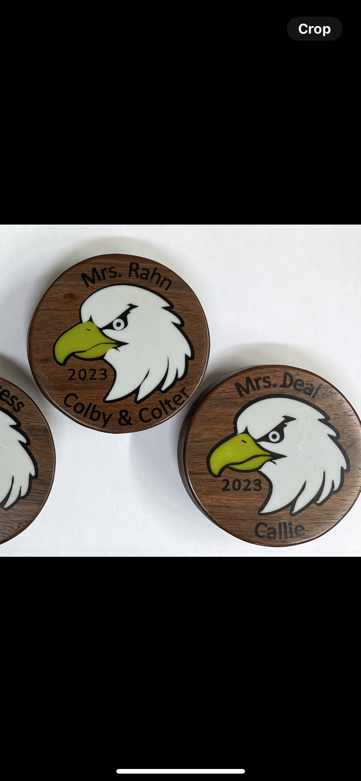

That is the strategy I did on these.
The dry time is a pain but there are some things that can improve it.
I moved the pieces off my machine so that I could do other work while it dried. If you do that you need to have a way to precisely position.
I have done that before. I printed the Carbide right angle fence and secured it to my waste board. That way I can put the project back in the same spot and use the BitZero to make sure X/Y/Z is set the same.
Those coasters(?) look really great.
Yes that are coasters. Thanks.

If you want a pocket within a pocket cut the first pocket. Lets say you want 1/4" pocket. Then for the second pocket just use the starting depth as 1/4" and set your depth. Depending on the depth of the first pocket and the closeness to the edges make sure your collet nut does not hit the wall of the first pocket.
Guy, I think he means he wants the blue union field and the stars flush, but 2 different colors. (Not 2 different depths).
If you cut adjoining shapes as separate pockets with a wood border between them, if using V-carve there will be a “dam” or “wall” between them, and if it doesn’t line up perfectly you may or may not see the wood.
I think Cullen had the right solution, cut the union as a solid rectangle & pour the blue. Then cut the stars into the blue epoxy & pour the white.
When I have 2 colors and adjacent shapes that are larger & I don’t want to waste so much epoxy, I just overlap the shapes a bit so the 2nd pocket is cutting into the epoxy from the 1st so you get a nice sharp clean edge.
Tod is correct. Sorry I couldn’t describe it better. I had envisioned a “wall” between the blue Union field and the white star. But what Cullen has described will probably look better. I am going to try that method first.
I have never used resin before so it will be a learning process.
Thank you all for your input and support.
I finished the flag. For the first time using ER, I am happy with how it turned out. Thank you everyone for their input.
