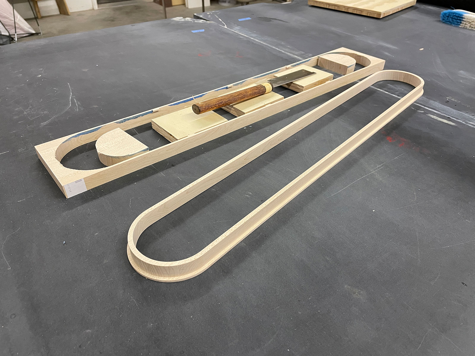

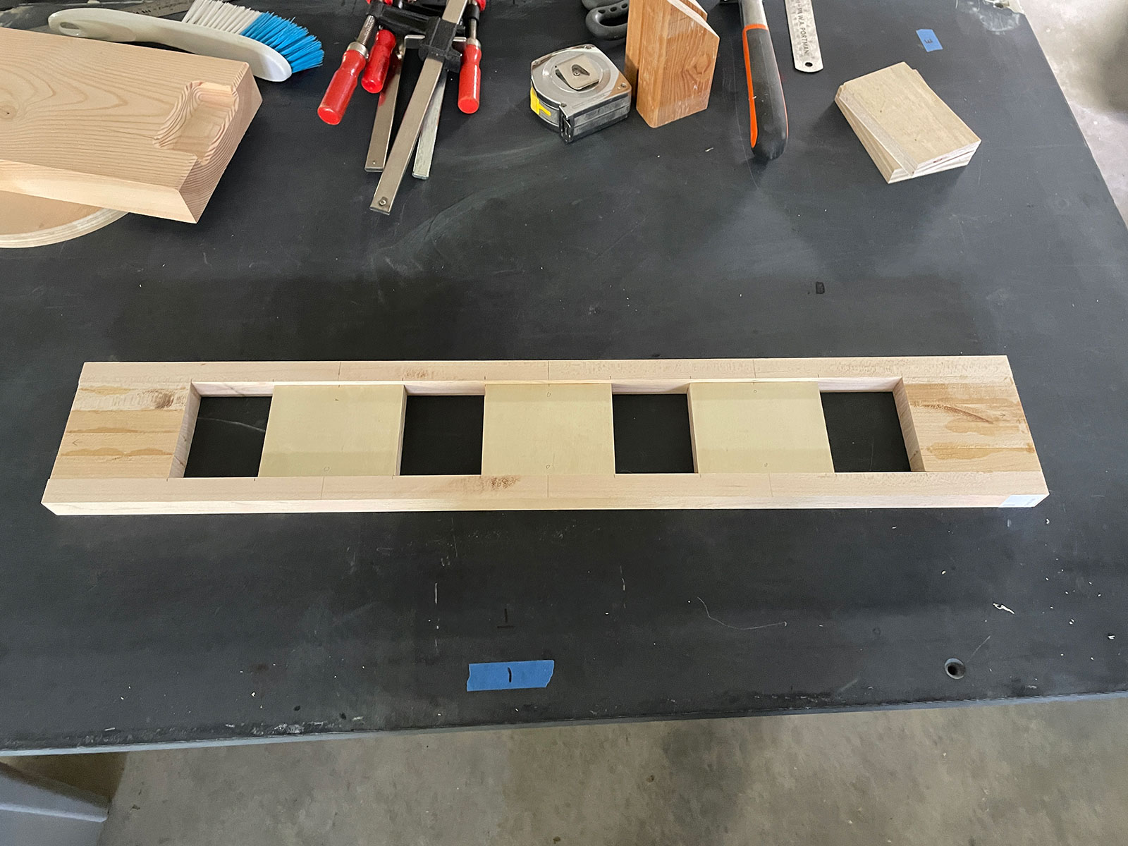

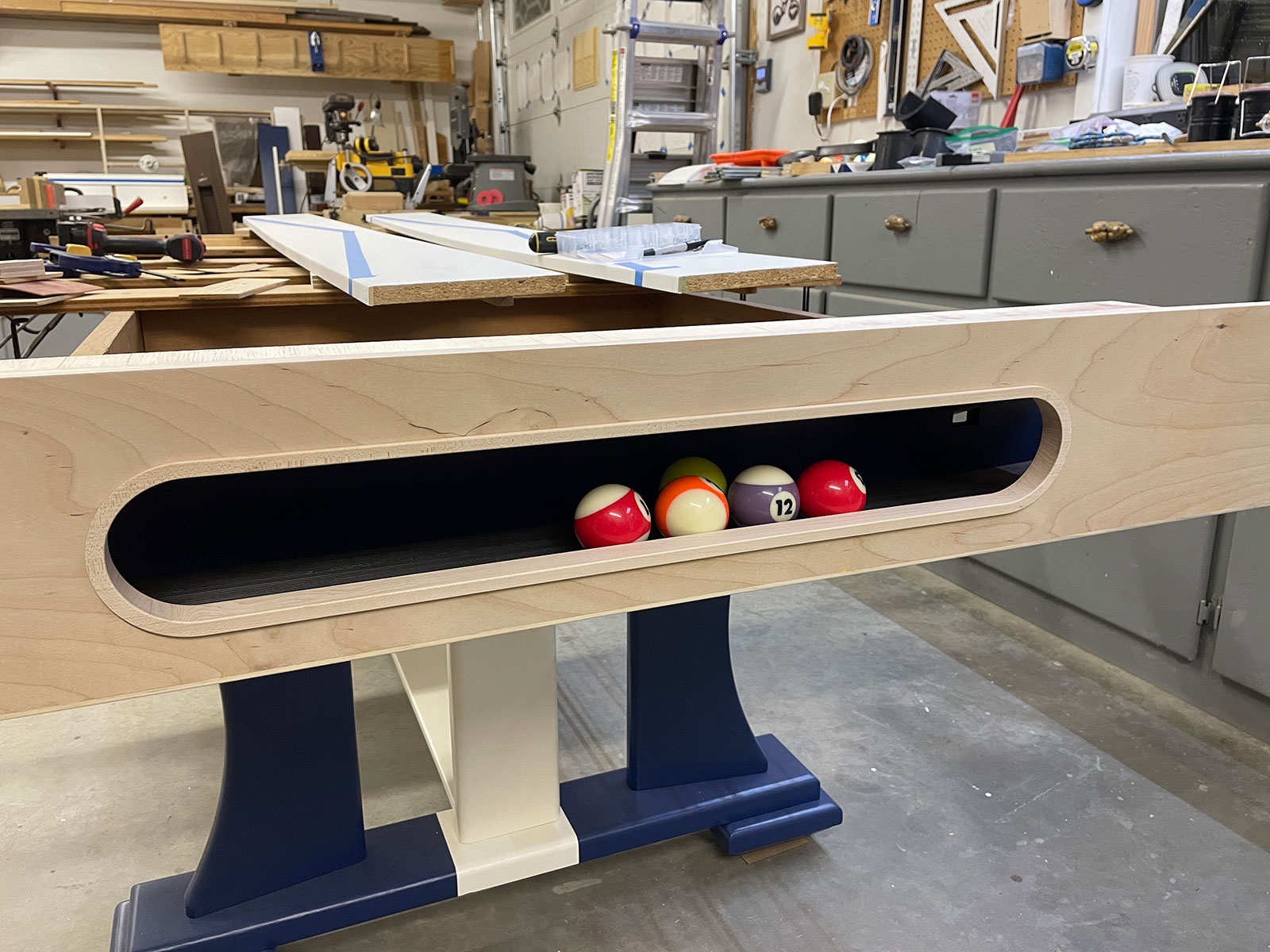

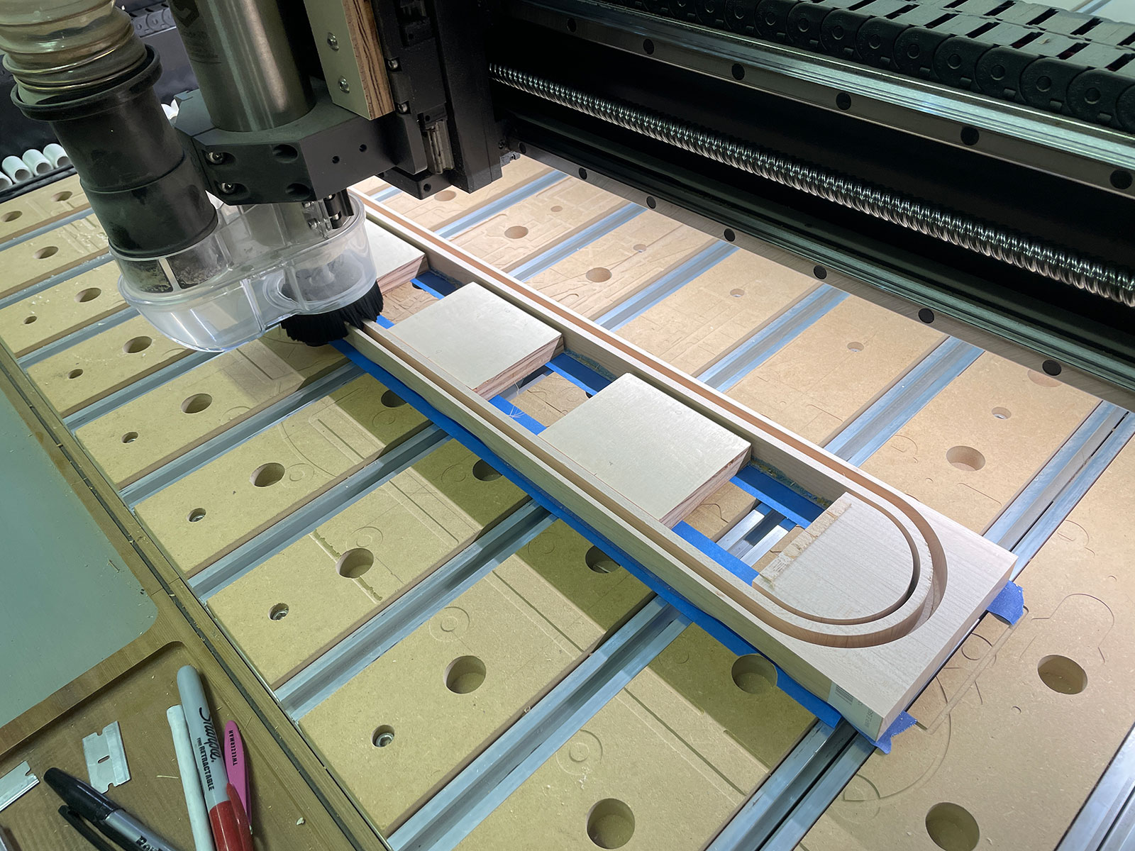

I needed a trim piece around the ball return on an old pool table I’m breathing new life into. It needed to be a hard wood (hard maple) because it’ll have billiard balls bonked on it all the time. I only had a few small scraps of maple left in my supply so I had to glue them all together and stabilize it with scraps of plywood. Turns out I had just barely enough and it was a bit of a dodgy carve but it came out great.
