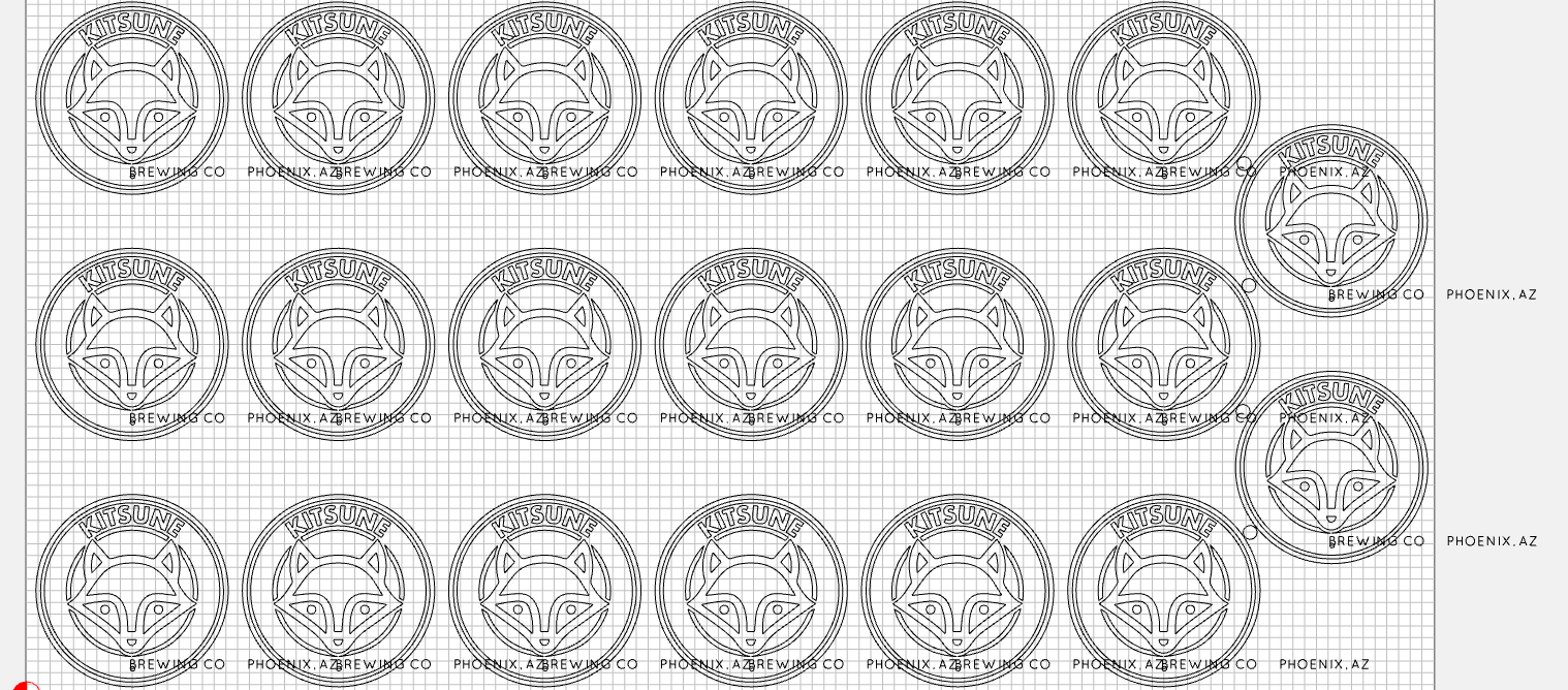

Something happens to the arc text settings, between Save/Exit and app start and open file where all text arc settings are lost
Everything had been setup as I wanted it and I had used the file for the first series of cuts, which completed as expected. I had saved, exited and opened other files throughout the day and when reopening this file, it was fine. I opened it this morning to continue with my project and all the arced text is now straight - all 20 of them.
I set this up by creating a master object in the lower left and then assigning toolpaths until it looks how I want it to look. Once that is done, I copy it with the Linear Array feature.
Today when I opened the file the arced text was trashed. Because I’ve already cut part of this project I can’t go back and fix the original object and copy it again with he array. After copying I moved the stack and manually spaced a couple of them to fit them on the stock - I have to redo the text 20 times now and hope I get them close to matching. Sorry, digressing in to frustration again.
I’ve had this happen a few times, not always, but more than a couple times over the past year. This began happening before the last production version of CC, so it’s not new.

It looks like it lost the arc setting, and the alignment (Now left instead of center).
Is the font correct? and the size?
If you edit one of them, and enable arc text, is it in the right spot?
Can you share the file? (Hint: If you disable all the toolpaths it will save a lot smaller.)
I thought I had set the text to be centered, but when I started fixing it, it was Left-aligned.
The font face and size were still correct.
When I enabled the arc (text on bottom) it was not in the correct location or arc.
To fix the issue, I deleted all the ‘broken’ text except for one. Realigned it, copied it and pasted and aligned them individually. Better than redefining the arc on each.

Hi Kevin - thanks for taking a look at it. I don’t have a non-repaired version; I saved it as soon as I made the fix. I deleted some notes etc from the file I uploaded - that’s the only difference.
I’m not able to recreate it at-will either. I suspect something is going on with copying text with an arc (and/or using text on the bottom) that may have toolpaths assigned to them, but I can’t recreate it to prove it. I worked on the file several times throughout the day, closing it to work on other things and then coming back to it and it was fine. It looked fine when I saved it at the end of the day. When I opened it first thing this morning I saw the issue. I closed CC without saving and I wasn’t prompted to save changes then reopened the file but it looked the same.
On this occasion I had just the one line of text (copied 19 times), but previously when this has occurred I’ve had more than one set of text that has had an arc and all of them are affected, so something is happening globally to those settings, either in the save or the app close process.
