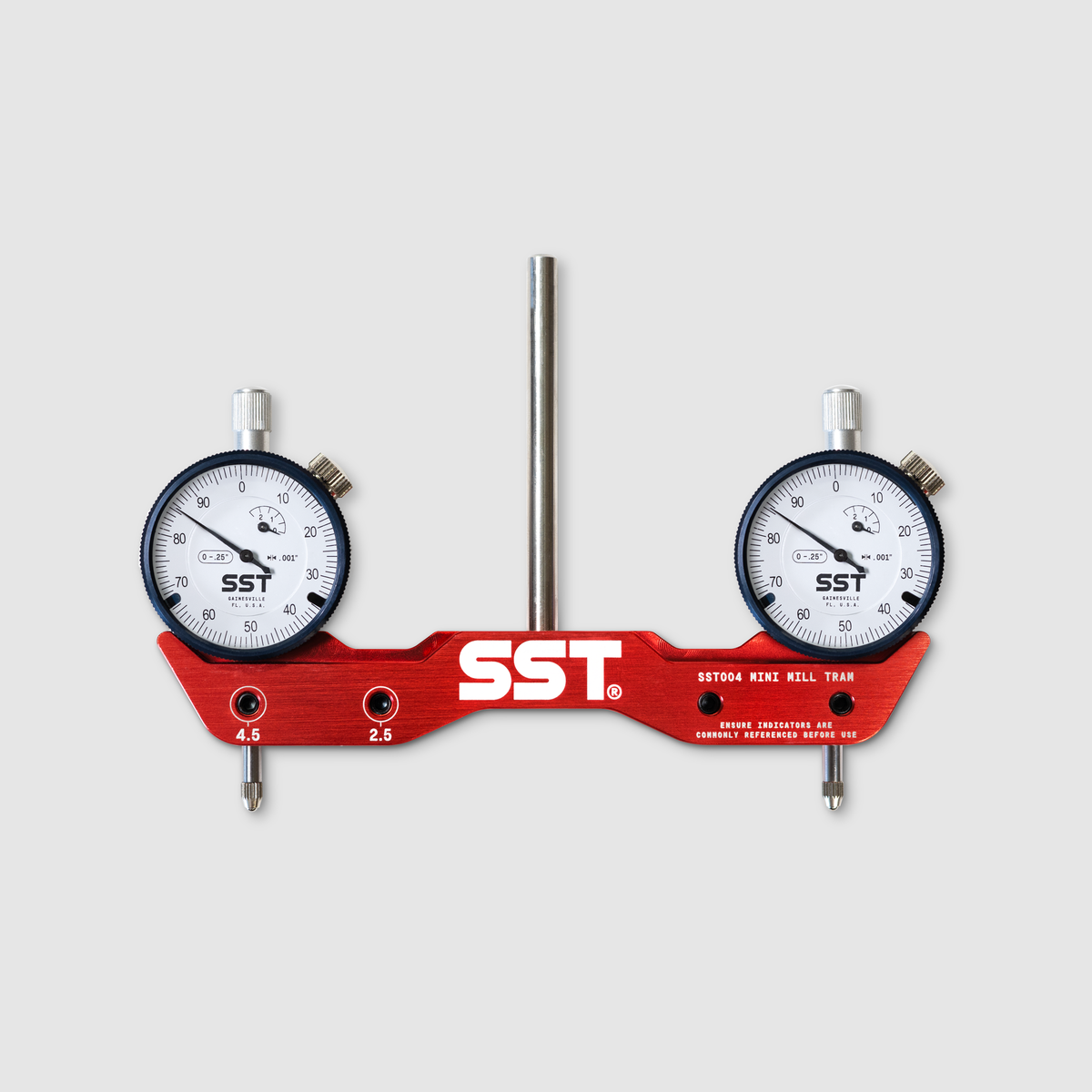

Unless you’re looking for sub-thousandths tolerances, I think one of these is plenty good enough…
You can even make one by bending a rod, or a couple dowels & a stick of wood.
I use one of these.
