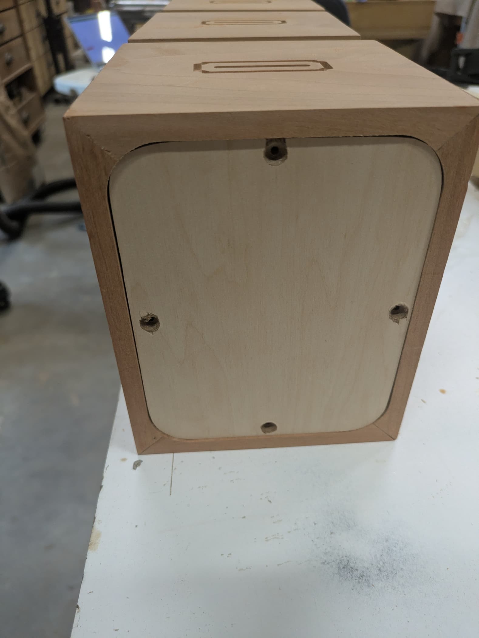

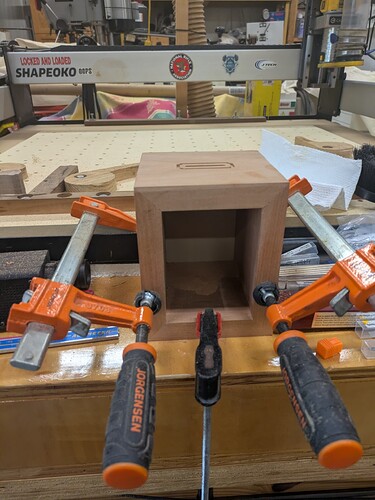

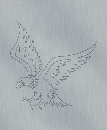

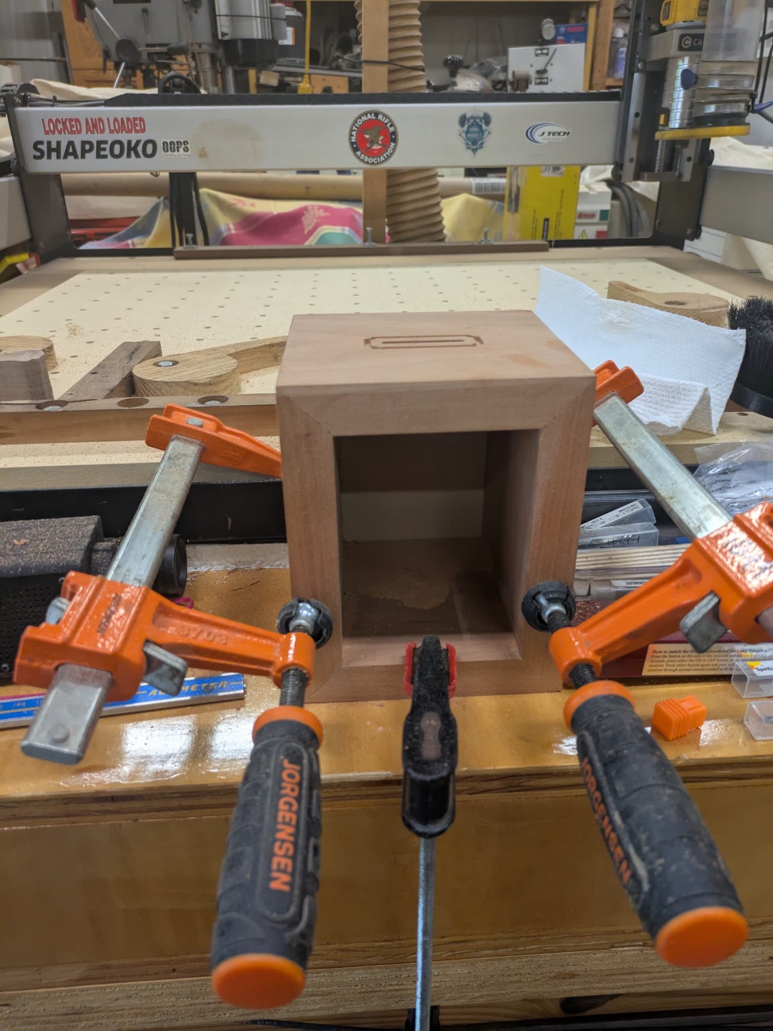

I have been working on some 1960’s Postal Box Doors to make 3 piggy banks. I have the cases done and the back rabbeted. I carved a hole in the top to drop money into. I am considering putting an eagle on at least one of them on the two sides. I will reverse so the eagle is pointing to the front.

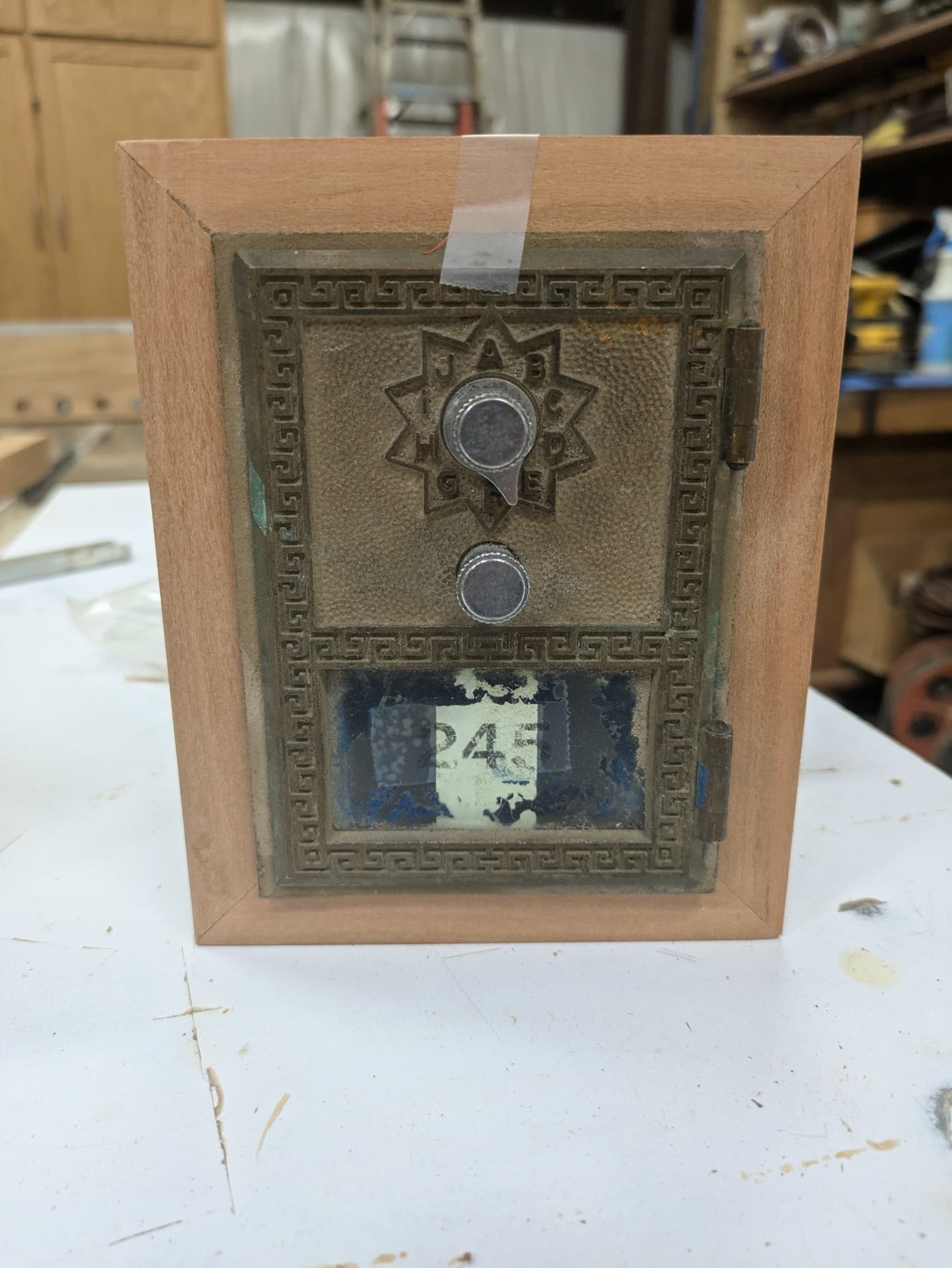

I used my SO3 on the front today to carve the money drop and an escutcheon simulation.

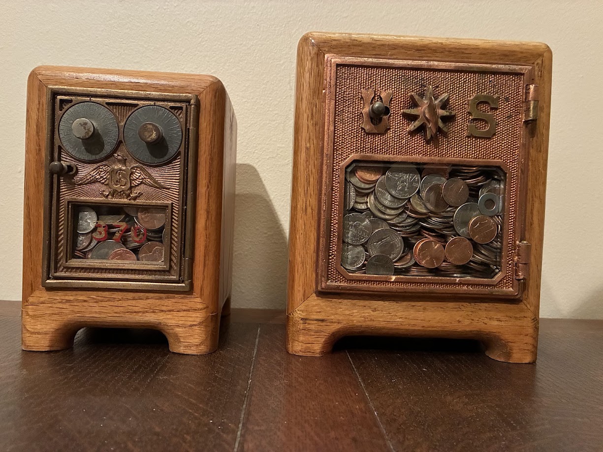

Here is a pic of what the boxes will eventually look like when finished.
Here is the back. I make an escape hatch so in the future if the combination is lost they can get in. If you have the door open you can figure out the combination. If the door is locked it is very hard to open. I may engrave the combination on the bottom. This bank is not Fort Knox. Just for fun.a

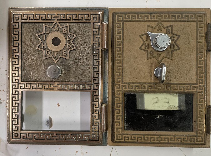

I have made some of these banks before and found 3 small and 1 large set of doors at a resale shop. Figured out the combination and need to polish up the bronze/brass to make it shinny.

Got one of the doors polished. It was quite an ordeal. I will leave the others with original “patina”.
Not really happy with the polish but it is good enough. I used metal polish, tooth brush, baking soda, buffing on a grinder. These doors are tough.
I made several of theses years ago and would disassemble the doors and soak the brass parts in muriatic acid, scrub them with a brush and clear coat them with lacquer and they would look great! These were done over 20 years ago
