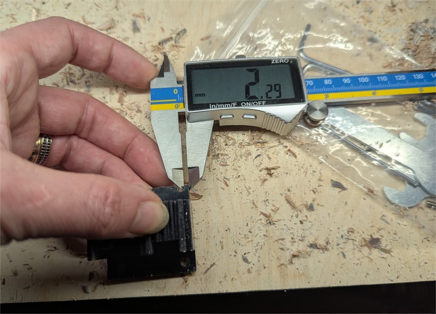

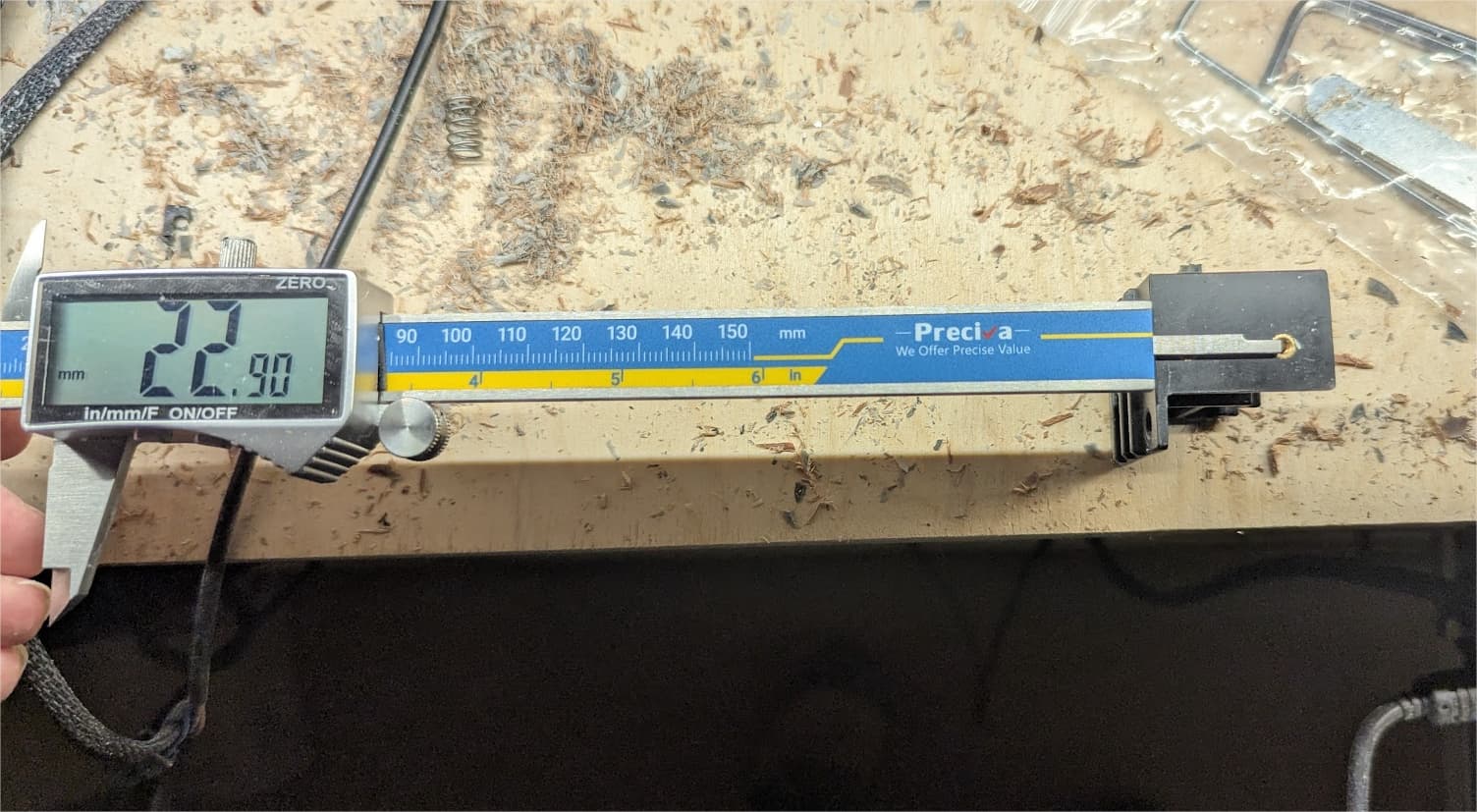

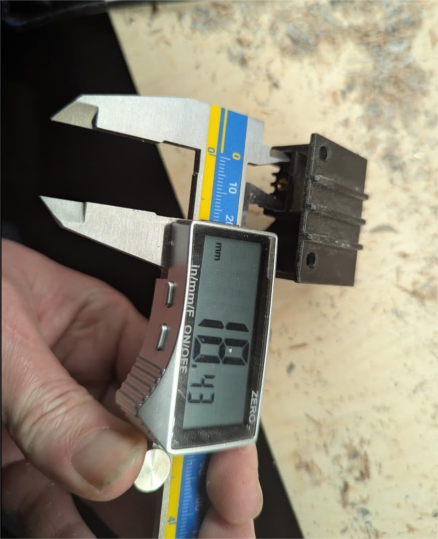

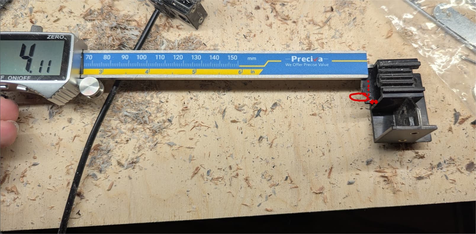

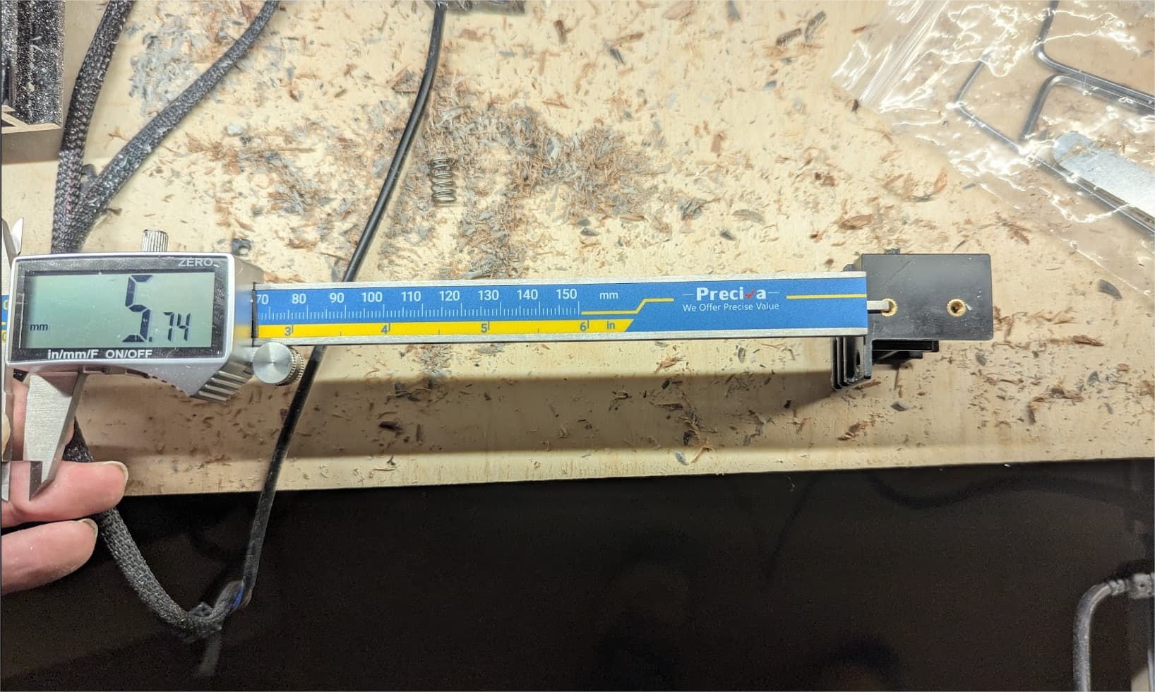

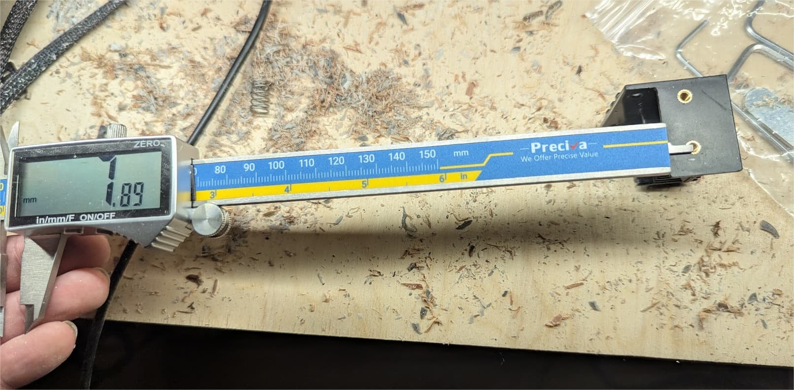

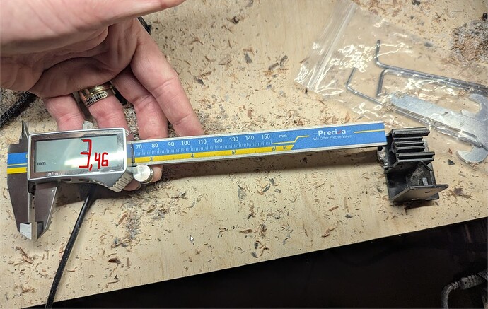

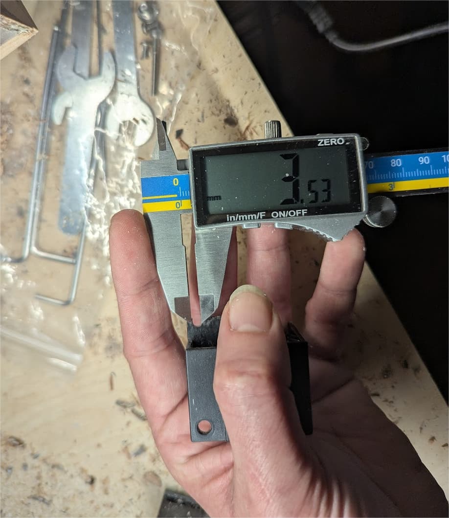

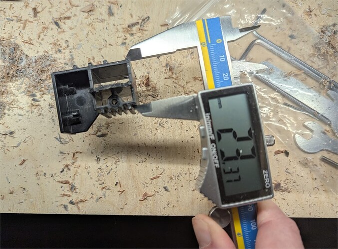

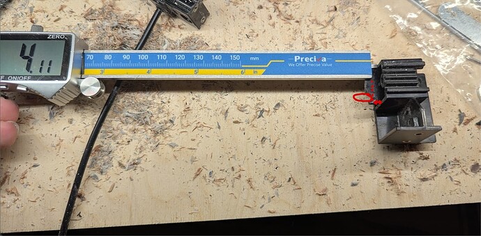

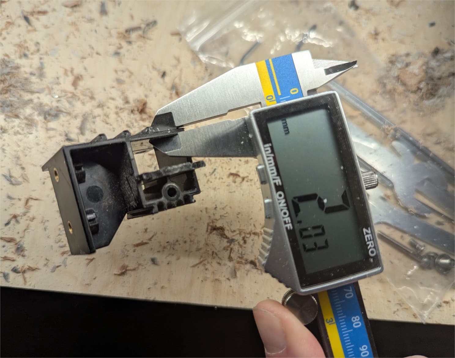

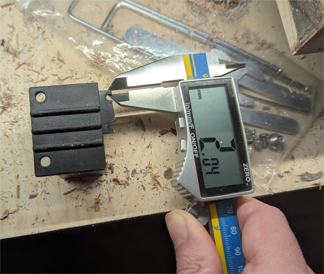

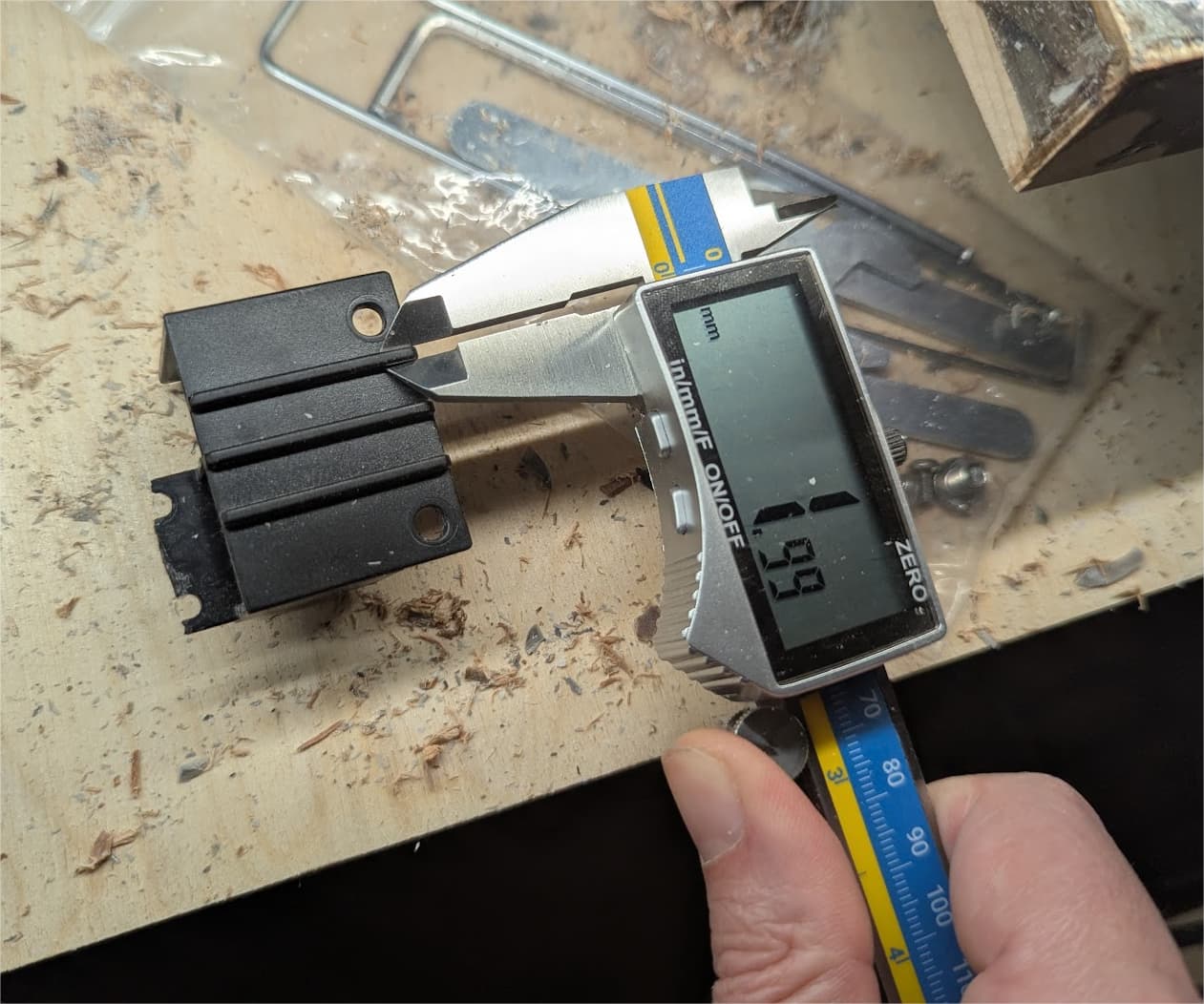

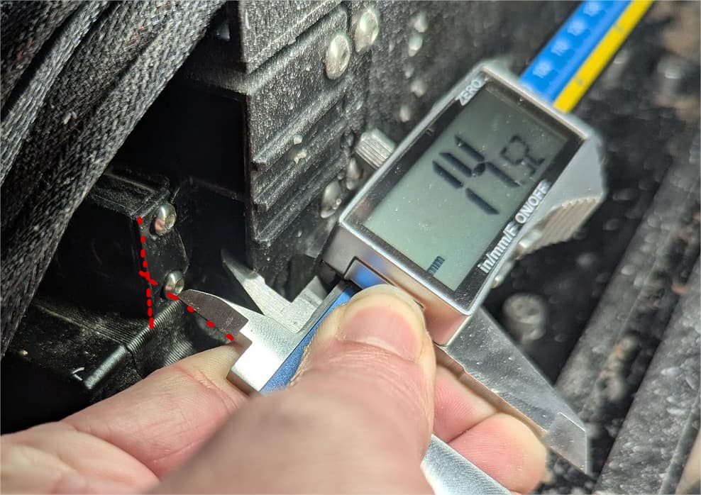

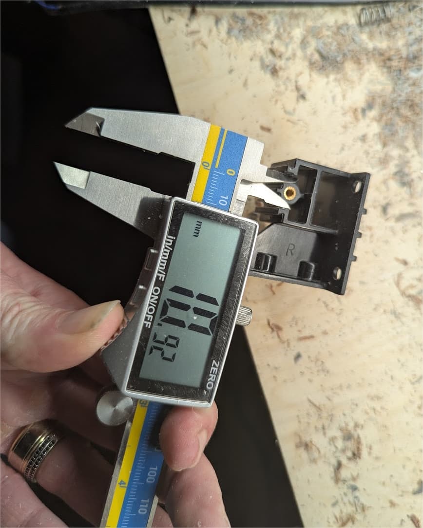

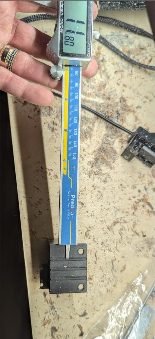

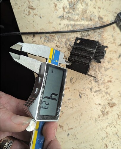

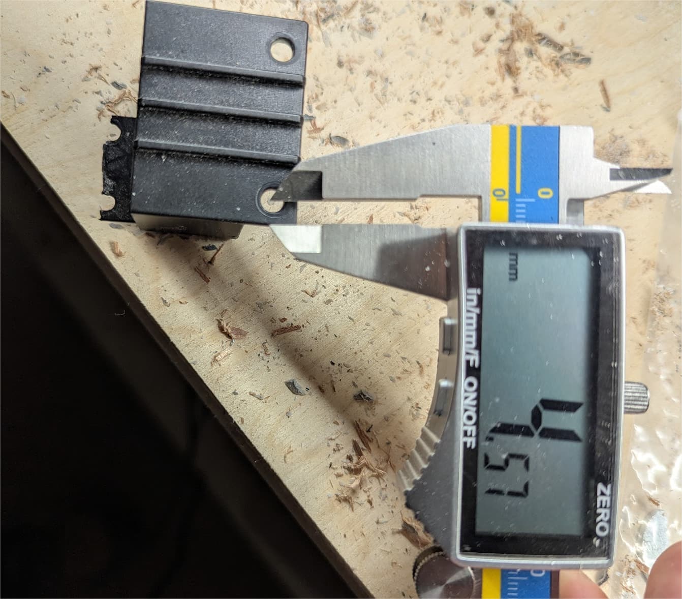

Here’s the different measurement you asked me :slight_smile:
Thanks! I’ll get those dimensions updated.
I am not sure what this dimension is? What feature is this for?
And I need these dimensions highlighted. Yes, I am working in imperial, but SolidWorks is nice in that I can just type in “2.3mm” and it converts it automatically.
And that should be about it. I can then upload it for you to do a quick print (in PLA probably) for a test fit, then any additional fine tuning before it’s ready for “the good filament”. :slight_smile:

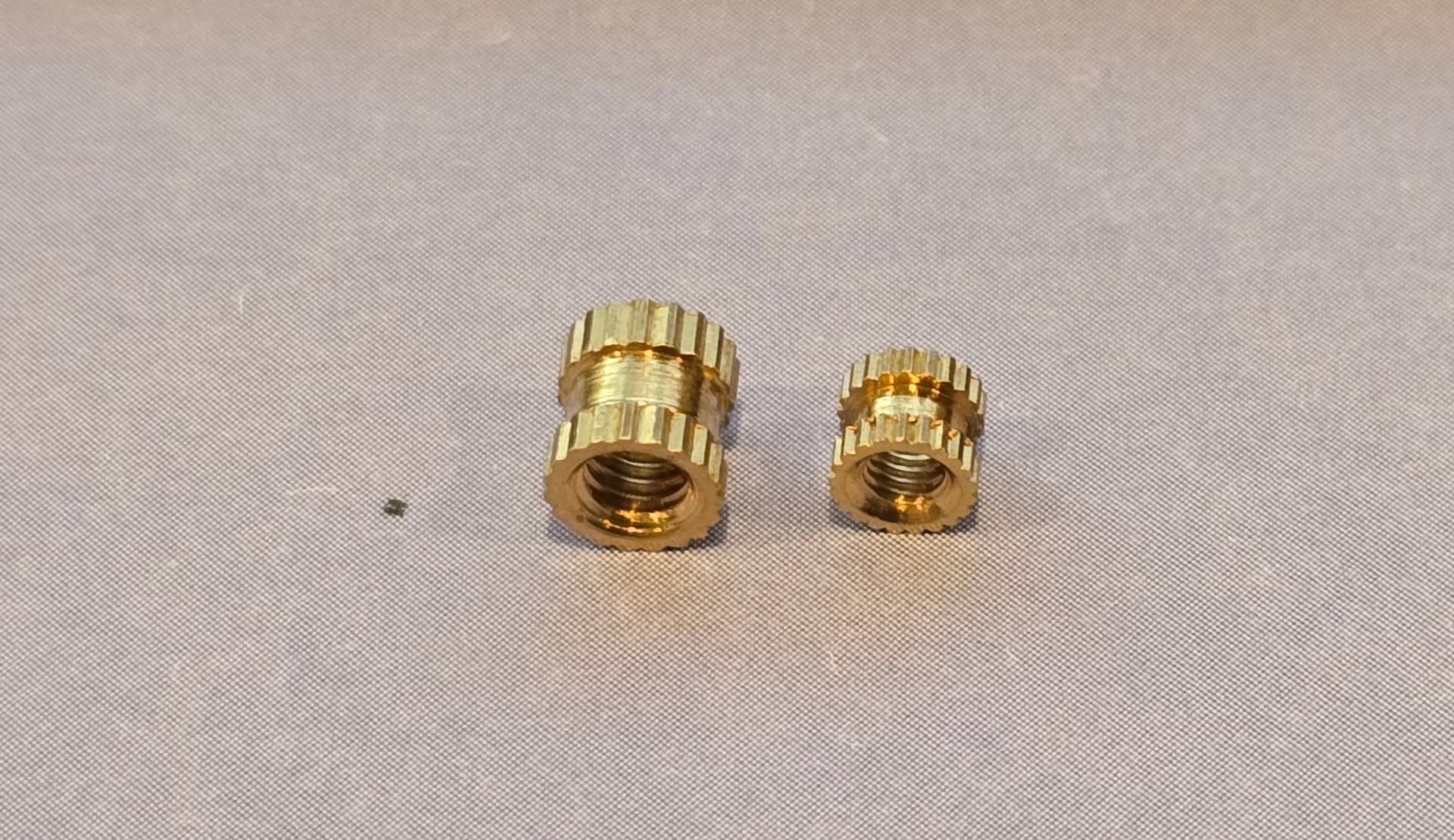

And I designed the holes for these M3 and M4 inserts. If you want, I can send you a couple if you happen to be in N. America.
I will also upload a version where the holes will be sized to the M3 and M4 tap drill diameter, so you can directly thread them as well if you want.

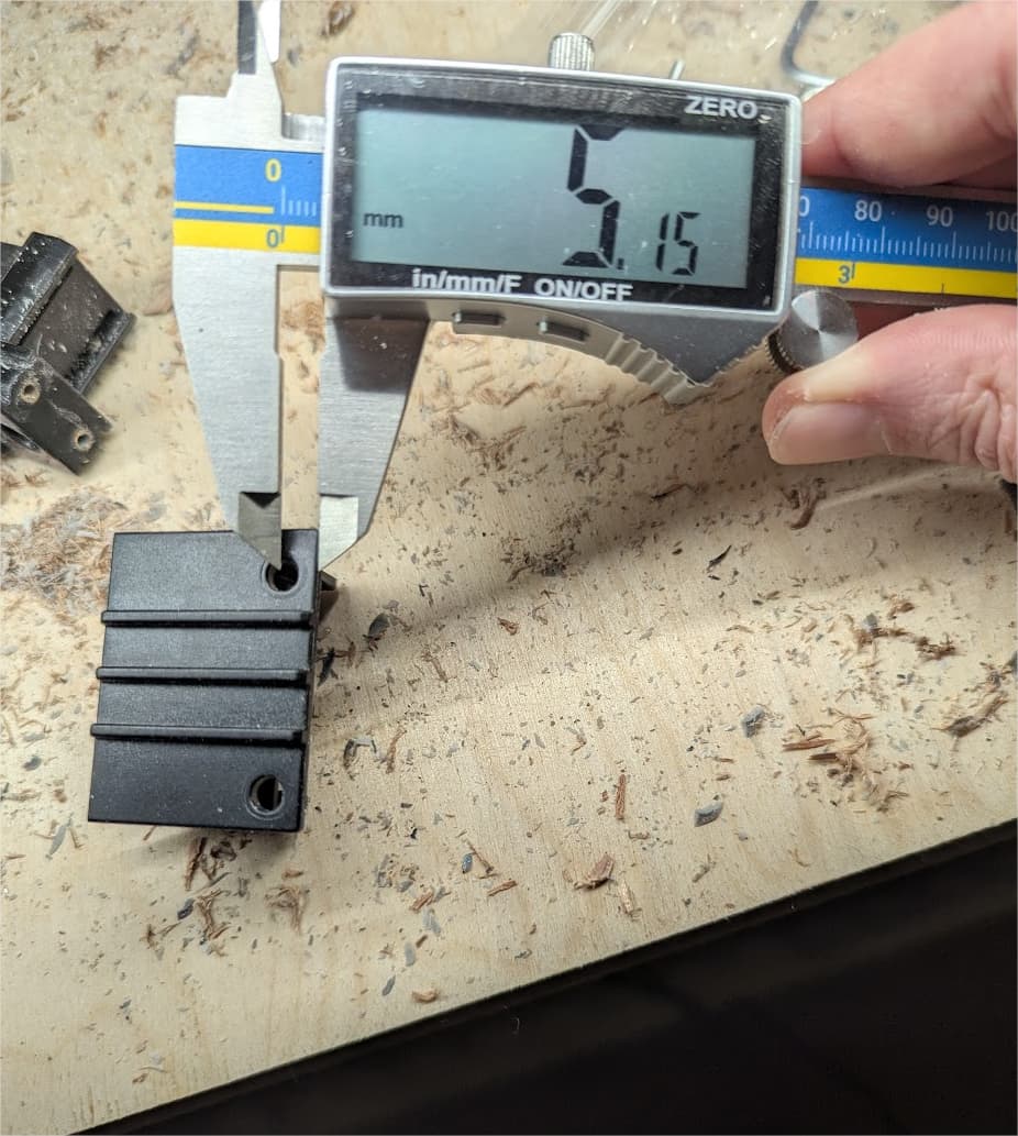

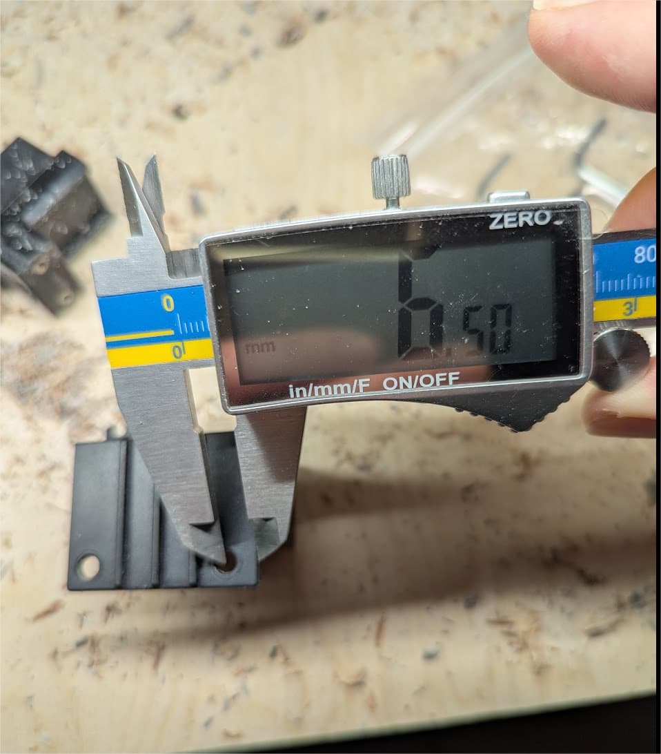

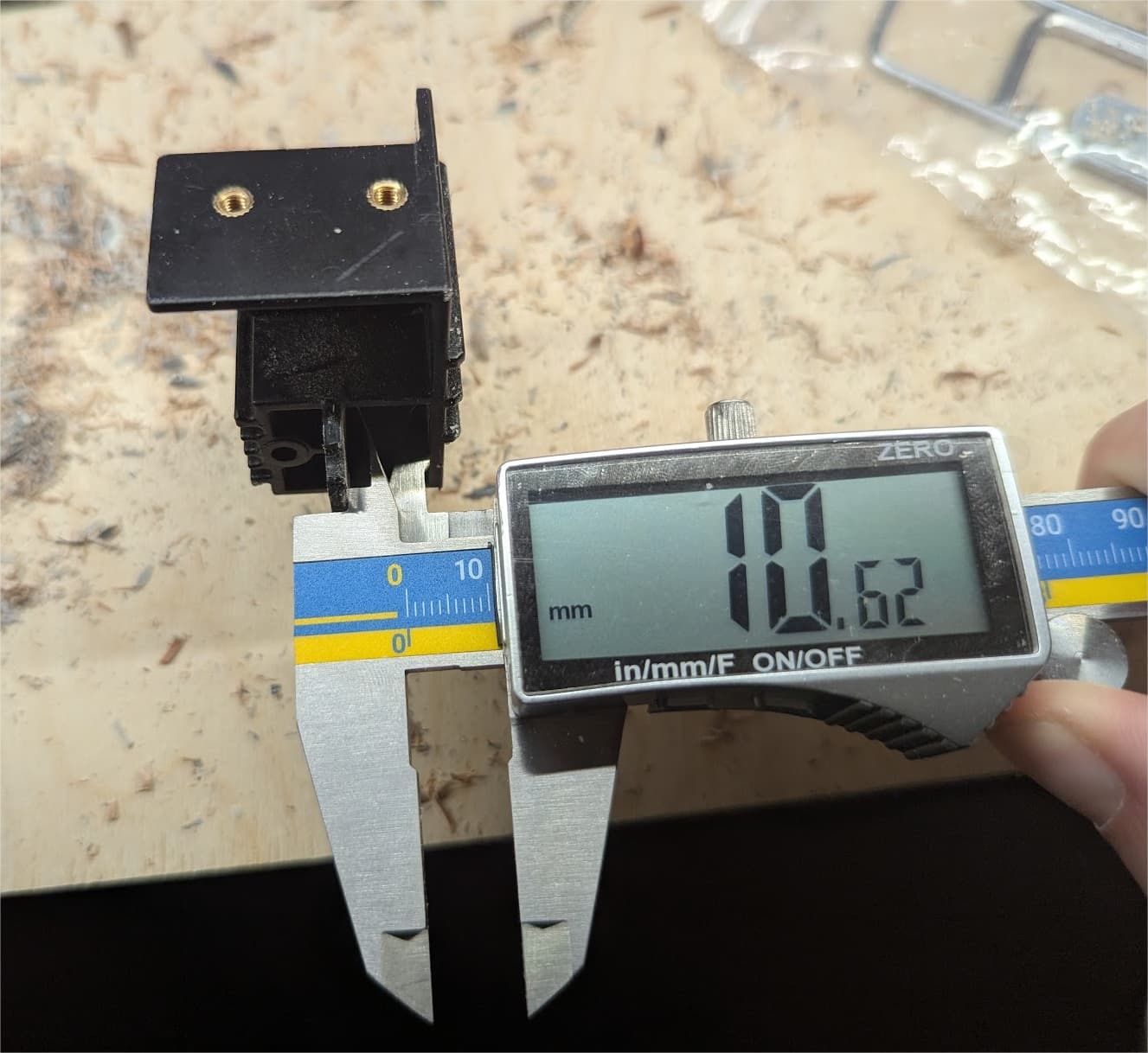

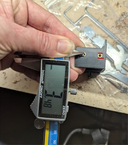

Here’s the last measurement
Sorry in fact for the photo you highlighted I realized that I was wrong, it’s the length between the border and the beginning of the hole for the screw :
In fact, PLA test and after I will see what type of filament to use :slight_smile:
I’m based in Montreal, that’s really appreciated, but after all the work you are doing, I dont want to ask you more than you already do, which is awesome. For the insert, I will check on internet i’m quite sure I can find a store not so far.
And in fact a version with the hole sized to fit M3 and M4 is perfect for first test :slight_smile:
Thanks again for all the energy and work you do, that’s really really appreciated

Can I ask you the version without the M3 & m4 insert?
I mean the version with the hole directly M3&M4, it will be easier to test because i dont have yet the the insert, if not no problem, I will try my best to find them fast :slight_smile:

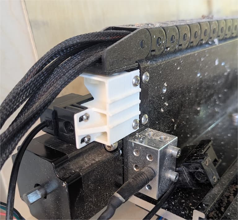

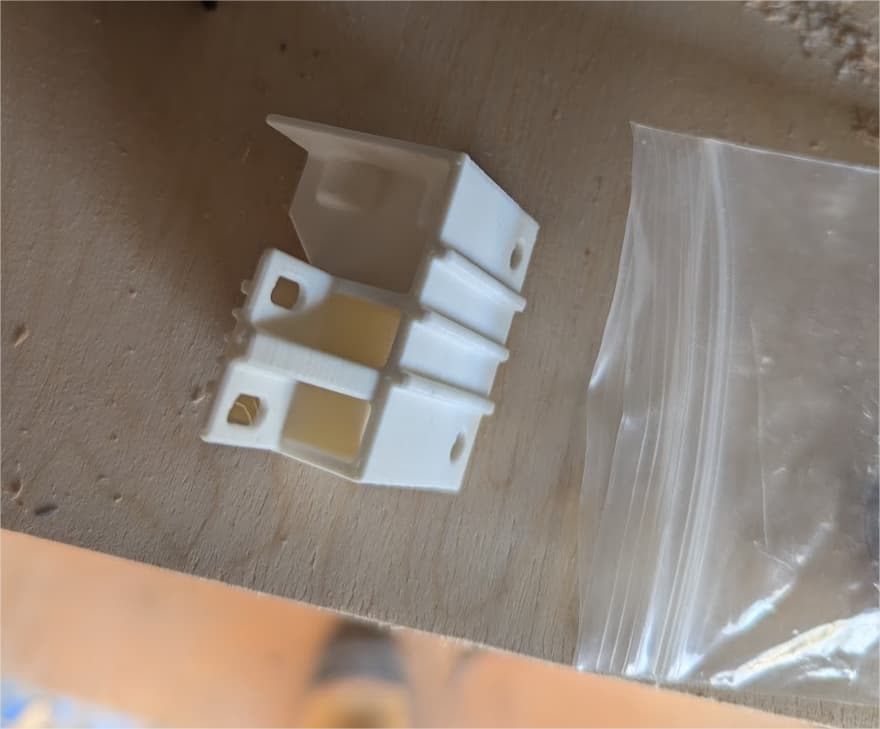

It works so well,
I just did a little touch up with my knife for the bottom screw!
The first print test works like a charm!
