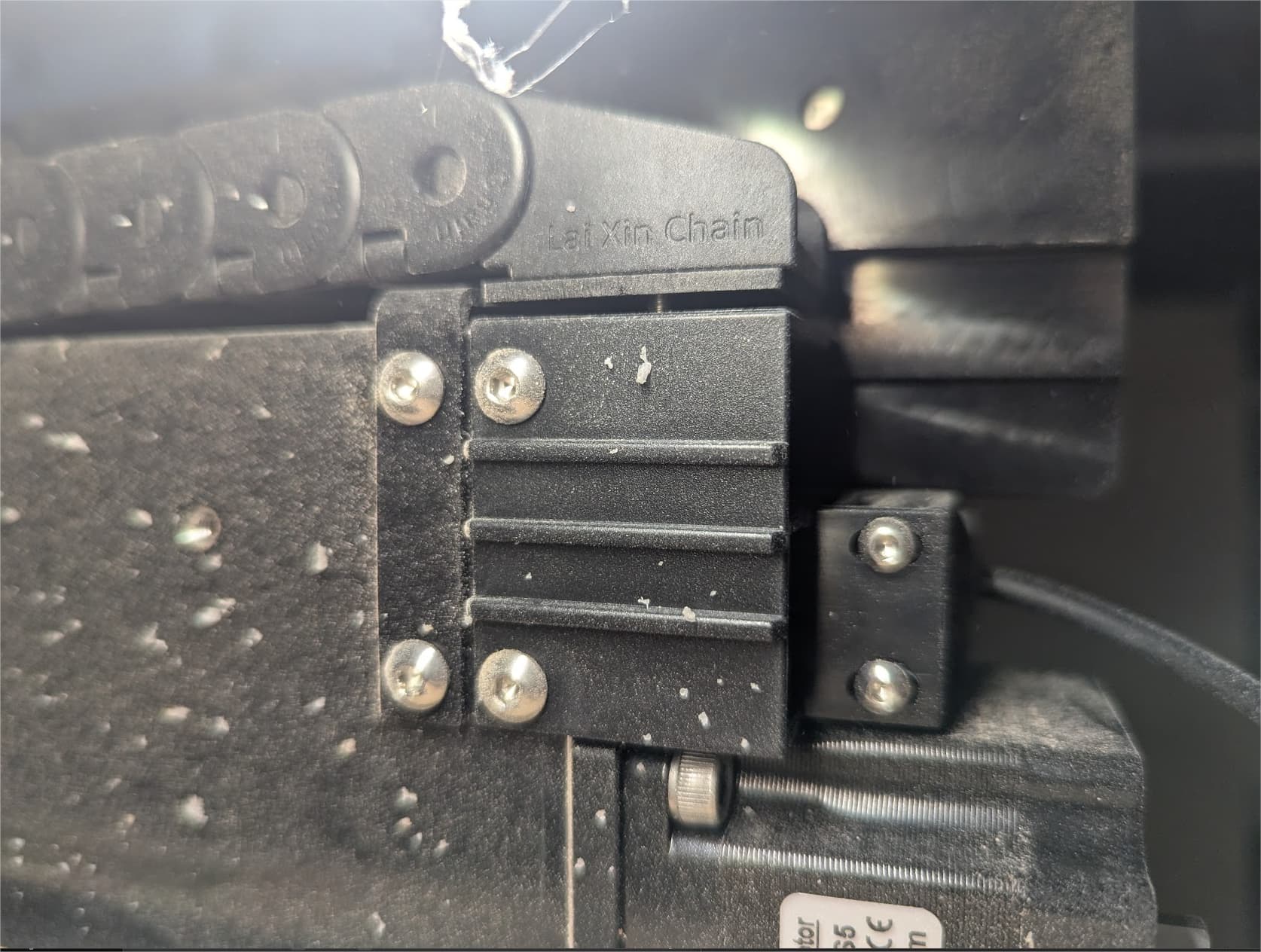

Second time, the dust collector fall off during a surfacing, and when the CNC finished its job it runs to bottom right, I think this the moment the dust collector runs to the plastic piece of the X&Y sensor.
I re-order, dust collector, the router thas was doing a Noise as hell, and a MCFly 1/4.
Then when I looked to relauch the surfacing I realised the plastic bracket to fix the X&Y sensor at the right was broken>

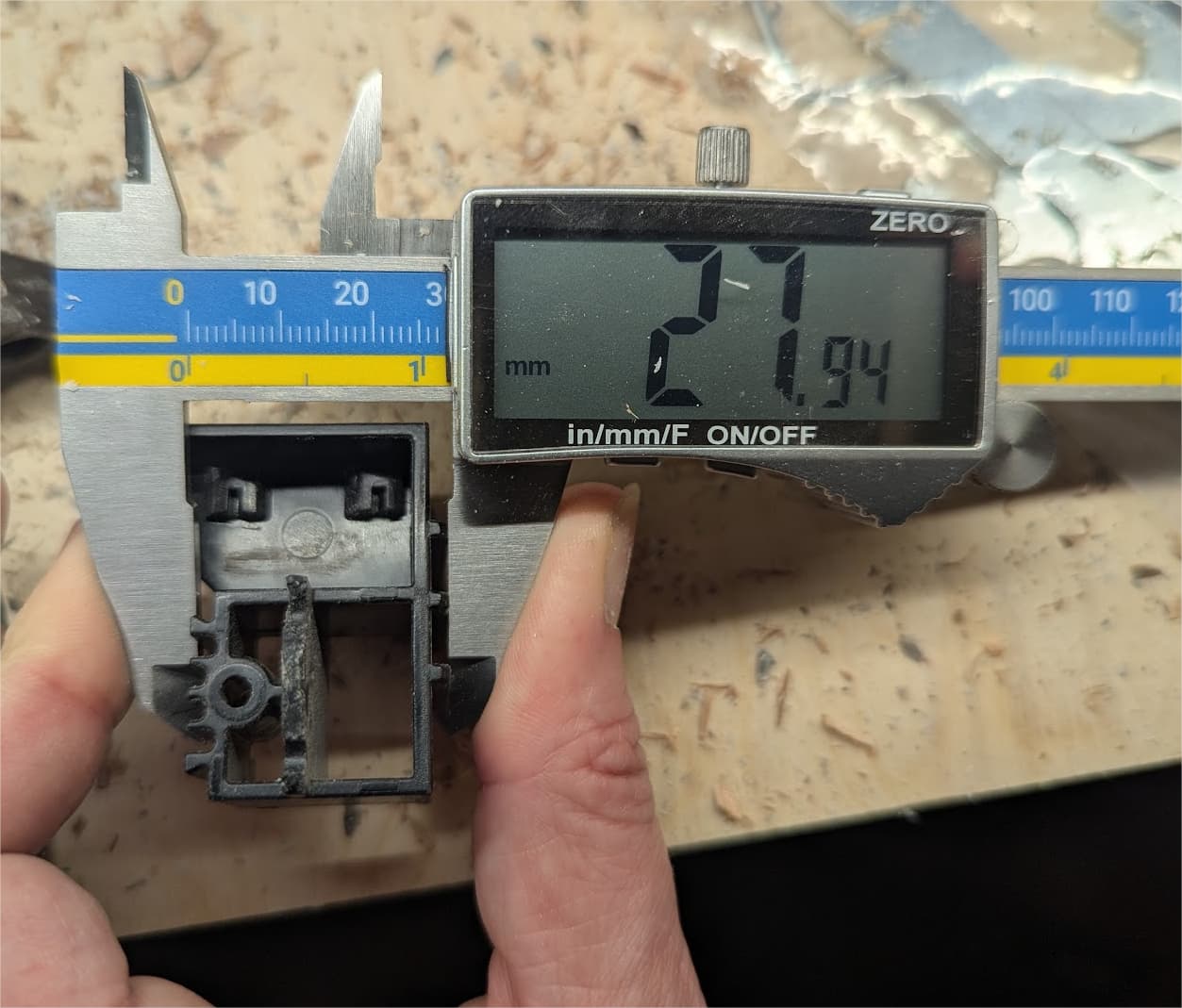

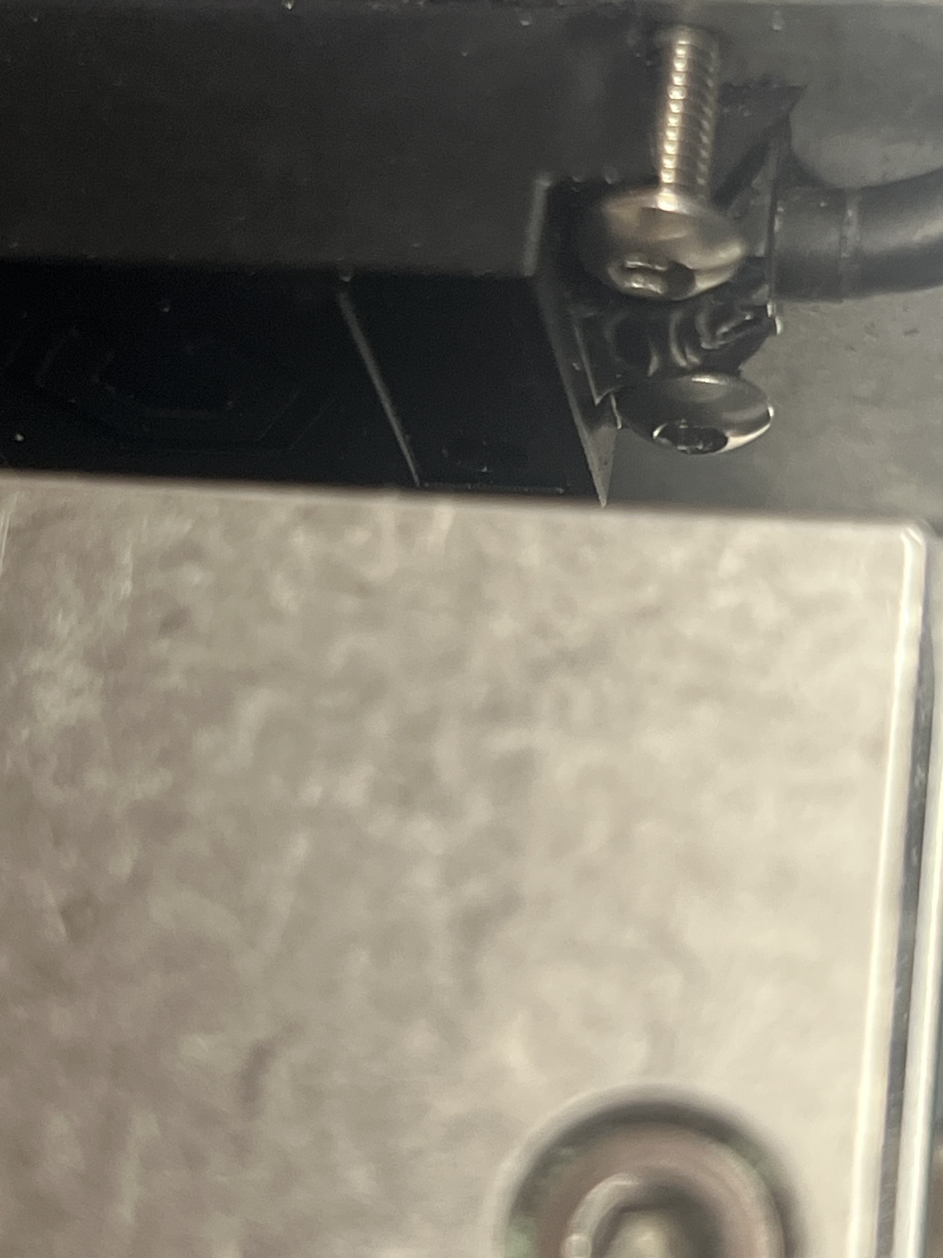

If you have some calipers, either post a dimensioned sketch or take pics of the bracket with the calipers showing the dimensions and I can whip something up.
Edit: As well as pics of it installed on your machine so I can see where I can add additional support and make it stronger, if you want.

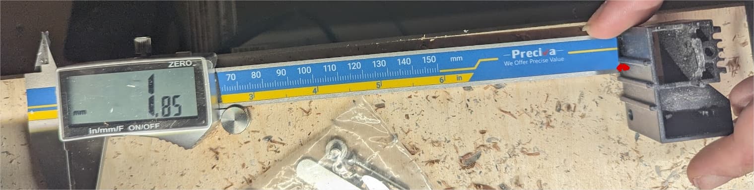

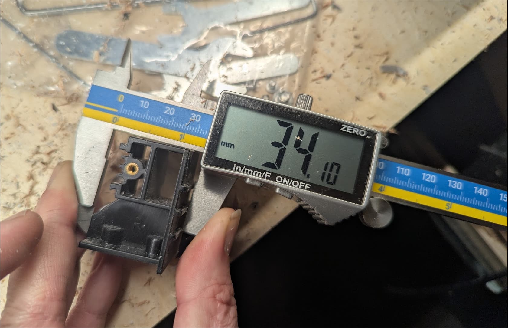

It’s the exact same piece as that one, but mirror on X

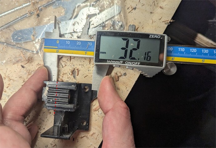

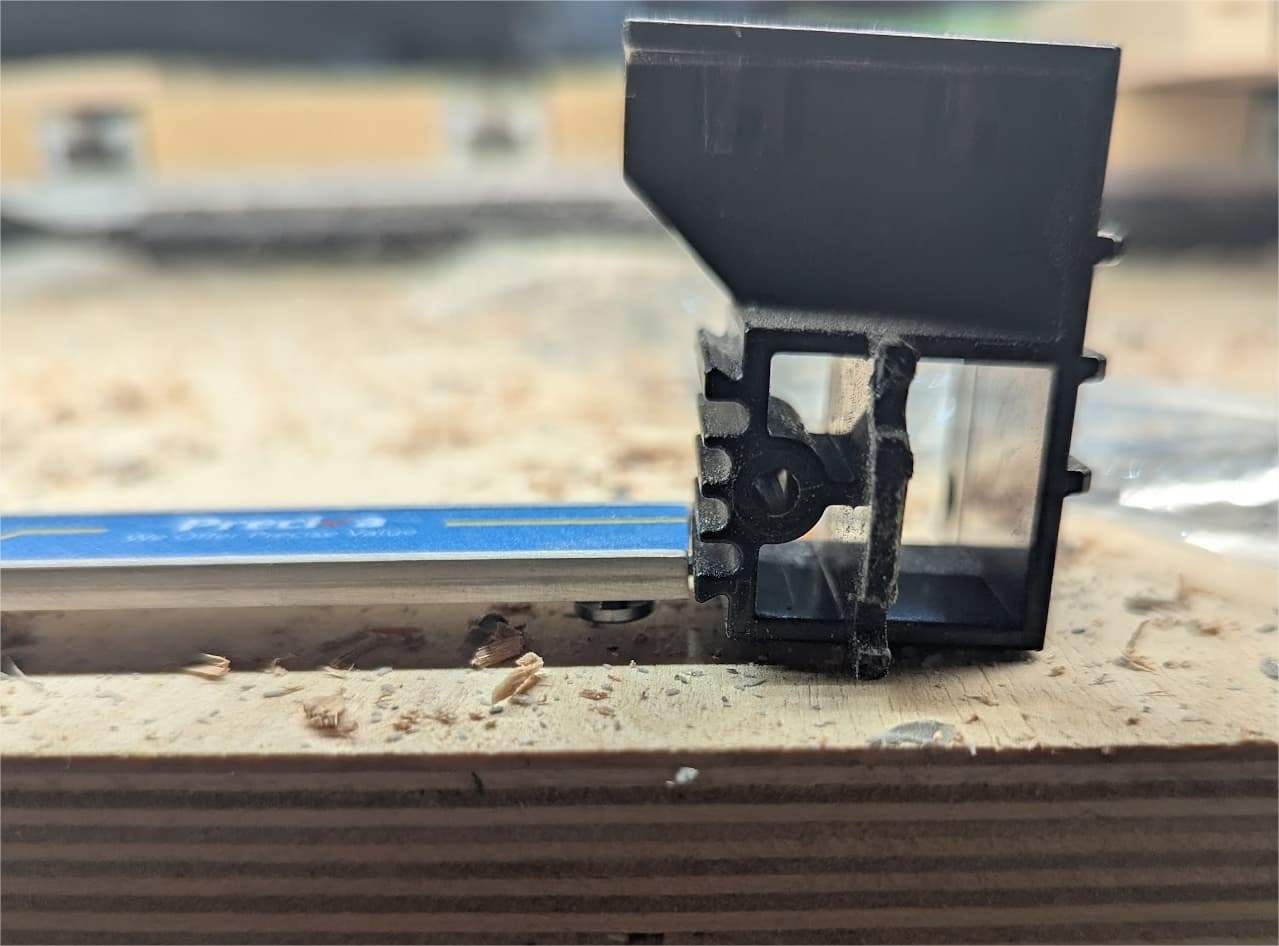

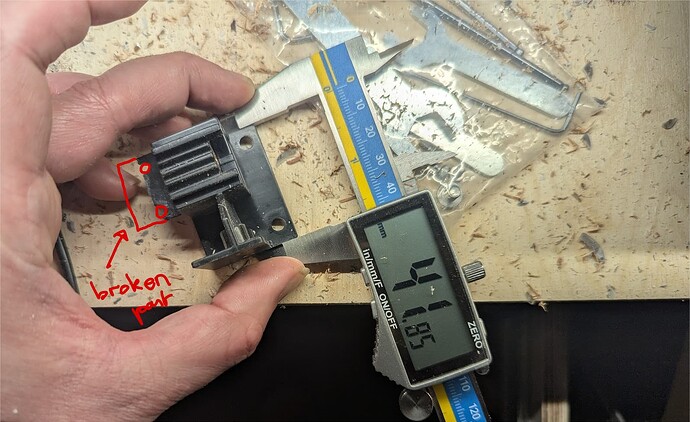

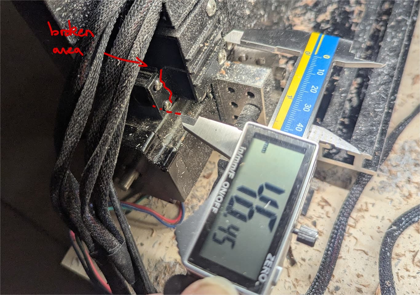

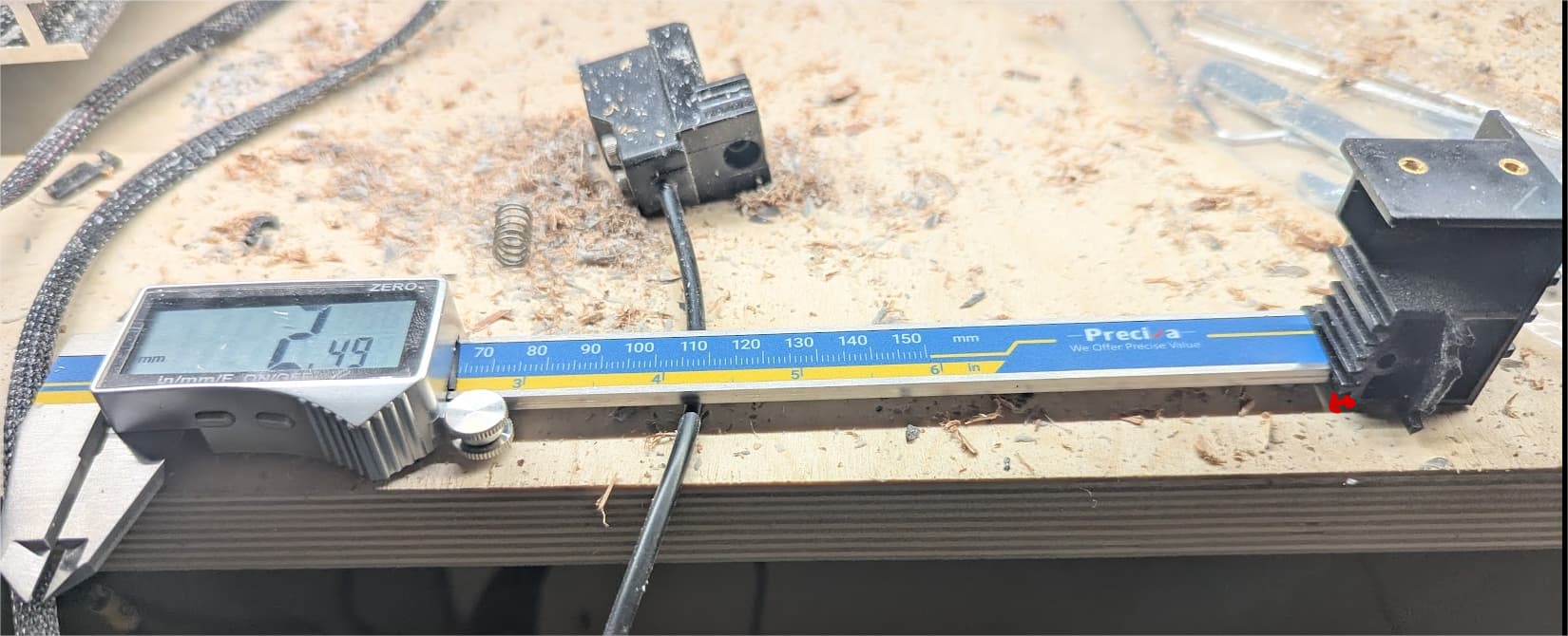

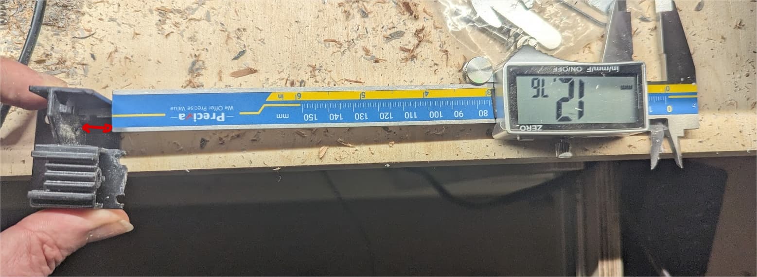

I will upload photos from the broken piece with my caliper right after that sent

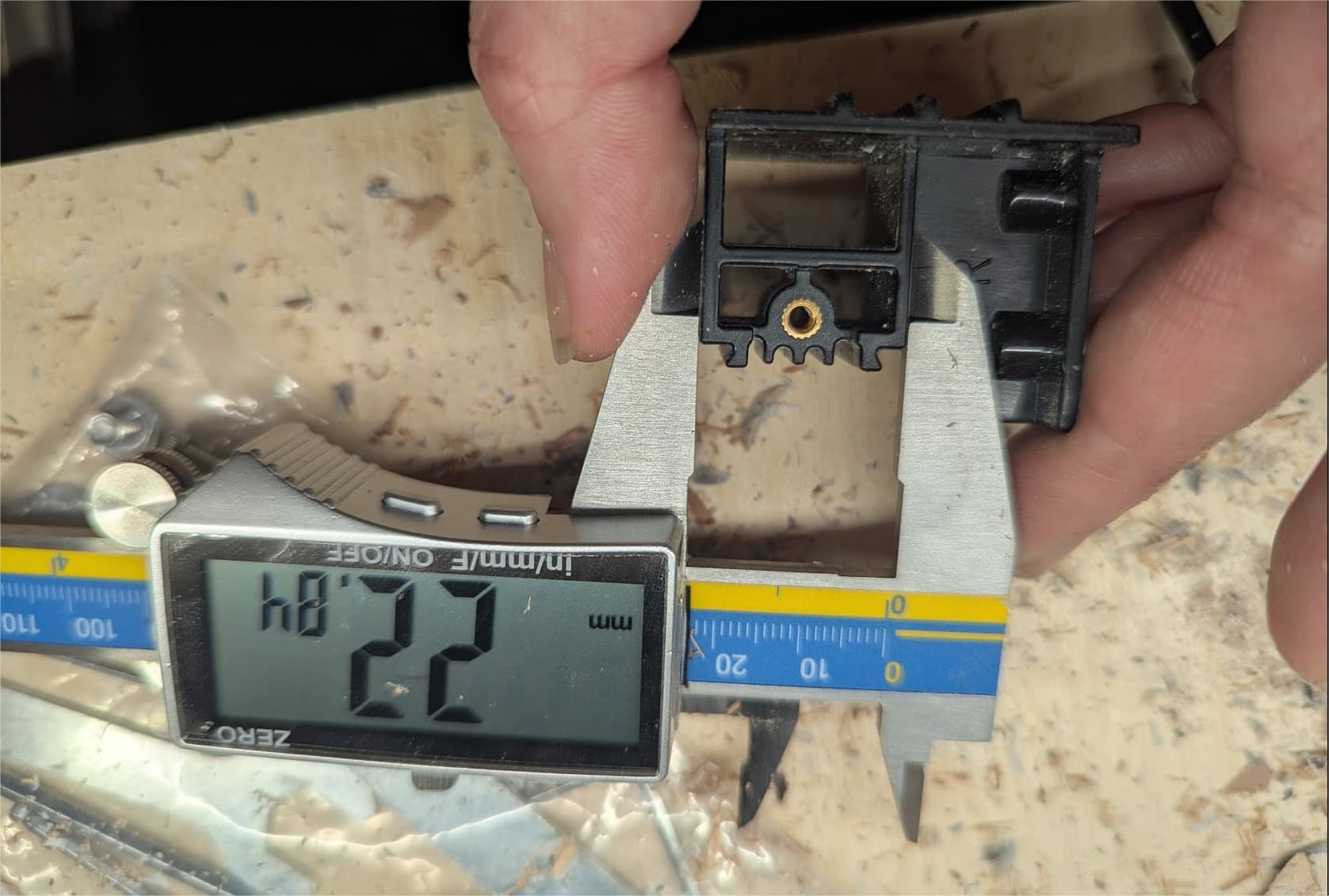

Here’s the dimension with caliper from the broken piece
Okay, great pics. I will get something posted this evening.

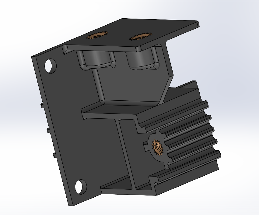

I’ll make two versions - one for threaded inserts and one for direct threading the plastic. I have found that threads in the plastic are actually pretty strong. Especially for something like holding this limit switch in place threads in the plastic may be enough, but I’ll make two versions so you have the choice.

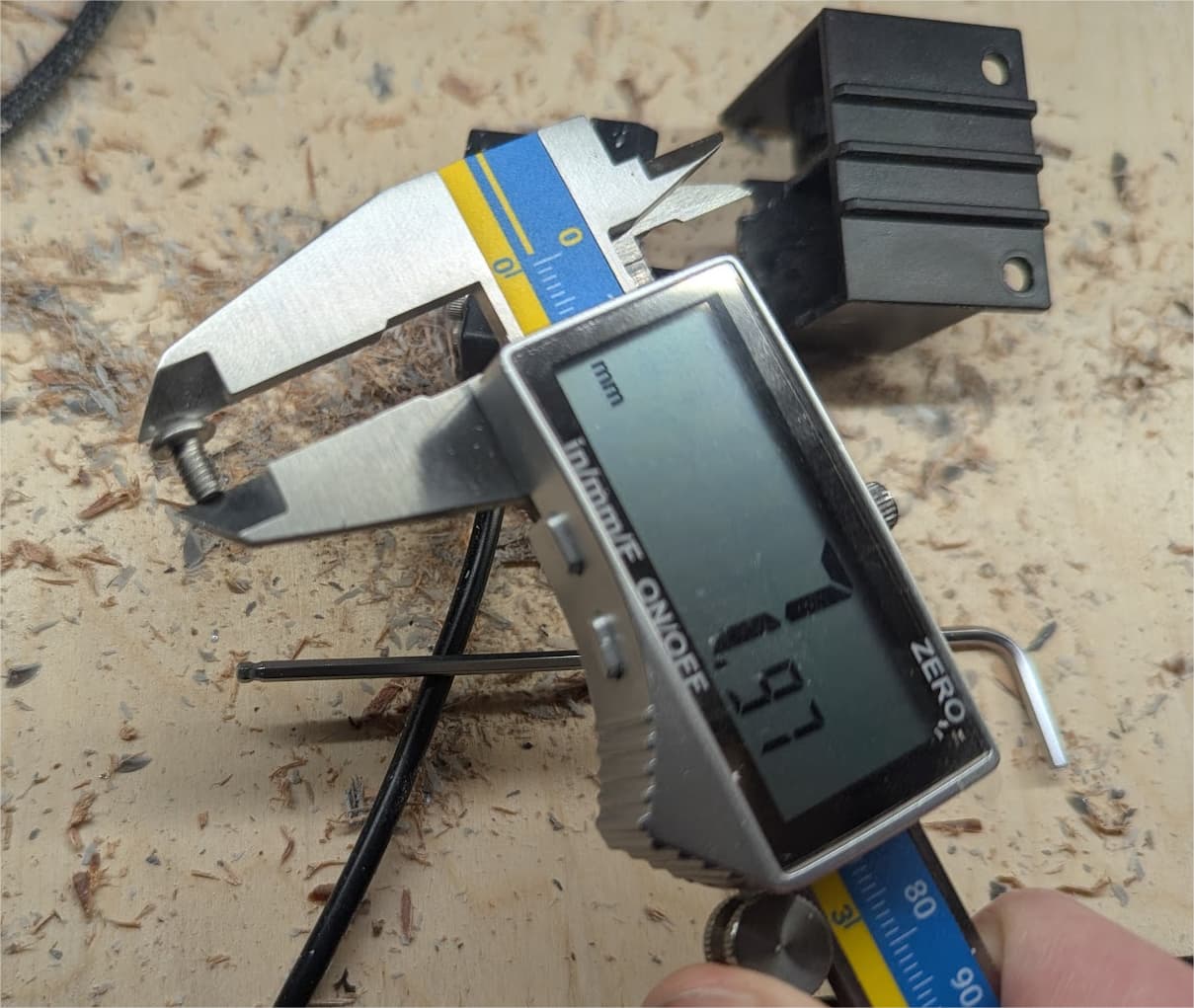

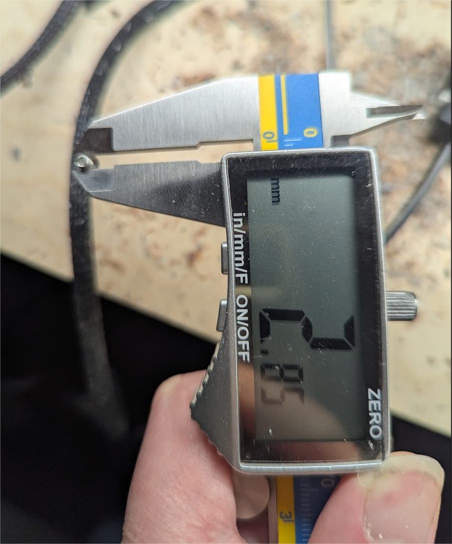

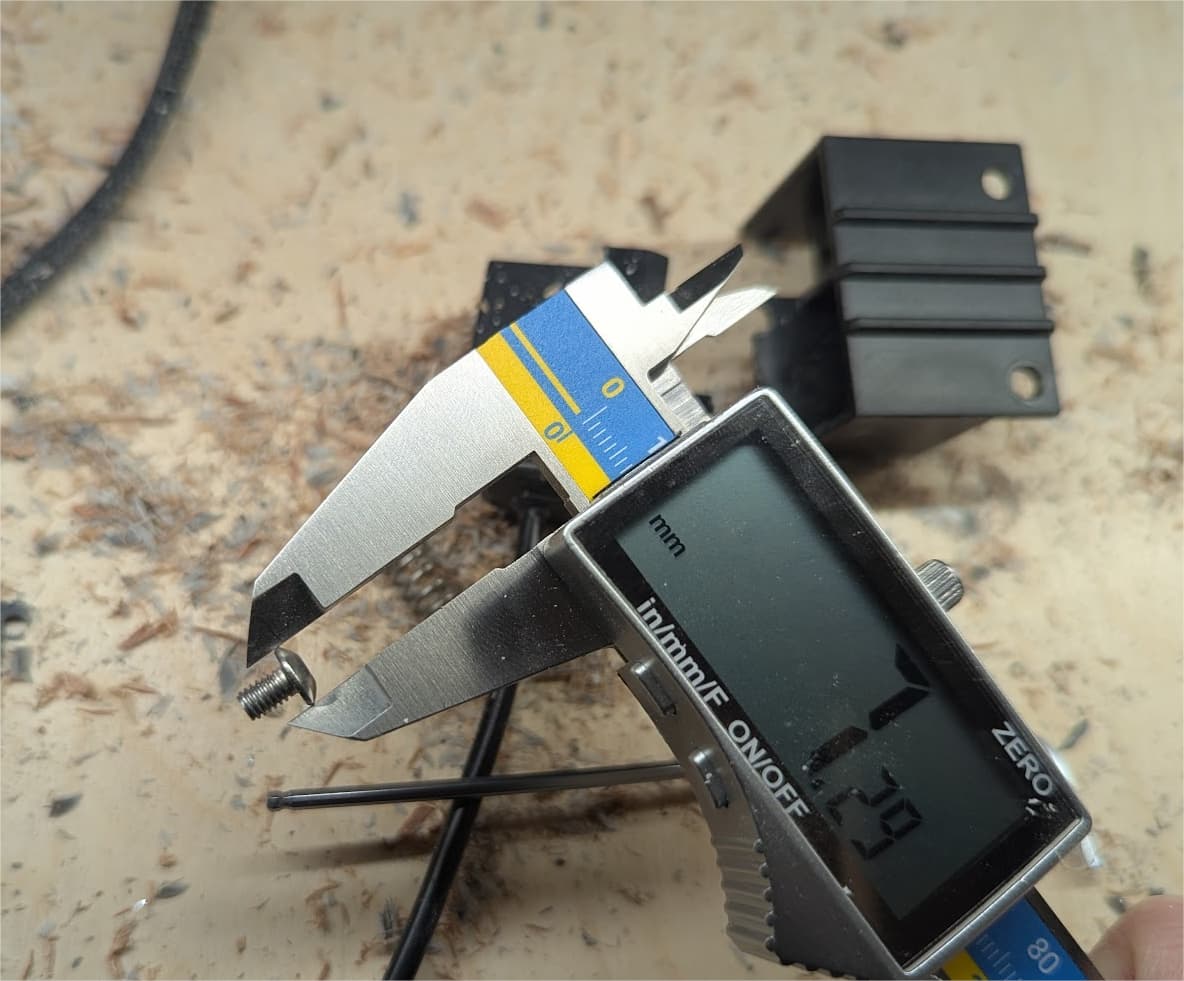

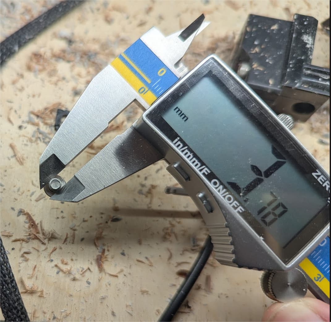

Here’s the dimension for the two little screws that attached the sensor :
And here’s the size of the two screws that attach that piece to the CNC

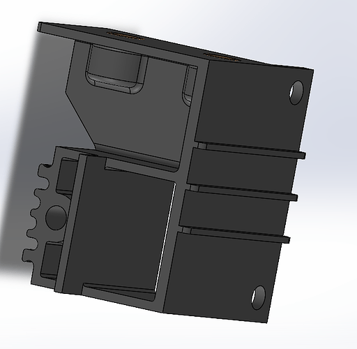

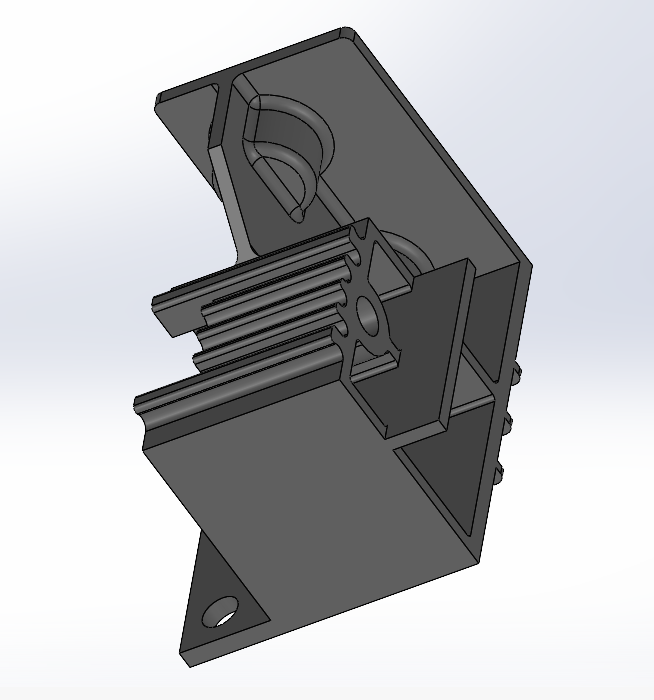

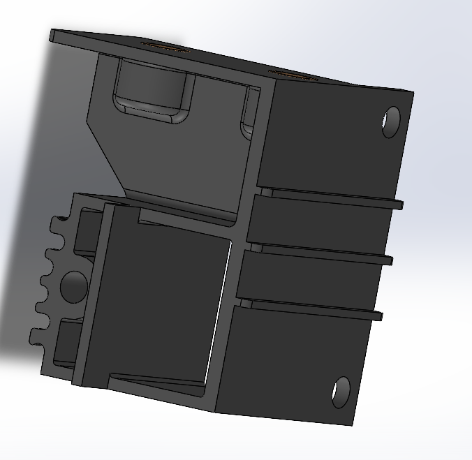

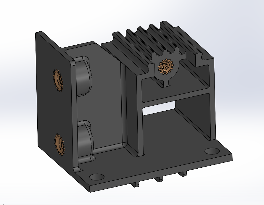

Okay, here is what I have so far.
I had to guess at a few things, so if you could get me some more dimensions, that would be great.

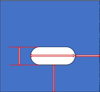

And the slot dimensions. You can put the very tips of your calipers in the slot of the undamaged slots to get that dimension, and then the width of the slot, then the distance from one edge of the slot to the side of the tab.

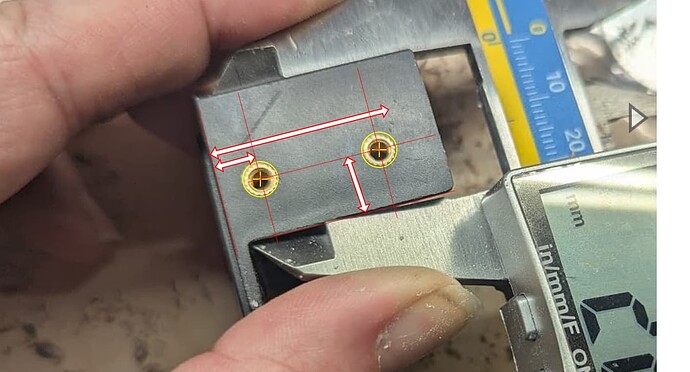

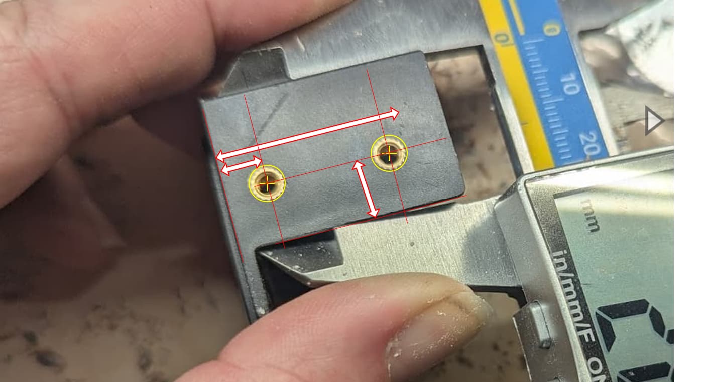

The centers of these two inserts.
I had to guess their locations using the tried and true method of grouping 11 lines together at a set distance, then rotating and stretching them to make a grid to estimate the distance based on the known dimensions of the rectangle.
Each red line is ~2.2mm apart, and each yellow is ~3.49mm apart. I copied the array and shrank it again to get a totally accurate 1/100 scale :wink:.

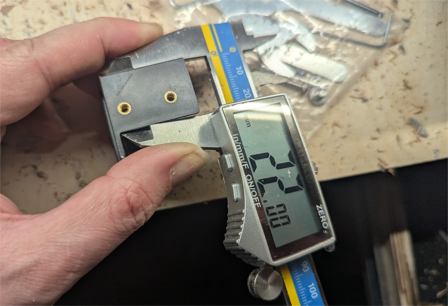

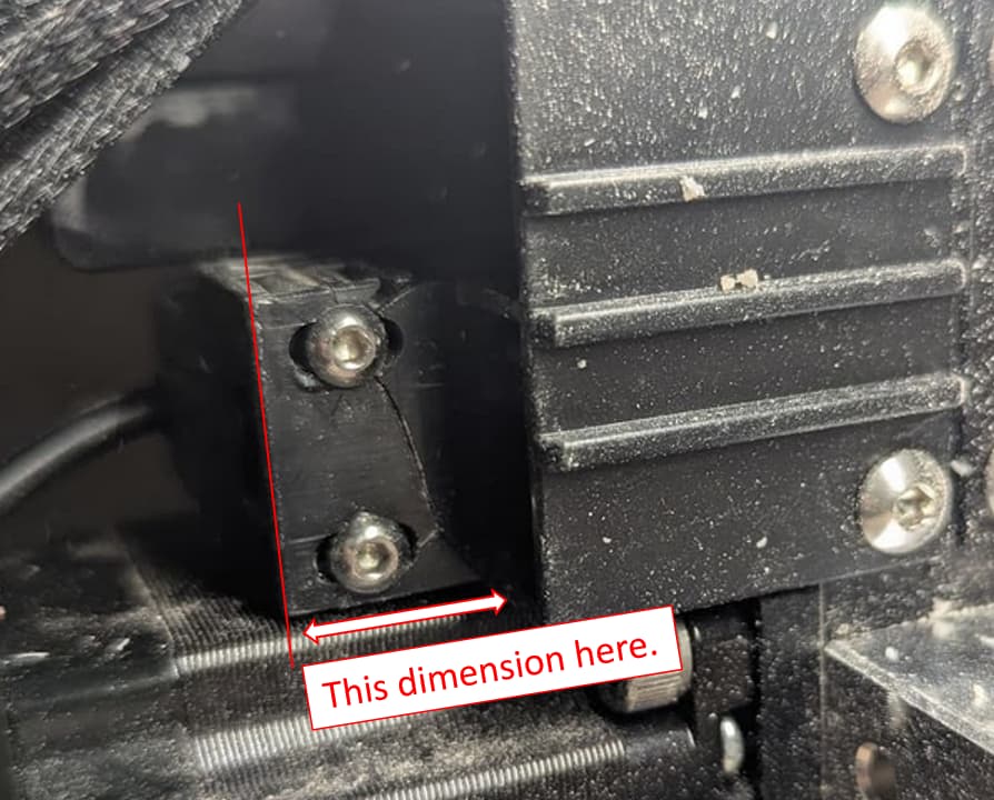

This dimension. I estimated it to be 6mm, but doublecheck please.

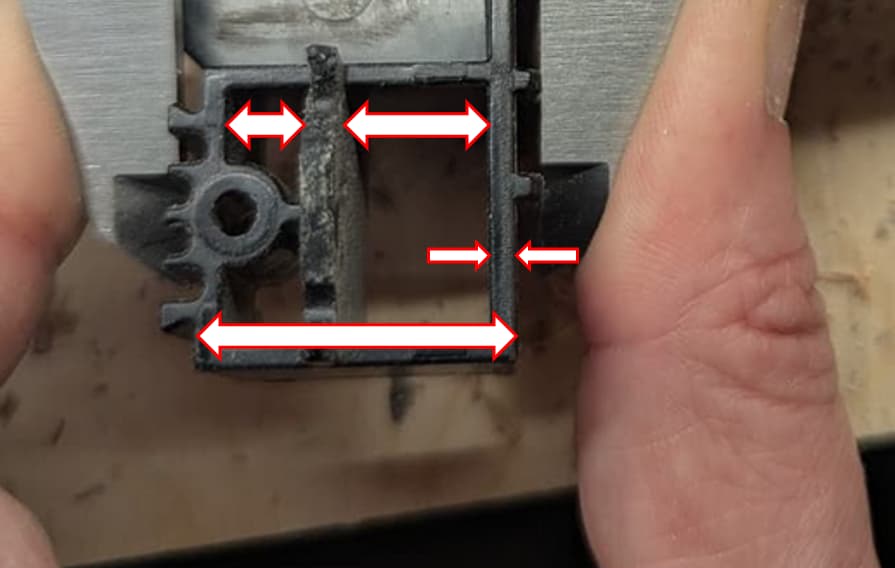

Also, these dimensions. Inside to inside of the wider chamber, narrower chamber, the thickness of the walls, and the outside to outside height, not including the “fingers” on top.
Oh, and these hole diameters, and distances from the edges.

No worries! What are you going to print it in? You wrote CF, but what combo? PC-CF, PP-CF, PETG-CF, PA-CF? I just got a couple of rolls of Prusa PP-CF and I haven’t tried it yet. It is recommended to put in a .6mm nozzle with the PP-CF, but I’ve just not done it yet.

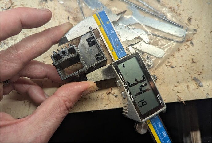

In addition to the depth of that cavity (red lines), I also need the width (yellow lines).
And regarding the previous post looking for the slotted hole dimensions, this is what I meant:

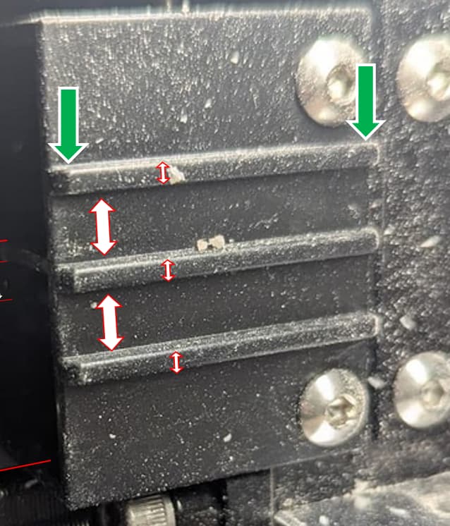

And these dimensions are probably not needed, but you could also give me the dimensions between the three strips, and the width of them as well (red/white arrows), and it looks like they are slightly angled, so the height of each end (white/green arrows).
Unless there is an interference, I am planning on adding a 4mm wide rib right down the middle of the two fasteners on the tab that is broken.
Also, a quick lesson regarding measuring screw/bolt grip length - the measurement starts at the surface of the material being fastened. In the case of the button head fasteners, the grip length “screw length” starts under the head.
Also, for measuring the screw thread diameter, you should not use the beveled teeth to measure the thread outer diameter, but the flat part of the jaws. For small screws like these, there is not much difference, but for larger fasteners, the beveled tips of the jaws drop into the threads and do not measure the proper outer diameter of the threads.
Based on the McMaster-Carr solid model, those screws are M3x0.50mm x 5mm long. I was able to kind of wing it with the dimensions, and I think I am close.
