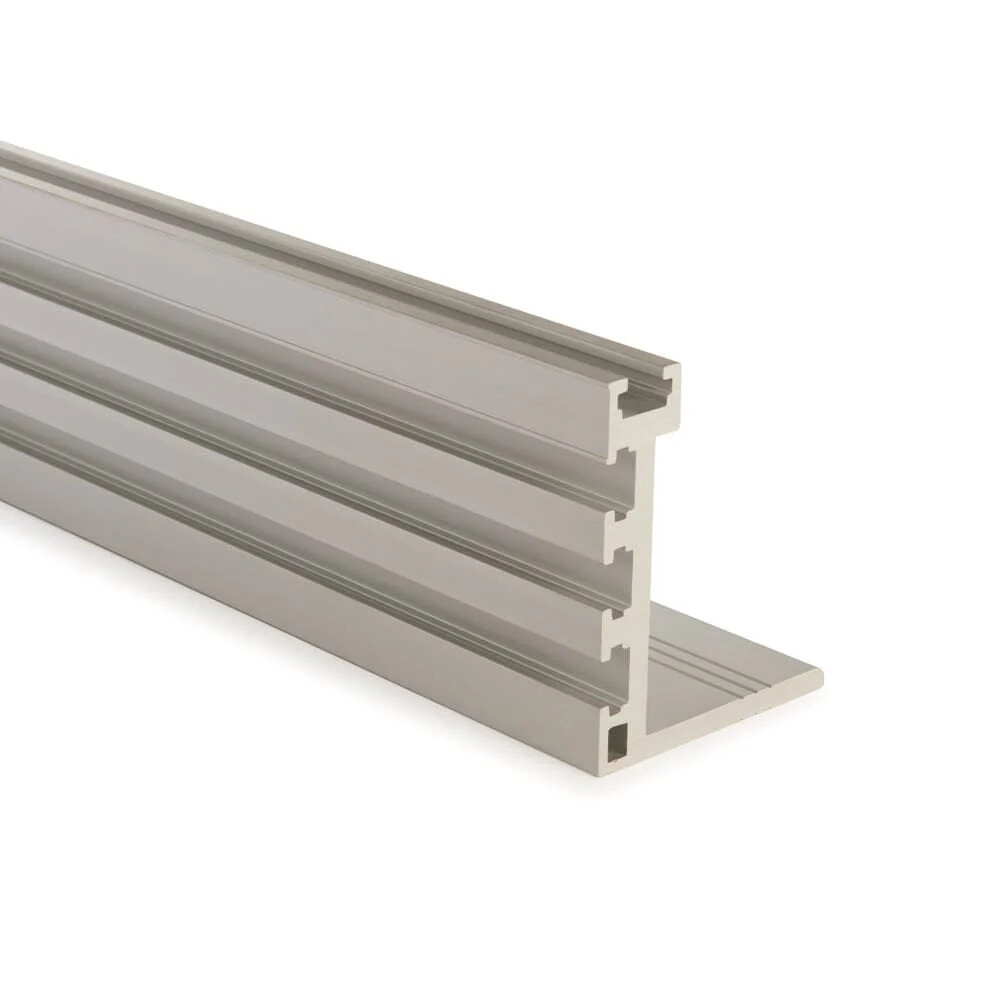

I’ve been looking at modifying the bench my machine is on for workholding — the idea is to frame the workbench top with aluminum under the machine and at the front to add:
(rotated 180 so that the metal lip is on the surface of the bench, with a similar thickness of material all around to preserve level)
