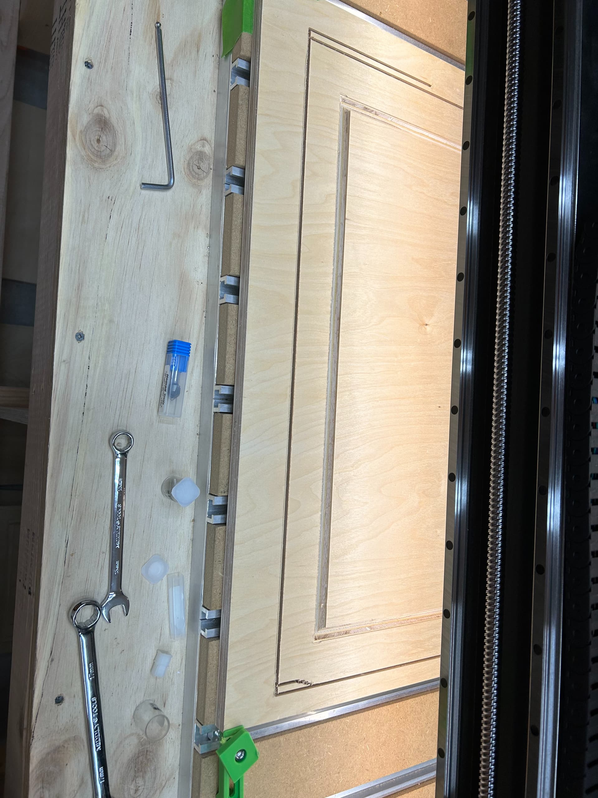

Has any of you had power blips from the grid and your design goes all screwy? Any suggestions on how to pause and/or restart a job to prevent it messing up when a storm is messing with power? Was a few passes away from finishing the first section and had 2 power blips. I am guessing that is what messed up the tool path.
Be sure your dust boot did not collide with the green clamp in the corner, throwing off X and propagating the bias as the cut progressed.

As @CrookedWoodTex suggested a UPS would solve your surging and drop outs. The trick with a UPS is to size it to last long enough to get your system shut down. You can get a big one that would last for hours but that costs a lot of money. So get one big enough to keep you up for 15-20 minutes and toward the end of that time if the lights have not come back on or stabilized then shut down in an orderly manner. The UPS would keep surges from damaging your electronics. A UPS conditions the power to eliminate the surges and gives you a clean sine wave power.

My suggestsion is don’t cheap out. I have an APC 1500 UPS running my 3XXL and the router. I’ve completed jobs when the power went out and using a flashlight. :smiley: More than an hour.
