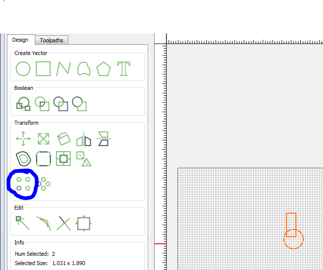

Your ‘Part Duplicate’ sounds like the Array feature.
A copy or a duplicate does not preserve layer info. I have not tried array copy
Ok, I tried using the array function, but it does not preserve the layers either
So, if I COPY, DUPLICATE, make and ARRAY all the vectors that are created are dumped on to the same layer… Is there a way to have the pasted vectors be on the same layers as their parent vector?

At this time, the significance of the active layer is that new objects are created on it.
