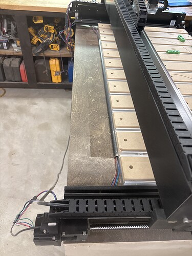

I need to move my entire CNC backwards on my table by a few inches. Question:
Will it hold its square as I move it? Or will I have to resquare it all again?
As I was originally assembling it, I had no idea how it would sit on the table. Now that I’ve using it for a few months, I realize I want to have the front and back available space available so I can build up an area as needed to attach clamps so I can use the full 4’x2’.

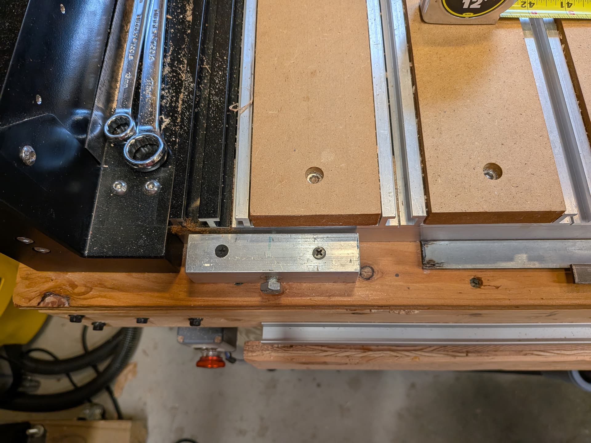

I noticed my Pro 5 was way out of square. It turned out that the assembly guy ( me ) failed to tighten the cross member bolts correctly.
I needed a way to move the machine slightly to realign. I added jacking blocks to help this effort.
I left them they for insurance.

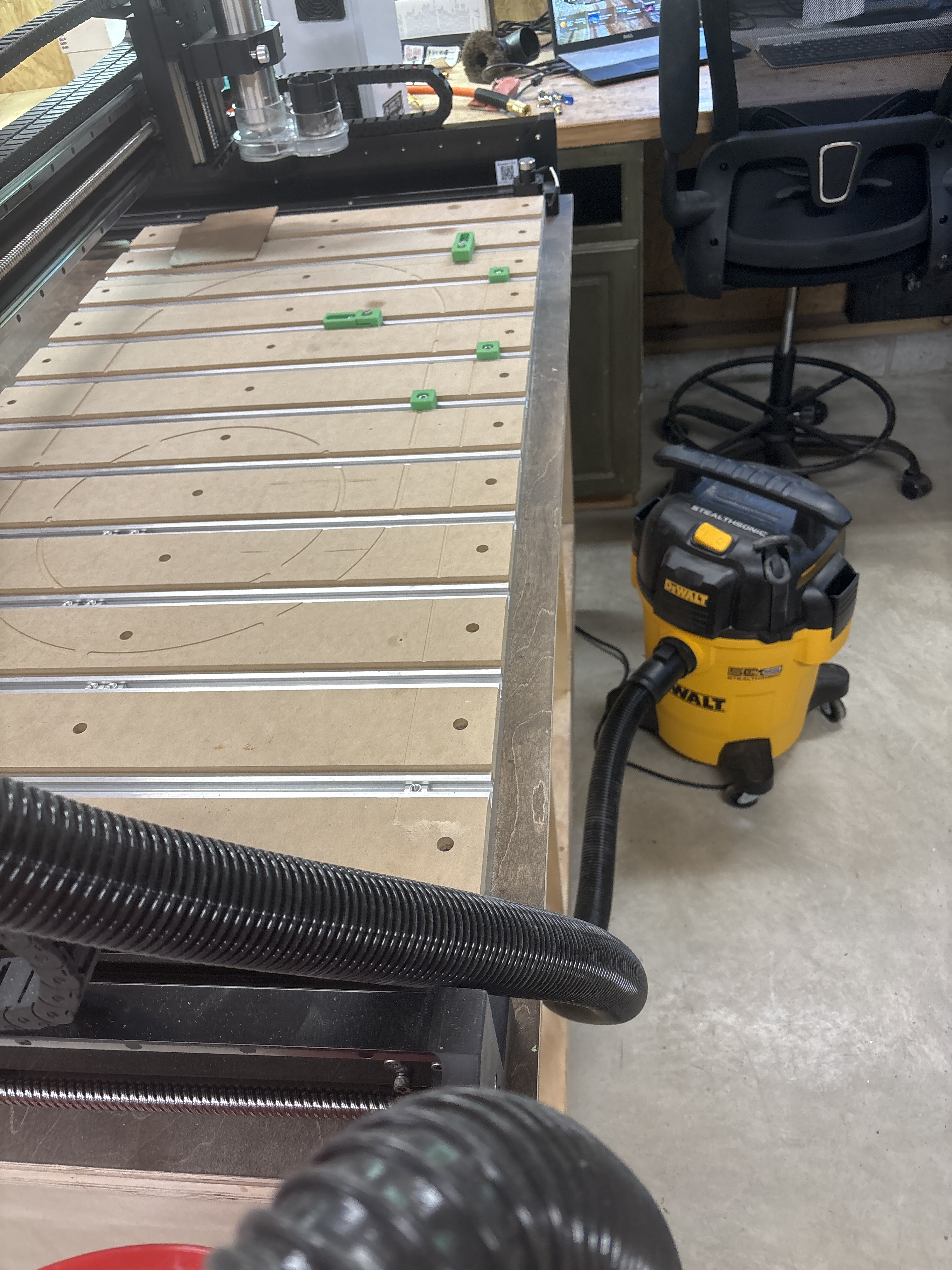

I slid my table forwards and backwards on my table until I had in its final position. I did have my brother lift the YR rail while I lifted the YL rail. Just don’t lift or tug on one side at a time and you should be fine.
I just had a similar concern… for me, I set it up on an old, sturdy kitchen table with an extension leaf. I’ve had it for 8 months now. In that time I’ve moved the table several times by pushing it (sliding it) across the garage floor. I started having Y-homing issues about a month ago, and they got so bad after the latest table move (I moved it from a horizontal orientation to a vertical one which was a big rotation for all that weight, that I could no longer initialize. I followed the standard squaring advice and works perfectly again. So, I’d say, no you don’t have to re-square unless you have homing or drift issues. That being said, if you are worried about wasting your work pieces right after moving the machine, and it will cost you to do so, re-squaring is certainly insurance.
A check using the provided Sharpie attachment with a quick spin around the spoil board prior to moving and then run the same toolpath after and inspect traces should resolve your question.
