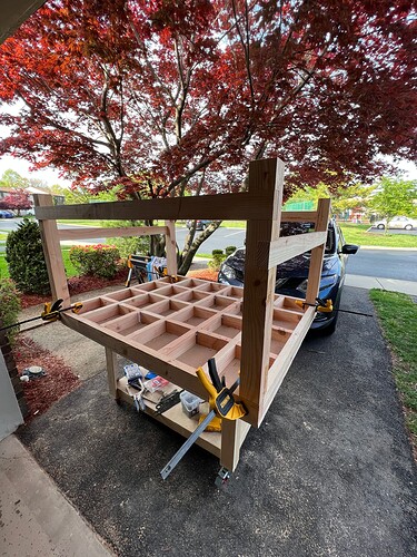

The first step towards building a CNC enclosure is building or buying a CNC table. I do all my woodworking/making in my tiny one car garage so building the very unique dimensions was obvious from the start.
I looked around at various plans available for DIY shop tables and landed on Crafted Workshops miter saw/outfeed table design. I really liked the way he integrated the legs with the rest of the structure and the pseudo torsion box top.
So I bought the plans and started building a model of my version in fusion. Here’s what that looks like sans cabinets
I still went with 2x8s over 2x4s even though they were DougFir at my hardware store because it was much easier for me 2 load into my SUV and move around 8 8’ 2x8s than 16 8’ 2x4s.
Also bought a sheet of .75” MDF for the top surface and .5” sande ply for the bottom.
I made my modified cutlist and got to work. That brings us to the time of writing. Everything is cut to size and the top structure was left to dry overnight last night.

Whew! Long day but made a ton of progress. In the morning I got the legs glued up and clamped.
Once they were dry I ripped each one to remove the remaining .25” extra width and then cut them all to final length. Once that was done I was able to cut the half laps and notch the front legs.
From there, I was able to attach the legs and install both pairs of stretchers.
I didn’t quite finish though. I still have a good chunk of work left. Casters have to be attached, the entire thing needs sanding and most edges need profiles. Debating painting it. Getting really close now!
