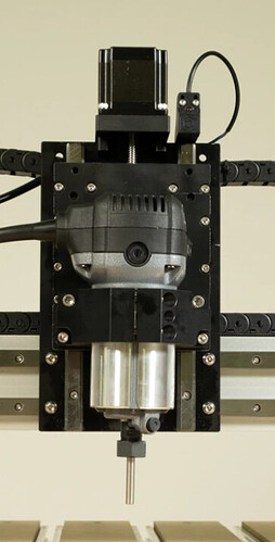

@chckblier - does your Z Axis look like this one?
or this one:
I have found your ticket — it was escalated — we will get this worked out as quickly as we can.
I received you email. And thank you for such quick action!
It is the second one displayed here with the router in it.
