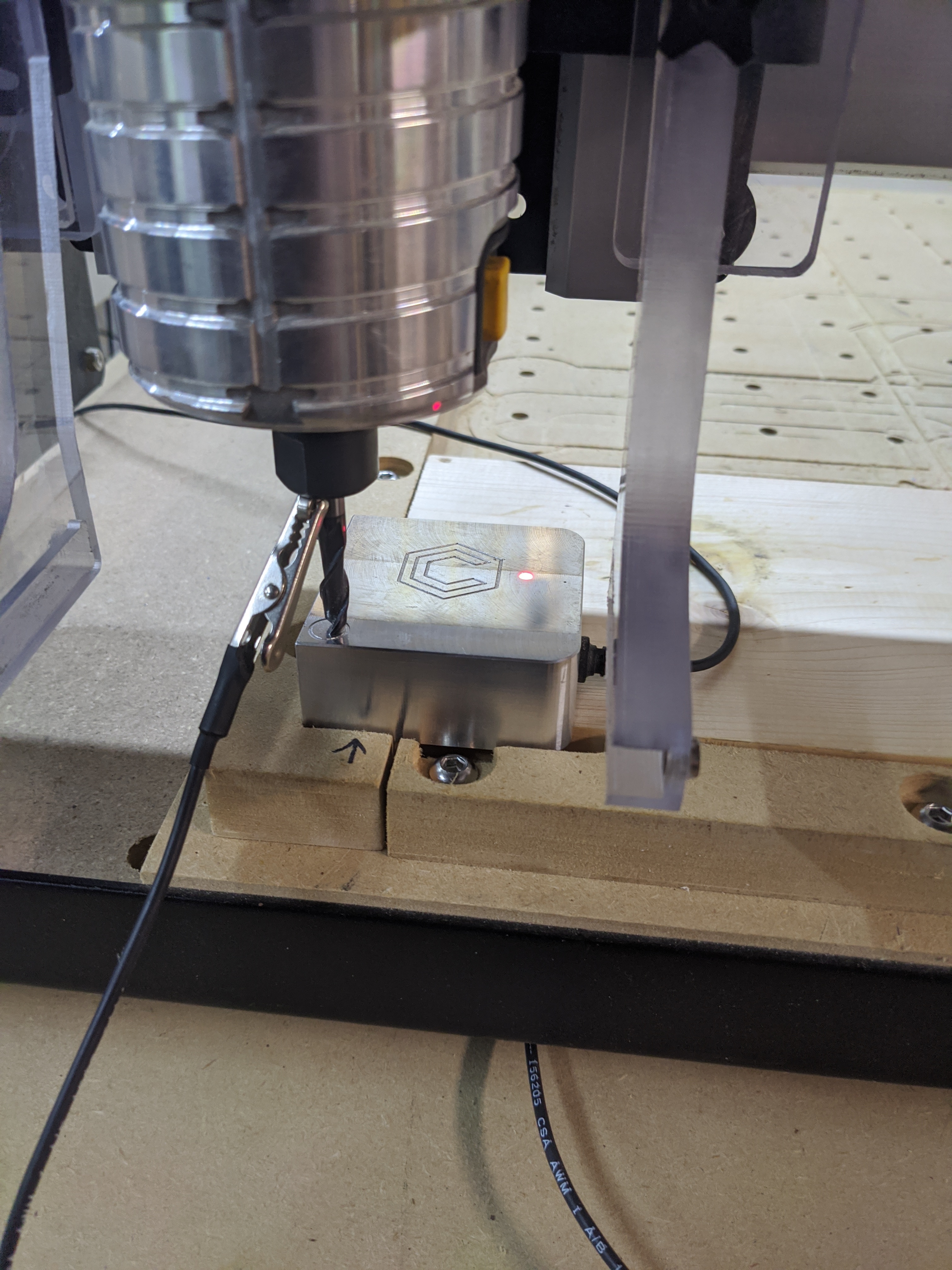

Please check to see if the the Z stepper motor gear is loose. This can happen on a stock Z right? I have had HDZ’s for 6 months it is hard to remember.
Do be sure to set the Touch Probe on to your stock with the edges hanging over. Otherwise it is approximately 3 MM difference when setup for probing Z only.
Check that the bit is properly tightened and is not slipping up into the collet on probe.
Any loose V wheels?
Does the probe on the bitsetter activator seem tight? Mine came loose after repeated use.
Editor settings for stock depth are correct? Double checked everything?
Note that there are 2 ways to set the BitZero — if you set it for a corner probe, but then probe only for Z it will be positioned 3mm lower than it ought (the height of the lip at front and left) — if you can come up with a repeatable set of instructions which we can follow we’ll see what can be done.
Mr WillAdams the repeatable set of instructions have been posted twice.

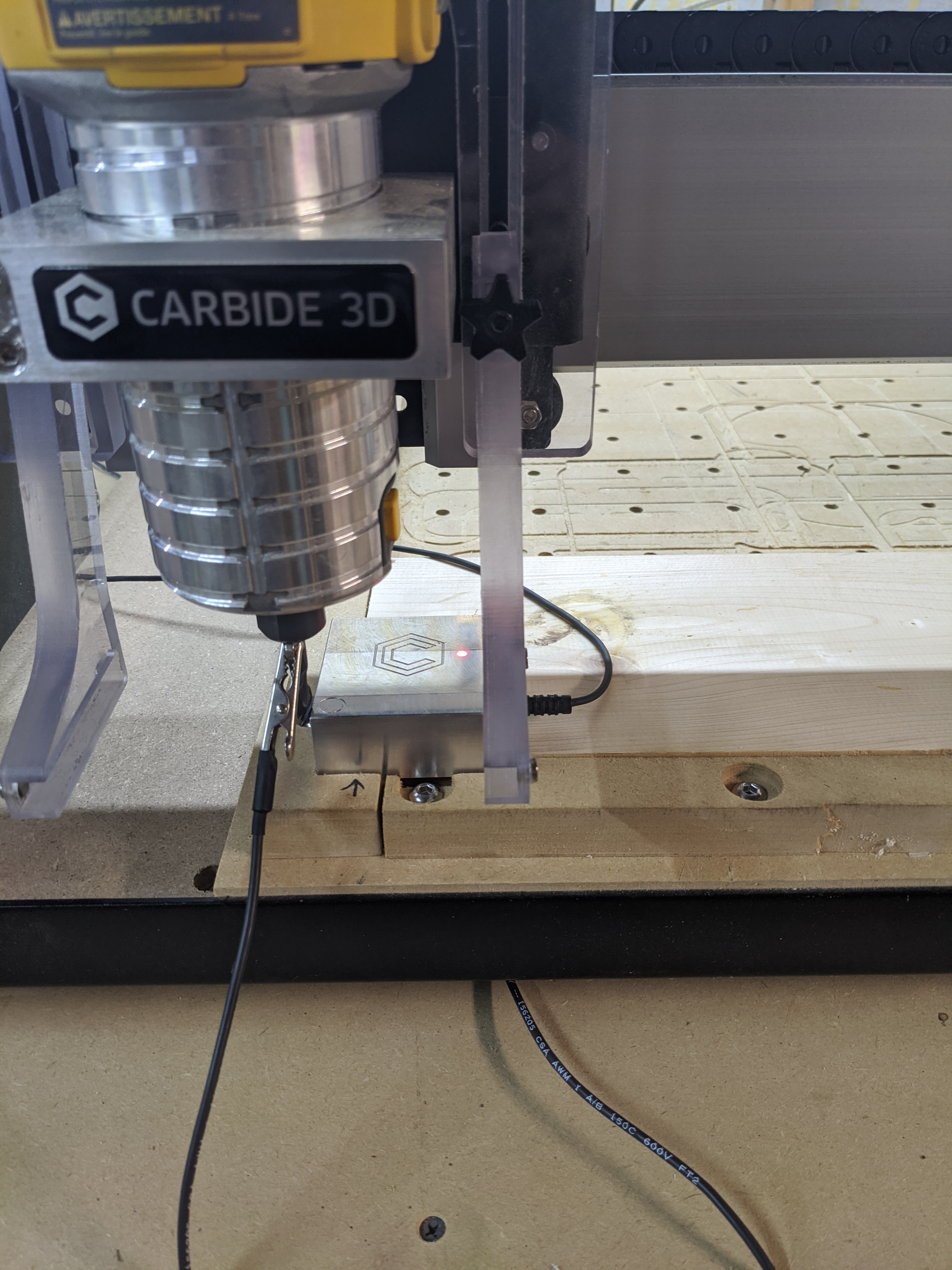

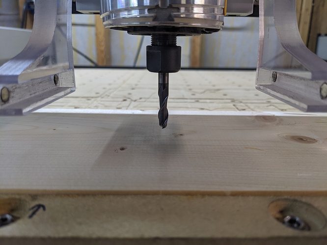

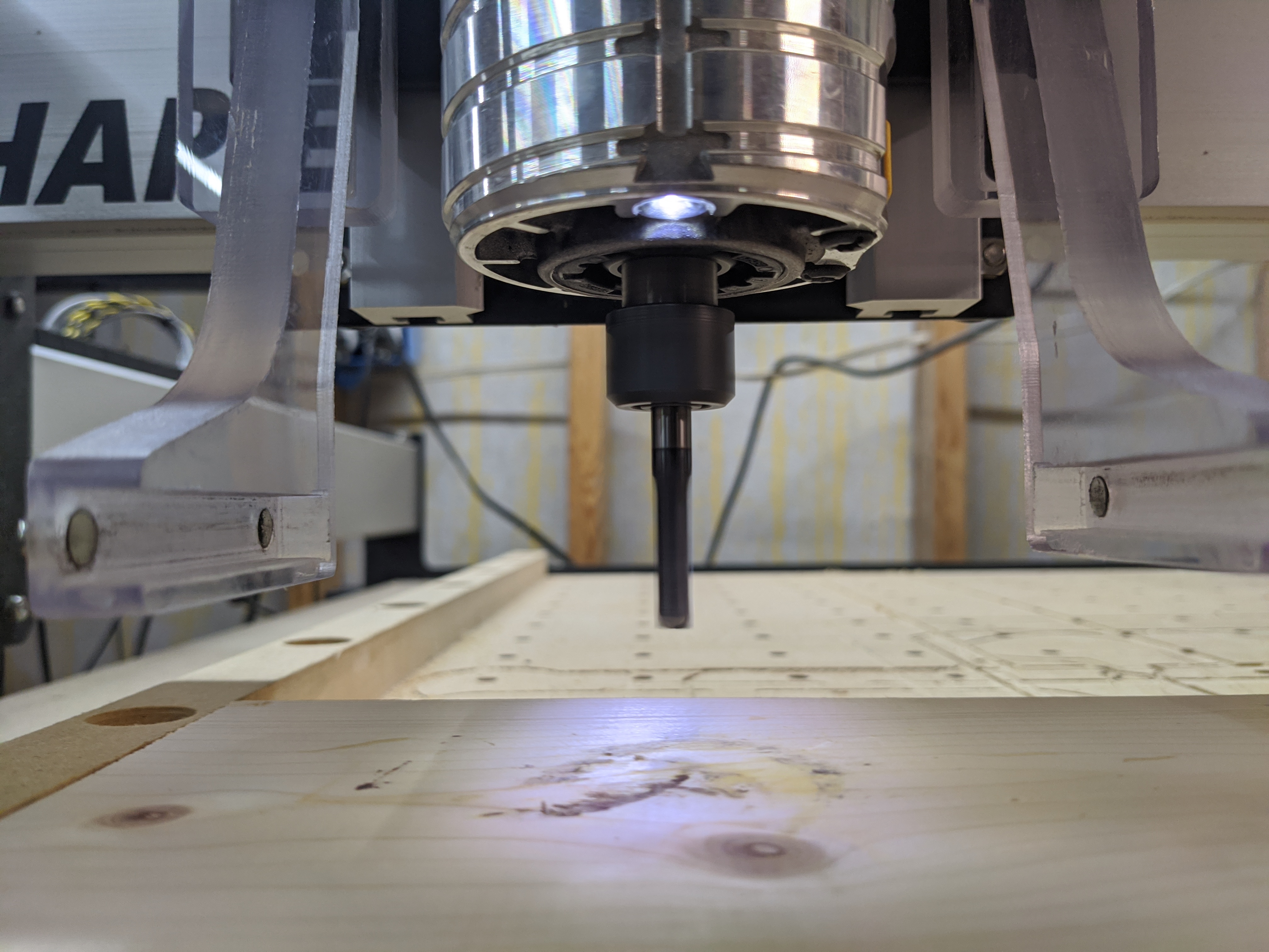

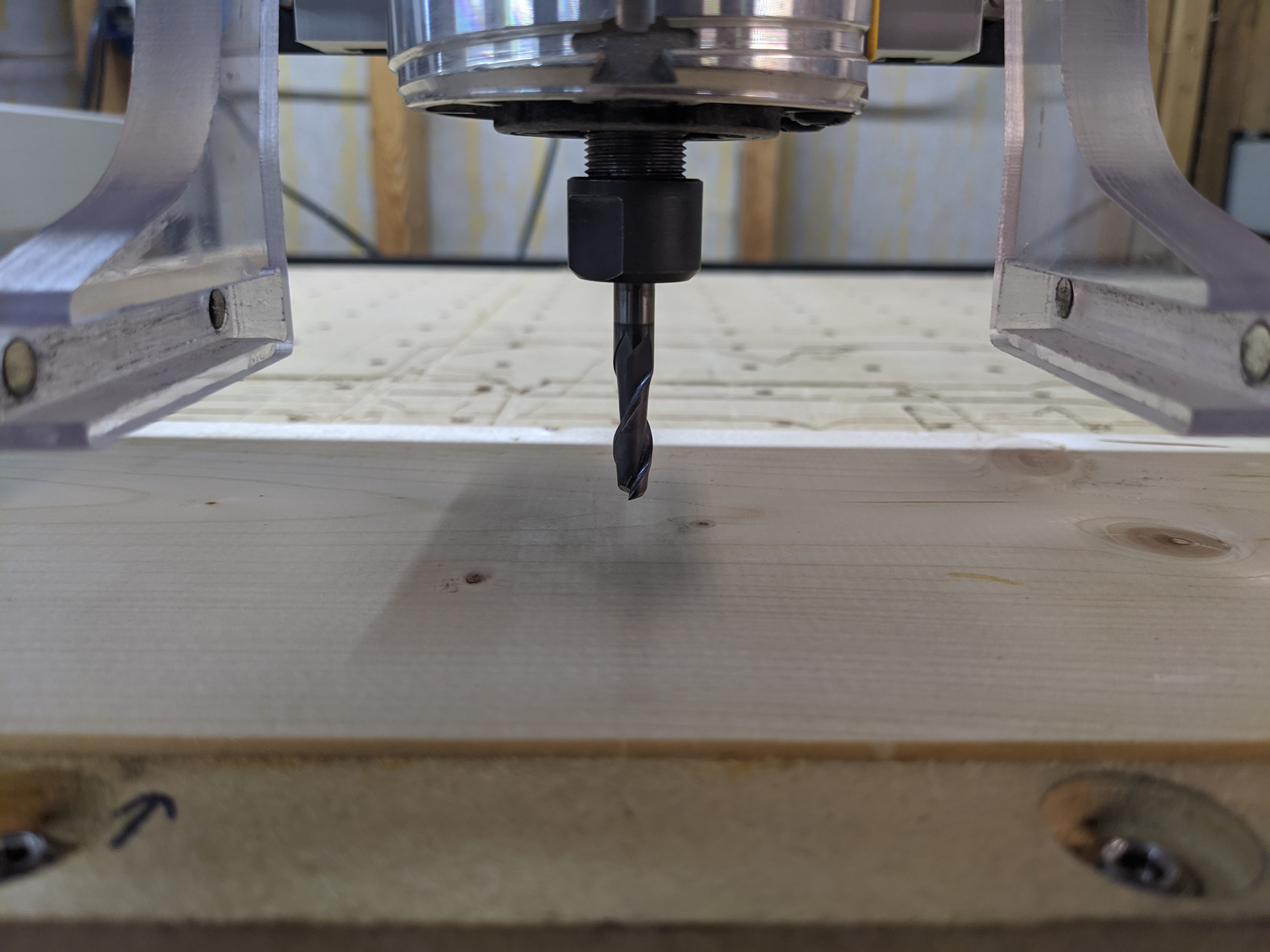

Turn on computer, startup carbide motion, connect to cutter, initialize machine, tool change required prompt, click resume, move carriage to desired position, use probe to set zeros all three, open carbide create, open project, click send to carbide motion button, click start job, click start, tool change required prompt, insert tool click resume, quick resume after tool goes to bitsetter, it starts cutting air,as pictured in previous post it should have been cutting the spoil board not 6mm above the spoil board.
I’m not sure what else your asking for.
Is the bit long enough to reach the Spoilboard?
@WillAdams can he test that by turning off the power and lowering the Z all the way down with the bit installed?
yes its plenty long enough to reach the spoil board, I can do the exact same steps with a piece of wood clamped down and it will do the exact same thing and be 6mm above the piece of wood

Will check Z stepper motor gear. Set x,y 0 to center of stock so I probe Z only. Use V-Carve Desktop, Carbide Motion, Shapeoko Tool Change post Processor. Replaced, tightened V-wheels, check every job. Collet is tight and bit doesn’t engage bit setter with enough force to change settings. Using $102=320, but had to set $132=300 or I would generate limit switch error on the way down with soft limits enabled $20=1 for my dust shoe.

Ken, you can’t use the XYZ probe zero without the probe hanging off the edge of the part to be milled. You won’t get the correct zero. You can do XY, but the zero will not be correct. You will have to use the Z-zero only menu item to redo the Z zero.

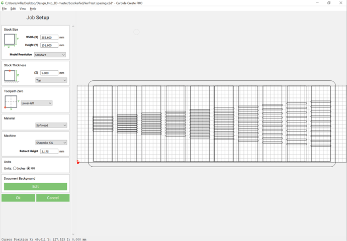

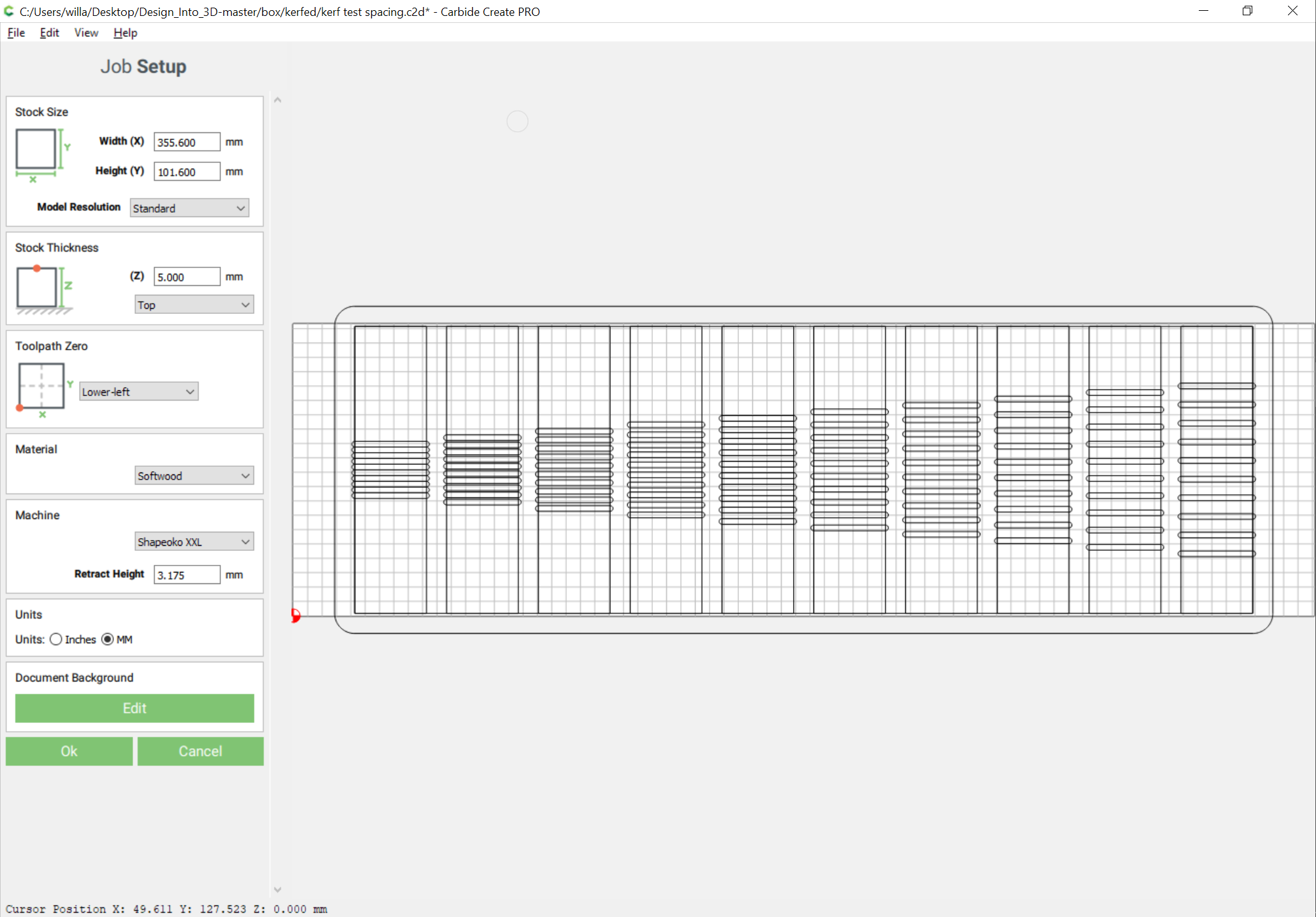

Okay, by way of comparison, let’s transcribe the instructions for the current project I am working on:
  • secure and clamp stock to machine
  • connect to and initialize machine
  • when prompted to insert tool, okay since a #251 endmill is still installed
  • machine measures current tool
  • remove lower Sweepy portion and jog to where the machine needs to be to Probe for Y-axis with BitZero positioned at front edge of stock as noted at: https://docs.carbide3d.com/assembly/touch-probe/userguide/#probing-y
  • secure ground lead, test connection and initiate Probing cycle with #201 (same geometry as #251) selected
Repeat the Probing for X and Z.
Rapid Position to XY and Z+6mm to verify position
Since job is set to surface of stock and begins with a #4577 endmill:
Here: kerf test spacing.c2d (794.2 KB)
kerf test spacing.nc (165.5 KB)
load the .nc file, start job, and change to a #4577
Job is running now, and the cutting began as expected.
EDIT: and the tool change went as expected and the #251 when reinstalled began cutting at the correct depth.

If I rapid to zero +6 it is correct and sits 6mm above the work piece but still cuts air approximate 6 mm above.
This would happen if you have the origin set in the file to bottom of stock and are setting zero on top of the stock.
FWIW, my cut finished out fine:
If you can get some other result with those files, following those instructions, let us know.

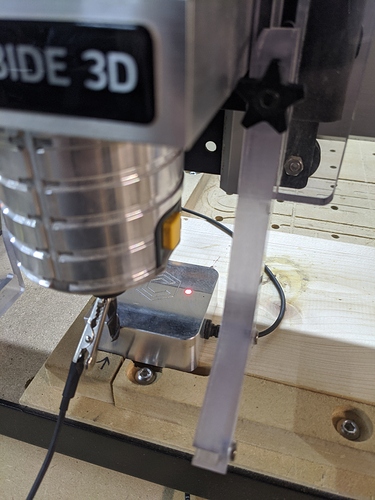

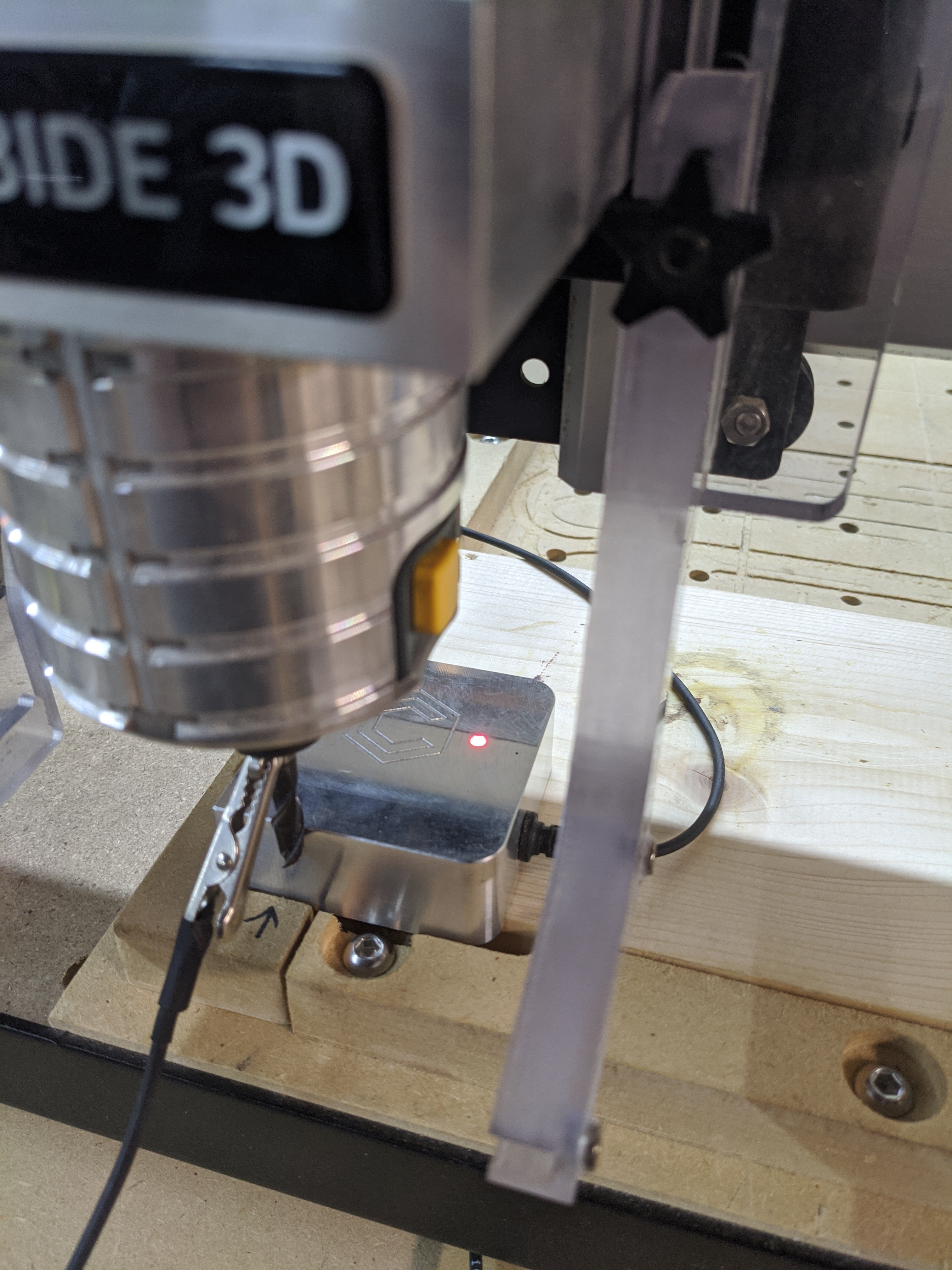

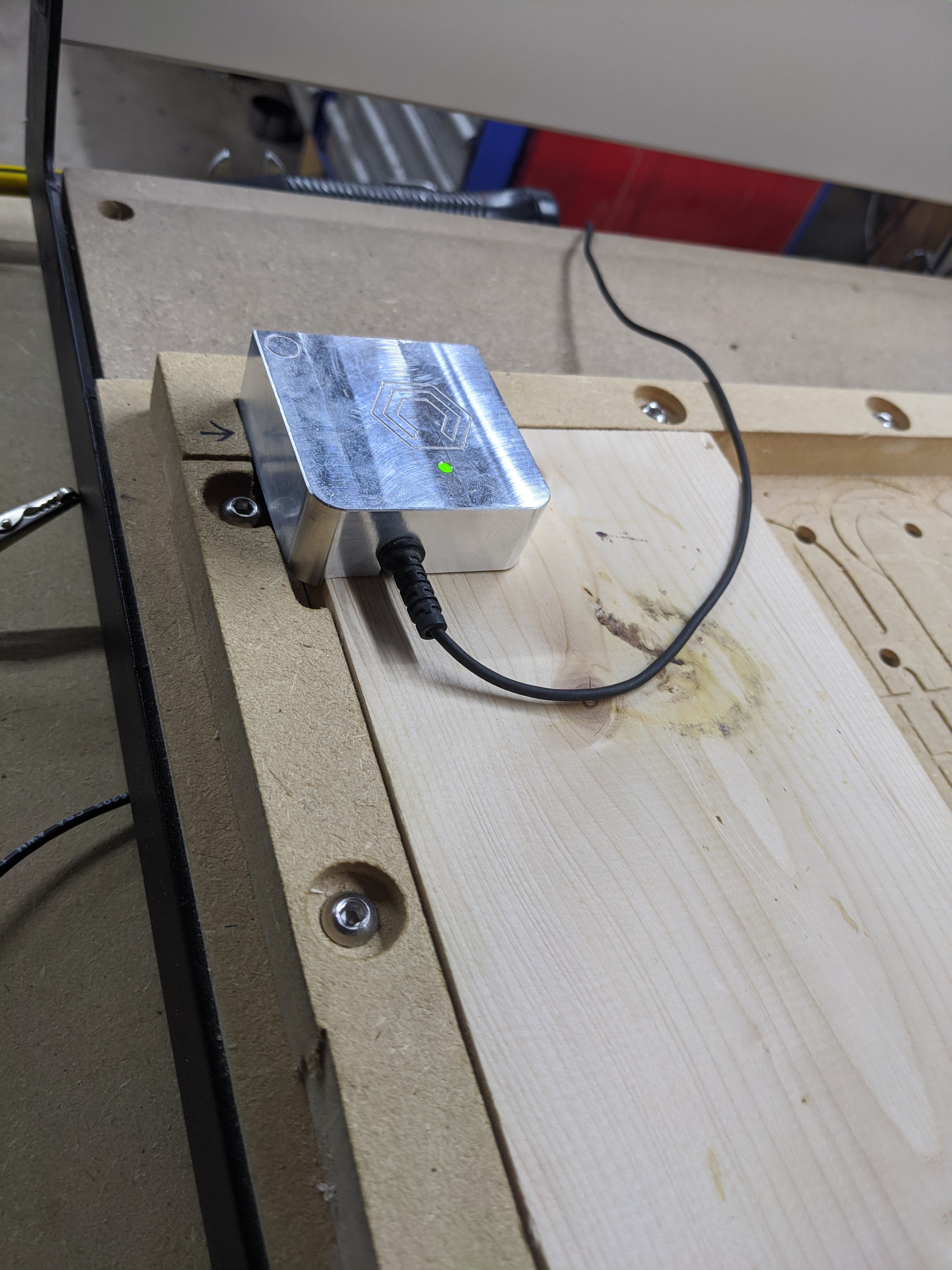

touch probe location
insert tool click resume, click resume after tool goes to bitsetter at which time it begins to run the job
stop the process and check zero height +6mm and its is correct
It will do this on any project I open but this is the one its trying to run in the pictures

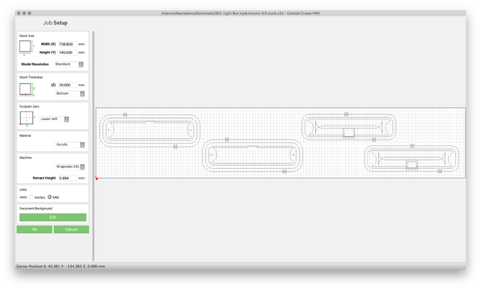

2EA. Light Box top& botoms 5.5 stock.c2d (996.6 KB)
I’m downloading and setting up to run those now
You have the origin set for Bottom in that file:
but seem to be setting your origin on the top of the stock
yes I just saw that,and that is the problem i everything I checked
Thank You it looks like I need to go in and check all my files for that.
now I feel stupid but am glad you figured it out it was a simple operator error
