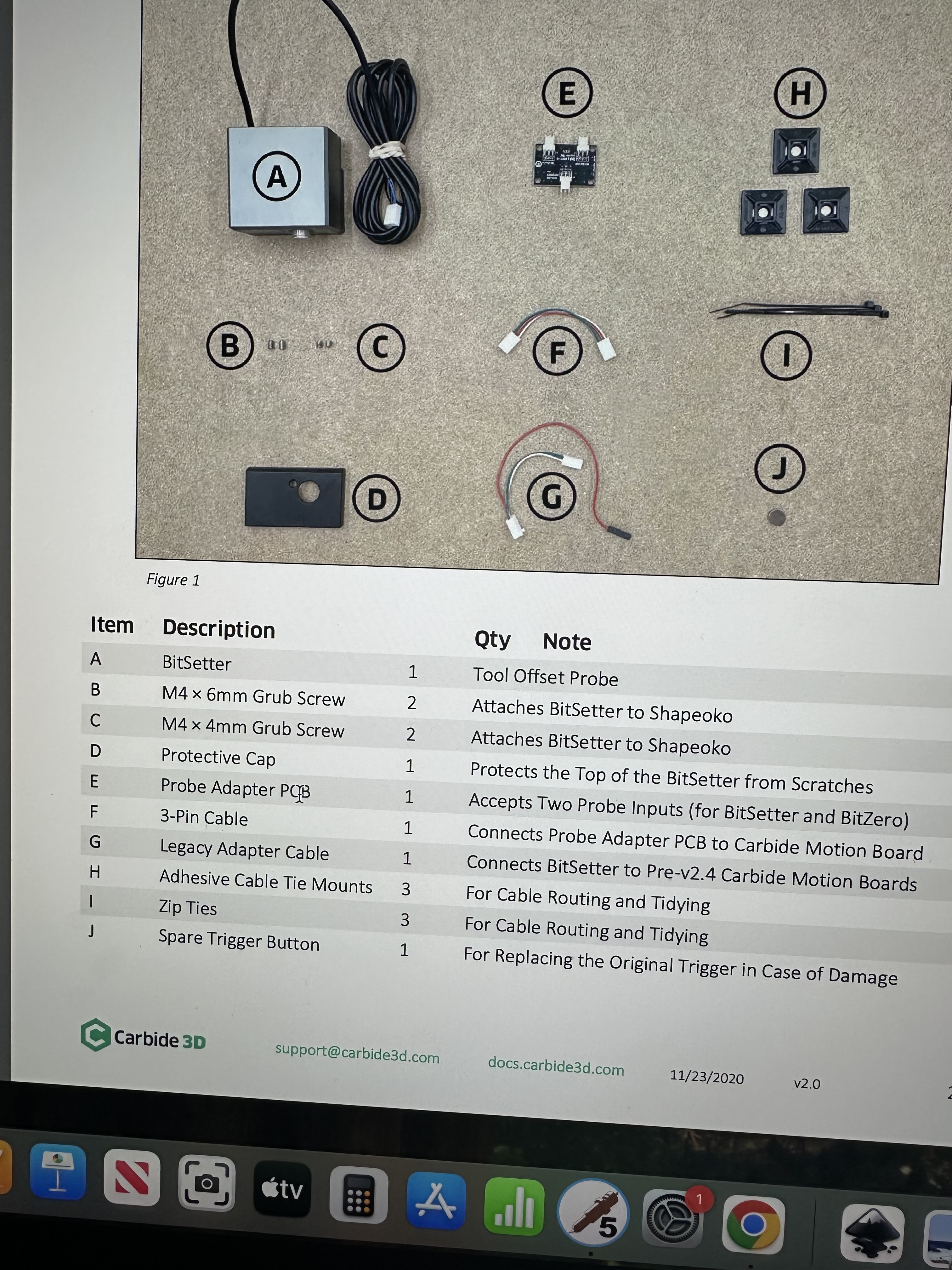

Where can I find parts? E and f on the picture?
So that I can hook up my probe and my tool setter, I bought a used tool setter and it did not come with the splitter. I have a shapeoko 3XXL.
Check in with the guys at sales@carbide3d.com
The PCB splitter and adapter cable shouldn’t be needed on current machines — if your machine is missing them, send photos of your BitSetter and BitZero and machine and controller to support and we will work out how to handle this.
@WillAdams He’s asking about Shapeoko 3
@hubbard0216 I just asked a someone here, the splitter board should have come with the BitSetter. (I mistakenly thought it came with the BitZero). As Ed said, email the team and they’ll get you straightened out.
Right.
An SO3 w/ the current Proximity Switches and Carbide Motion Board will afford two Probe inputs:
- the Reserved header as documented in the installation instructions
- a P(robe) input on the PCB expansion adapter
no need for a PCB splitter.
