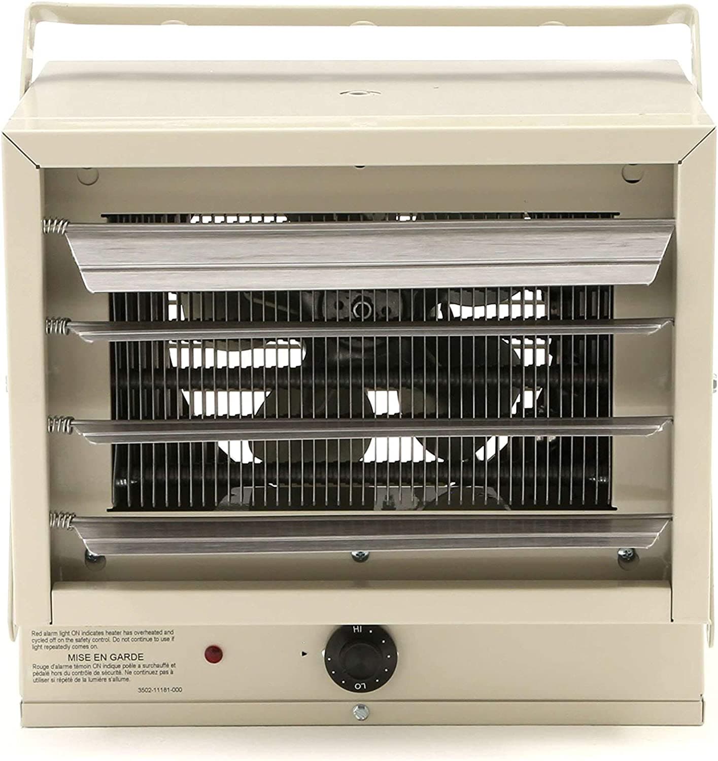

The cold bite of Jack Frost. He likes to nip us when least expected. I live in East Texas where today it was about 50 degrees F so in the big scheme of cold weather that is not cold but is miserable to me. I heat my shop with a 2 burner propane stove and that is costing a fortune with the higher price of propane refilling. I meant to buy an electric heater in the spring when they went on clearance but forgot. Luckily I have a 30 amp 220v plug I use for my bandsaw available to plug in the electric heater. Will have to start looking for one. However I just transfer the expense of propane to the electric bill. I think the electric heater may be cheaper to run in the long run.
Something like this. Maybe not this one but one with a remote control and thermostat.
