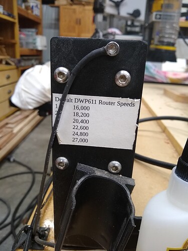

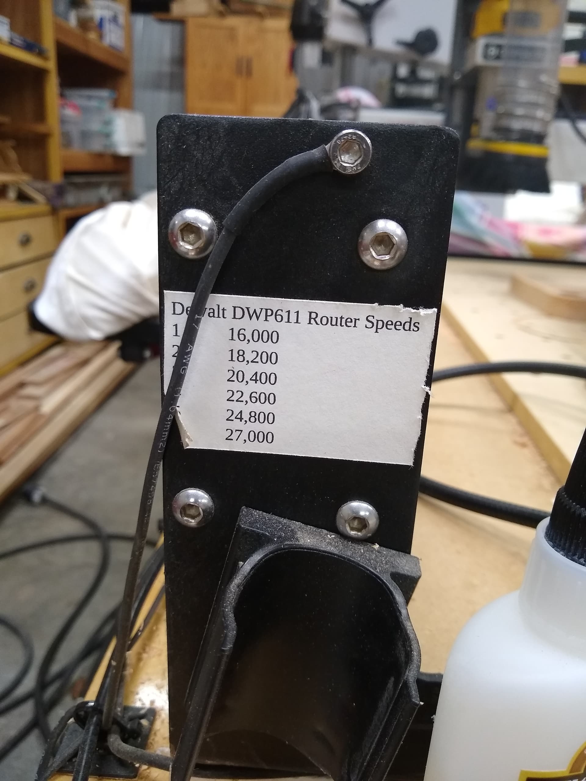

Since you just moved is there any chance that you are not grounded properly? Obviously the probe works for part of the X Y and Z probe so maybe the grounding of the magnet has gone haywire.
By grounding you mean my electrical supply?

Not your plugs. The code requires the plug to be grounded and if a pro did it assume for now that is correct. I meant the Bitzero magnet wire is solidly attached to machine. I have a v1 so the wire is attached to front of my frame.
So follow your magnet wire to where it is attached and see if it is tight. During move it could have become loose. Also check wire to magnet connection.

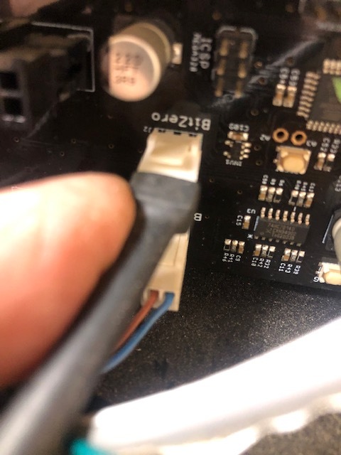

I just noticed, I have bit setter and bit zero plugged into the Y Splitter board that is then connected to the “P” header on the riser board for my Z+ limit switches.
The instructions show that Y splitter board going into the “reserved” port on one side of Shapeoko PCB. I wonder if my brain shut off and I moved it there.

I have the XXL Pro. Mine is plugged into the bit zero spot on the board.
