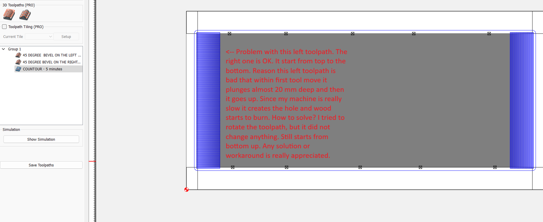

Problem changing toolpath direction or angle

If the 3D model has a hard edge (white background behind the edge), and the boundary is on or outside the modeled edge, the tool can fall off & plunge to the bottom of part.
It’s best to make the model geometry bigger than you need, then limit the path with your boundary.

Ah, that was not the problem. You are only using a finish 3D path, and it just happens to start at the deepest point. Try running a rough 3D path first. Use the largest stepover & depth per cut you are comfortable with.
