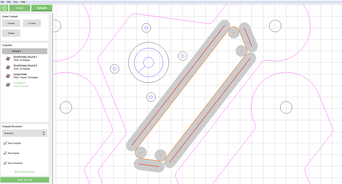

I’ve been getting a weird glitch trying to import from an SVG file. My dxf imports were looking terrible (taking a 5/8" radius curve and breaking it into straight segments over 1/8" each), so I found a solution here on the forums to convert to svg before importing. My files look great, but now I have two new problems:
  1. I have to manually select EVERY line or curve segment manually, and join them into groups. CC won’t recognize the closed paths after the dxf/svg conversion.
  2. After joining a closed path into a group, some work great, and others create glitchy toolpaths where the machine switches what side of the profile is inside vs outside.
Any ideas on what I’m doing wrong? Any better solutions for dxf import quality?

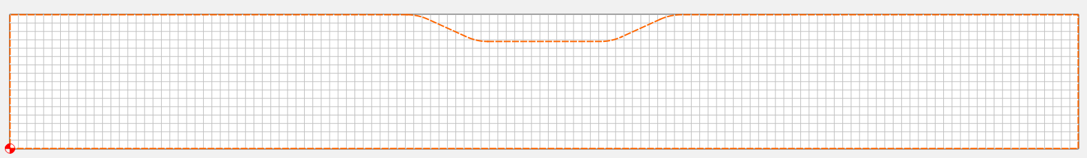

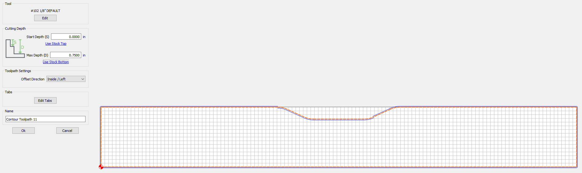

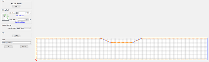

I can confirm this issue on the most recent Carbide Create. This part is modeled in SolidWorks and exported directly from the part file as a DXF. I am just trimming the handle recess so started with that alone and had the inside/outside issue, so went back to the full file which imports as line segments. Grouping inside Carbide Create does not fix it. File is attached.
DRAWER, WIDE, 1x3 STOCK.DXF
